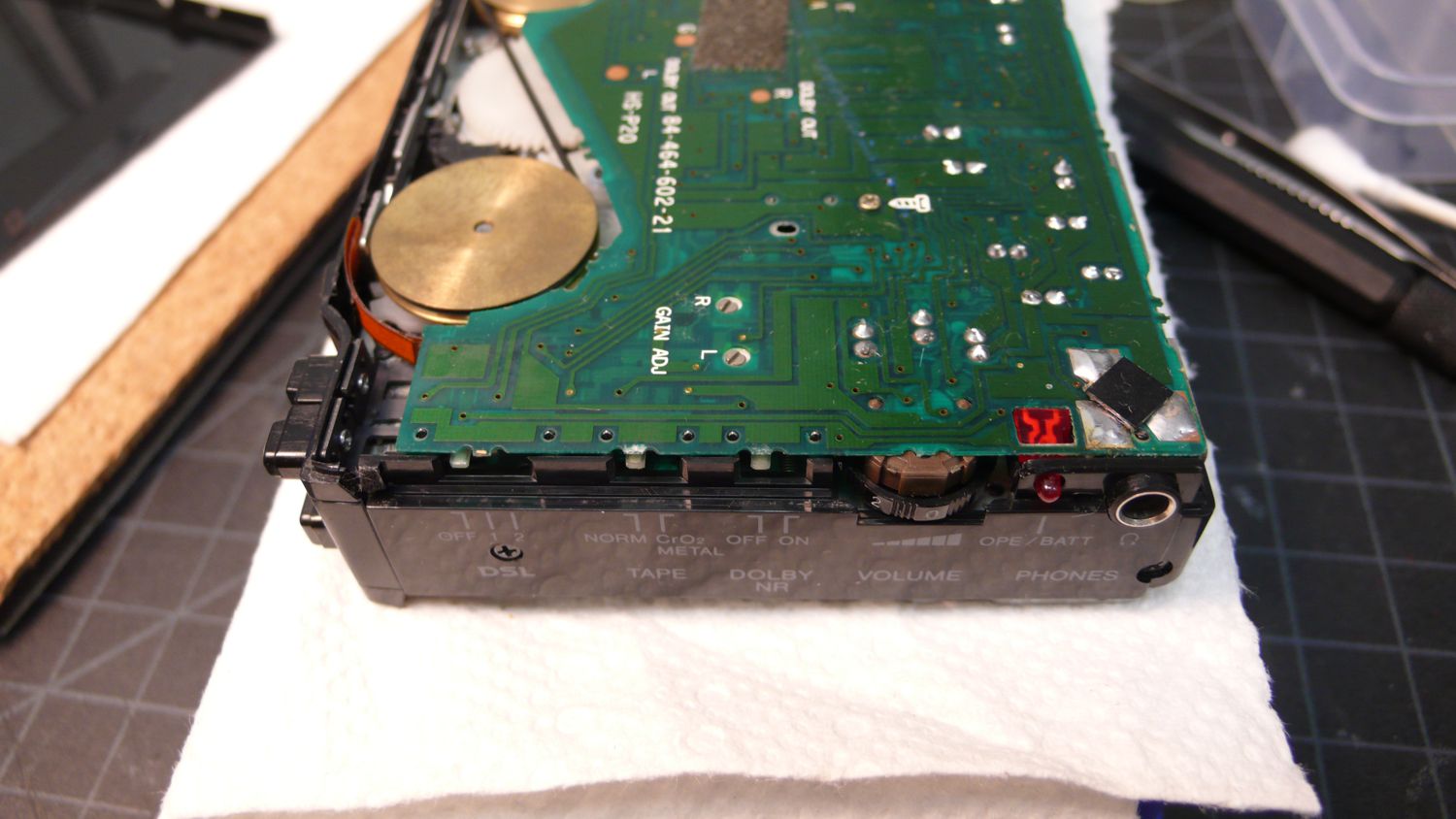

  3. Jorge
    1,754
    I did disassemble it completely, just for fun! But here is a photo which shows that the mainboard is NOT held by h/p or LED:

  4. walkieman
    walkieman New Member
    italy
    hello Jorge.
    mine is is same of yours in the photo.
    that black horizontal small plastic around led and hp held the board...
  5. Jorge
