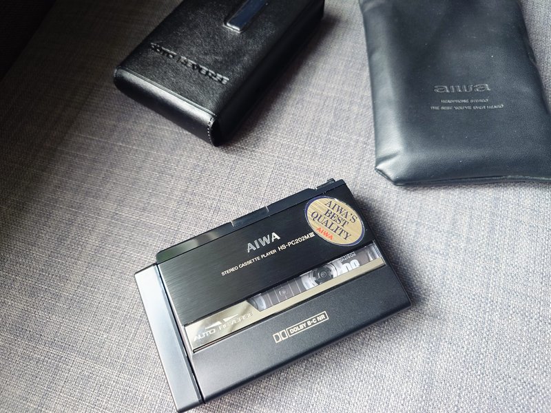

    Thank you so much for this thread. I finally picked up an absolute mint condition PC202 MkIII today. Almost the same model but with the Dolby-C circuit (which I heard is actually not the best on this model and isn't maybe worth the trouble trying to source over the Dolby-B only version).
    My motor hums really badly.
    Here's a sample: https://voca.ro/1ntlFmCclc5S
    The speed reports about 3082Hz on a 3000hz reference tape. The hum it's very audible, likely the caps are gone and it needs a proper cleaning and repair which I will attempt myself. So I am really appreciative that you've put so much effort into all these photos and explaining everything clearly. Thankfully this is not a "rare" model so there's quite a bit of information around about it. But it looks like it will be time to try my luck at micro-soldering and buy the capacitors I need. Unfortunately with the motor hum there's a lot of potential causes, most likely is the capacitors and increased power draw from the engine.
    I'll be opening up the device this week to figure it out and I'll post my findings here rather than make a new thread.
    That said, she's a beauty and came with all the acecssories including the case, bag and even the EU adapter which often goes for up to €50-80 on its own. I've never seen one in this good condition except for a few years ago when an eBayer was selling about a 100 or so of these BNIB and I missed my chance on one of those.

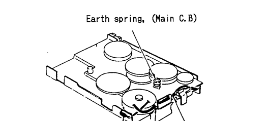

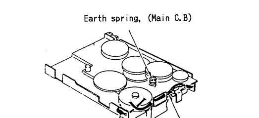

    The second question concerns the grounding spring. Does anyone have a photo of what it actually looks like? Is it flat on both ends?
  13. Valentin
    1,696
    No, it isn't normal. Check the screws where the AAA sidecar is mounted.
