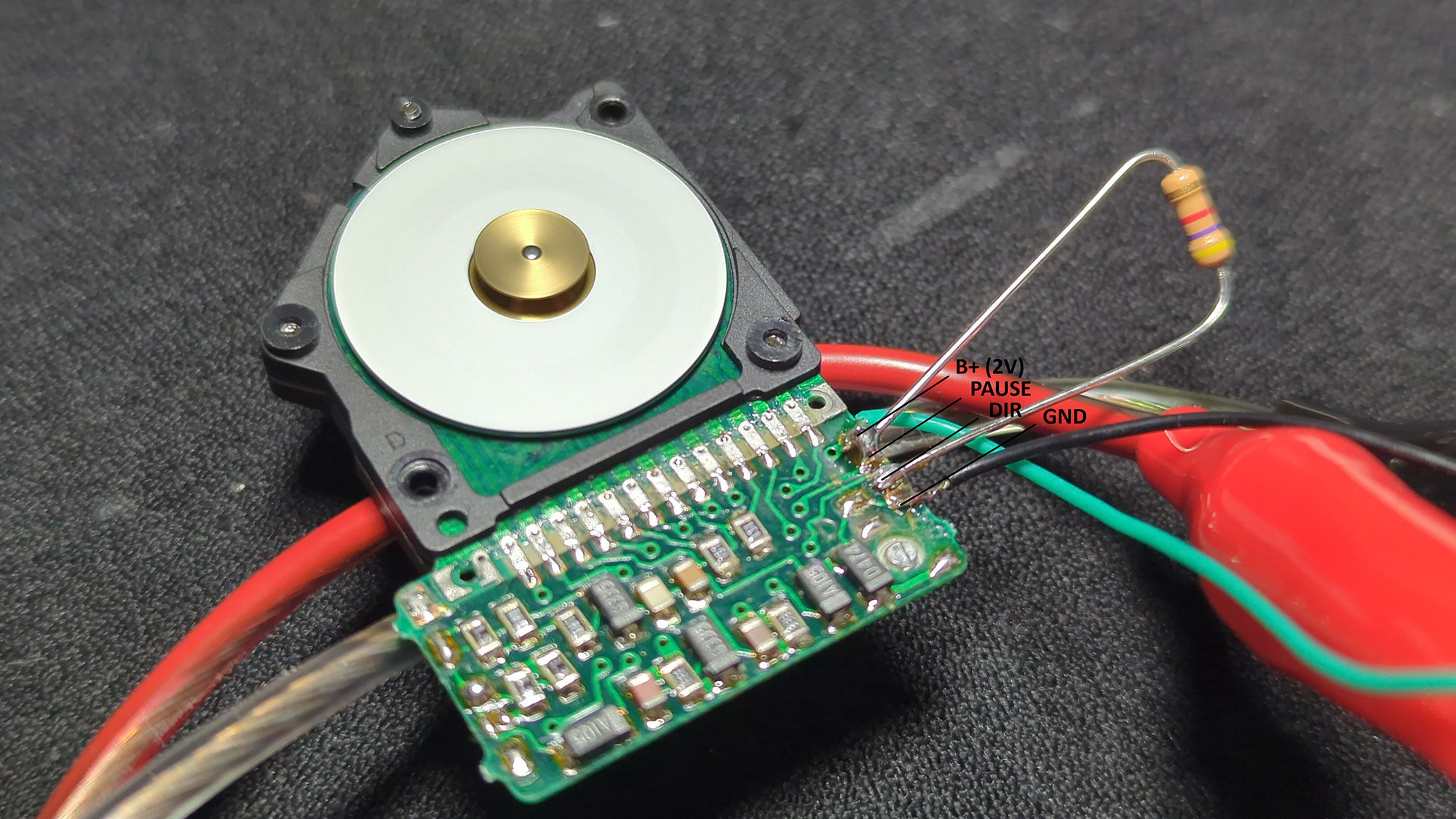

    In regard to the motor, note it can be tested outside of the walkman. Refer to page 8 of the pdf service manual (pages 11, 12 of the actual manual).
    To test you need to connect pin 3 to B+ and pin 4 to B+/GND (clockwise/counterclockwise rotation) through a 4k7 (or higher) resistor.
    After you get the motor running, check that when motor is stopped by hand, the current draw is ~250mA. If not, perform the adjustment at page 8.
    Also motor should be able to start again on its own after it's released, even at 1.7V B+.
    As a sidenote, these disc motors don't have a lot of torque, so the finger feel test is only relevant if you know how a good one should feel.

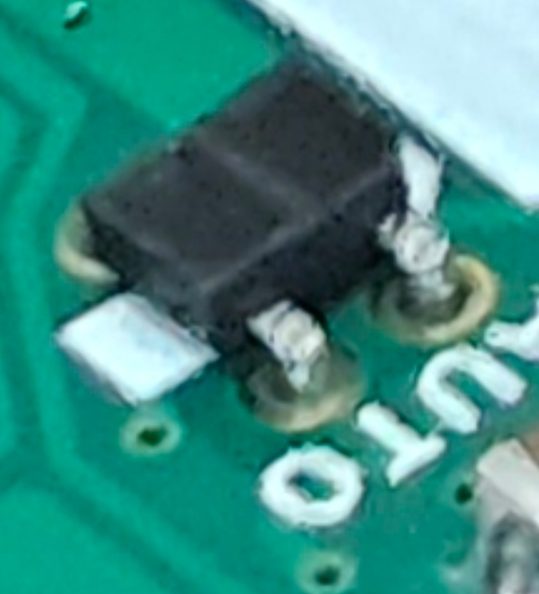

    Leaving an update here, i have finally found the problem and it was my fault here.
    Basically, when i was transferring the sensor over to new pcb i started soldering it from the back of pcb. The solder didn't make connection because i didn't know that solder have to run through both sides of the pcb through hole.
    I can now go through the process of motor torque adjustment, tape speed , and adjust dolby pots.

    Normally the solder shouldn't need to run through to the other side to make a connection, assuming the hole is copper plated.
    In your case it's possible the PCB either had a manufacturing defect or a design error.

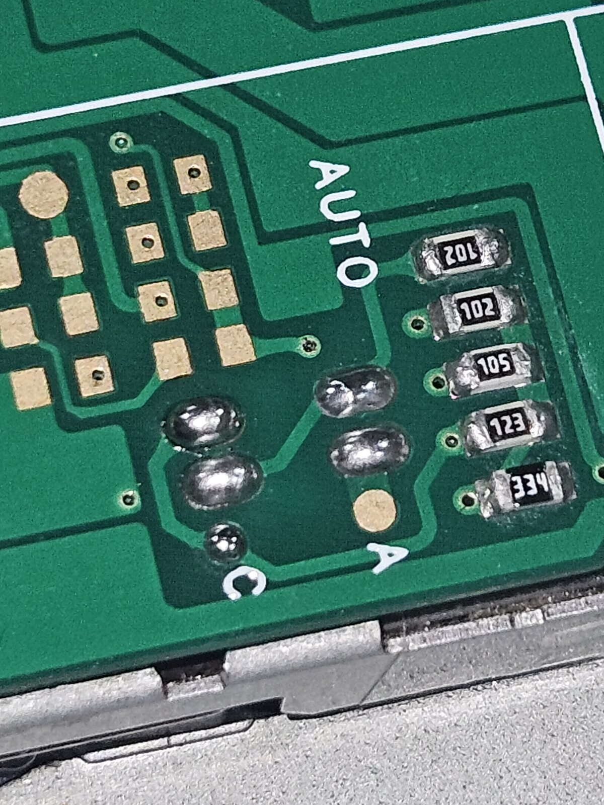

    I think it's possibly a design error because i did find other problems while transferring over to new pcb. I found that 2 of the soldering pads were missing and i had to scrape off solder mask on copper trace underneath to put in the smd caps.

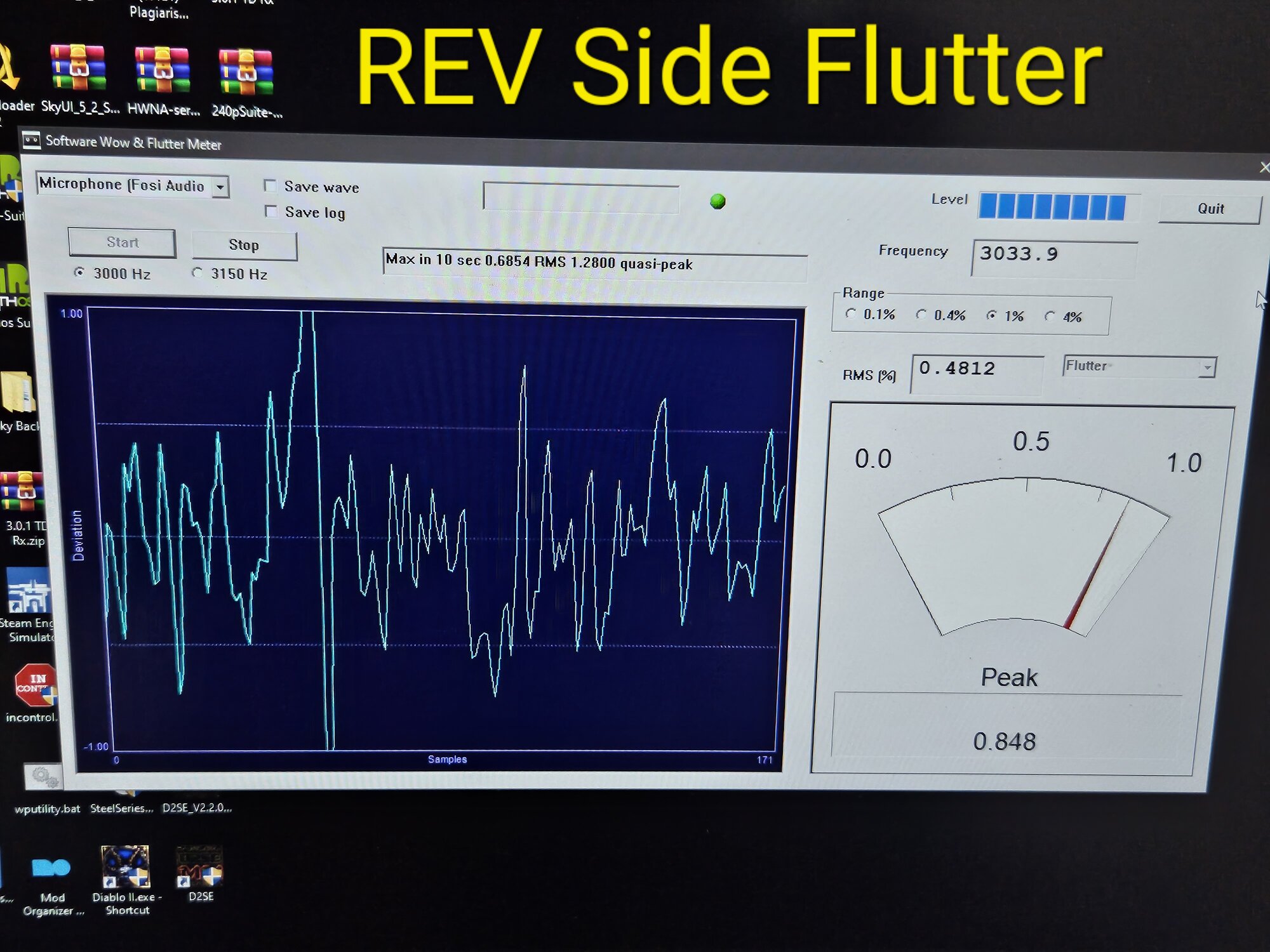

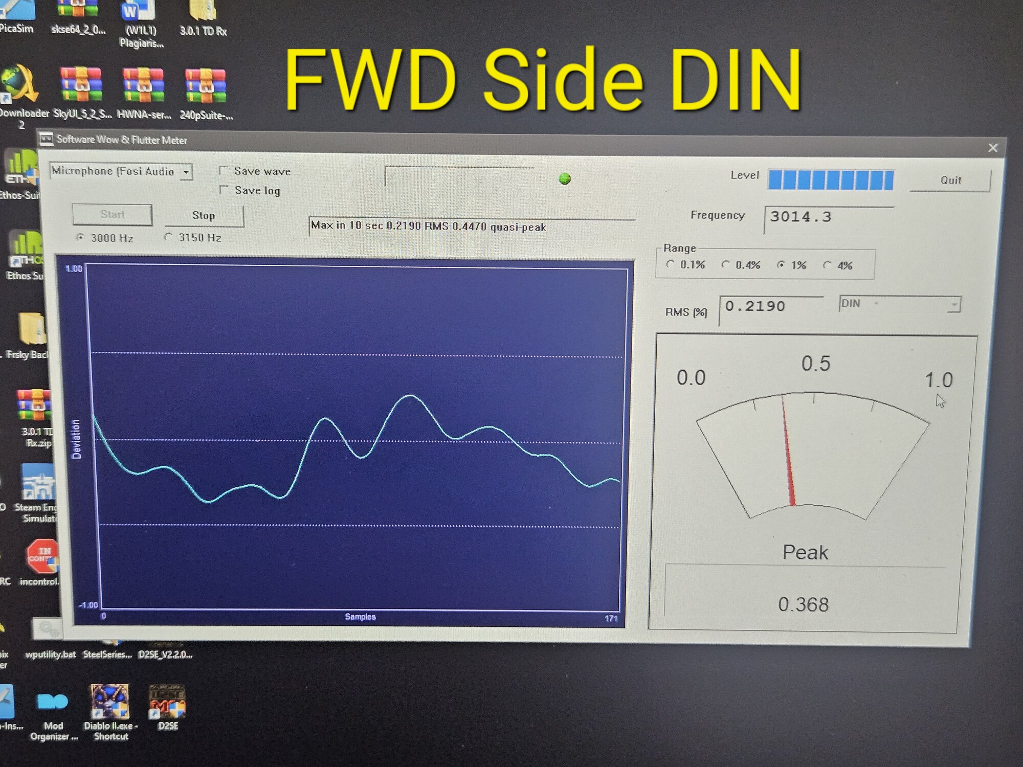

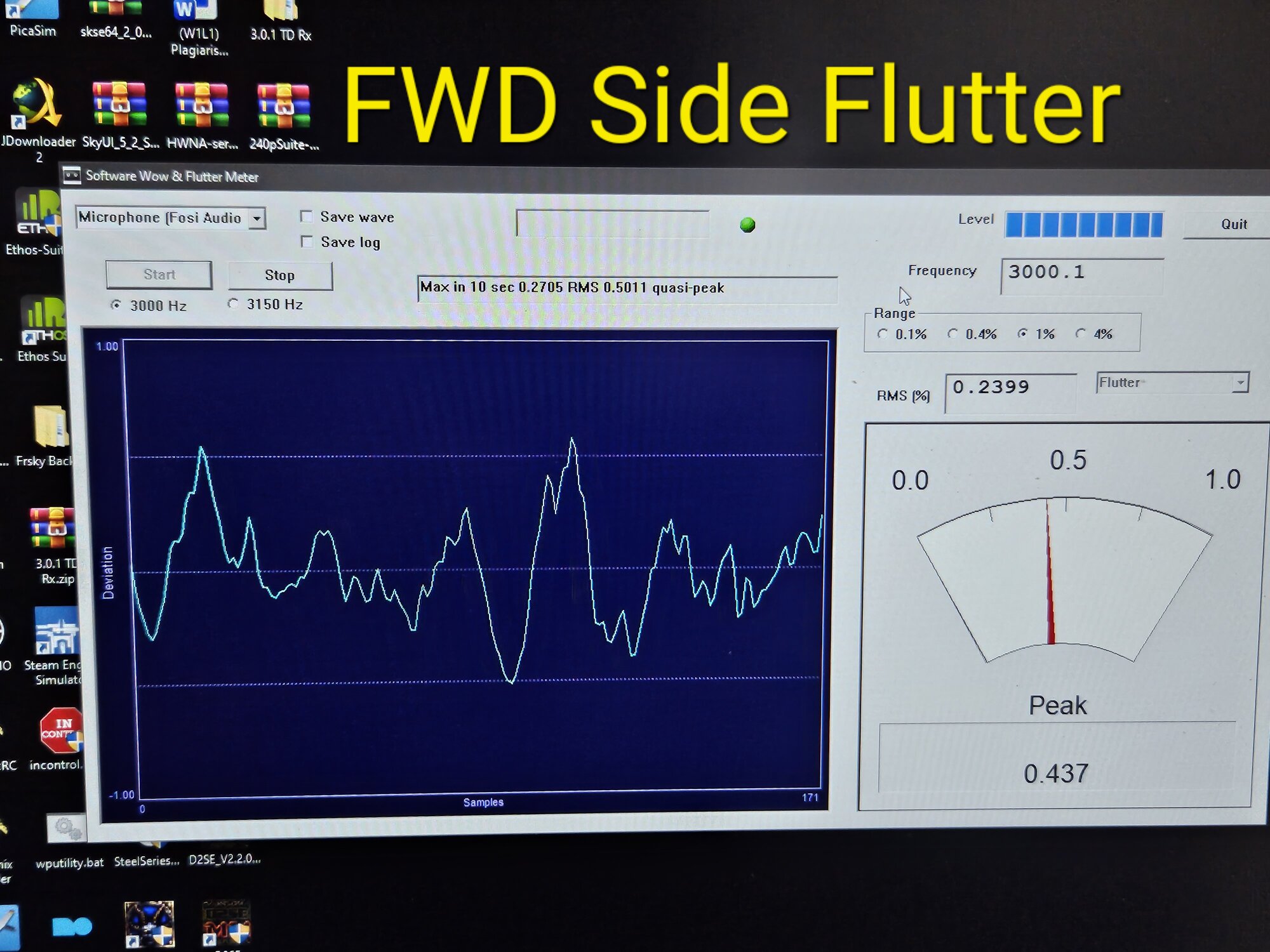

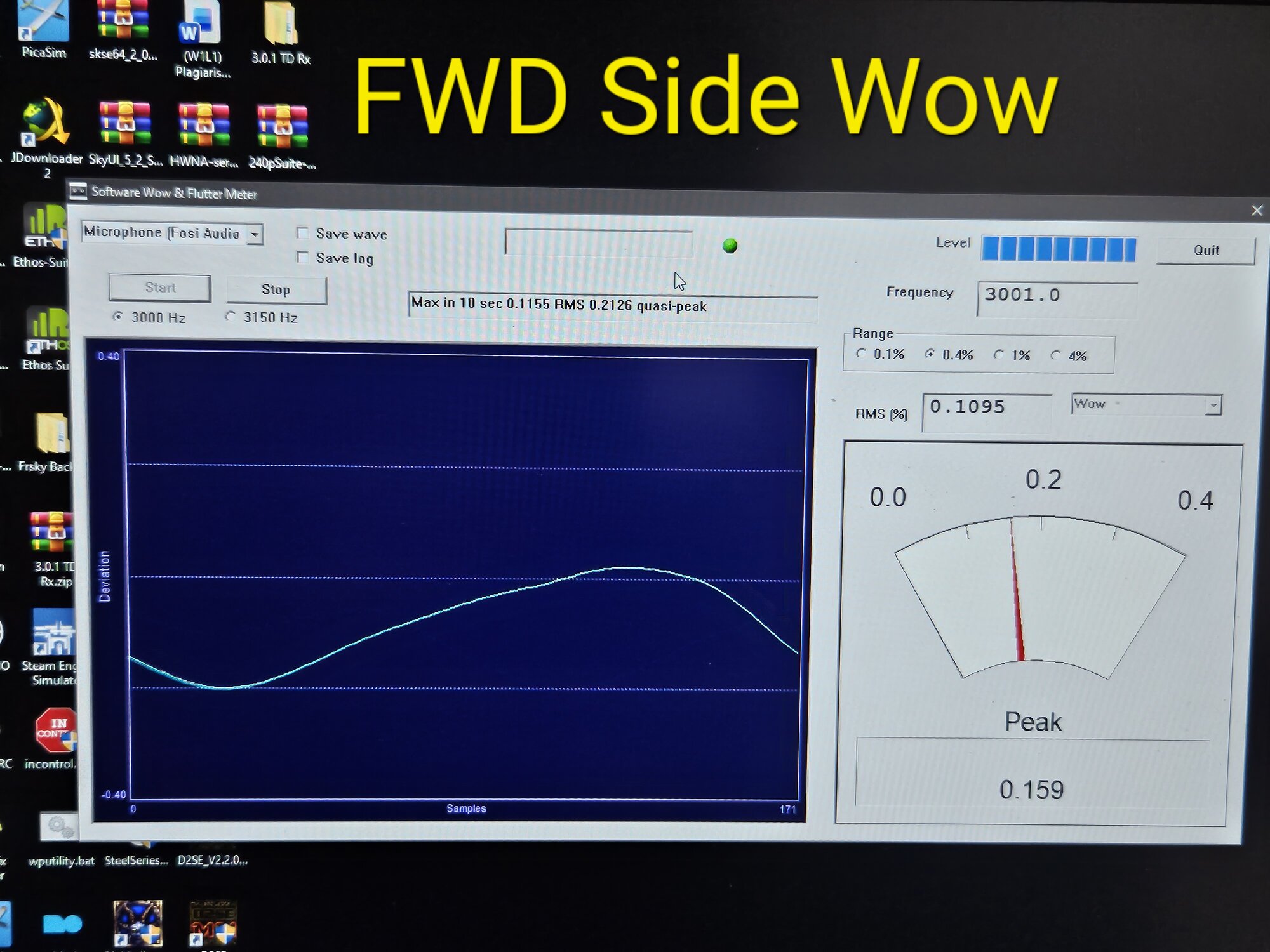

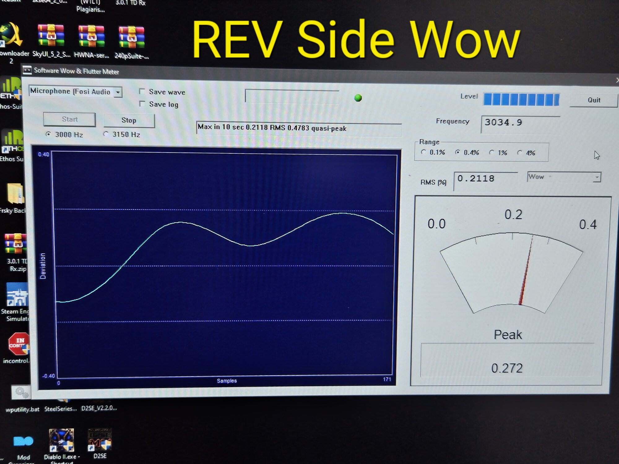

    I decided to use WFGUI to measure tape speed and check for wow and flutter values.I noticed that my previous way of measuring tape speed was off by at least 10Hz. The only explanation i can think of is that the grease on the capstan bearings caused speed difference and then i proceeded to unnecessarily etched capstans which causes more wow and flutter. Now i will need to somehow fix this issue because i can see that rev side isn't consistent. The tape speed on REV side is close to the acceptable range and is hovering around 3033Hz-3037Hz.
    I have attached photos of the test and i noticed that fwd side is more stable than rev side. During the flutter test i can see that rev side isn't consistent. I can see in the graph that sometimes there is a spike on it.
    The machine also struggle to pull through tape leader and i have to fast forward through it and then press play. this happens on both side of playback.

    W&F is indeed high on REV side (especially flutter). FWD seems ok. Would check the RMS value (DIN in WFGUI).

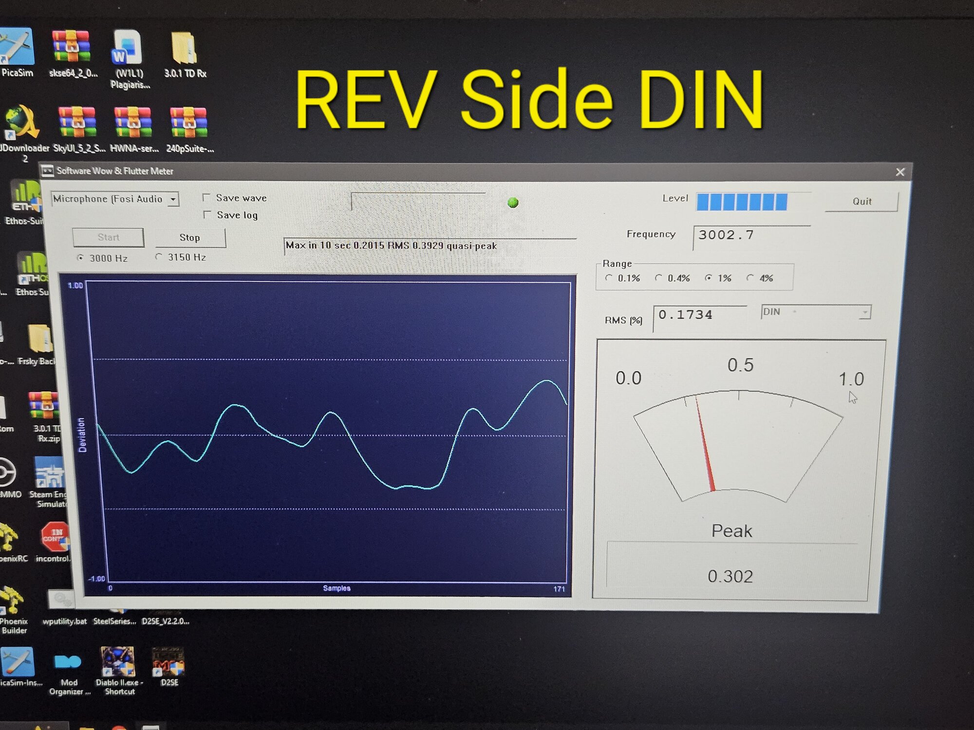

    Thanks for giving me a very comprehensive guide. I have followed your guide and it helped getting the tape speed to be back into its range.
    I have attached the WFGUI results photo on this reply. I don't really know much about RMS or quasi-peak but i think judging from the tape speed, i can see that it is more stable than before.

    The values look ok for both FWD and REV, these I would consider within spec. Speed difference is also well within the acceptable range at 12Hz.
    Regarding W&F, if you want to read more, a forum member has written a whole article about it explaining all the details here: https://reflectiveobserver.medium.com/wow-flutter-explained-31cc9495d24
    But to make things simple, it's the DIN figure we're mostly interested in (this is WRMS) and also if there are any sudden sharp peaks in the waveform.
    Of course there is an entire debate about what figures are acceptable, but that will vary a lot with type of music listened. Classical is extremely sesntive to even low amounts of W&F which won't be audible on most other genres.
