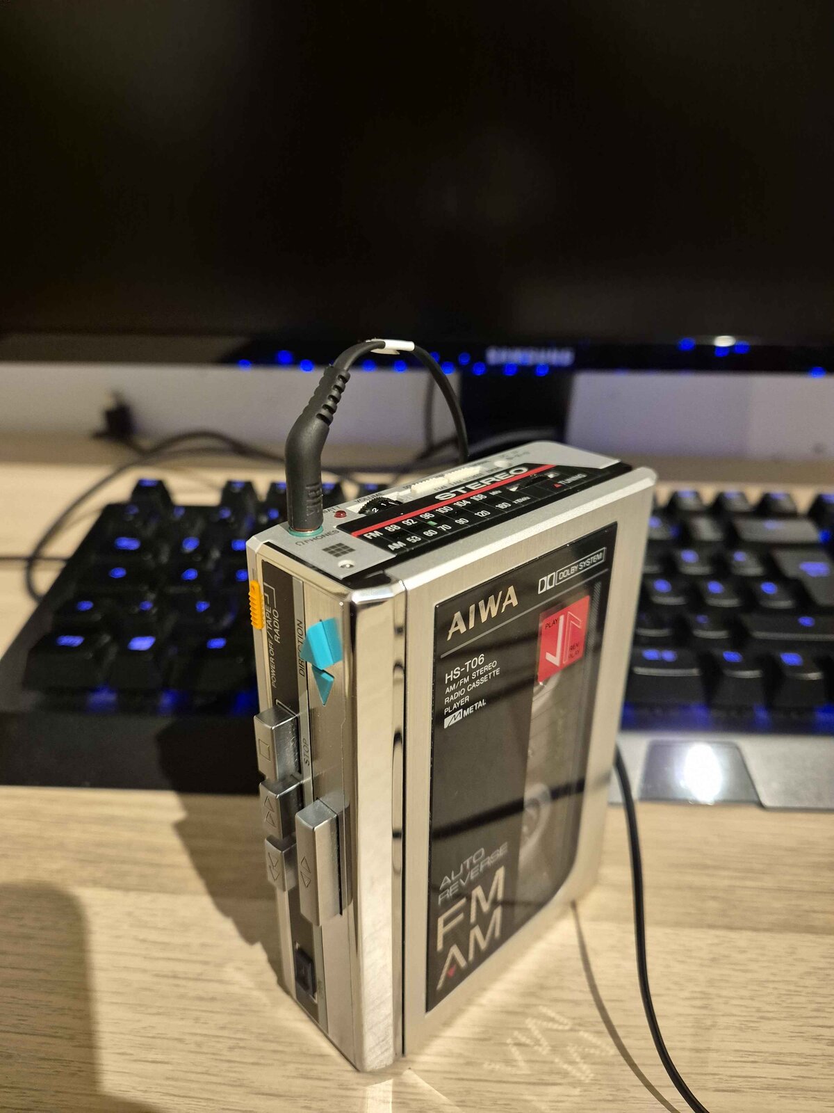

    as I already mentioned in my introduction thread yesterday, I just got my hands on an old Aiwa HS-T06 "Walkman" like device:
    It plays tapes even with it's original belts and switching between tape types and turning Dolby B NR on or off works just fine so far.

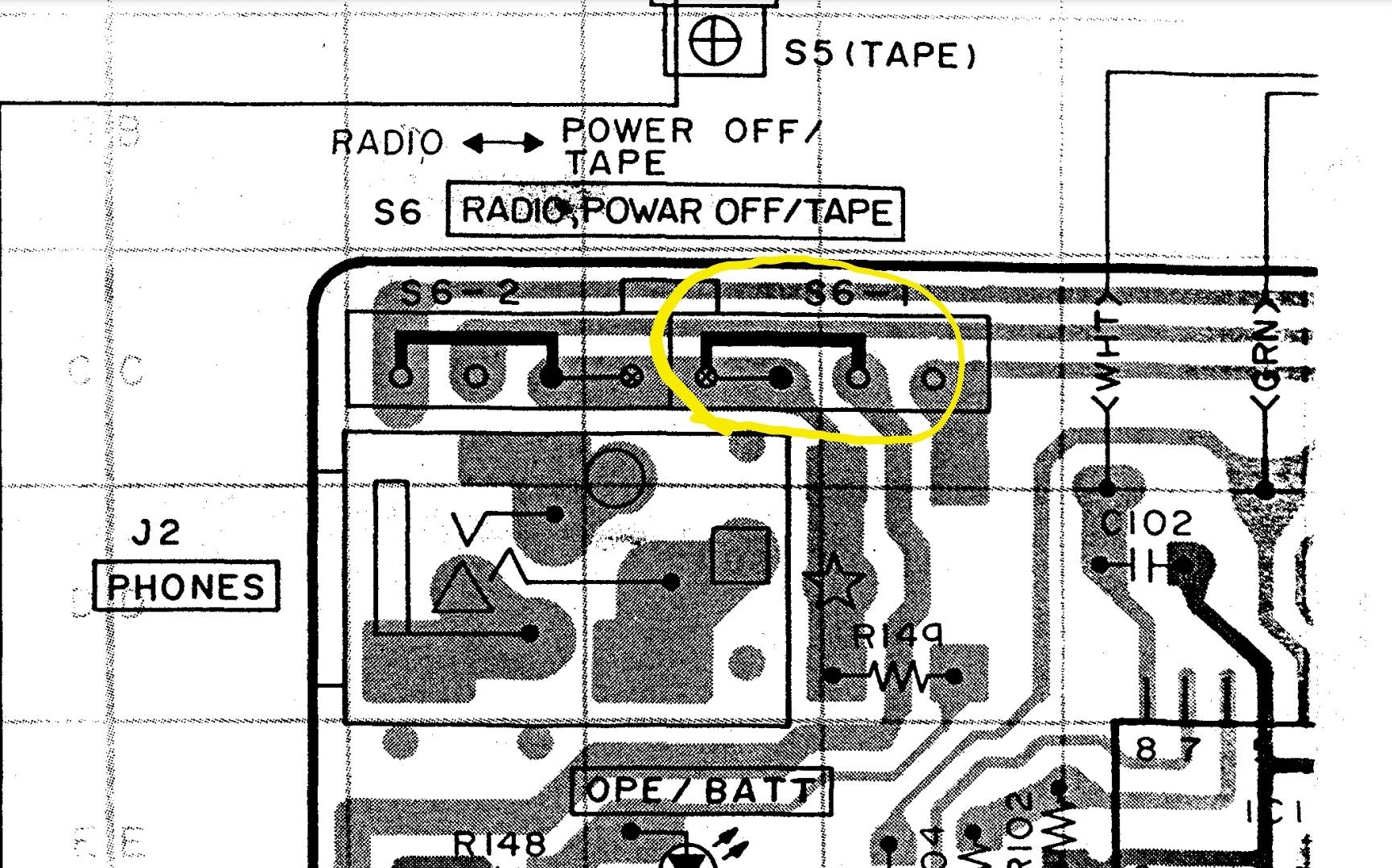

    Therefore, I now removed the plastic back cover of the Aiwa by removing the 5 screws as mentioned in the service manual (https://archive.org/download/manual_HST06_SM_AIWA_EN/HST06_SM_AIWA_EN.pdf) to get a look at the main board. Since the Walkman was apparently dropped at some point, I expected to maybe find a cracked solder joint on that switch.
    I therefore got out my digital multimeter and checked for continuity between the different pins of the radio/tape switch (S6)
    What I noticed here is that on the right part of S6, that being S6-1, I get continuity between all 3 pins all the time, no matter what position the switch is in. Could this be the issue?
    Only on S6-2, the continuity between the 3 pins changes when changing the positions of the switch, which results in only 2 of the 3 pins on the S6-2 part of the switch to have continuity.
    If I see it correctly, I should only have continutiy between 2 of the 3 pins on S6-1, too right?
    If this is the case, what would you suggest to verify that the switch is the actual cause of the problem or if it's something else further down the road?

    Okay, so I have to apologize since I was a little bit stupid here - actually I had the play button pressed all the time that I measured the radio/tape switch. When I release any tape mechanism function and therefore cut the connection at the leaf switch, the radio/tape switch measures fine with only 2 pins having continuity in each position, so 6-2 and 6-1 are both fine.

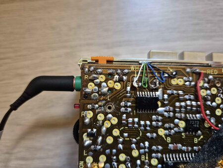

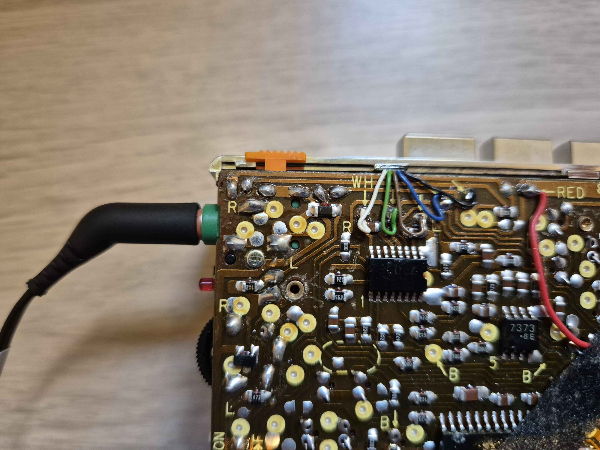

    Another thing is: I see several solder joints that look quite bad. Not in the way of having visible cracks, rather it's them just having not enough solder. I have read from similar observations here in this forum by the user Steve Grant here: https://stereo2go.com/forums/threads/repairing-mid-80s-aiwa-hs-j09-9-600-10-36-360.10445/
