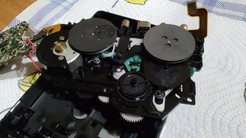

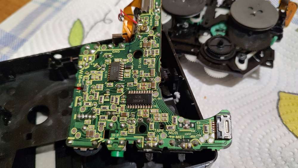

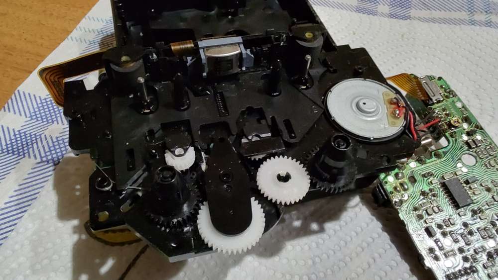

    I'm trying to fix this old Sony Walkman; I recently replaced the main drive belt, but I'm still having a problem with the autoreverse, which is behaving bizarrely.
    The sound quality isn't terrible, but it's certainly shaky (I'd give it a 5 out of 10). I'm attaching three photos and the results of a usage test where I highlight what the issue is.
    Pressing play with NO TAPE INSERTED
    Direction FWD
    Continuous play OFF
    WM keeps playing
    Direction REV
    Continuous play OFF
    WM stops after 1 second
    Tests with the SIDE A of a new, pre-recorded tape inserted:
    Trying to play the beginning of SIDE A
    Direction FWD
    Continuous play OFF
    It plays the end of SIDE B
    Sound is slightly distorted (w&f)
    Direction FWD
    Continuous play ON
    Trying to play the end of SIDE B
    Direction REV
    Continuous play OFF
    It plays the beginning of SIDE A
    Direction REV
    Continuous play ON
    Does anyone know what it might be?

  3. Black Fingers
    Black Fingers Active Member
    191
    Netherlands
    You might want to check direction switch S311....could be that this switch is not making good contact
