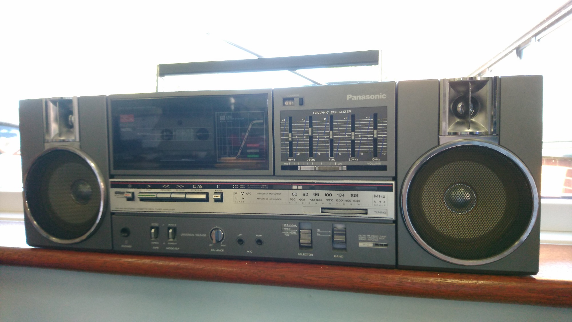

    And now... live... from Galveston, performing in the UK thanks to an international voltage selector... Ladies and Gentlemen... give it up for.... C3-P... oh sorry... RX-C45 ... yeaahhhhh..... 20180517_133532.jpg

    Boom! Working ok?

    Yup, once I altered the voltage selector. Only tested the radio so far.

    Such a good machine, how you like the sound? I think they are amazing for the size.

    All hail the mighty Aiwa... I definitely don't want to drop this on my foot.

    It is a nice beast, sure. The radio isn't catching on the channels properly, so I suspect that the radio side needs recapping. Also, the rewind on the tape is a bit weak, so that's either a belt issue or perhaps something else. That'll require investigation.

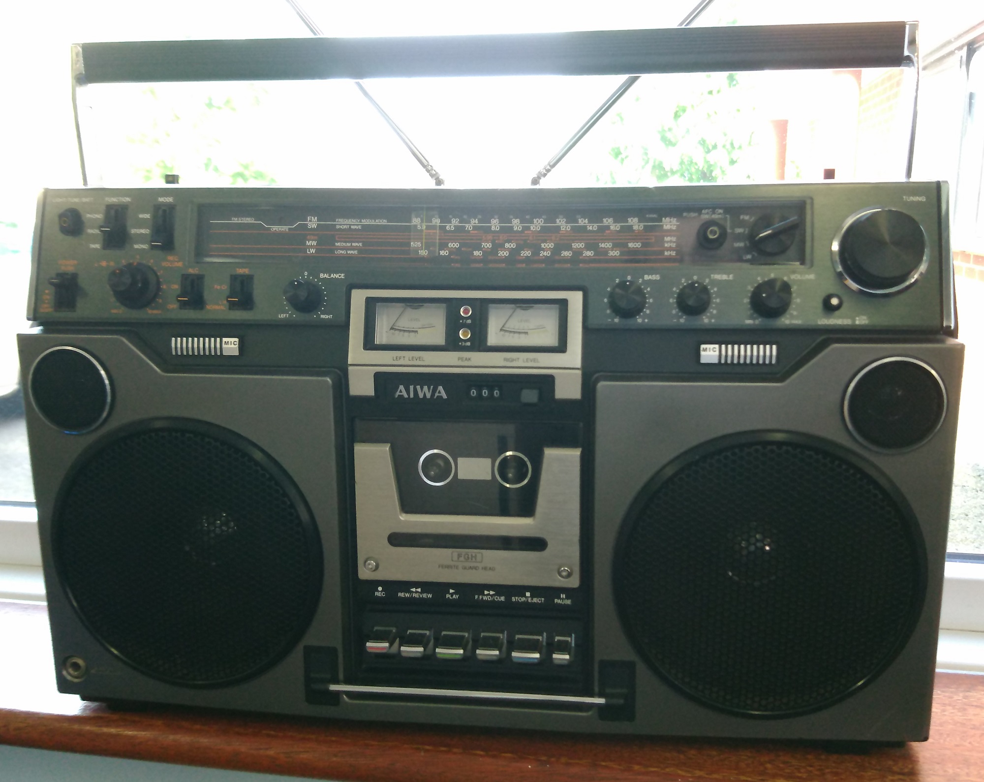

    The Aiwa is also having a radio issue. Reported on ebay as FM not working, but I got the slightest, fraction of a second out of it, before it immediately faded away, so I suspect a cap problem rather than an IC. Haven't tried the tape yet as I'm still at work. Likely approach to this will be to replace all caps and see where I go from there.

    If the problem is that the stereo light rarely illuminates, you can adjust the stereo pot which is located on the tuner board.
    Or the function switch needs cleaning...….. or possibly it has been damaged by internal arcing.
