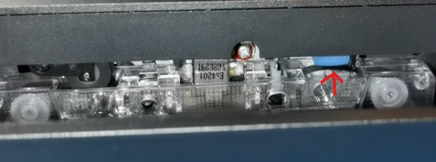

  10. HelloDD
    HelloDD New Member
    CN
    The problem is that when switching play/FF/REW, the tape will be attracted by the permanent erase head, causing serious erasure.
  11. Anthème
    Anthème New Member
    21
    france
    What unit is that ? On mine, the PM isn't as close as this one in the photo, but yes. Seems important no to mess around with PLAY/FF/REW without hitting stop.
    By the way, I made a test. On my Sony DC6 I recorded a 16khz signal on a tape. Next I used a spectrum analyser to report the level of the 16khz signal played in my D6C.
    I then played it about 20 times in my Sony TCS 430, and i was fiddling a lot with FF/ REW.
    Next thing I did was do the analysis again with the D6C only to find nothing had seem to change, the level at 16khz stayed exactly the same.
    So that's cheering me a bit, even if my measurements might have been done the wrong way....
    Anyway
    Cheers !
