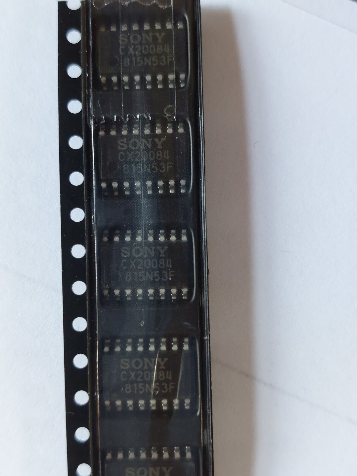

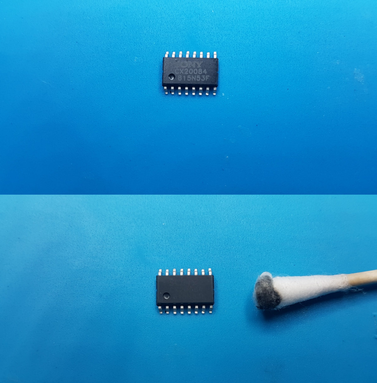

    @Silverera I'm afraid it's 100% fake. Take one out and use acetone, if the cotton swab looks like the picture below, don't even solder it. These are random repainted SO16 IC's. They heat up instantly and the only thing you can do is damage the device.

    Well that's something at least. Way better to avoid wasting time and effort putting in a dud IC which could cause damage to other subsystems. As mentioned before in this discussion running your D6 on batteries and not cheap switch mode power supplies is also a good idea.
    I might try the acetone swab test on mine out of interest.
