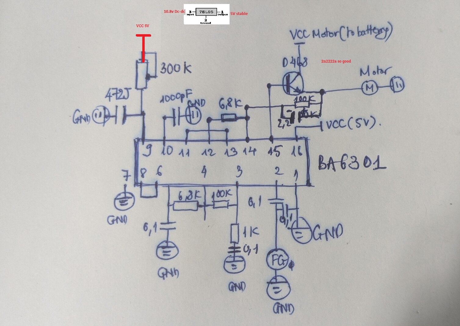

    My parts ( HAS BEEN EDITED 21/4/25 becaus there is confusion at pin 9 and add more detail )
