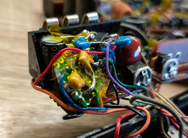

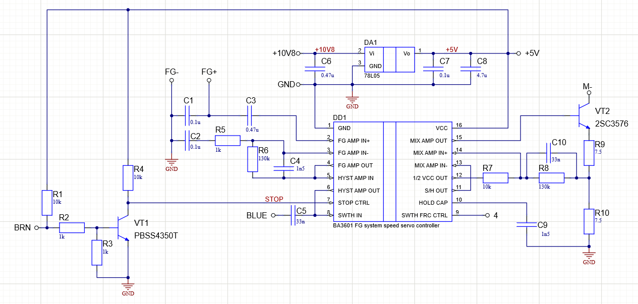

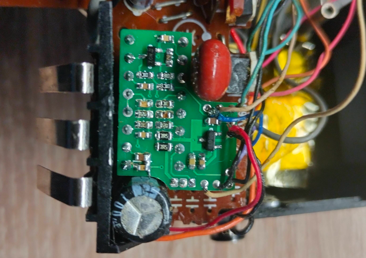

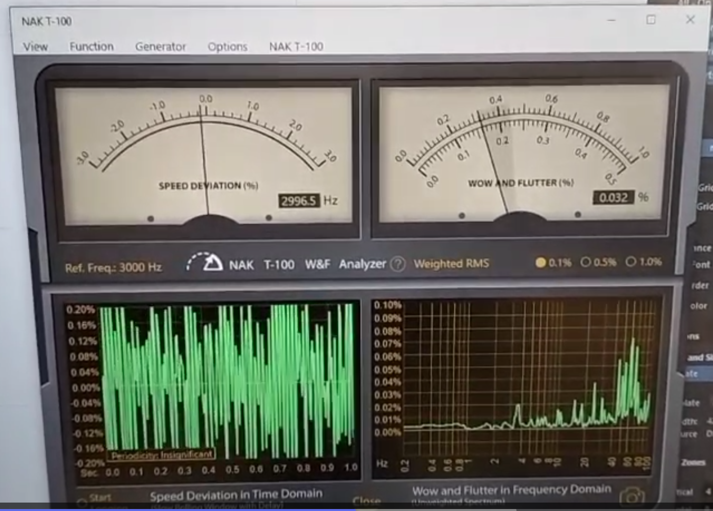

    Hello there! Successfully changed dead CX20084 to BA6301, quartz lock and speed tune mode also works, Wow&Flutter is about 0.03-0.04 RMS - perfect!. Big thanks to Hn141977 for placing here information about this IC! Did some changes in schematic, using datasheet and service manual posted here as reference. After successfully testing I designed a little board that can be installed into D6C after removing some original components used by CX20084. After testing I find a little error in PCB, will fix it later and post here a gerber-files of PCB and installation instructions. It would be very interesting if someone try to repeat my way - if this solution will work on another unit, I would be happy) Here on pictures is NAK T-100 measuring W&F with quartz lock enabled, early working prototype, final schematic and custom board

  20. Emiel
    1,115
    0.032%? This is top cassette deck territory and would make it the best performing cassette portable ever! Well done.
