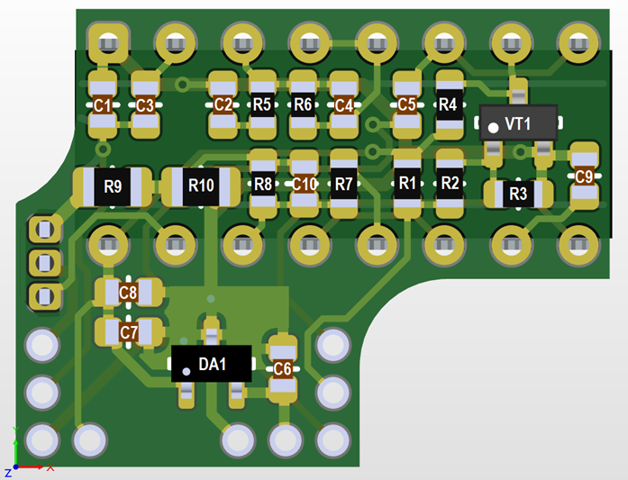

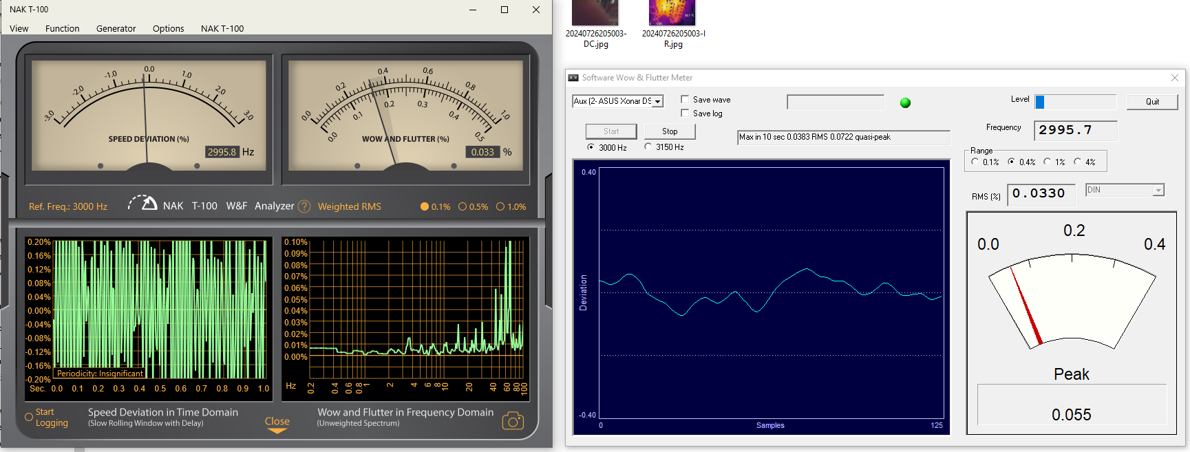

    Here is corrected gerber files, as I promised. And some little more detailed W&F measurements with quartz lock on, and pictures of replacement board from infrared camera after playing a tape about half on an hour. BOM and assembly drawing is not ready yet, will post them later with installation instruction witch I'm currently working on.
  2. LeKos
    LeKos New Member
    5
    Russia, Moscow
    Thank you! Actually, I have two units - D6 and D6C, and W&F is the same on both of them, mayby slightly better on D6 because of it's small usage. D6C has significantly signs of wear - I think, it's really been used by journalist, because pause button surface is polished.

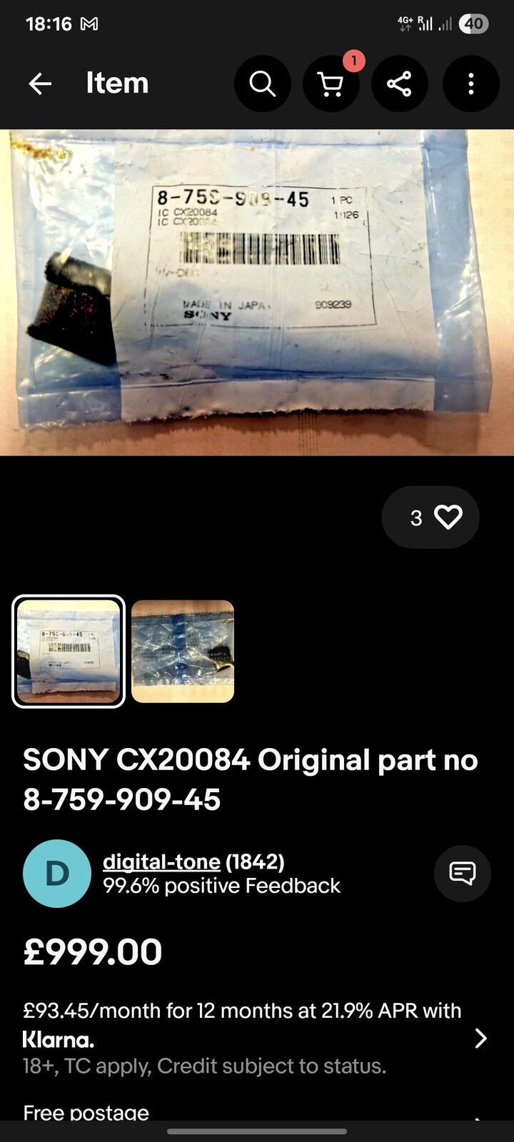

    Anyone Screenshot_20250801_181642_eBay.jpg looking for an original chip?:)
  5. Valentin
    2,009
    That's funny, that sealed IC has only sentimental value if one wants to collect it. Is there anyone collecting NOS parts (without the intetion of ever using it) ? I wonder...
    For everyone else, donors can be bought much cheaper (remember donor doesn't have to be a D6C), then it's the new Chinese board alternative and the BA6301 solution presented by @LeKos.
    With 3 significantly cheaper options available, I honestly fail to see any value at all in this listing apart from potentially being a collector's item.
    Even a couple of years ago when I could still get these genuine NOS CX20084 ICs, they used to cost less than 1/10 with shipping included.

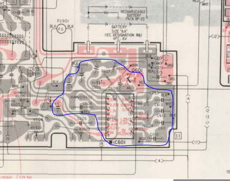

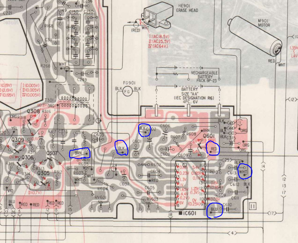

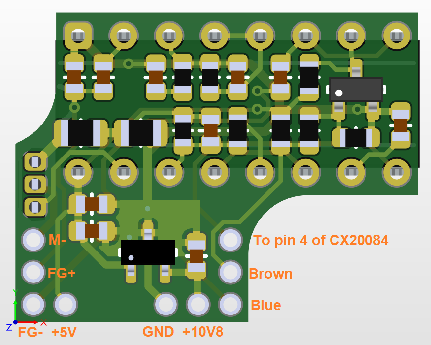

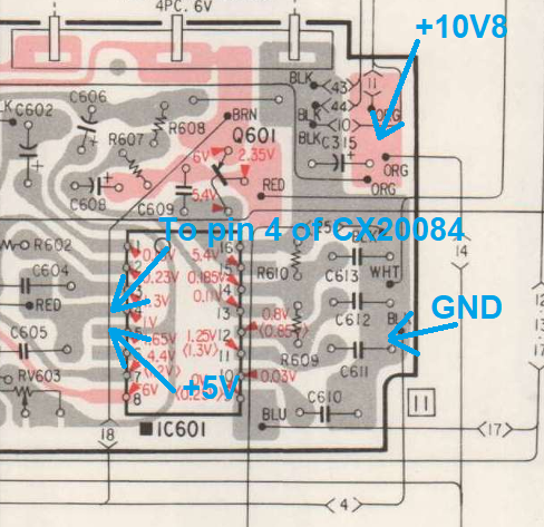

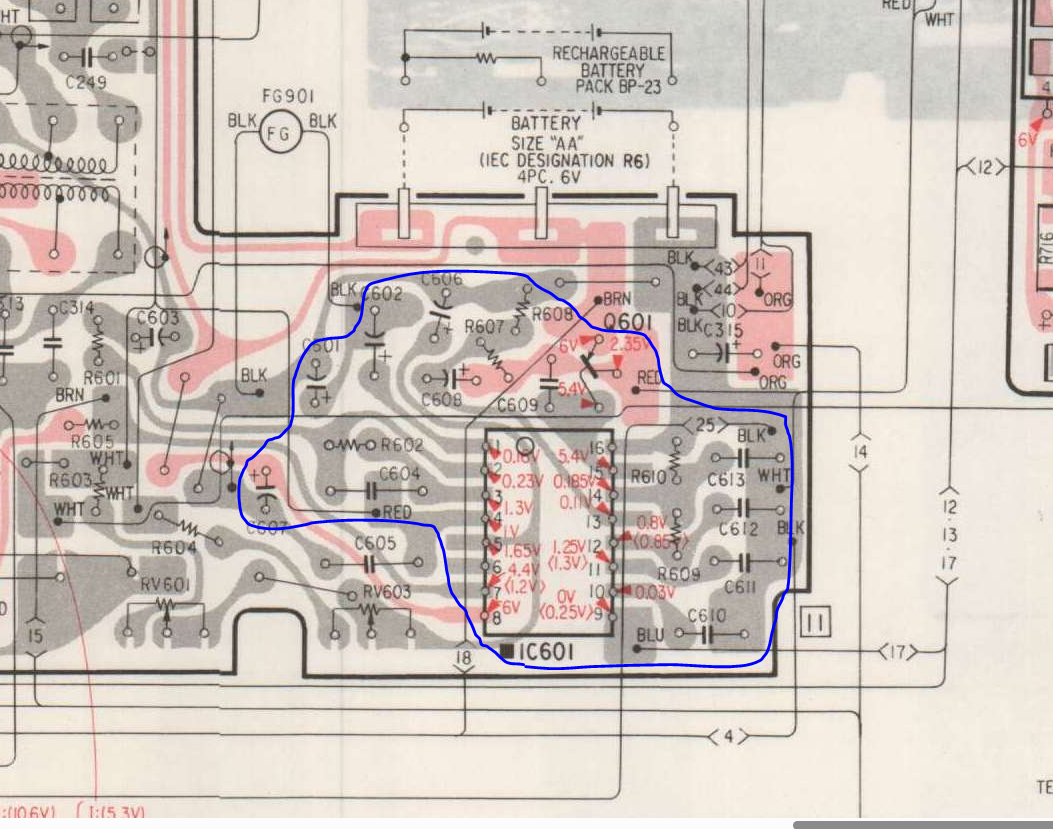

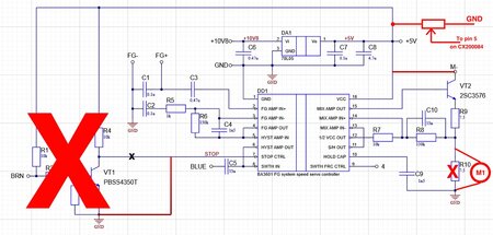

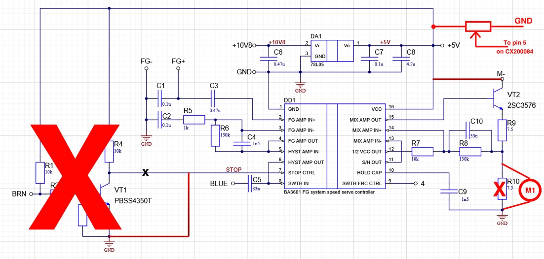

    Making an instruction actually took more time than I suspect. Now I think it`s ready, but maybe I missed something, so if you have any questions, I will try to help. So…
    Desolder:
    Components within blue line.
    Wires from motor (red and white).
    Wires from FG coil.
    Brown wire #15.
    Blue wire #17.
    Also remove R603, R604.
    R604 need to be replaced by 300k resistor, R603 need to e replaced by 330k resistor.
    Existing wires soldering:
    Red wire from motor solder to the same place as brown wire #18.
    Wires from FG coil connect to "FG+" and "FG-" pads on replacement board.
    Blue wire #17 and brown wire #15 connect to "Blue" and "Brown" pads on replacement board.
    White wire from motor connect to "M-" pad on replacement board.
    And there are some new wires needed:
    Wire from "GND" pin on replacement board solder to the same place as black wires #4, 25, 43, 44.
    Wire from "+10V8" pin on replacement board connect to the same place as orange wires #14, 11.
    Wire from "+5V" pin on replacement board connect to pad for pin 5 of IC601.
    Wire from "To pin 4 of CX20084" connect to pad for pin 4 of IC601.
    And you need to add a 270p cap between pins 5 and 8 of IC701 on Auto OFF board for proper working of quartz lock mode.
    After installation adjust RV603 with speed tune set to on and RV602 on center position.
    Adjust RV601 according to minimum W&F with speed tune set to off. This is the same adjustment as described in "Tape speed adjustment" in service manual, but I`m not sure about proper speed. In my unit, with "Tape speed" solder joint removed, I have speed about 3240 Hz on 3000 Hz test tape. Be careful - instead of original, in my current schematic this adjustment have smaller area, in witch PLL lock works properly and stable. If you can't obtain stable small W&F, try to increase R715 on Auto OFF board, decreasing additional capacitor's value from 270p. I have the same stable results with R715 changed to 3.3 MOhm and 120p capacitor. Also you can try to increse a value of R603 and decrease RV601 - theoretically it should simplify the adjustment.
    All of this is more tricky than original procedure, and I can`t guaranty that it will work. In my case it works perfectly, but if in you case it don't, just replace R603 by 300k, remove "Tape speed" solder joint and adjust speed by RV601 to obtain correct tape speed. Quartz lock will be disabled, but unit should work stable.
    In attachment there are pictures with instructions, BOM and gerber-files. Gerber files are the same as before, attached them here so that everything - instructions and gerbers - was in one place.
    Deb64, Chip Spencer, Hn14197 and 2 others like this.

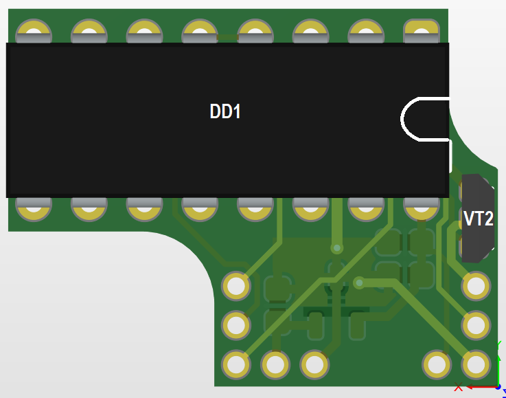

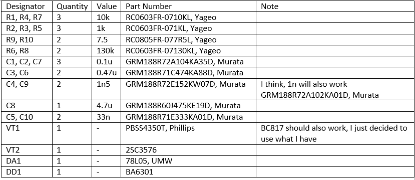

    There is also a Chinese board available, but you need to remove quite a few components from the board to install it.
    It's available here, you will need a proxy like SuperBuy: https://www.goofish.com/item?&id=766454209480
    This is a something you can buy directly, but a bit harder to install compared to the BA6301.
    Not sure if this BA6301 board is available to buy (you can ask) or you need to make one yourself.
    I am also considering to design something with discrete components, but that would need to be tested first. So it may take a while.

    There's only 2mm difference in chip dimensions between the two. Additionally, for the DIYer who likes to assemble their own boards, the tiny BGA chip is a serious challenge.
    Valentin likes this.

    Don't bother, I ordered it via SuperBuy and while it "works" it is totally unstable. Let me say, I am working with a Supplement 2 Green PCB (blown CX200084 which I removed) and the board was designed for the earlier through hole PCB. Whatever, sometimes it just works but then suddenly it will start a rapid pulsing in the speed that just destroys the sound.
    No schematic is provided but it is basically a LeKos design simplification, even the component numbering matches. The designer made some interesting design choices that are giving me fits, e.g. there is a potentiometer on the board which is set to provide a 3.65V bias for the speed adjust circuitry on pin 5 of the now removed CX20084. The Sony schematic says this should be 1.65V (LeKos connects it to 5V) but this design requires 3.65V or the motor crawls. That pot seems to be related to my instability because adjusting it the tiniest fraction will stabilize the speed but never for long. In addition this board has no logic for auto-off (pin 7 of the BA3601 and CX200084) so REW without a tape just runs forever. Finally the transistor driving the motor sits around 85C during operation. It is labeled "1P" so no idea what transistor is being used.
    Anyway, what I WILL say is the PCB is TINY... easily fits below the PCB alongside the silver DC-DC converter at the edge of the deck OR even below the DC-DC converter. Shame I can't get it to work and I can't contact the Chinese designer for help.

    Here's the modified LeKos schematic and I am concerned with the relocation of the motor. LeKos had the motor between collector and 6V(EDIT: I originally said 5V). This schematic relocates it as shown where it replaces the second 7R5 resistor. Am I right that this could make it harder for the BA3601 (pin 15) to saturate the transistor? Could this be some part of the overheating of VT2?
    You can also see the trimmer used to bias the speed control logic that was connected to pin 5 of the CX00084. This works for a while but then instability breaks out. Adjusting this pot by the tiniest fraction stabilizes it but then it drifts again.
    Finally, I dread deleting the ShutDown logic on the left? Won't the motor draw a lot of current at the end of a tape in FF/REW, even more overheating?
