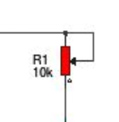

    This I'm sure has been answered before if it has I'd appreciate being pointed in the right direction.
    What does the object in the diagram signify?
    Thanks in advance
    Tim
    4,027
    It is a variable resistor alternatively called a potentiometer. They are often used as volume controls but have other uses. It has been wired like that so you don't get a complete open circuit if the contact lifts off the track as it is adjusted.

    Ah OK. Thanks. It was in a diagram for a low pass sub filter. If I post the full image I don't suppose you mind labelling it would you?

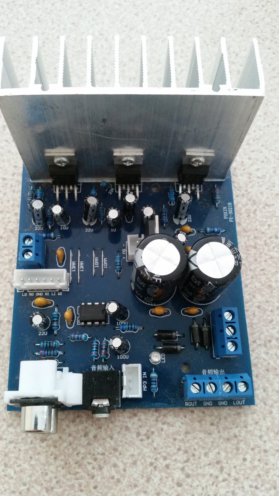

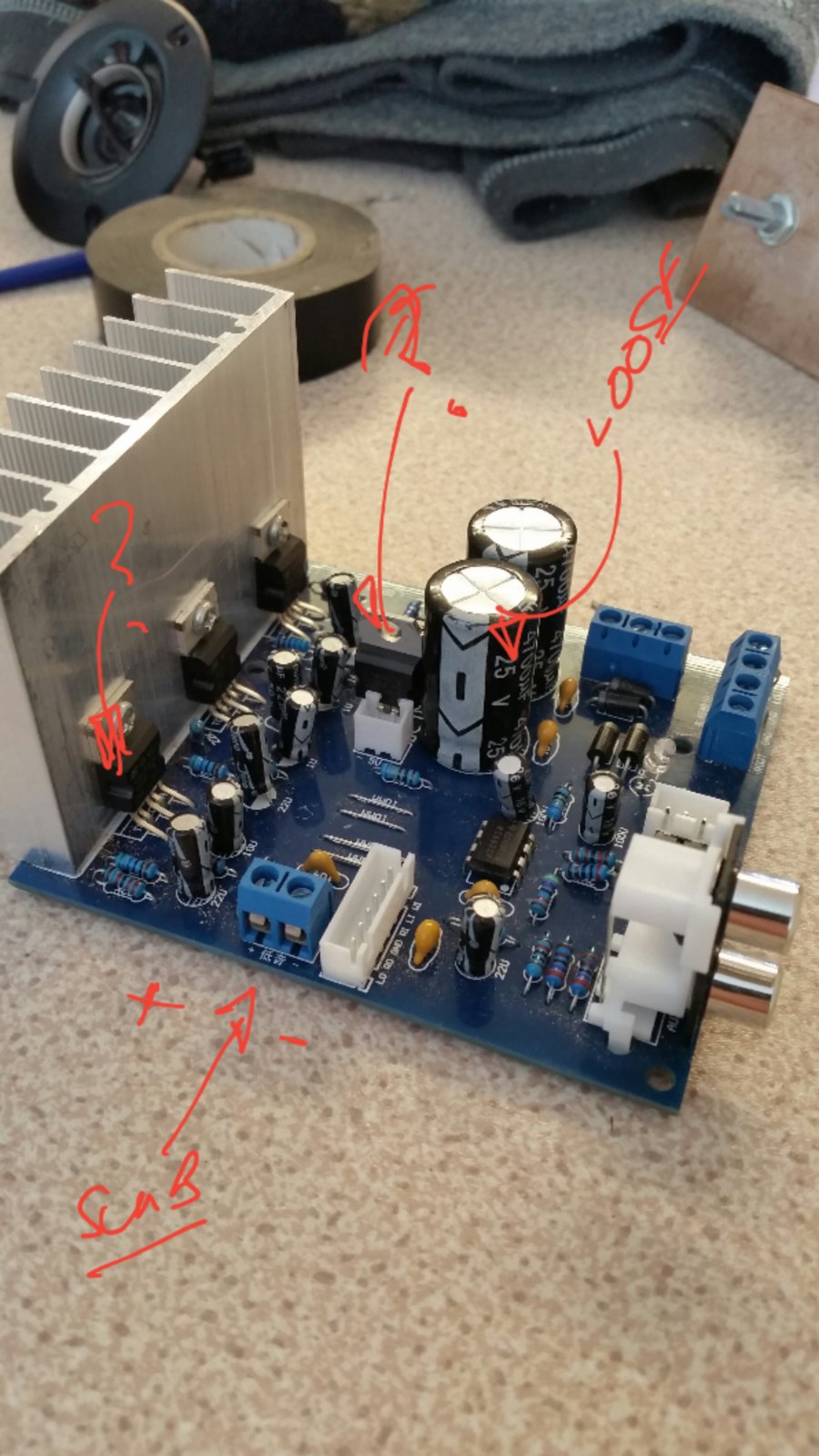

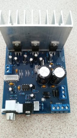

    Thanks for your help. I'm primarily concerne with the sub circuit as I'm getting no sound from it at all. Have tried a variety of speakers but they just sit there and hum.
    I've marked the sub outlet and question marked the thing that's attached to that circuit I assume it's a transistor.
    Also the large 4700uF cap is loose but still connected..... I think!

    I thought you were going to post a circuit diagram. If you can identify the part number of the three 5 legged ICs attached to the heatsink (or post a close up photo) showing any manufacturers markings I could probably find a manufacturers data sheet which usually gives example circuits.
