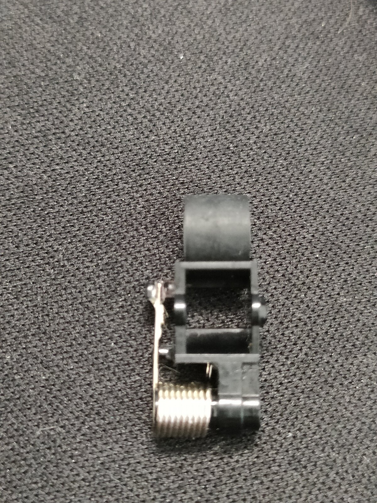

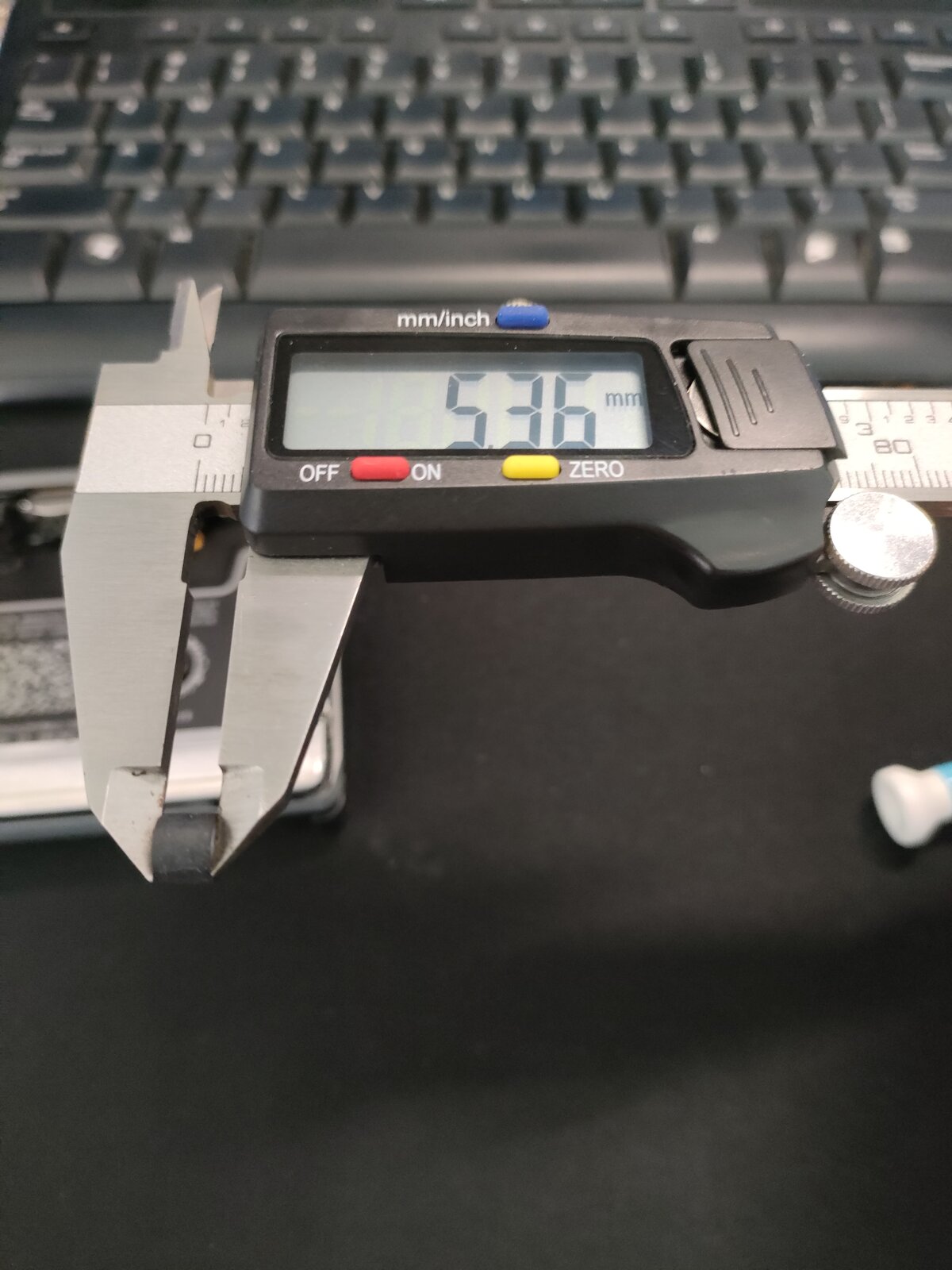

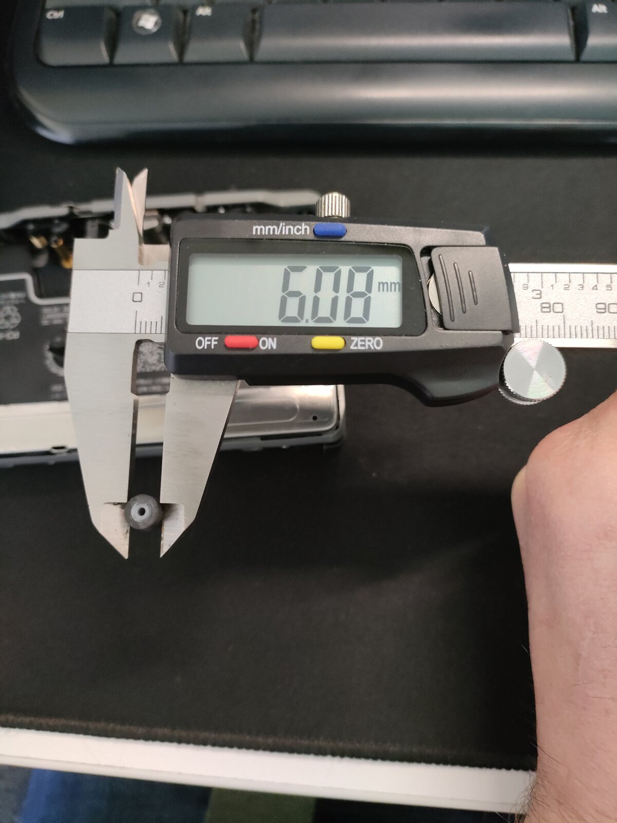

    Hi Valentin. I ordered some 6mm x 5mm x 1.5mm from China and I recieved the incorrect size: 6.22mm x 5.38mm x (not sure inner diameter but looks ok)
    The problem is because the full height is 5.38mm (0.38mm above spec) it doesnt physically fit. I am pretty annoyed. It seems to be not only the rubber protruding past 5mm but also that plastic inner piece so there no way to slice anything off.
    I have a feeling I wont be able to get my money back on these too as its hard to prove they are the wrong size. Any one who reads this, be weary of ordering pinch rollers from China as the dimensions are far from accurate
    I took the existing one out by the way and outer diameter 5.55mm and full height 4.92mm. Im not sure if that 5.55mm tells us they have worn down 0.45mm or not. Anyway not much I can do until I order some more reliable seller
  9. Valentin
    2,049
    Only potential solution is to sand the plastic hub, 0.2mm on each side, assuming the hub is significantly taller than the rubber.
    In regard to dimensions, height has to be a bit smaller than the actual specification, since there needs to be some play in the bracket.
    The 5mm is supposed to be the height of the bracket, while 0.08mm is the allowed play.
    Same thing goes for the pin, hole has to be a little larger than the 1.5mm pin to allow a tiny bit of play.
    As for OD, that usually won't match exactly, but would expect it to be closer to 6mm (like 5.8-5.9mm for example).
    That 0.45mm less may be the reason why tape doesn't have traction at the roller, since these rollers don't have a lot of tension to begin with.
