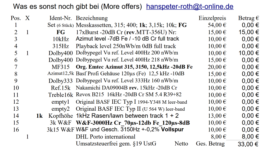

    As far as test tapes go, you can get one from HansPeter Roth, see the attached image. You need tape at the position 3. They're nowhere near 60euros (for just 1 tape) and are very good tapes.

    Hi Valentin, Thank you again for the great advice! I will get the Azimuth test tape. Is this the one I need to check the waveform with the supply roller? or can I use the 3000HZ test tape I got from fix your audio for this? If the w/f is better with the supply roller disengaged, I think this is a case for a misaligned supply roller?

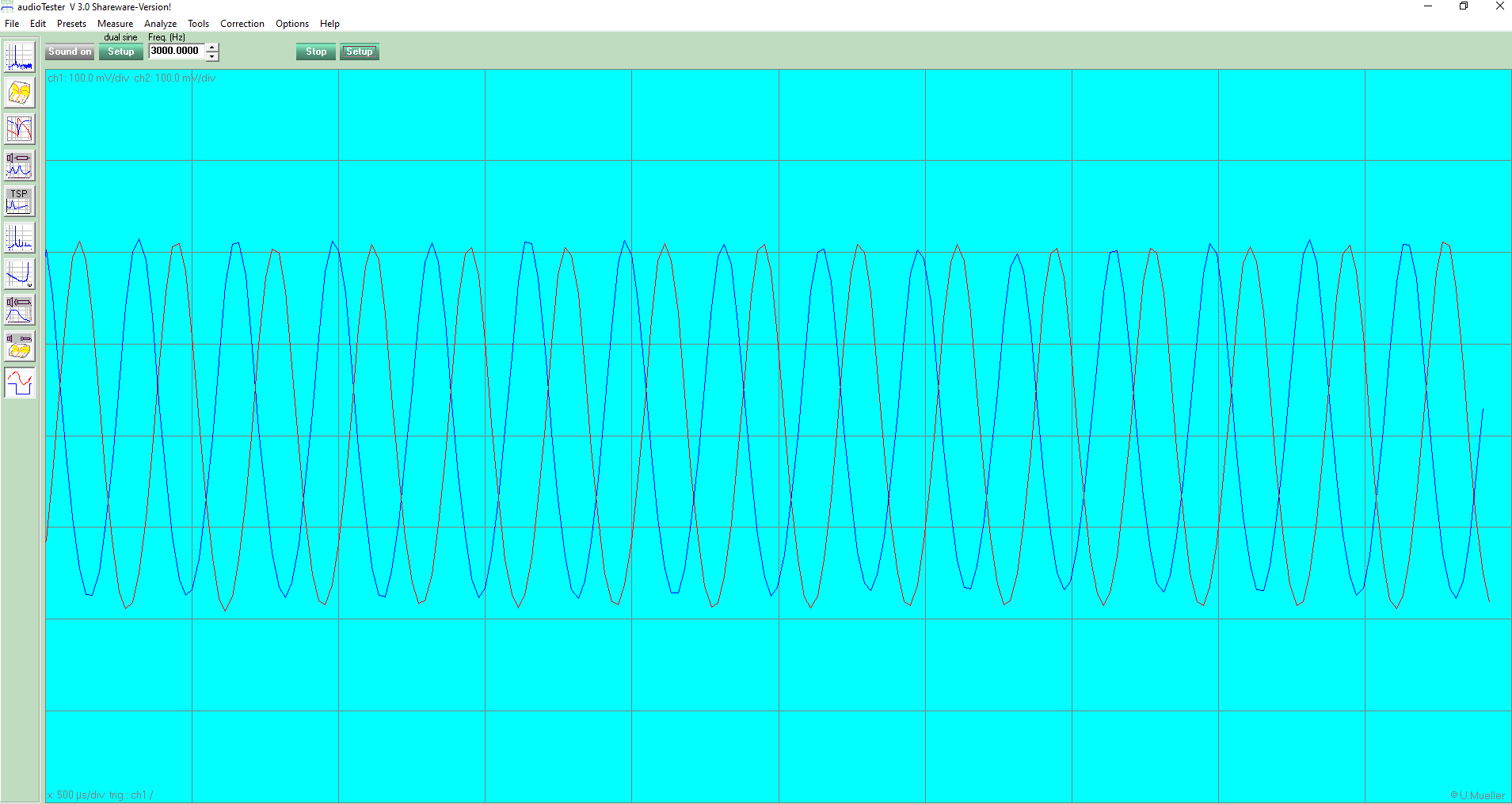

    I have also looked at the waveform of the 3 khz signal with software with the supply roller on and with the supply roller disengaged. Please see the Screenshots, i don't know if this means something but there is a change. i have ordered a 10 kHz azimuth cassette.

    If the W&F doesn't change it's good. Fact speed changes is likely from the extra drag, but would ignore it for the time being.
    As far as test goes, you can do a rough measurement with the 3kHz tape also, but this has 2 problems:
    - the frequency is a bit too low for this measurement;
    - it's not recorded as a full track (with mono head), so any phase differences that existed on the original recorder will exist on such tape;
