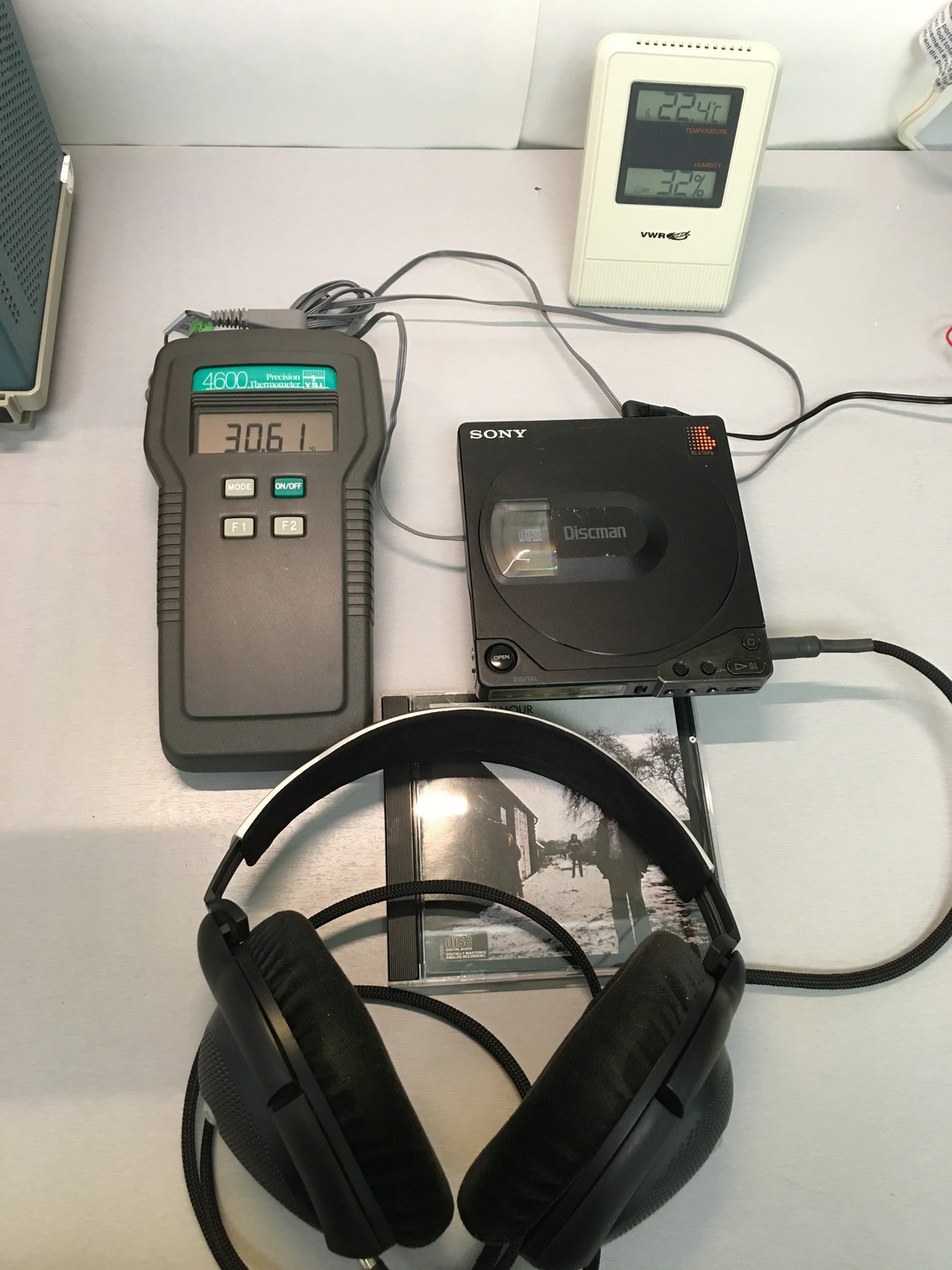

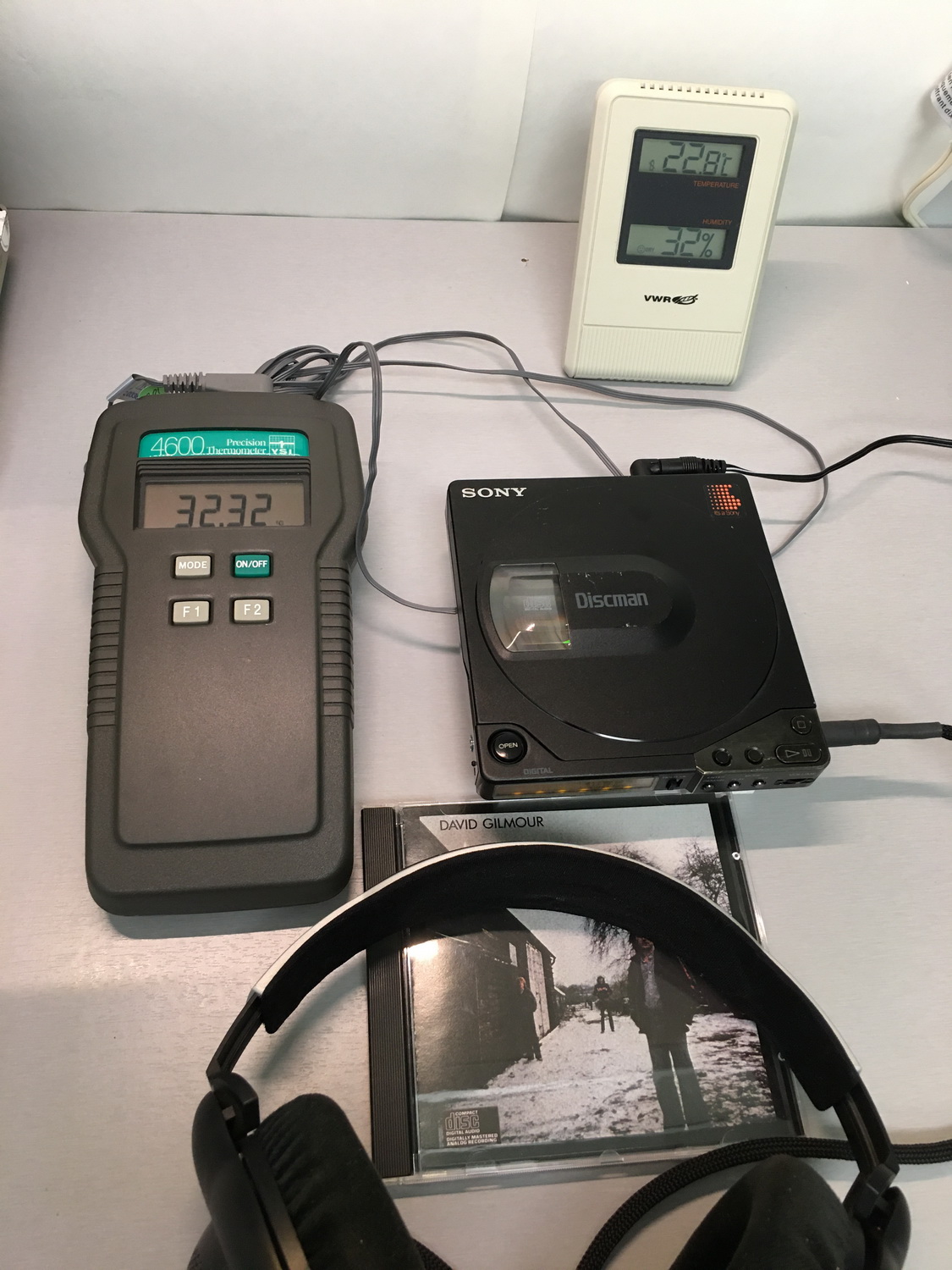

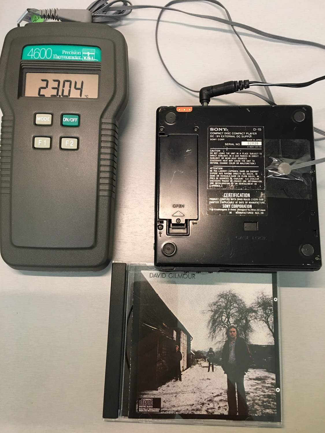

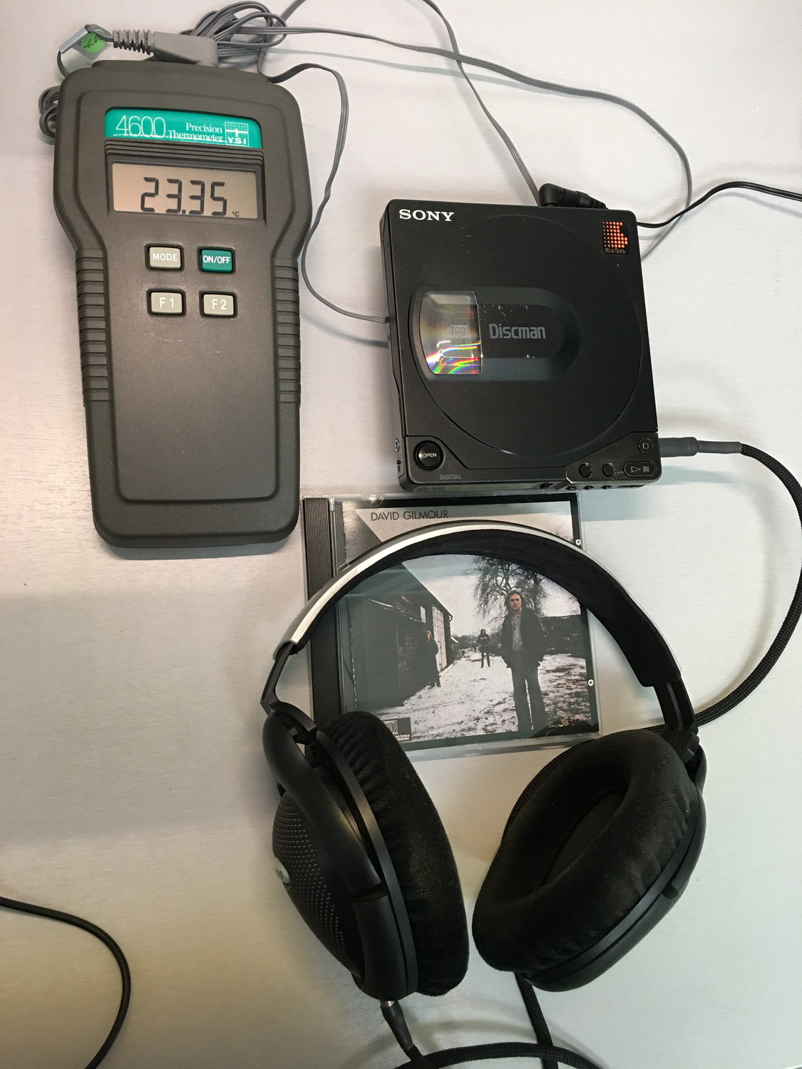

    Flat-surface probe attached direct to the metal bottom of D-15, Red-Book CD put on infinite replay, 120Ohm Sennheiser HD-570 plugged in, volume set at high but still bearable volume of '4':
    After an hour of play temp rises from 23C to 30.6C, in another hour it reaches 32.3C and stays there. Even without a probe you can easily check if your Discman-Baby has a fever, i.e. hotter than 37C, as all mommies do... with a palm of your hand
    But from your observation on flickering display it is a safe guess that there is a problem with Discman's power supply, you should get a regulated power supply and start poking around Discman's voltage regulators and DC-DC converters. Start with @Recaptcha suggestion, those transistors do most of the work, get hot and go bad often. Later model, D-250, got this part redesigned and upgraded.
