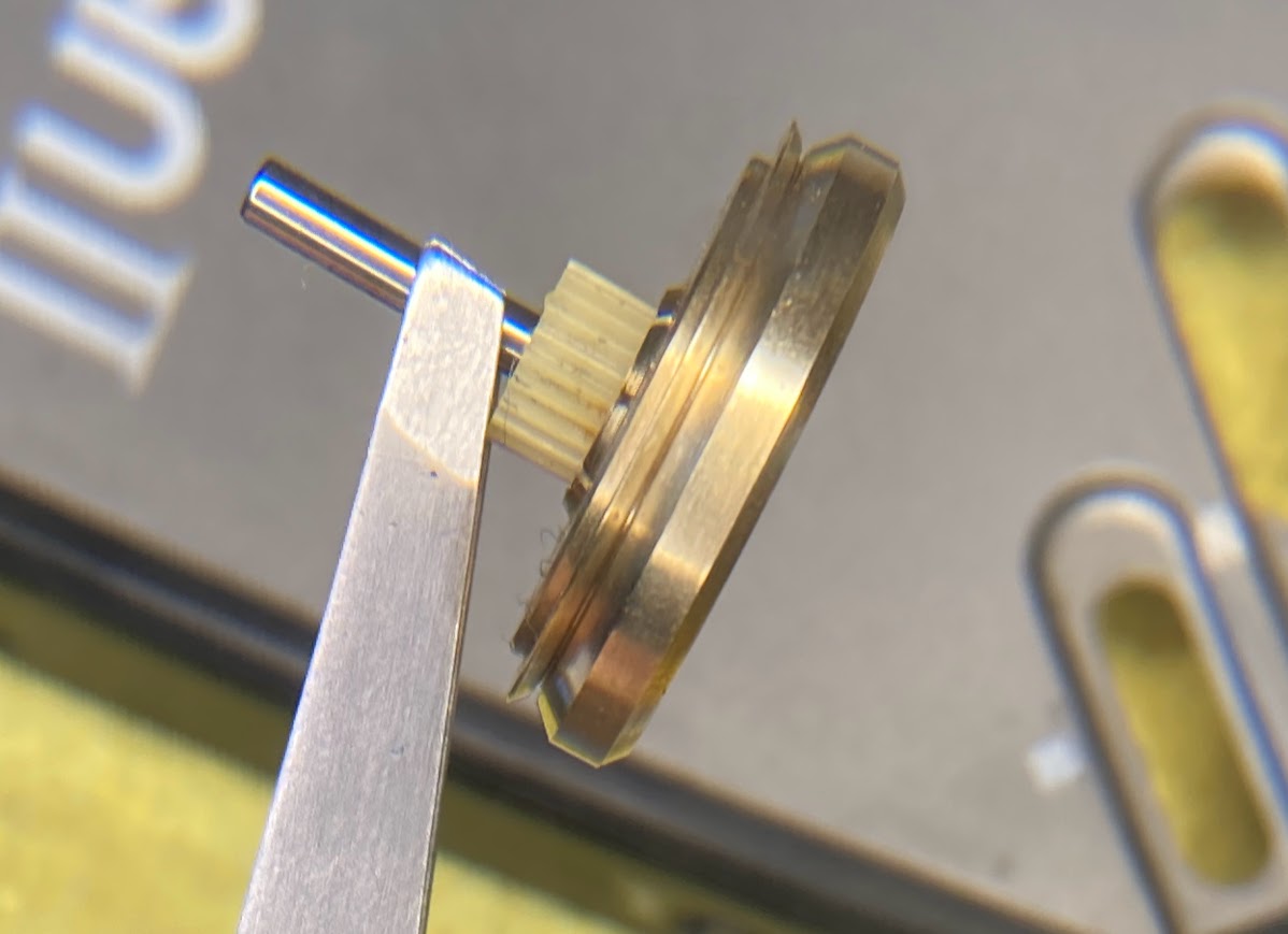

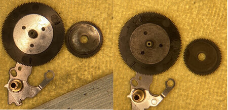

    Center Gear & Clutch: This unit has that thick plastic center gear and is not cracked. I still completely disassembled it and polished the clutch to remove all patina, just in case.

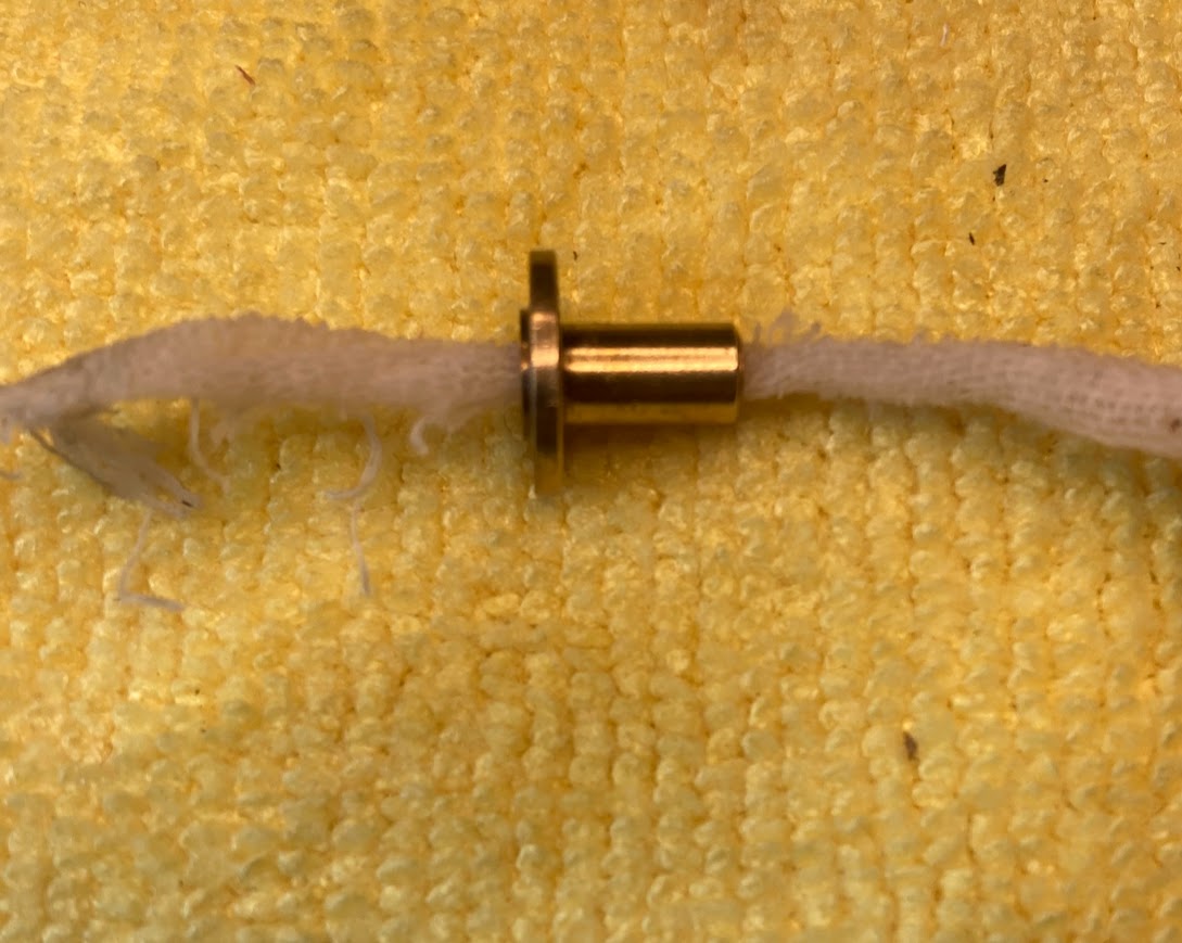

    Mechanicals: Cleaned and relubed the capstan bearings, greased the appropriate points, and added a few drops of oil to the motor shaft.
    Belt Path: Polished all surfaces that interact with the belt. The transport runs whisper-quiet and feels mechanically excellent.
