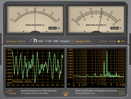

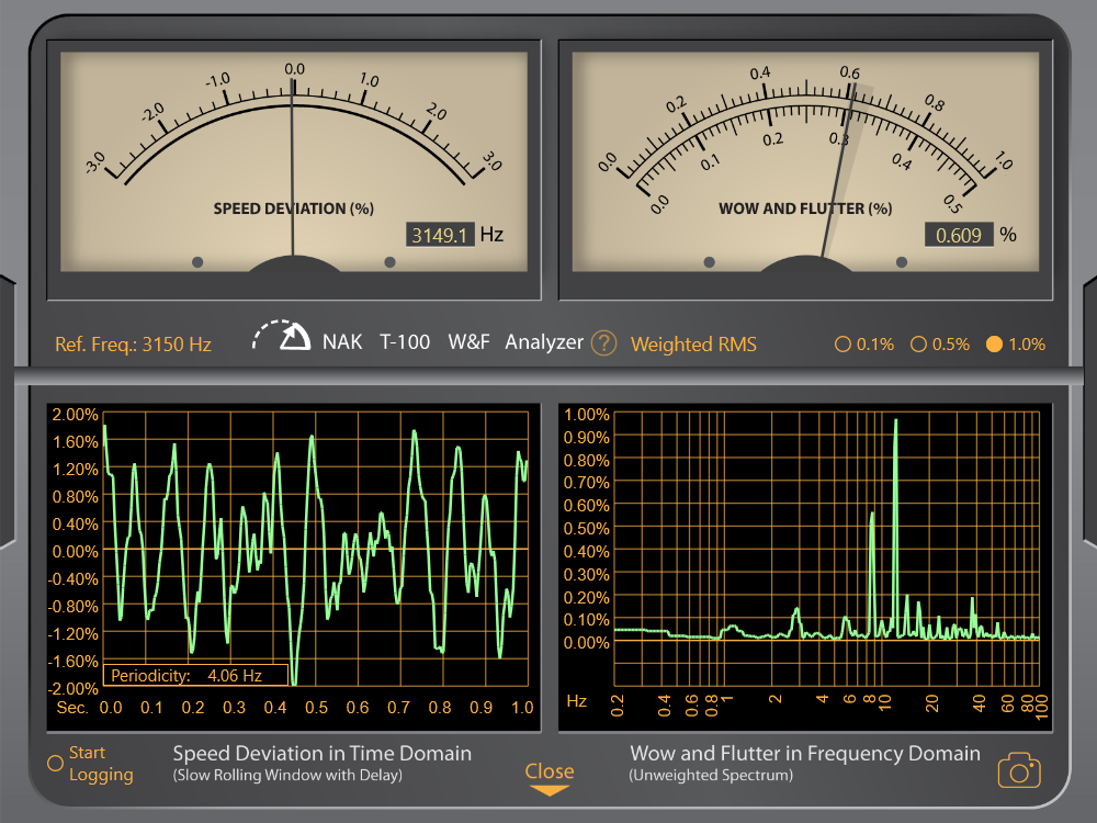

Excessive Wow & Flutter in Sony WM-2 (0.78% RMS with 8Hz Spike)

    Hi Norm,
    Thanks for the note! It’s reassuring to know I’m not the only one who couldn't track down official W&F specs. I’ve restored a few 1983 Panasonic boomboxes in the past that sit around 0.2% WRMS (against a 0.3% spec) and sound perfectly fine. Given how superior the Sony WM-2's mechanical build quality is by comparison, this performance hiccup really caught me completely off guard—a unit engineered this well shouldn't be performing like this.
    Like you, I always give my audio gear the full "spa treatment"—sparing no effort just for my own peace of mind (and because I genuinely enjoy the process).
    Before starting this project, I watched several videos and read through @Valentin's tutorials, so I was well aware of those door mechanism bearings jumping into the abyss! However, this "mystery ball bearing" was much smaller than the two door detent bearings. Naturally, the donor unit’s shaft was clean, so who knows where it came from.
    The belt is certainly still a suspect as well. While Marian’s products are consistently top-notch, strange defects or batch variations can always happen. I usually buy belts from Neil at Russell Industries—great quality and prices—but he doesn't have the right size in stock at the moment. Would you mind sharing the US eBay vendor’s name so I can check them out?
    I'm currently waiting on the replacement parts to arrive so I can start swapping components and see where that leads. I hope to take a victory lap (or maybe two) at the end of this project.

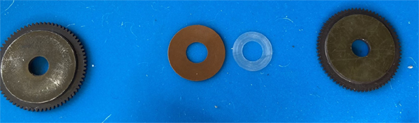

    An update on this bewildering project.
    I have good news and “the same” news to report. The good news: after replacing the supply reel gear with a new one, remediating some corrosion, and resoldering all the wire connections, the donor unit works. I gave it the usual "spa" treatment. The "same" news is that neither player’s W & F is good. The original Walkman W & F dropped to 0.45% from 0.8, and the donor now sits at 0.6% WRMS.
    I swapped some parts between the two, trying to nail the swine: belts (both sourced from fixyouradudio.com) - no change; flywheel capstans - things got worse (?!); driving gear assembly with its own native washer, and hysteresis plate- no difference. During the swap, I found that the washers used between the central gear metal plate are different.
    The red one (Teflon, I think) is larger and also thicker (0.21 mm); the clear one is 0.11 mm. Is that normal? The Serial numbers in these players are close.
    I also changed hysteresis plates (B) and tried them upside down, etc. It didn’t seem to make any difference.
    It appears there are only two things left to try to solve this W&F mystery: try a new belt from a different supplier, and replace electrolytic capacitors.
    Any other ideas? I'd be grateful for your input. Thanks!

    Hi Alex! On my WM-2 repairs, the clear washer is what I have experienced. That red washer looks rather odd to me, but I would defer definite answers from the pro's on this forum. I do believe that the WM-2 is capable of doing better than 0.4/0.6% wrms. For the WM-2's that I've restored, it has always had full replacement of electrolytic capacitors and full cleaning of all the gears. Are you able to check if the capstan is even slightly bent? Have you lightly sanded the magnetic clutch gear and metal washer on a perfectly flat surface with something like 5000 grit paper? Is there any corrosion still left on the motor pulley? Even if there is some residue from a sticky melted belt on one of the gears can introduce issues. Do you know what the frequency peak is from the wow and flutter from something like the NAK T-100 analyzer? Let's get this thing sorted! Norm

    The transparent washer is what I've seen also, although haven't seen that many of them to say for sure that's the only washer that was used on this model.
    However don't think this is the problem if the torque is right. Rather the different thickness may influence FF/REW main gear engagement.

    By the way, the red (Teflon?) washer that sits between the metal plate of the central gear and the magnetic gear is made from the same material as the thrust washer (sits inside the shaft of the capstan flywheel) and the spacer washer that sits under the circlip that holds the capstan in place; same color and thickness, 0.21 mm.

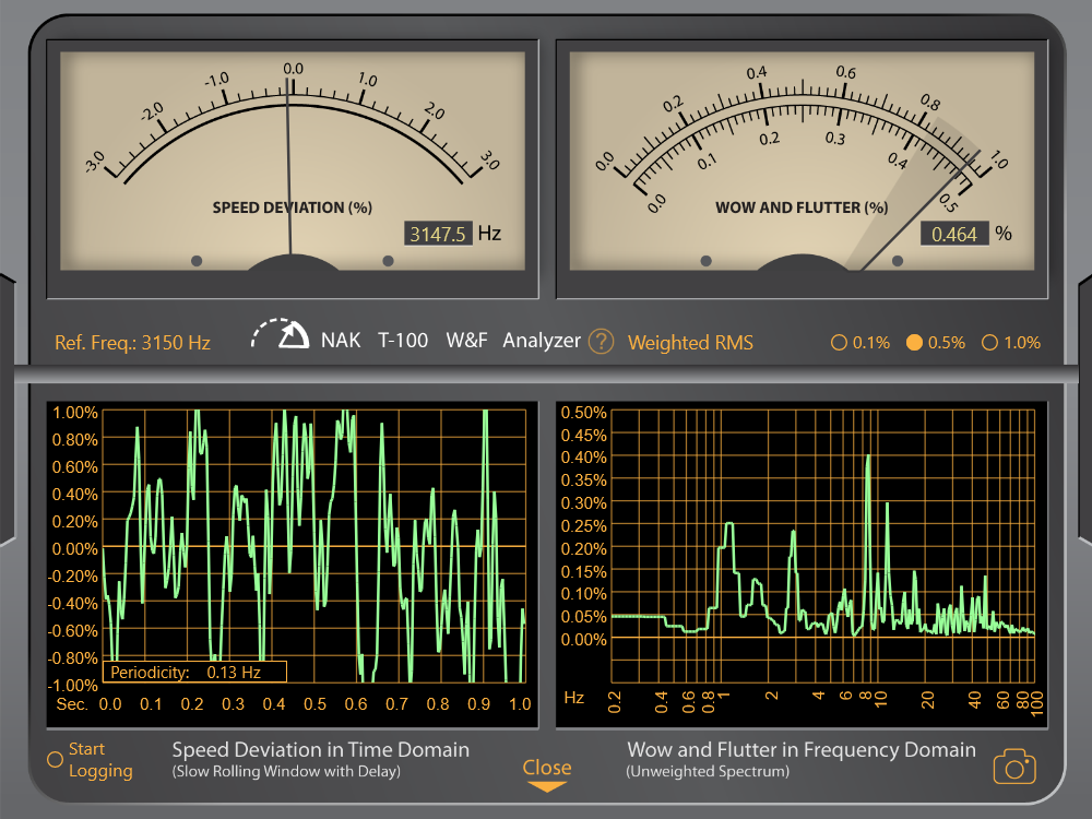

    This is the "original problem" WM-2. The speed is unstable on this player, and seems to vary more than I'd like to see.
    This is the "donor" WM-2

    I'm no genius, so I often refer cautiously to Gemini. This is what it said about your 8hz spike:
    Primary Causes of an 8 Hz Spike
    • Capstan Shaft Contamination: Hardened tape oxide, shed binder, or adhesive residue stuck to the capstan surface, creating a micro-bump against the tape once per turn.
    • Bent or Eccentric Capstan Shaft: Runout, burrs, or a slightly bent shaft introducing physical eccentricity into tape travel.
    • Bushing / Bearing Wear: Excessive radial play, scoring, or dried lubricant in the bronze capstan sleeve bearing, causing the shaft to wobble or chatter under load.
    • Flywheel / Gear Drive Defect: A nicked tooth, flash, or debris on a drive gear or flywheel surface coupled directly to the capstan shaft on a 1:1 drive ratio.

    I also ran the W&F spectrum through Gemini and got similar diagnostics analysis; the spectral breakdown helps narrow down rotational frequencies. That's why I decided to swap various parts to nail the culprit.
    What puzzles me most is that both units share nearly the same performance bottleneck. Two identical mechanisms failing at the same baseline makes me wonder if there's an issue with my re-assembly, belt batch consistency, or lubrication tolerance.
    This WM-2 is prove-it-to-me stubborn. Looking at its beautiful layout and over-engineered build quality, it’s almost ironic that my humble Panasonic RX-F5, which is full of plastic parts, easily kicks its butt at 0.2% WRMS.

    Mechanically—aside from the capstan etching option—I feel I’ve taken it as far as I can. I’ve gone over every potential friction point multiple times.
    While waiting for the new belts and capacitors, I measured the original belts. They sit around 0.89–0.90 mm thick, whereas the FixYourAudio belts measure 0.98–0.99 mm. A ~10% increase in belt thickness seems quite significant for a mechanism engineered with such tight mechanical tolerances. Perhaps that extra mass, which adds rigidity, is driving up the W&F? Will see. At this stage, swapping to a proper 0.9 mm belt and recapping the servo circuit are my best bets to resolve the issue.
