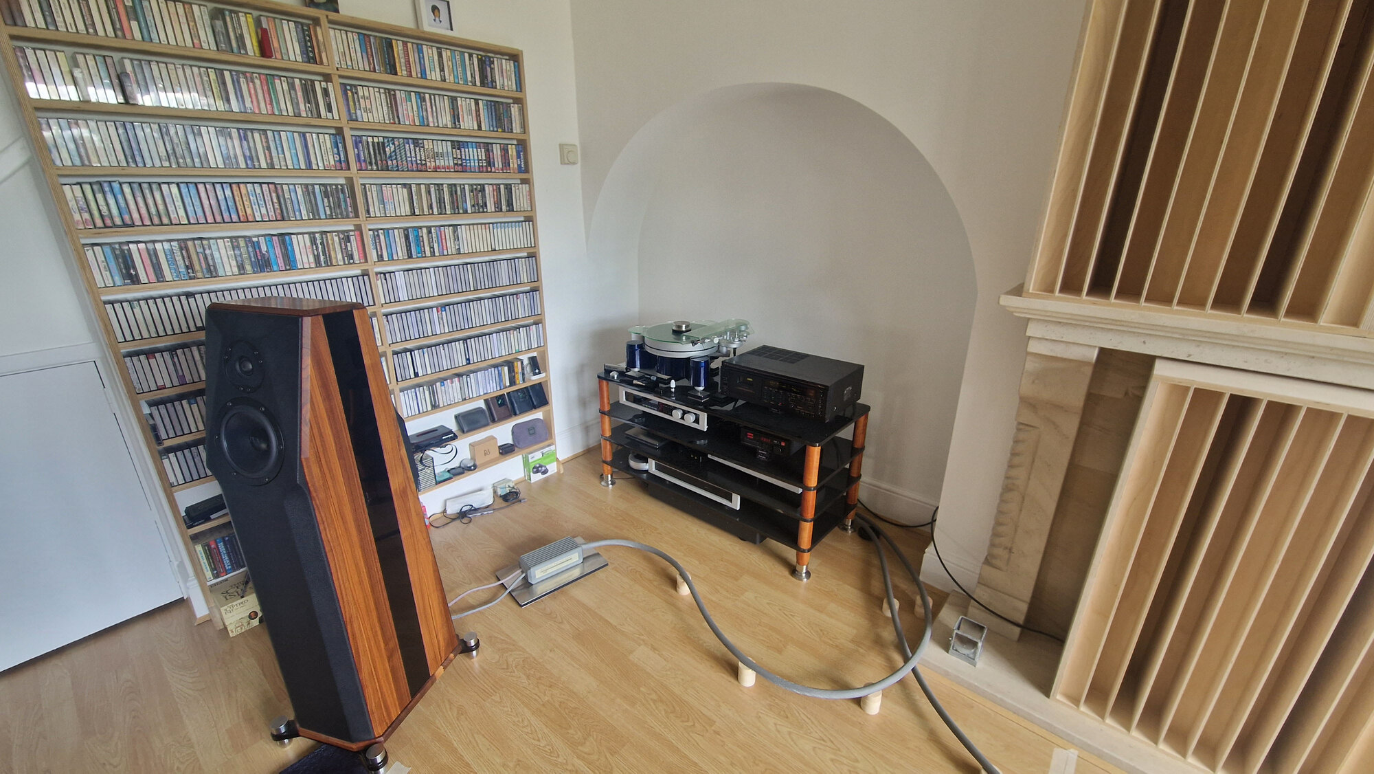

    Slow progress with the house and room.
    I bought some DIY plans from Acoustic Fields. I now have quadratic diffusers for the front and back wall. The front ones are 9½ inches deep and the back ones are 4½ inches deep. I could have gone deeper in the front to get lower wavelengths, but the units would have been deeper than the mantelpiece that would not look good.
    I could not go deeper with the diffusers on the back as they are too close to me and the sound waves would not be fully formed by the time it hits my listening position.
    Regarding diffusers on the front and back wall, I have covered as much surface area as I could. I still want the living room to look like a living room, and the middle of the front wall is the most important for the imaging as far as I am concerned. Yes, it would be nicer to cover the whole front wall, but that is not practical in this case.
    I will need to do the cloud cover and replace the first reflection points with new panels from Acoustic Fields, that is something for a later date need to do other things in the house first.
    So, what do I hear from just doing the front and rear wall diffusion.
    First thing I noticed is centre image focus much sharper, image thrown much wider than the speakers. I now get the height information back, greater image depth. I also get greater clarity.
    I will probably have to play with the speaker placement again, to take more advantage of the new diffusers.
    I am now hearing more of what the speakers can do, baby steps but getting there. :thumbsup2:

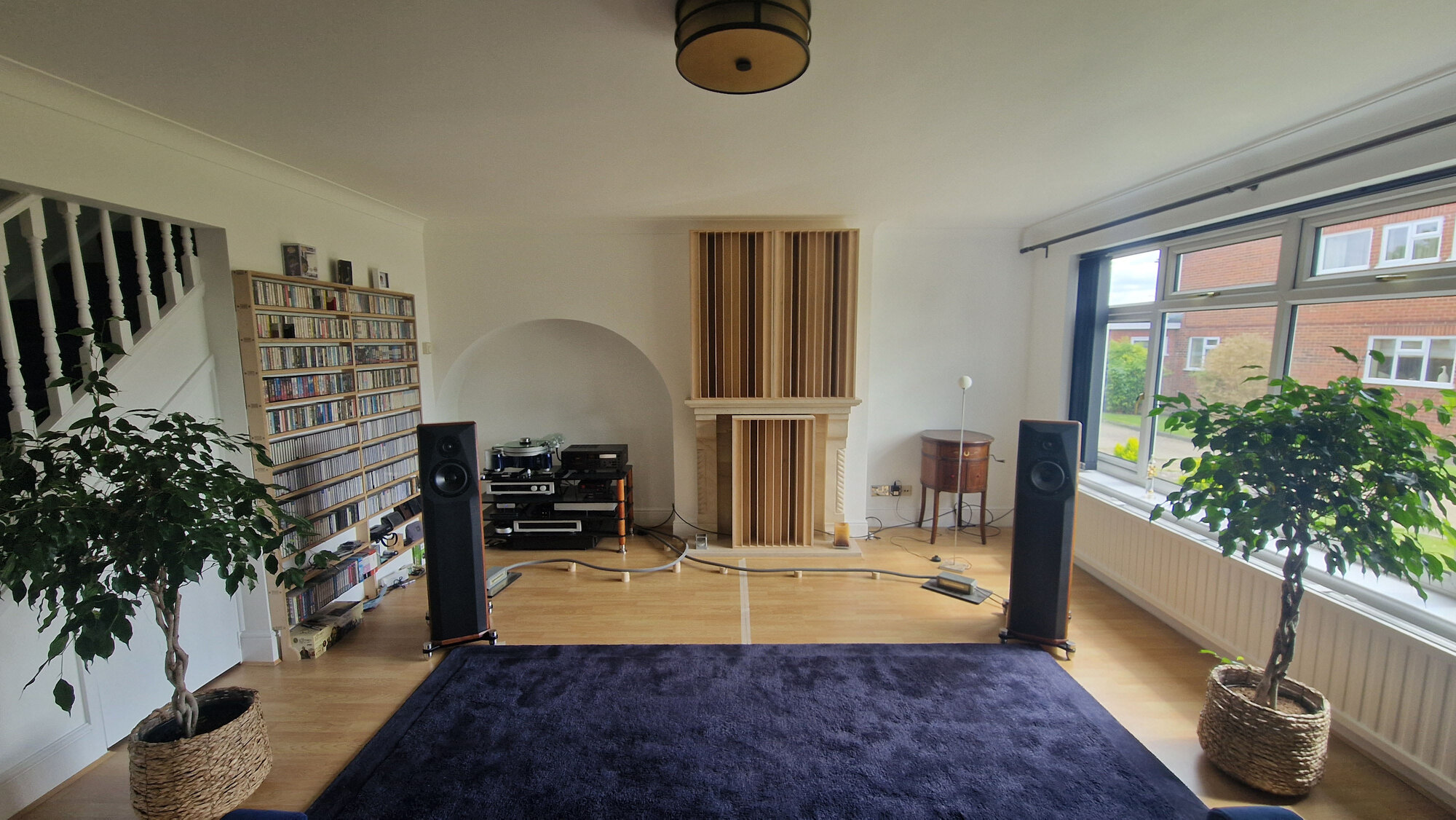

    After replacing the main light in the room and seeing the mess with the ceiling, I have decided to hold off on the cloud cover in the listening room. As it’s going to be a big messy job.
    What I have done for now is to get some really thick underlay to put under the rug, to help a bit more with the floor bounce. I think that is good enough to help and minimise the floor to ceiling bounce, I’ll have to get some friends in to listen and see if they agree with me.
    I thought my one plant looked a bit lonely, so I got another Ficus to balance the symmetry in the room.
    I think I am done for now, with the living room regarding making the Hi-Fi sound better.
