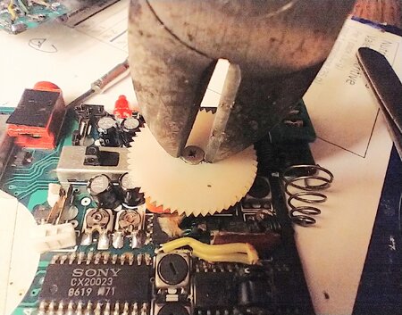

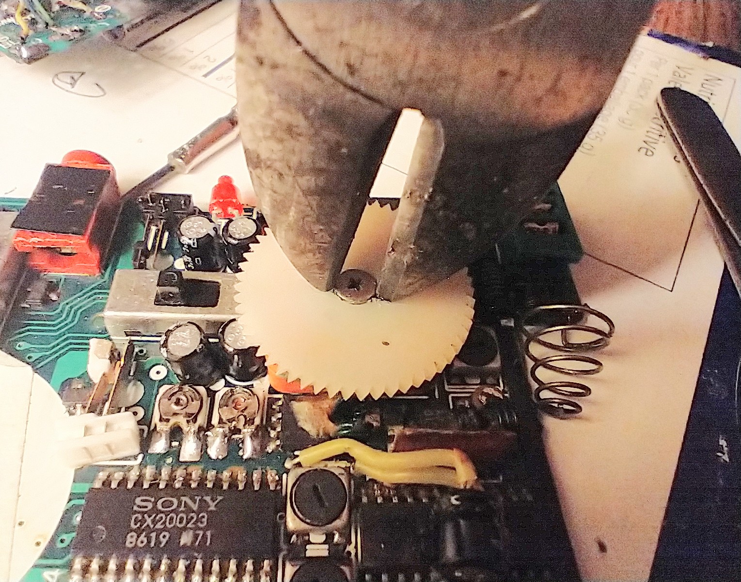

    Fixing things sometimes involves trying to loosen screws that won't turn. This is a method that works as long as you can access the sides of the head of the screw.
    In this case it was the screw that secures a plastic gear to the tuner. The tuner wouldn't turn due to corrosion. Forcing the gear risked stripping the gear where it fitted onto the tuner's metal axle. Penetrating oil and vinegar had no effect. Since the screw head was flush with the surface of the gear, I cut away enough plastic to be able to grip the sides of the screw head with wire cutters. The plastic removed has no effect on the function.
    The screw then came out. I was able to grip the tuner's exposed axle head in a small vise and free up the tuner. I don't know yet if the tuner works.
    Edit: Later, the tuner works. Amazing.

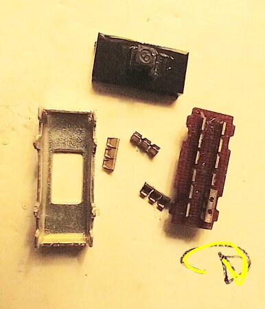

    About the slide switch next to the tuner. I've found spraying such switches with cleaner/lubricant is inadequate. This leaves too much tarnish and contaminants to ensure reliable operation. I remove and disassemble them to clean them properly. IMG_20260712_215104141~2.jpg
