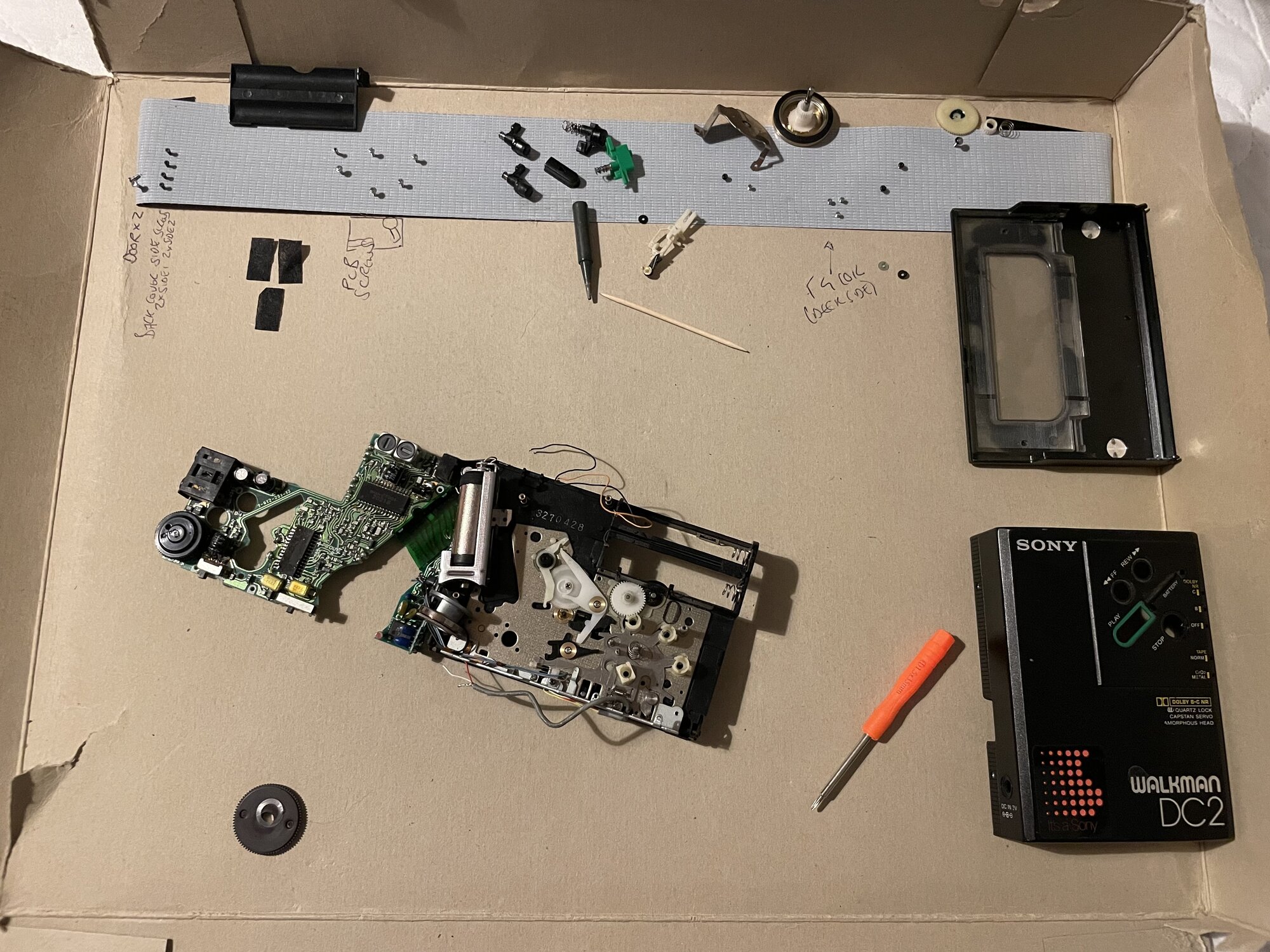

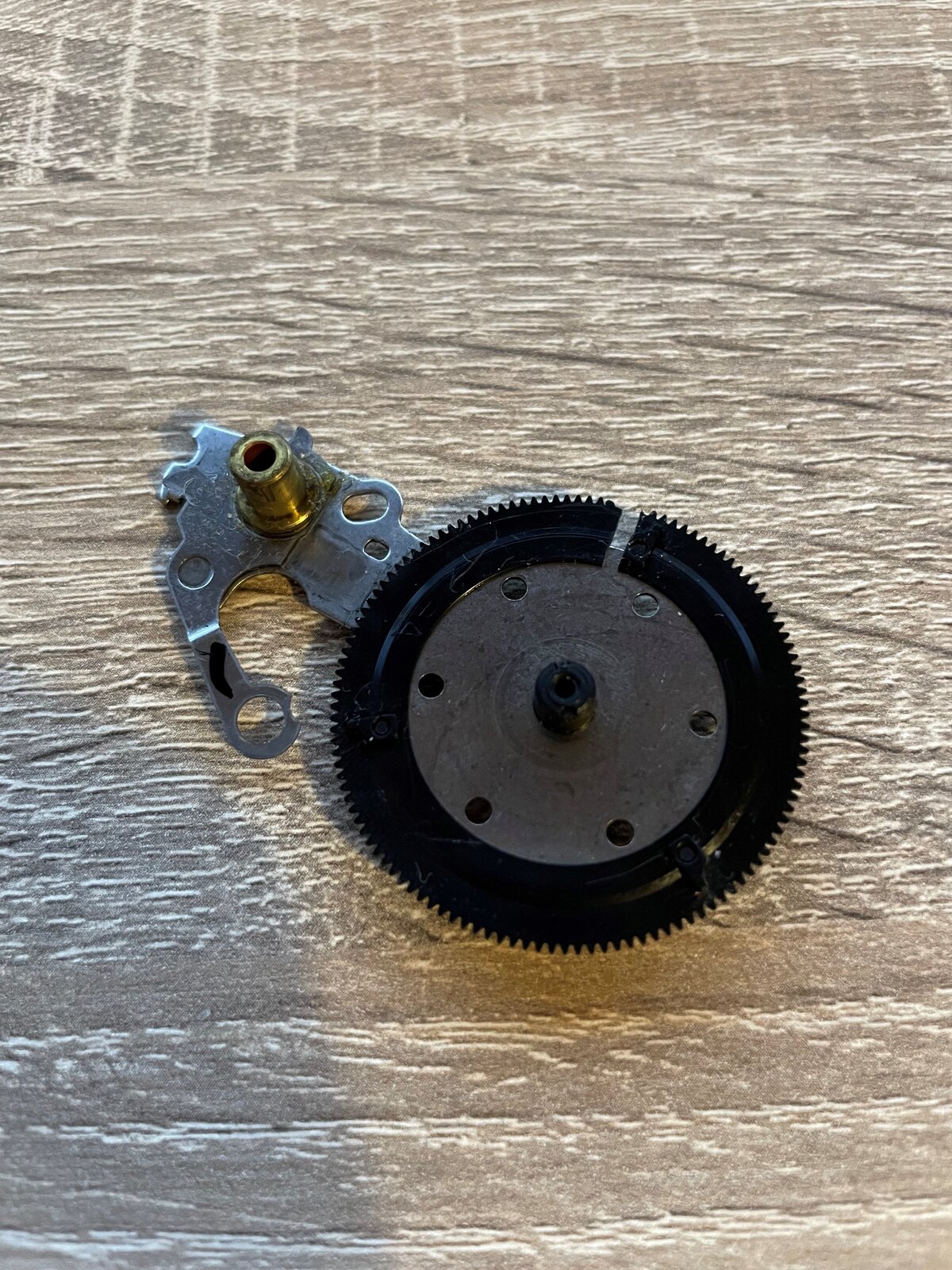

    I've found my old Sony DC2 in the loft and have followed a really good guide on this site to strip it down. I've found that the center gear is cracked (see photo), and now I need to purchase a replacement (I'm in the UK). Can anyone suggest a good option please, preferably within the UK? I've seen a few different types:
    1. a 2 part plastic sandwich with 6 screws
    2. a 2 part stainless steel version of the above
    3. a 1 part black plastic version, but I have no idea how this would fit over the metal center disc
    Would anyone know which type is best, and where to purchase in UK?
    Thanks in advance =)

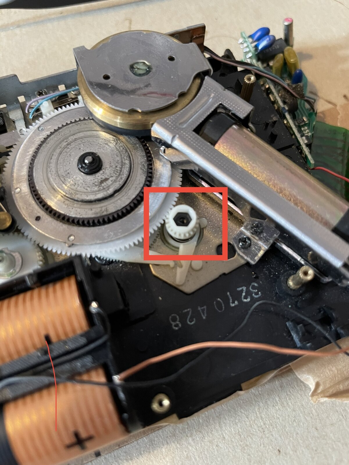

    First rookie problem. The tiny hook spring from the slider flew off when I was attempting to teeezer it back it place :( I know :( Does anyone know where I can get a replacement one, or what size it was so I can look on eBay?

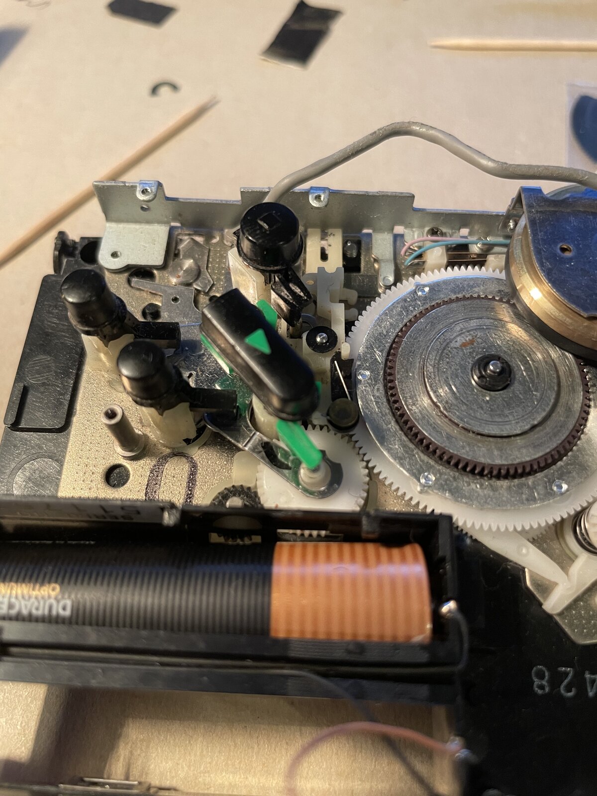

    Second issue may be more tricky. The FF button isn’t clicking when I press it. RW, play, stop are fine. But FF doesn’t click, even with more force than should be necessary. I’ve swapped over the FF and RW buttons just is case but same result. The centre gear gets pushed down, but no click. Does anyone know what might be causing it? Photo attached, and I’ll attempt a video too.

    Have I installed the small gear under the take-up gear assembly the right way up?
  8. Rog McDonnell
    Rog McDonnell New Member
    14
    From what I can see, on FF, the button is supposed to push down the centre gear assembly, enough for the large cog in the centre gear to locate onto the small cog of the take-up gear. But when I push the button, the centre gear assembly doesn’t push low enough. Like something is stopping it physically, but I can’t see anything obvious.
  9. Valentin
    1,997
    Yes, it is installed correctly.
    The spring I'm not sure you will find one that thin on ebay, it's a very fine wire diameter one. I don't know its dimensions. Usually you will need to order more than one of such springs until you get the correct one, as measurements won't be perfect.
    The second problem I believe may be caused by stuck auto-stop levers. They should be cleaned regardless. Link here: https://stereo2go.com/forums/threads/sony-dd-series-play-ff-rew-buttons-not-latching.7524/

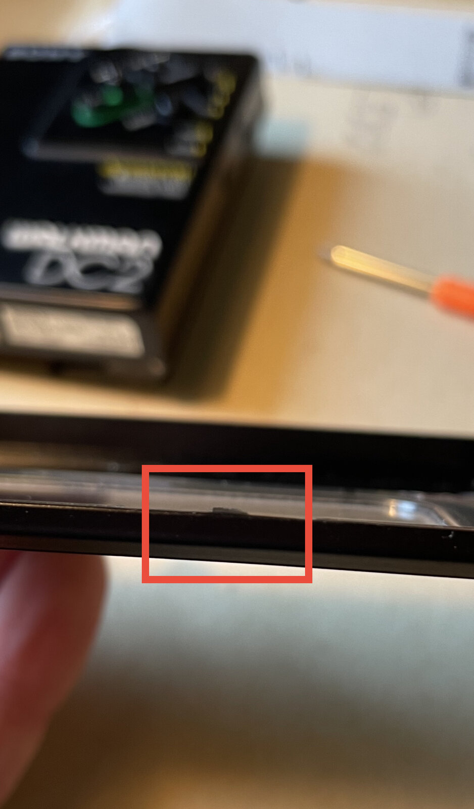

    Thanks for the catch advice too. As you mentioned, I think my issue may be that the hook on the door has bent out slightly. I’ve attached a photo. I’m very hesitant to try to bend it back, as I don’t want to put pressure on the door and the window. Any thoughts?

    Latch door hook bent…

    The door hook doesn't look to be a problem to me, although it's not very clear from the picture. Usually the plastic part wears a lot quicker than the metal.
    What can be done is slightly file the plastic latch, so it goes further towards the closed position in order to compensate for the wear.
    However please note that if the door does not open on its own, the latch is working correctly and you can leave it alone. Some small up/down movement on the door is present on most of these units.
    I also recommend putting a tiny bit of grease on the friction part of the latch in order to prolong its life.

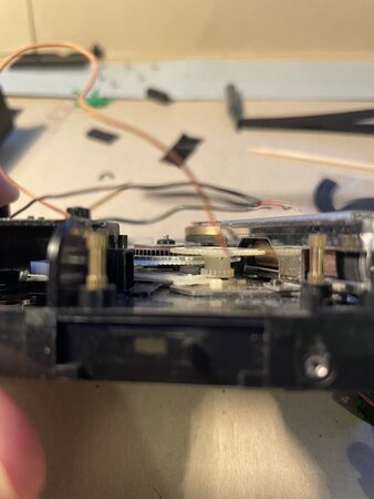

    One last issue if that’s ok? All functions are fine without a tape. With a tape, PB is fine, but RW and FF can be noisy, and you can see the spindles occasionally stopping and starting. It’s particularly bad rewinding near the beginning of a tape and forwarding towards the end. I tried a few tapes and they’re all quite similar. Any idea what I could check for?

    You need to bend the center gear arm as indicated in the tutorial until the gear slips no more.
    Alternatively, you can add a very small piece of electrical tape (cloth type) over the center gear arm, so the button pushes the gear further down.
    1 or 2 pieces of tape will solve the problem. After finding out the correct thickness you can glue the tape with super glue on the center gear arm.
    I preffer the second option as for bending the gear arm you need to take it out every time. With tape, you just take the buttons out.
    You should check the device upside down as well.

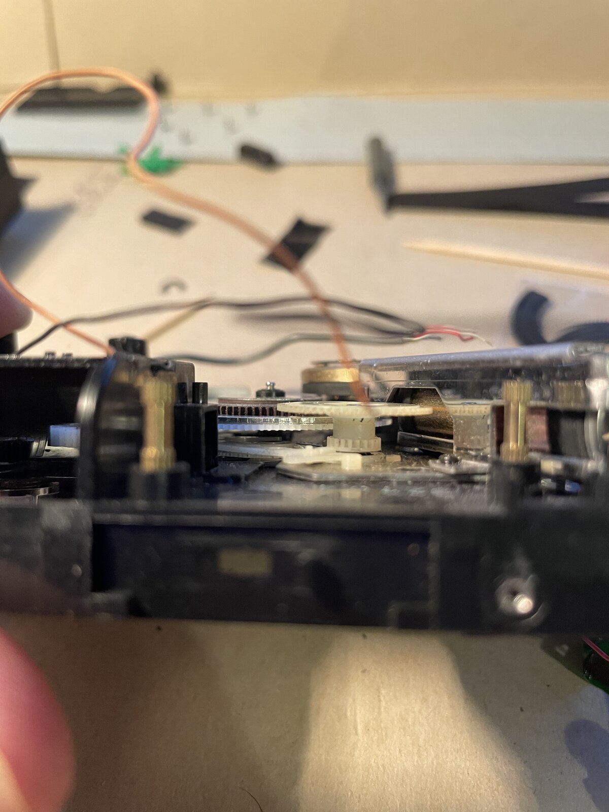

  20. Rog McDonnell
    14
    Hi Valentin
    I stripped it down again and took the opportunity to sand off the top surface of the new centre gear, following your tutorial, as I was getting some noise. That seems to have worked nicely and it’s much quieter now.
    Afterwards I experimented with adding tape on the gear arm and RW is now perfect, with or without a tape.
    But FF has got a lot worse since the center gear has been adjusted. Without a tape it’s fine, but with a tape, the center gear keeps slipping on the small gear of the take-up gear assembly. Photo attached. I’m thinking that maybe this gear needs replacing now?
    Do you know if this gear is available to purchase? I had a look on fixyouraudio.com but couldn’t seem to find the right one.
    Any advice on where to find one would be appreciated. Or alternative solutions.
