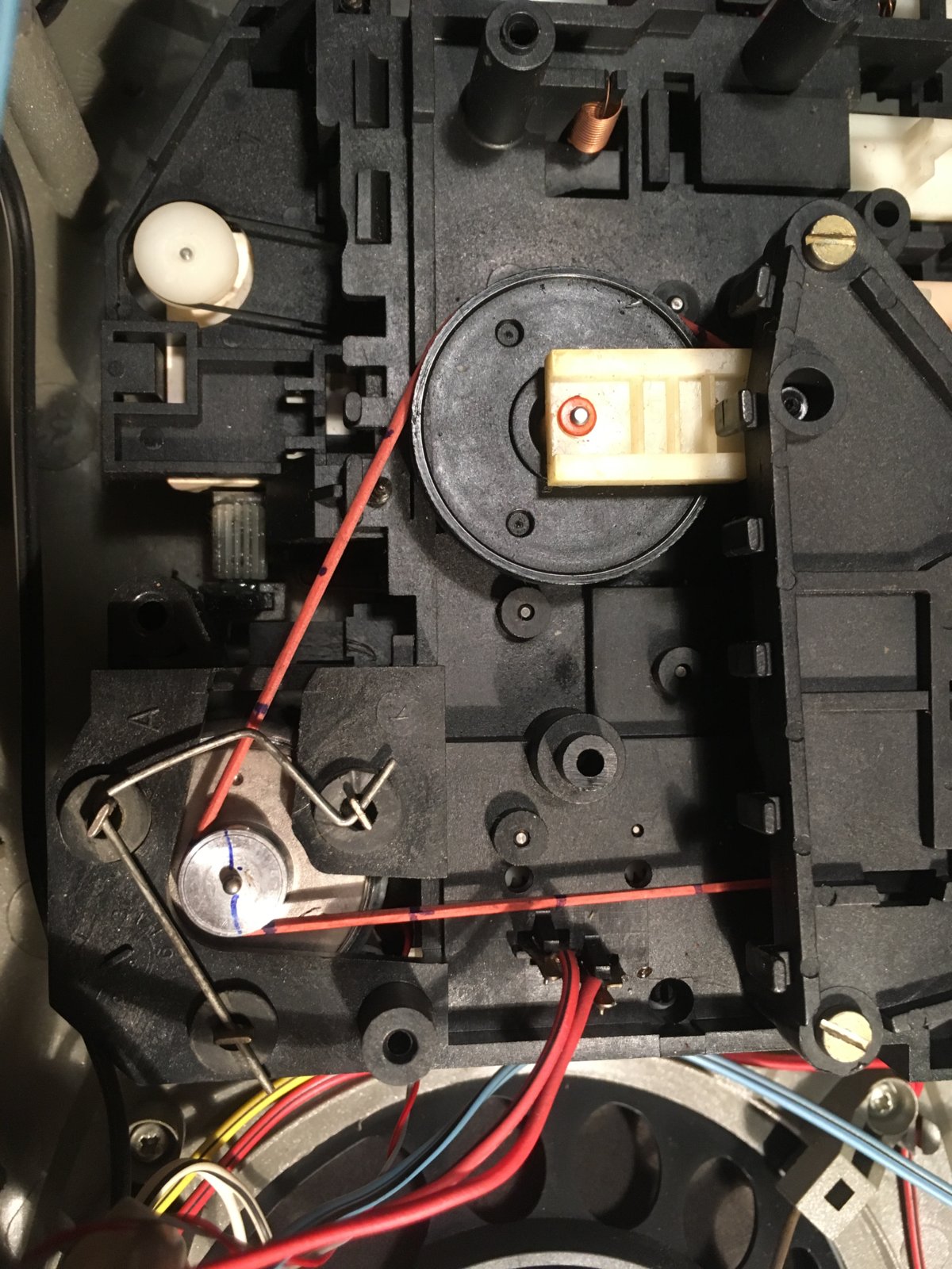

    I'm from slovenia, I've always been interested in old gadgets and a couple of days ago I found an old Panasonic d-8414 at a dump. Radio works really well, but I have a problem with the cassette player, I had to clean the "magnetic head/reader"(don't know the term:), after that another problem occurred. The big elastic loop that connects the motor with the cassette spinning heads snapped, I replaced it with an elastic i found in the kitchen. Cassettes play but the sound feels like it is too slow and not as it should be. I ask if I should buy a new elastic or could the problem be in the motor?
    Thank you for the answers in advance:)

    19,378
