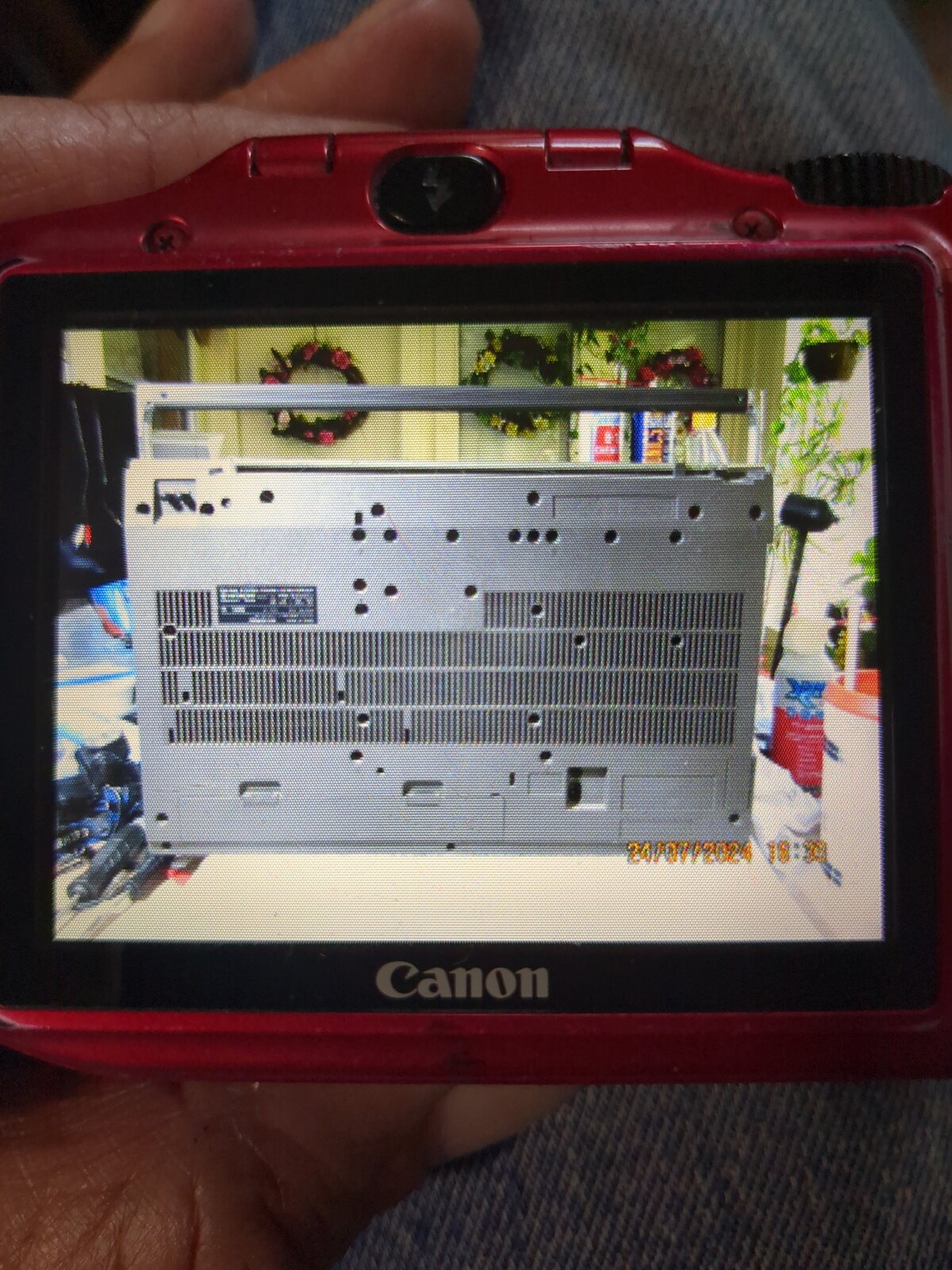

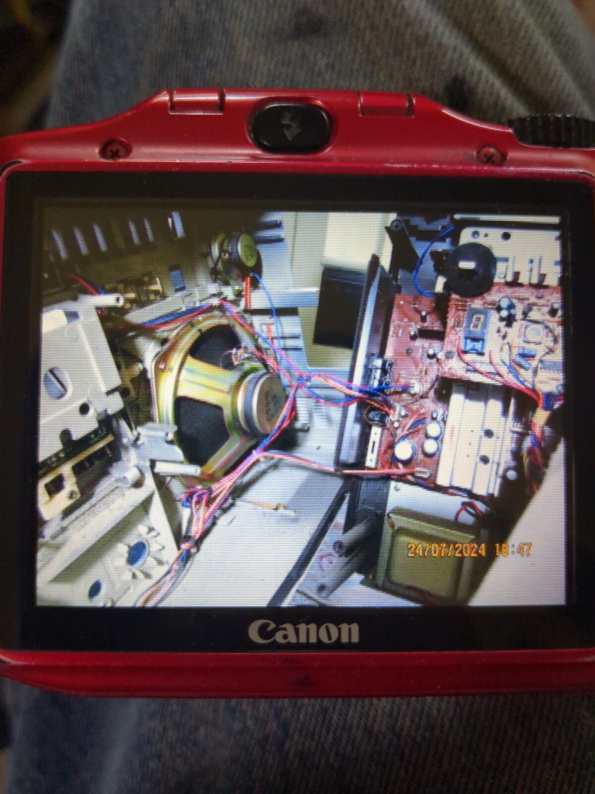

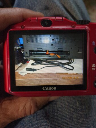

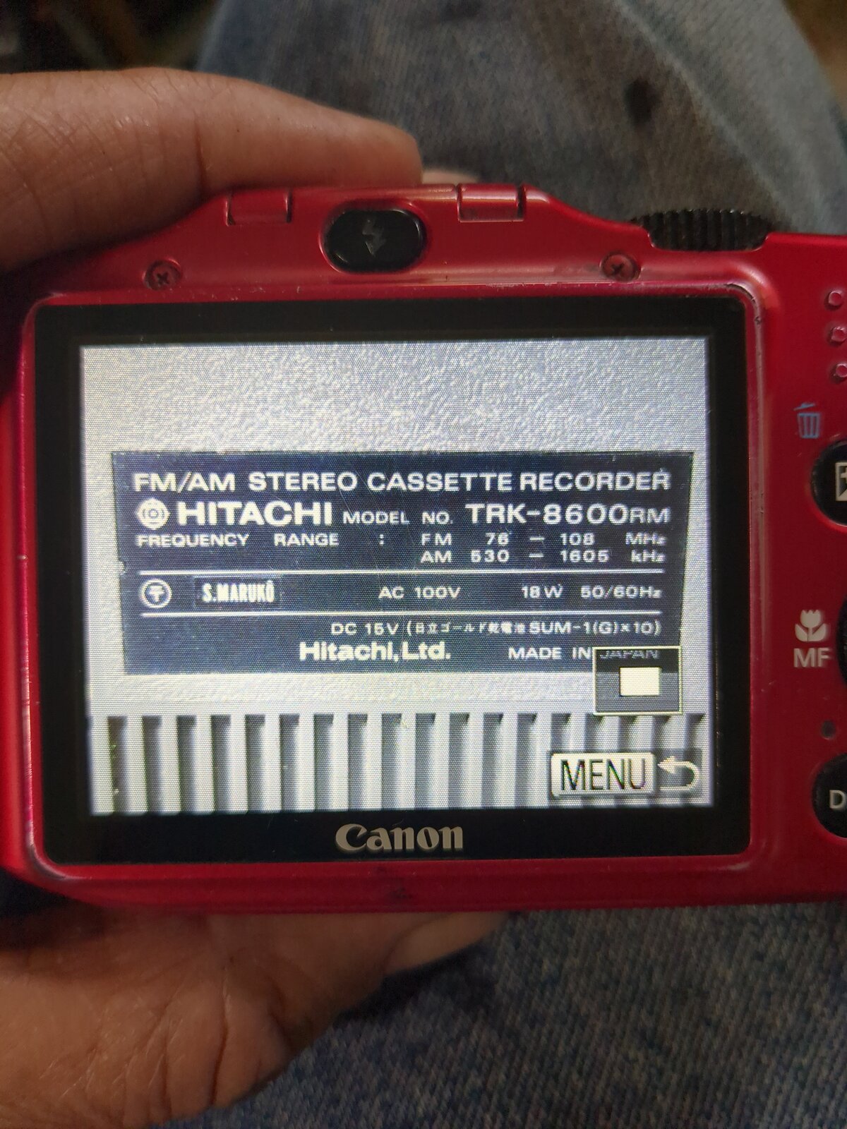

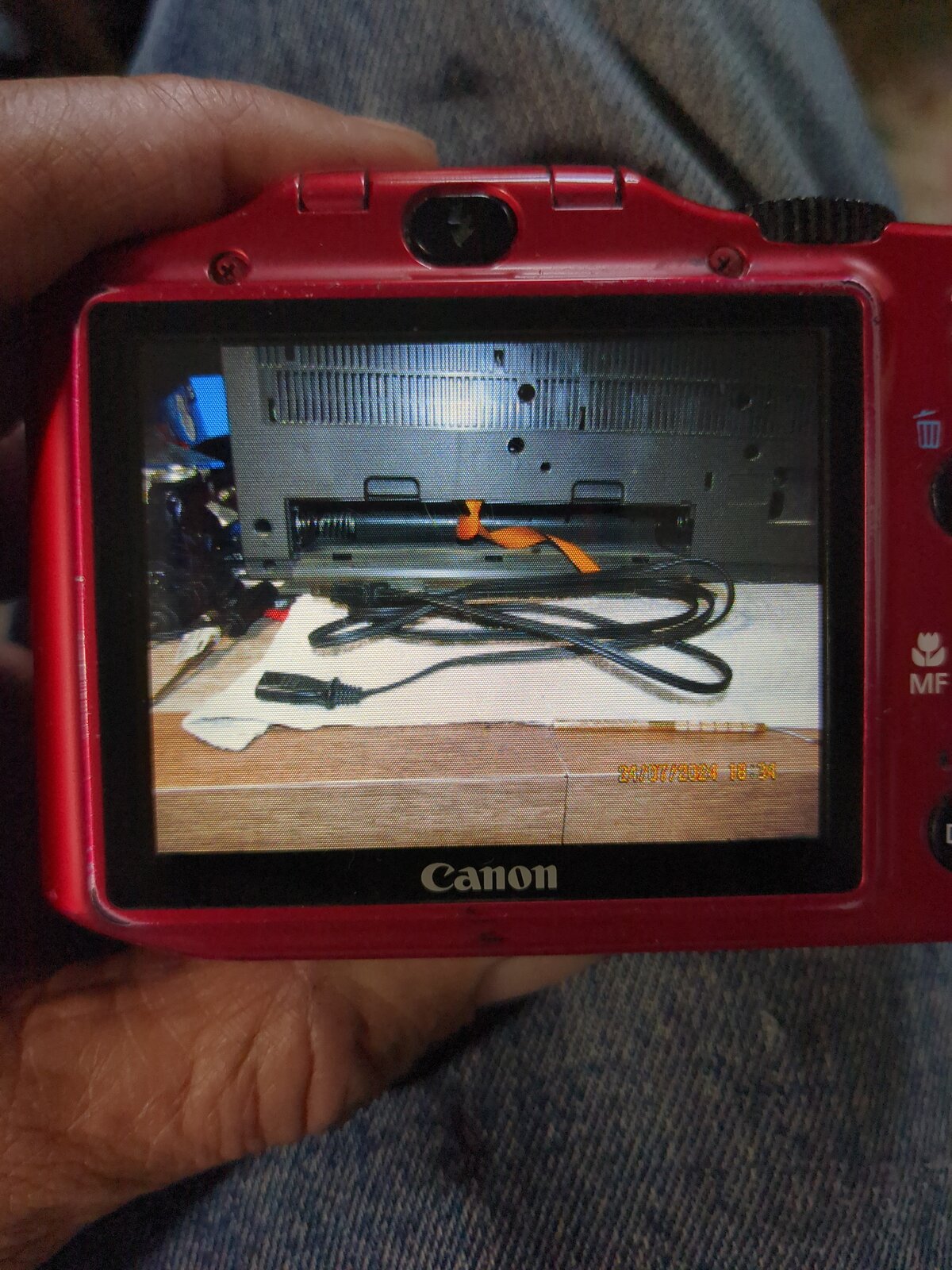

    I have a potential customer that's looking for a good working type deck and this is a good working radio but the tape deck is dead and these are pictures I took with my little camera first. 17219418849398731590193712616026.jpg
    Front

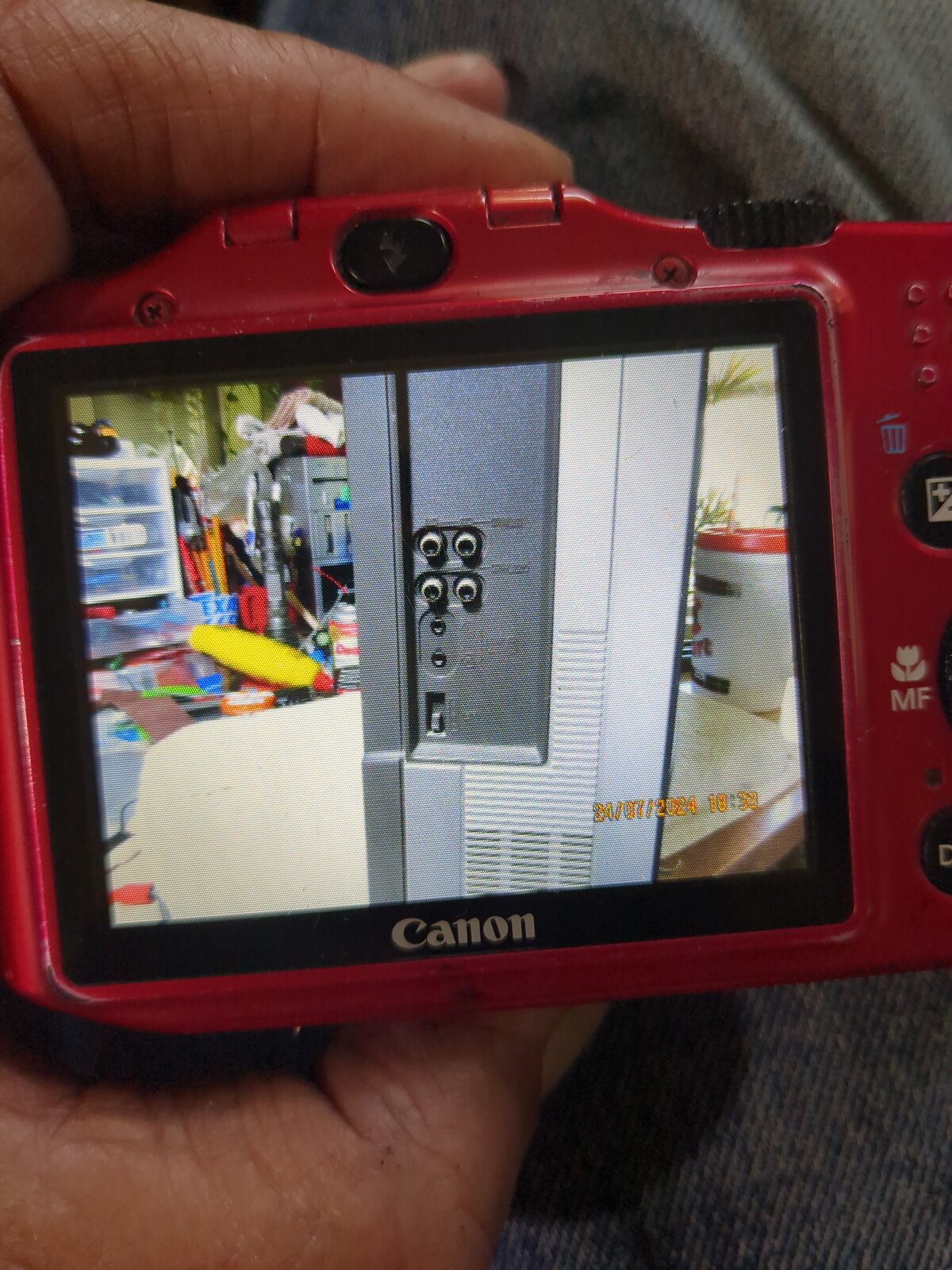

    Input end
    Back or rear
    Battery compartment

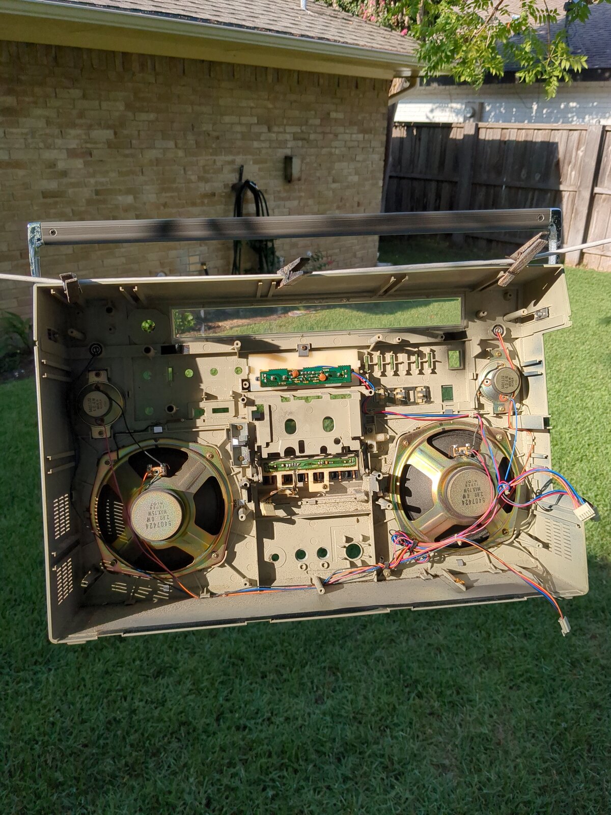

    After screw removal cracking it open
    Got to know are those speaker wires go to plug in.
    Just making sure where the wires go

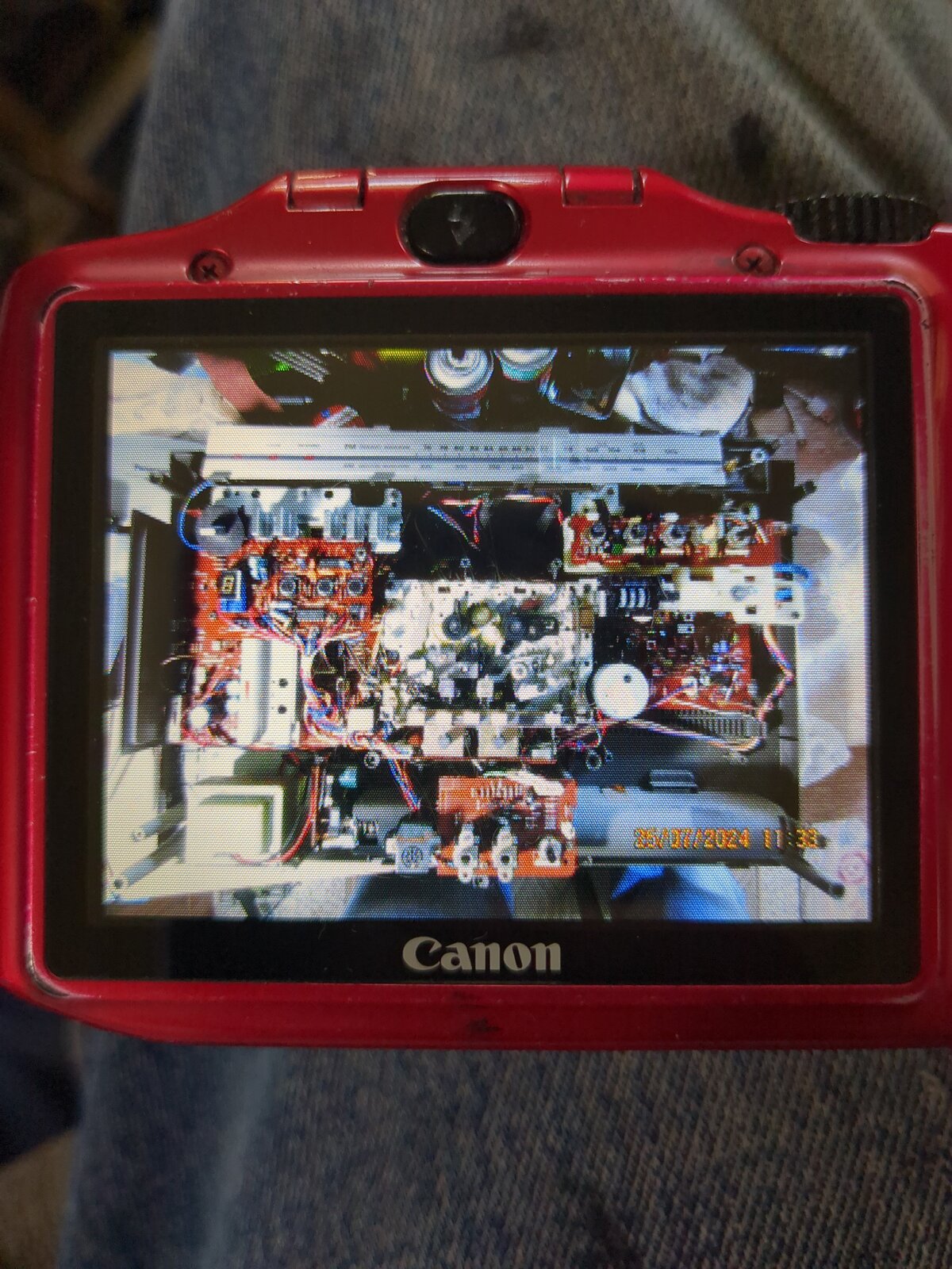

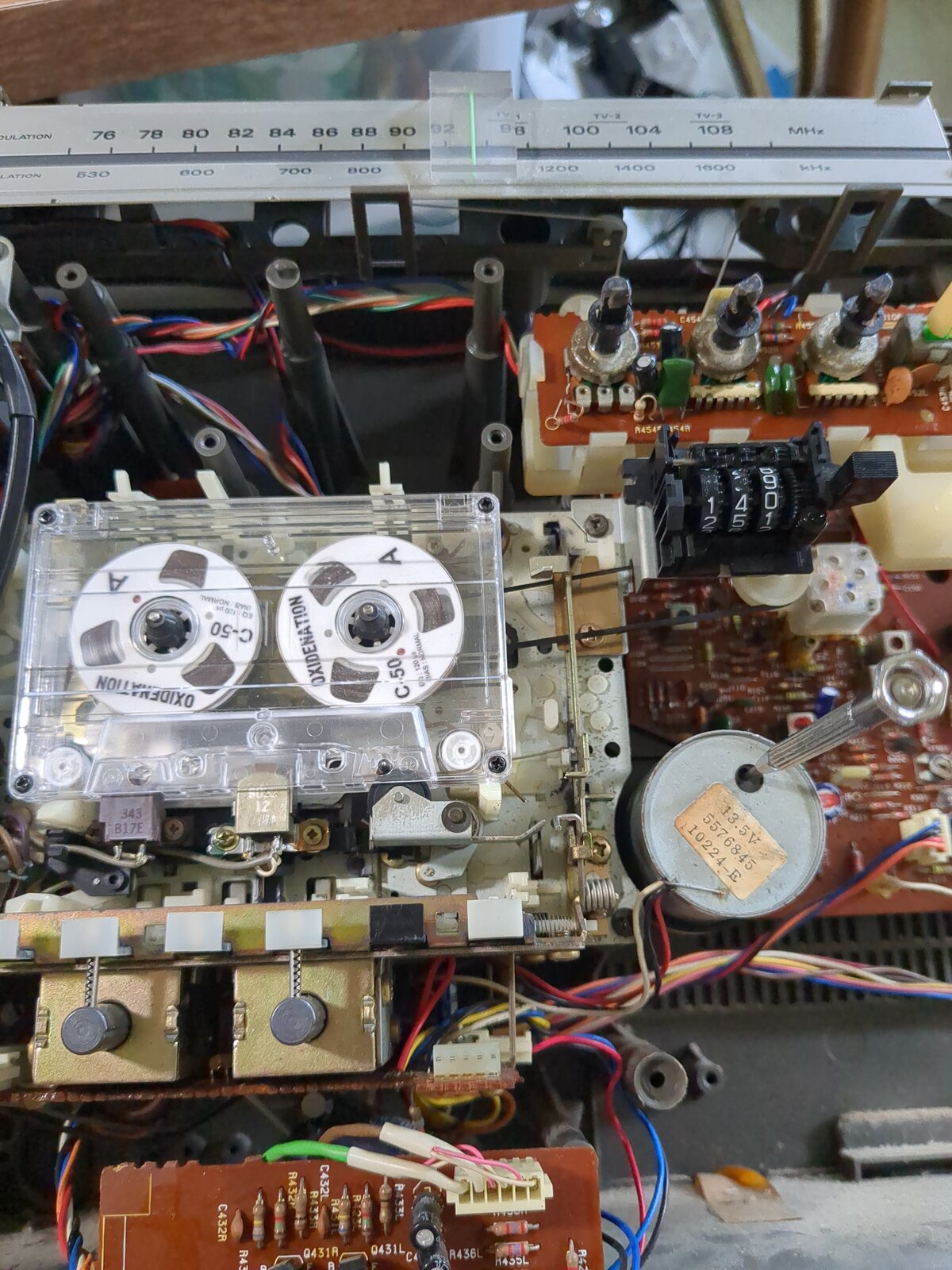

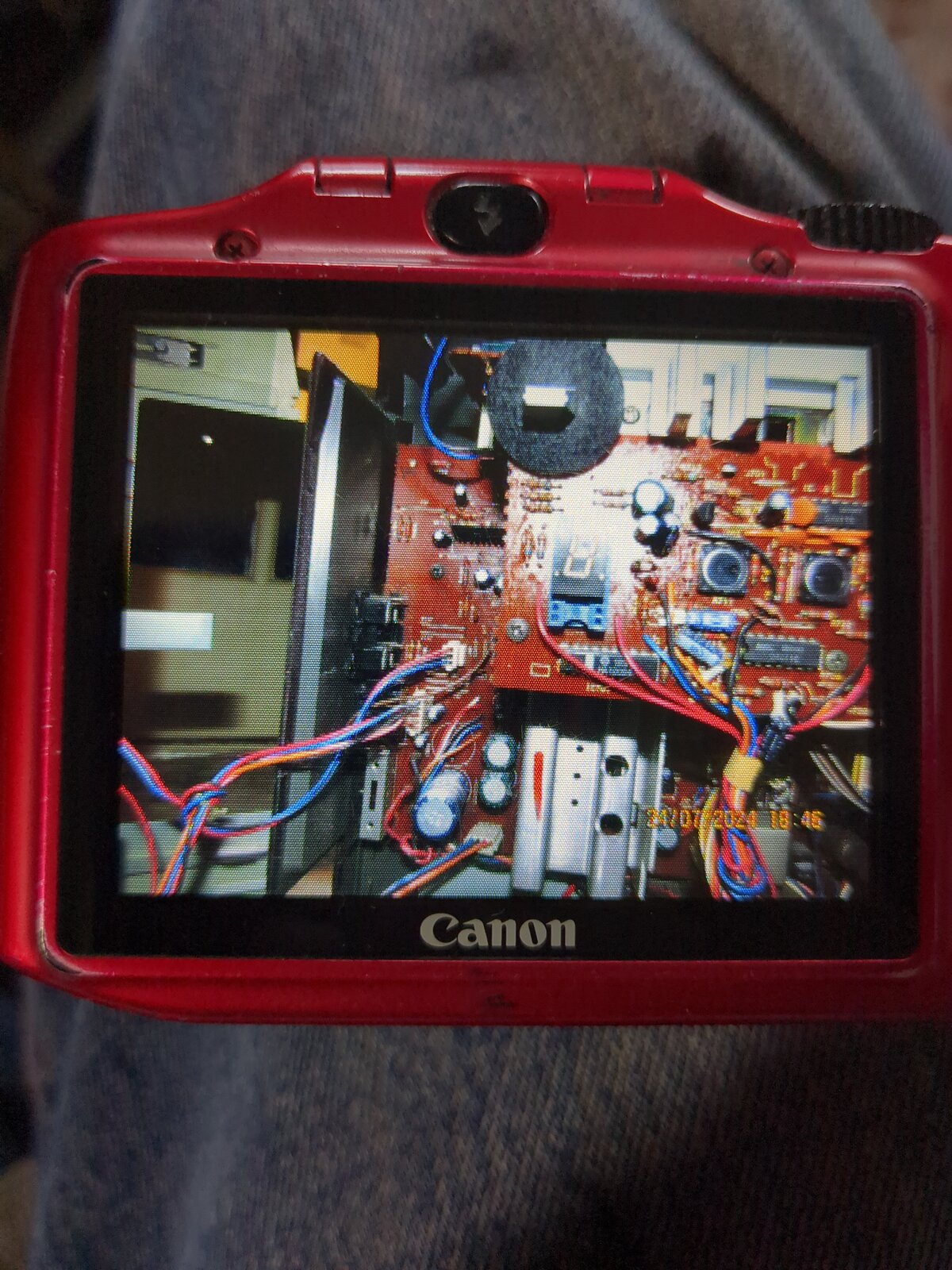

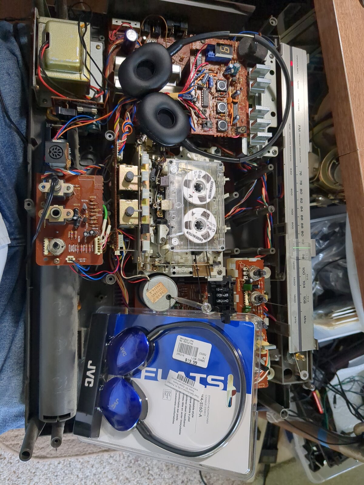

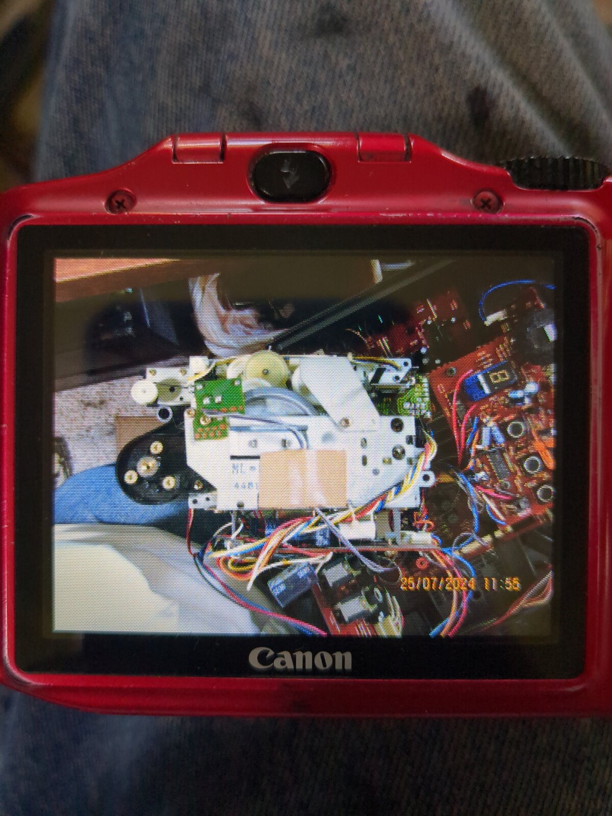

    Overview inside before removing cassette deck.

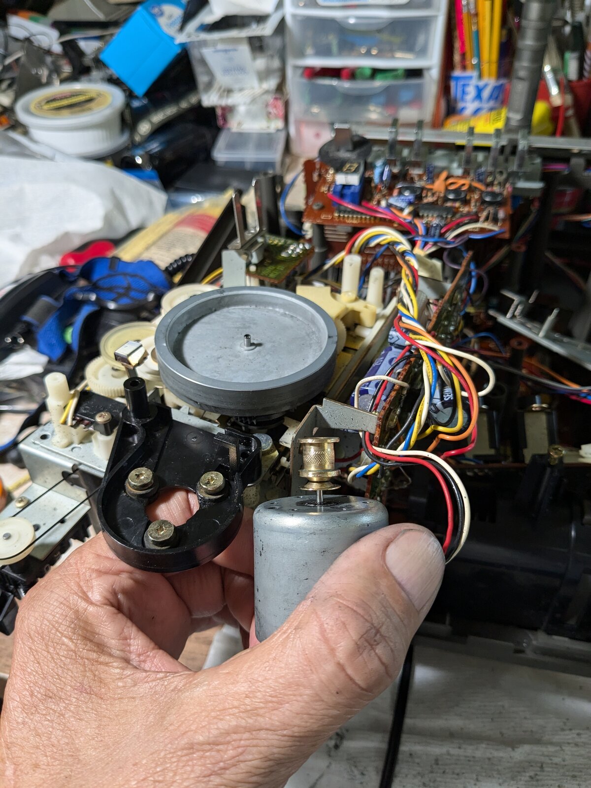

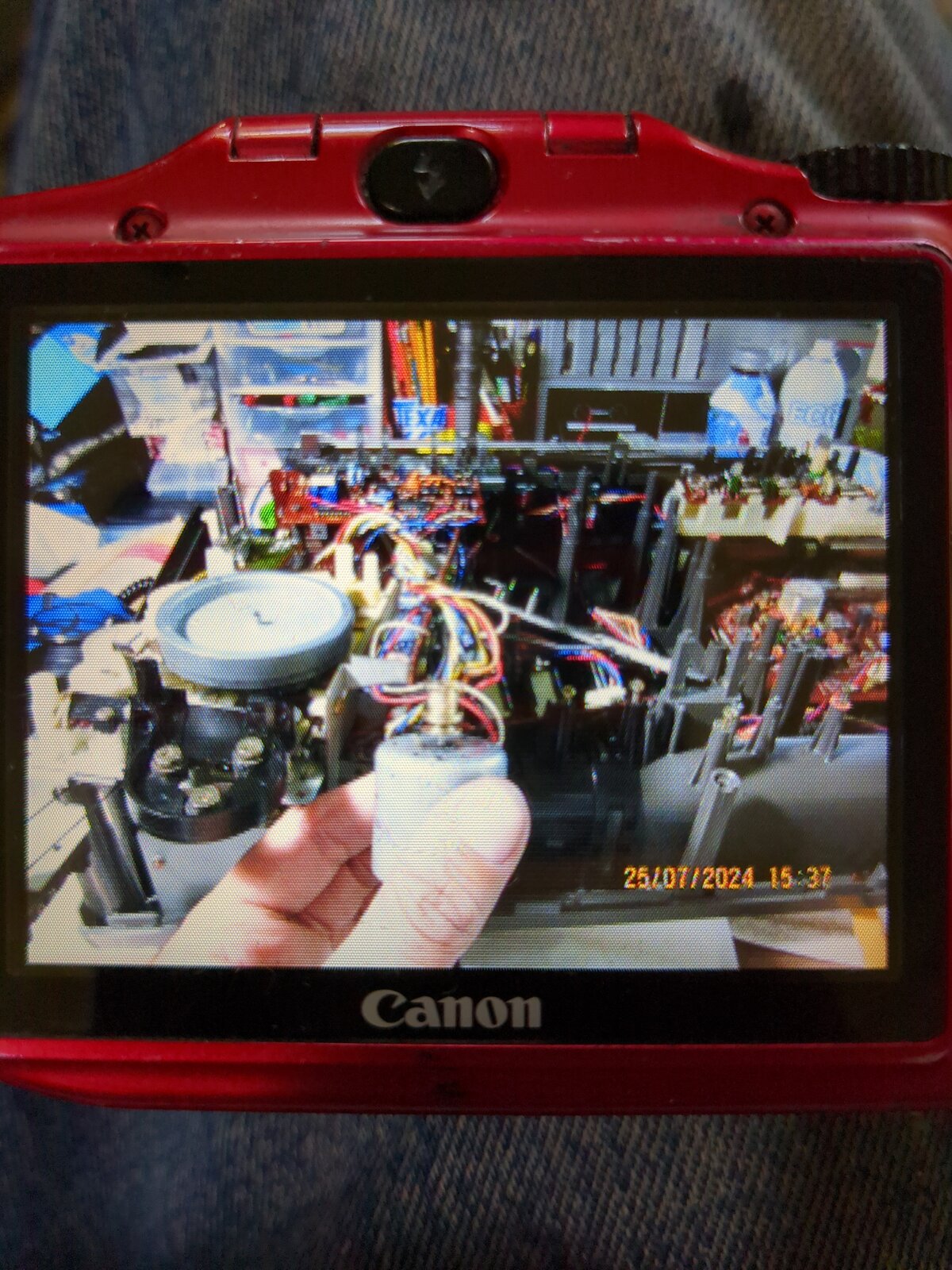

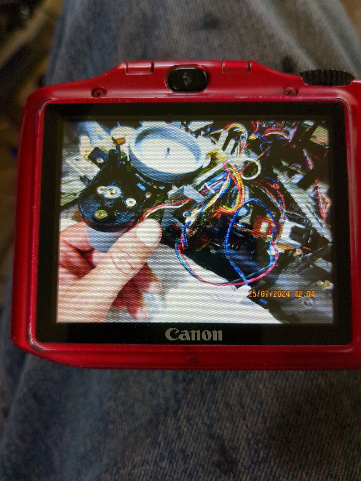

    Making certain of what wires plugged into where and also note the amount of rubber tire wrapped around the motor or tar.
    See how both pulleys are now very clean.

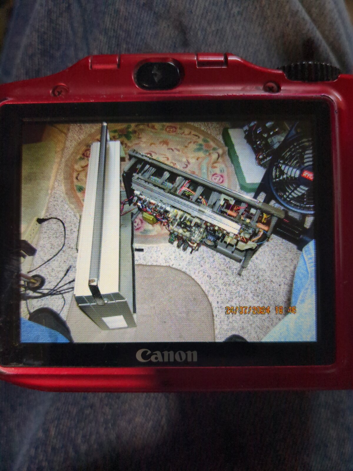

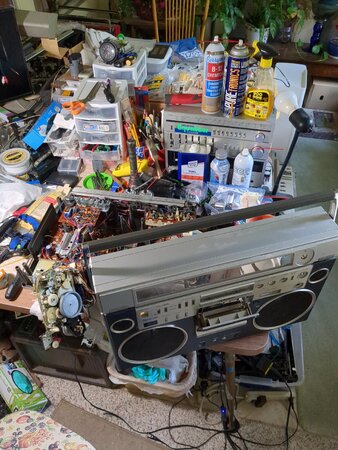

    And now for the one picture I took with the phone

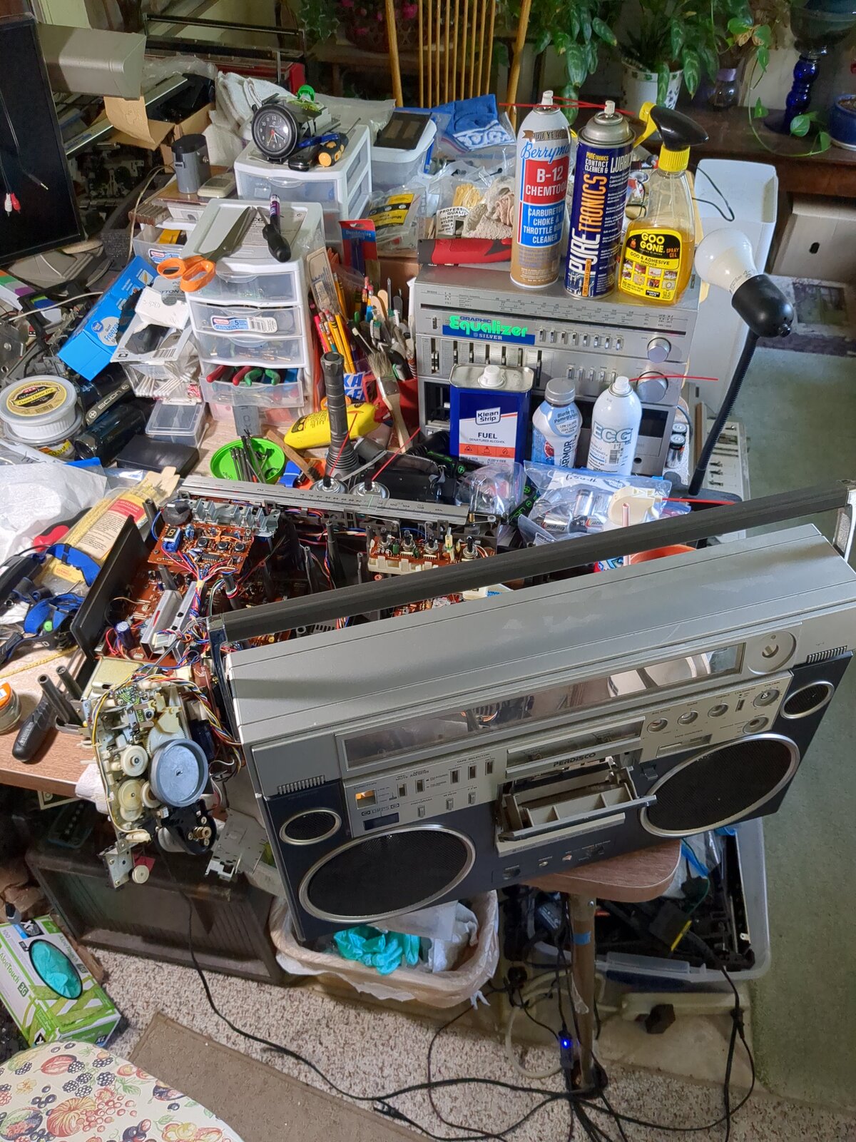

    And now where I'm at kind of an overview

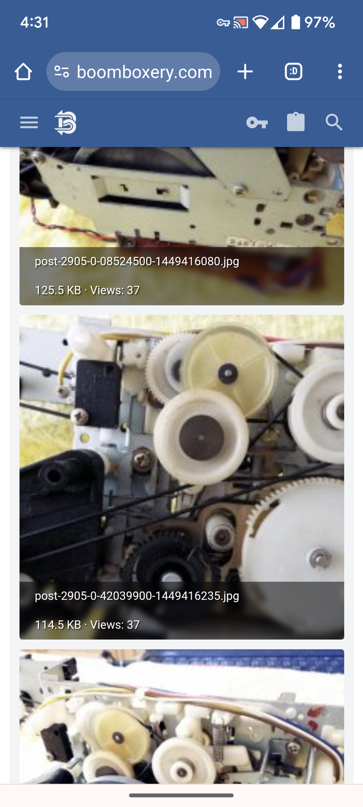

    Finally, with a little help from boomboxery which this had stumped me. Here's a screenshot I found because I couldn't copy their picture or download it or whatever because. Screenshot_20240725-163106.png
    So now I'm going to get my own belts and start putting new belts into this model. I'll be back.

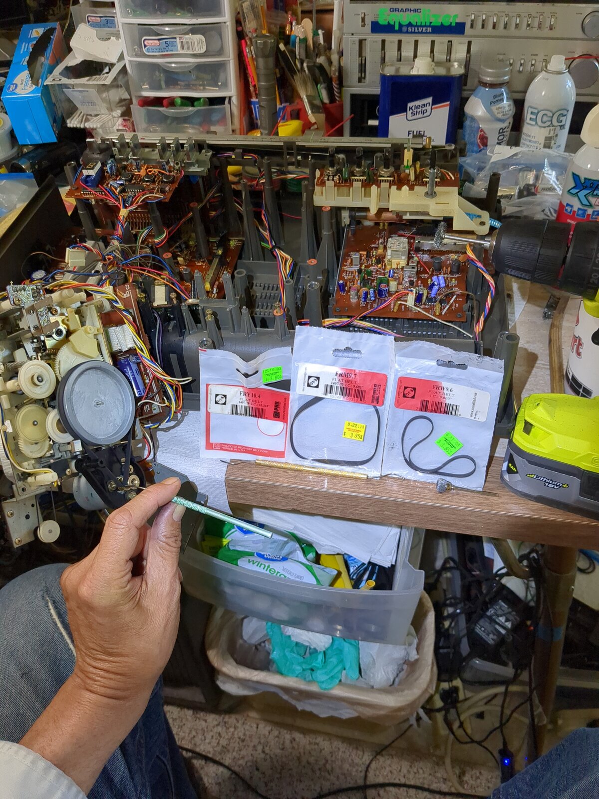

    Yes I got belts new ones old ones used ones flat ones square ones round ones idler tires. Yes these are just for boomboxes as the Walkman belts are with the walkmans and not out here.

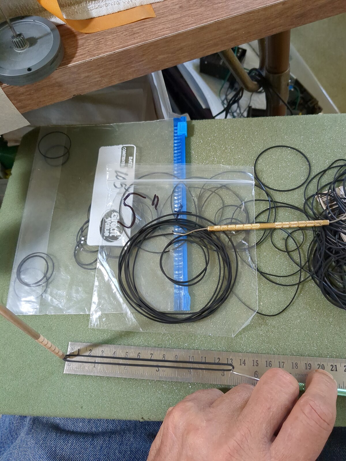

    This 10.4 in flat belt fits better than the other recommended sizes. Allow me to illustrate.
    You don't want your flat belt on there so tight that it binds the motor while it's rotating. Ideally you would want the belt to just reach the center of the shaft of the motor and no more which is what I have here with a 10.4 in belt as I've already tried a 9.7 and a really tight 9.6 that's no good.

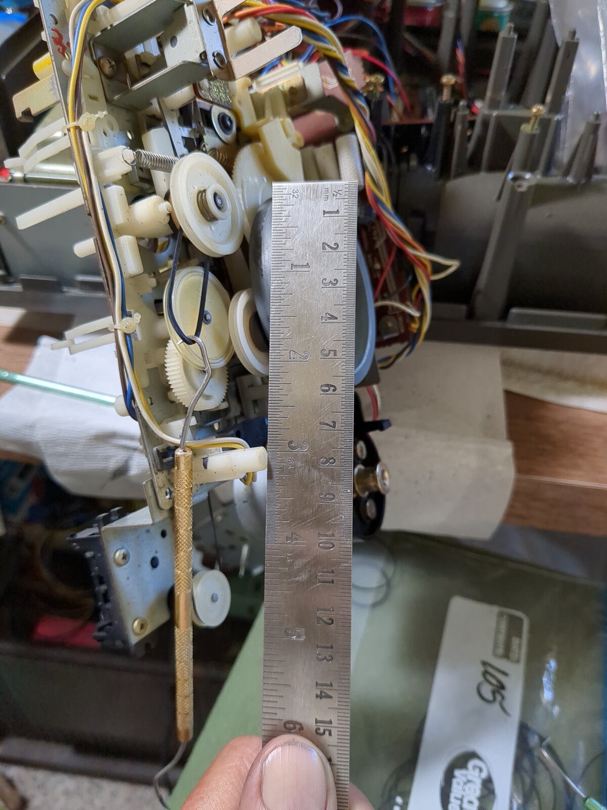

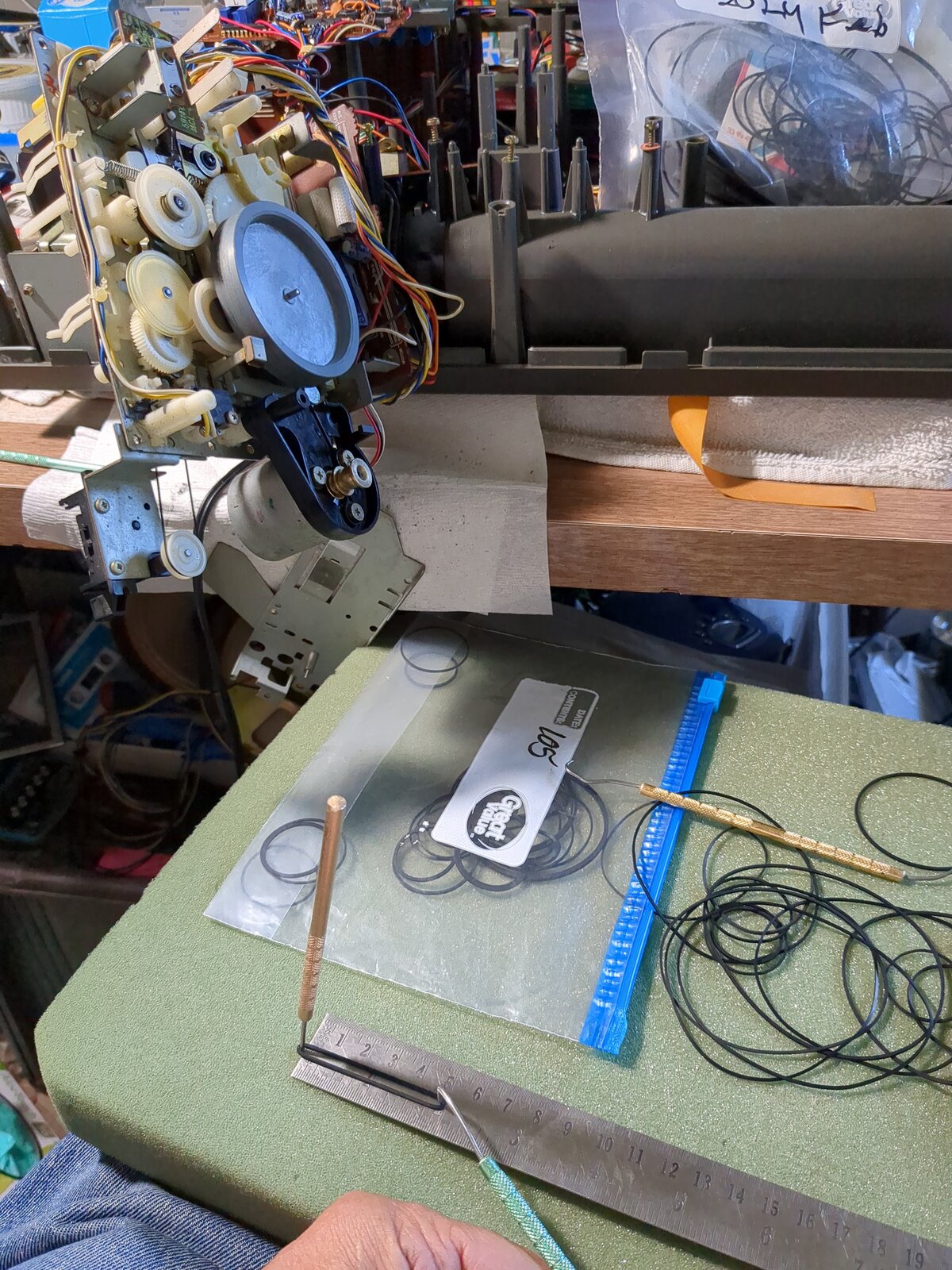

    50 mm belt seems to work the best for the auto stop feature and also the first belt you replace in this model.

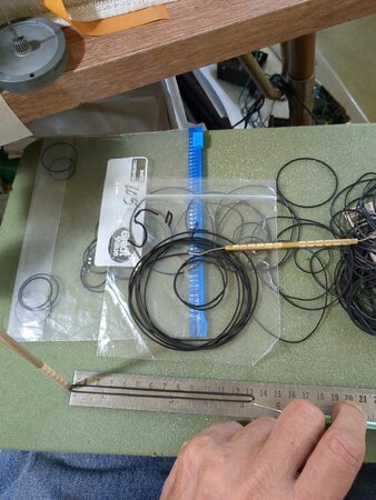

    I thought I would show you how I measure belts. 1721948461108585407900762683748.jpg
    Okay, I'm installing this one.
  5. Cassette2go
    1,614

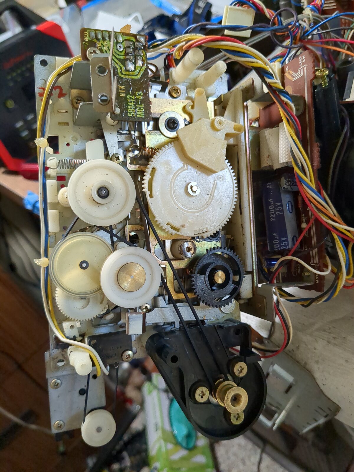

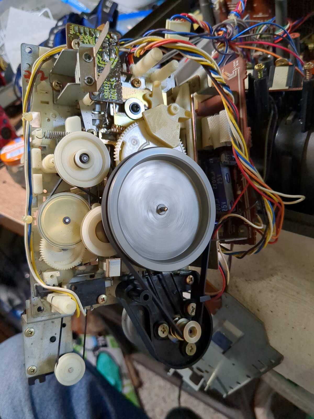

    132 mm roughly for the motor driven belt that drives the take-up reels via the clutch, how I measured it.

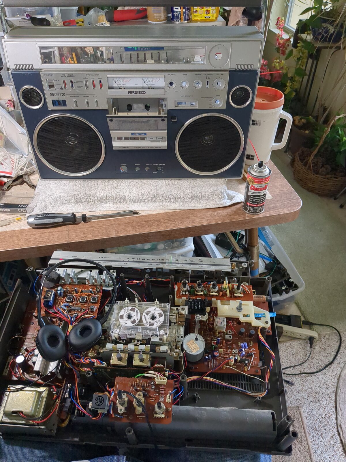

    Here it is installed without the flywheel in place. 17219491018952621313545222982676.jpg
    Well here it is running. I know you can't see it running, but maybe you'll get a blurred picture of the flywheel or something. Let's see.

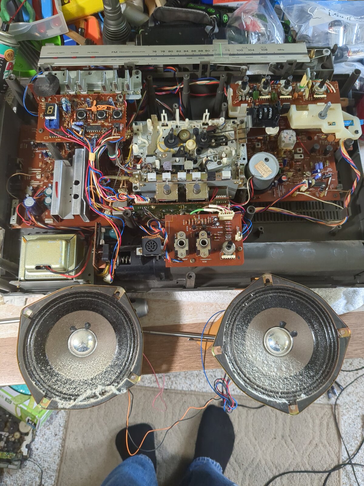

    Hopefully the electronics work cuz I know the speakers do and the radio but tomorrow I'll be getting into this very dirty. Dusty grimy front speaker said and me cleaning that and cleaning the speakers and all that. Let me illustrate with a picture.
    There's a lot of dust in the speakers too.
  6. Cassette2go
    1,614
    Put water all through the front cover, now it's drying
    Soon as this is dry I'll put the cleaned woofers back in.

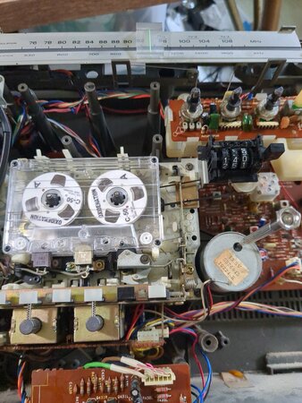

    This is how you adjust the speed by taking your driller screwdriver and putting it into the back of the motor in this model as I'm showing you here and I'm playing my test tape 17220186045832055881378671291031.jpg
    Yeah, it's probably too far away. You probably can't see that. Let me give you a close-up.

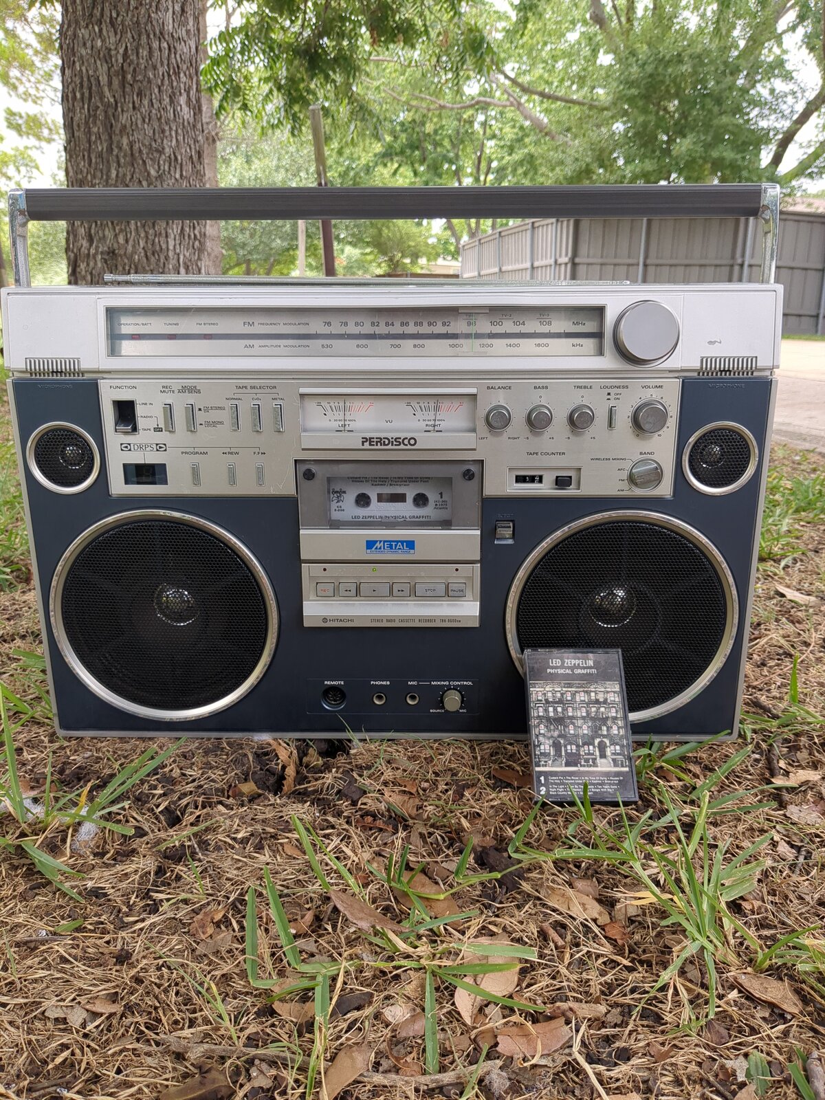

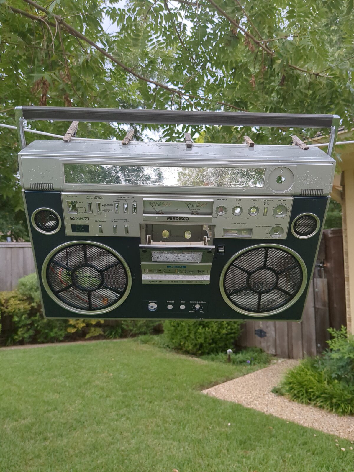

    Led Zeppelin physical graffiti

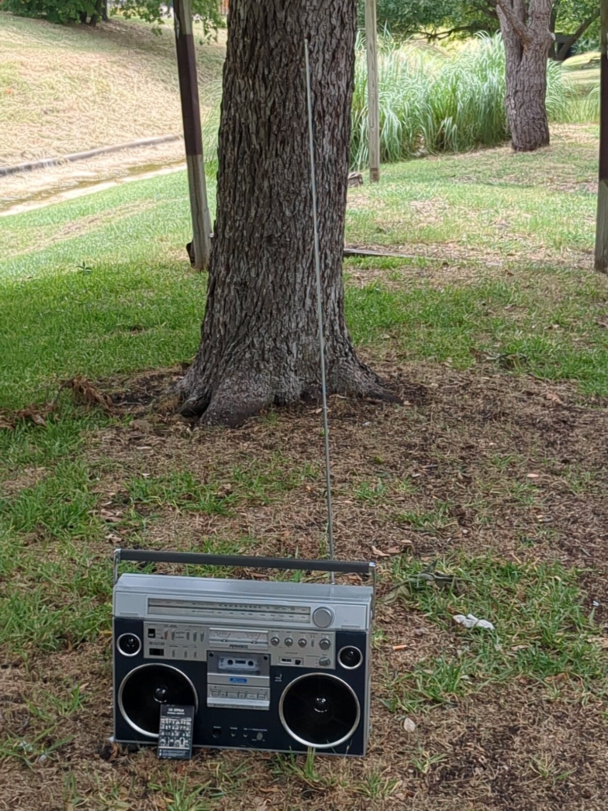

    Outside on batteries
    The antenna is very tall
    Hyperscope likes this.
