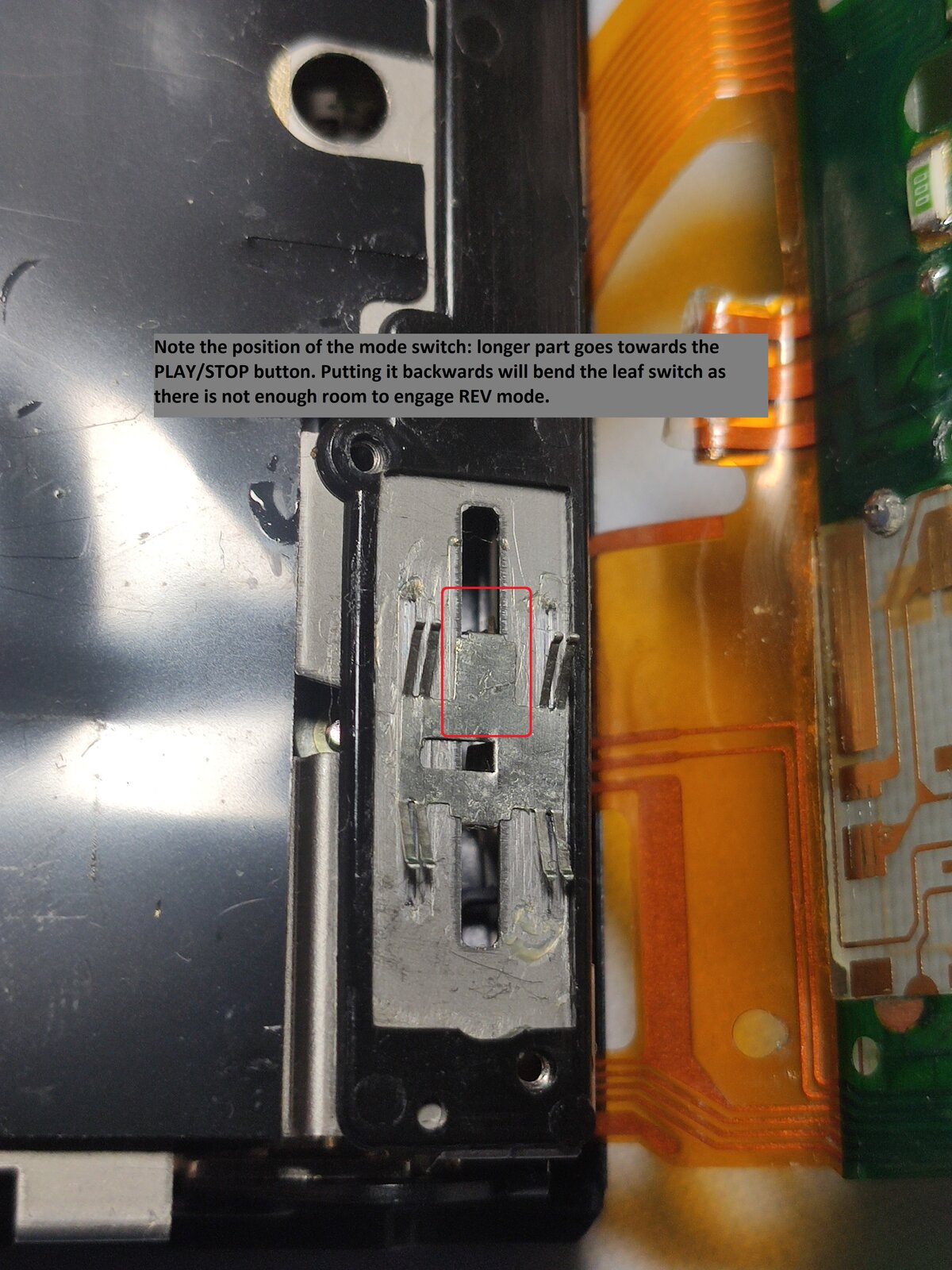

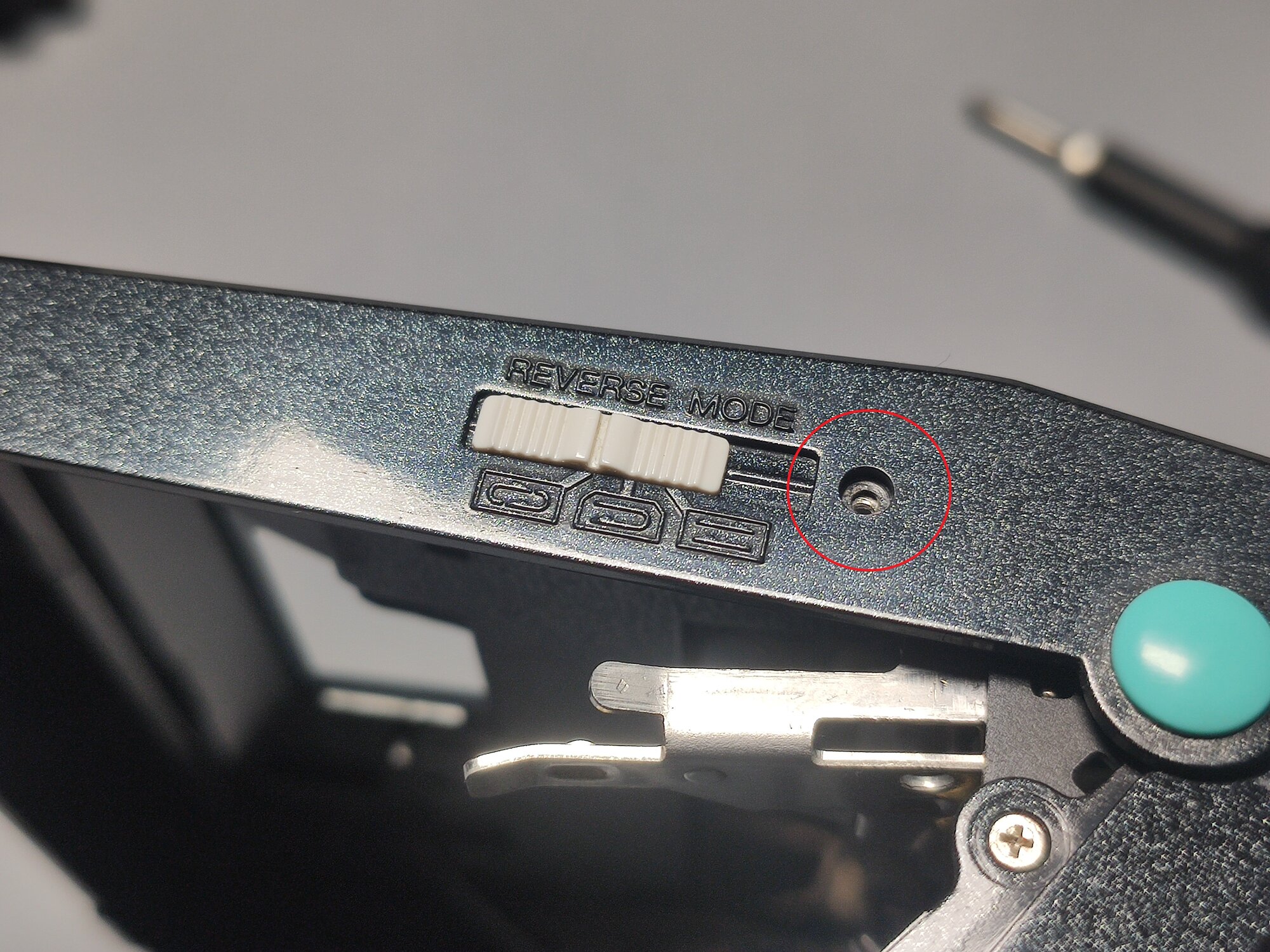

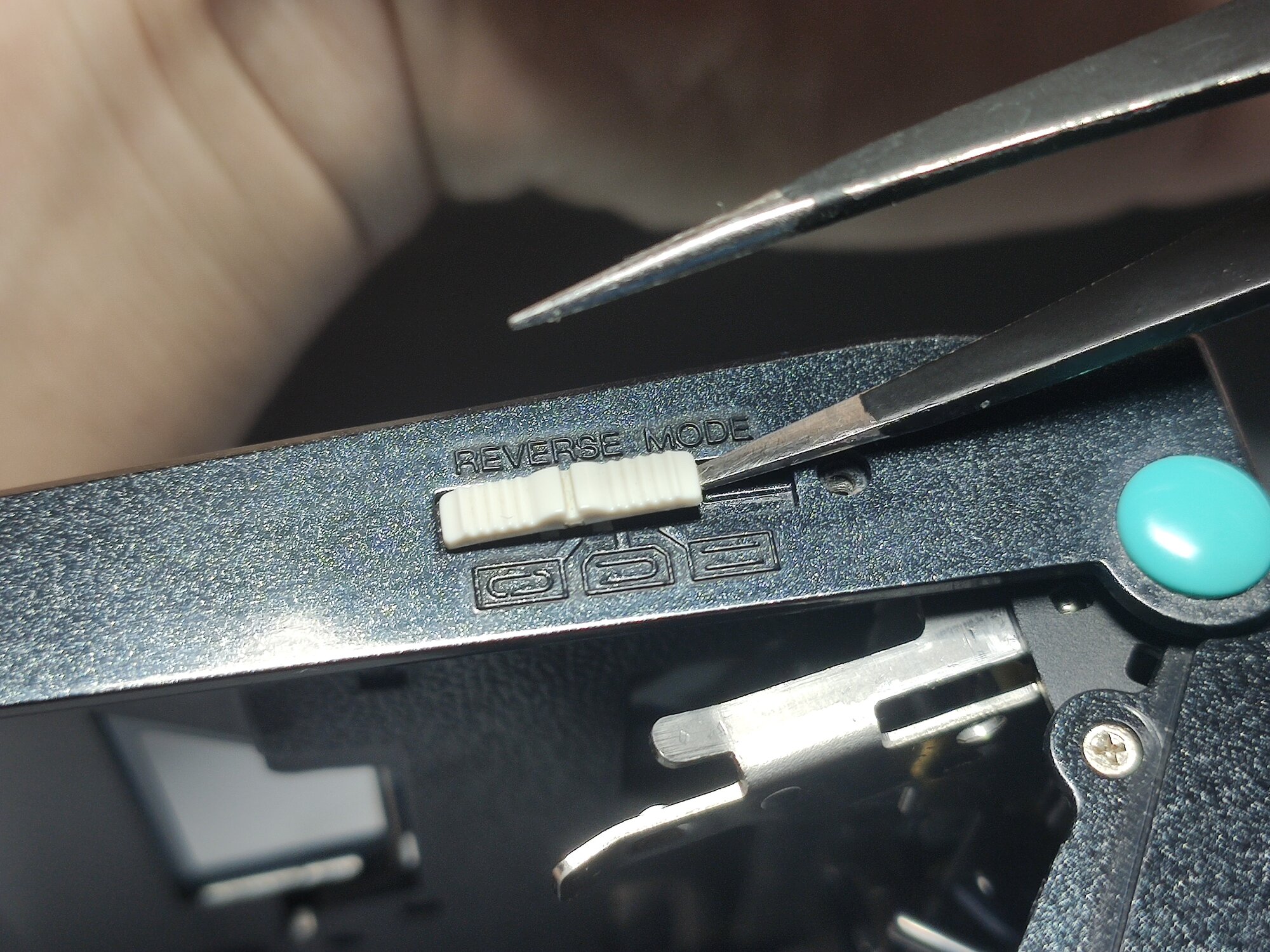

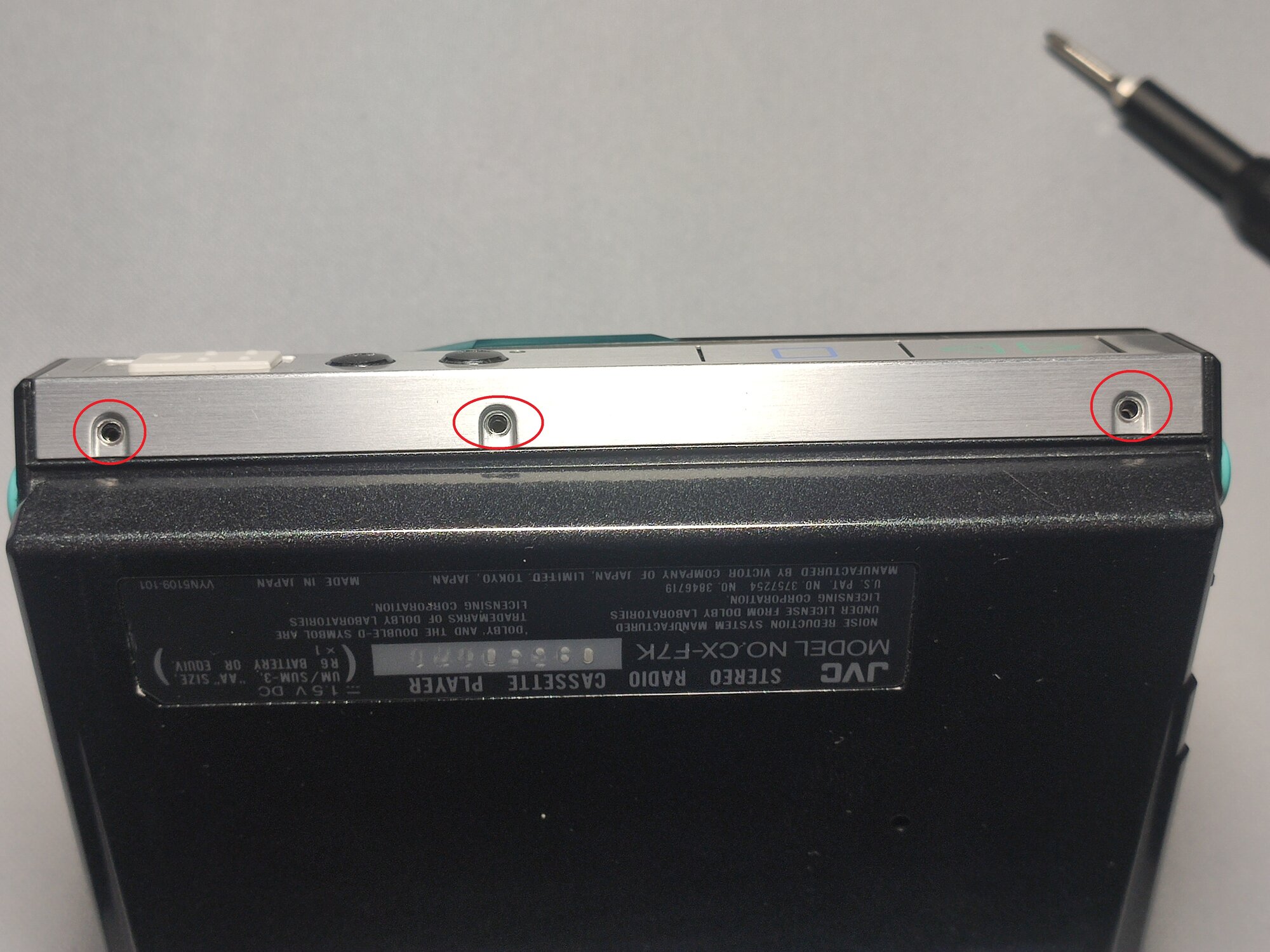

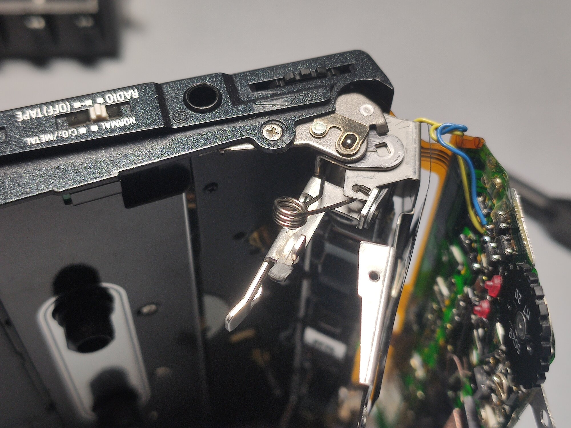

    1. You need to remove the cassette door cover. It's held with 5 screws and the auto-reverse switch.
    Note the switch does not need force to be removed, it should come out very easy.

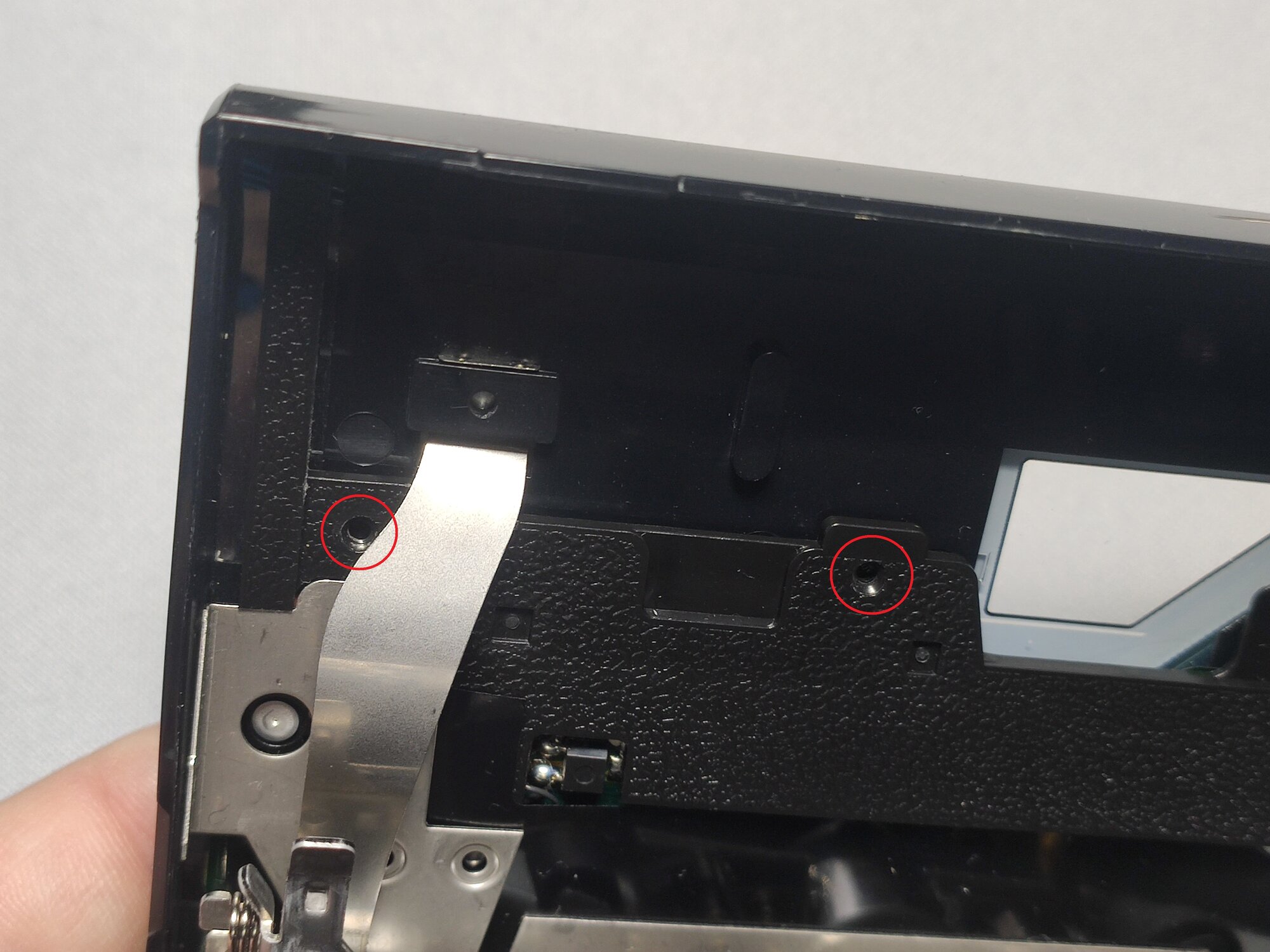

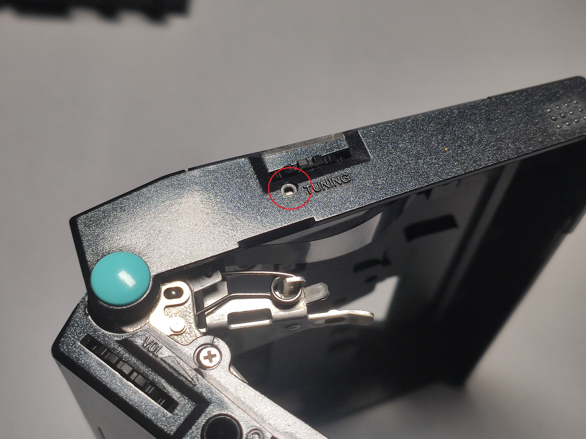

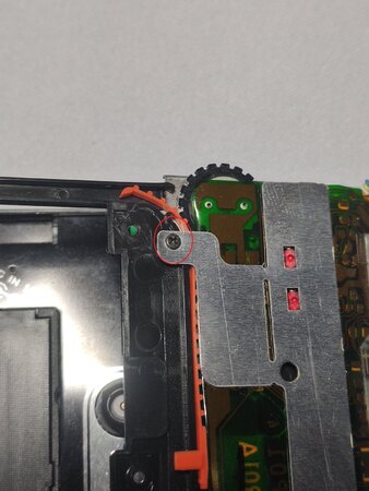

    2. You need to remove the radio scale together with its plastic backplate. It's held with 2 screws.
    Note there is a washer beneath the screw at the top, near the tuning potentiometer.

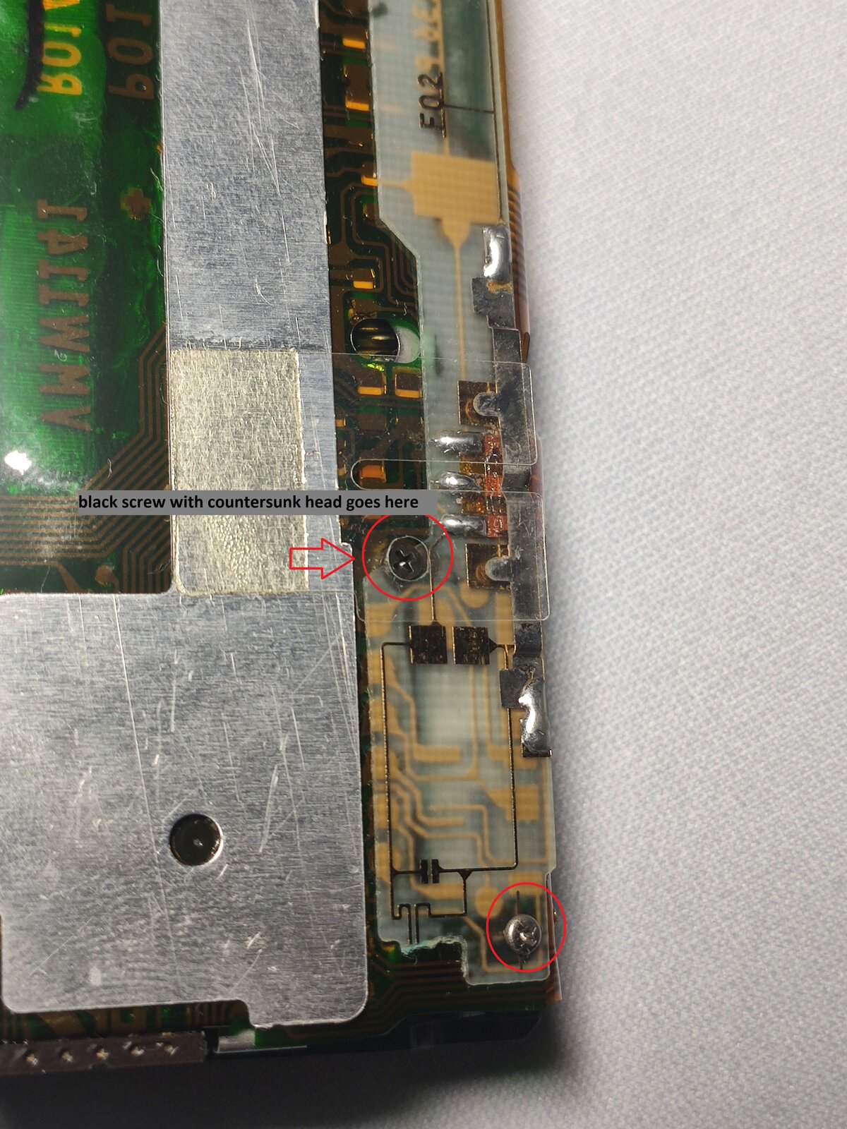

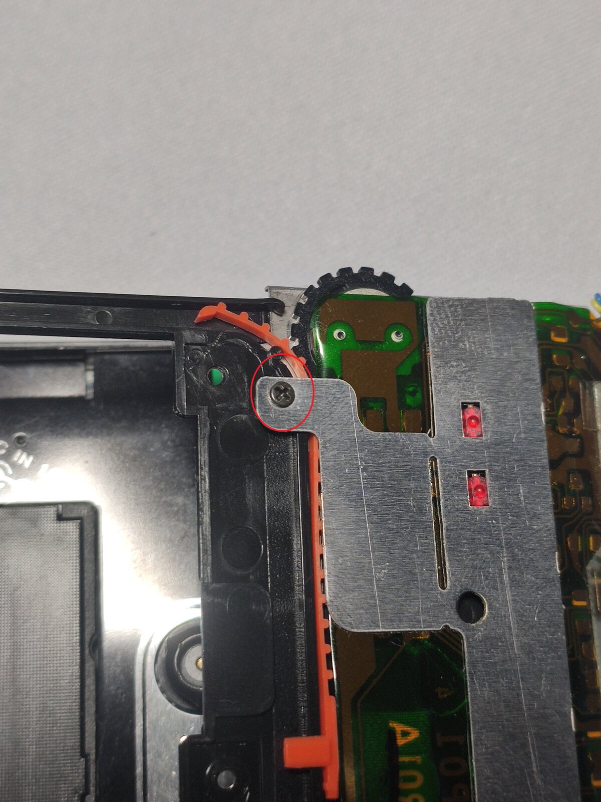

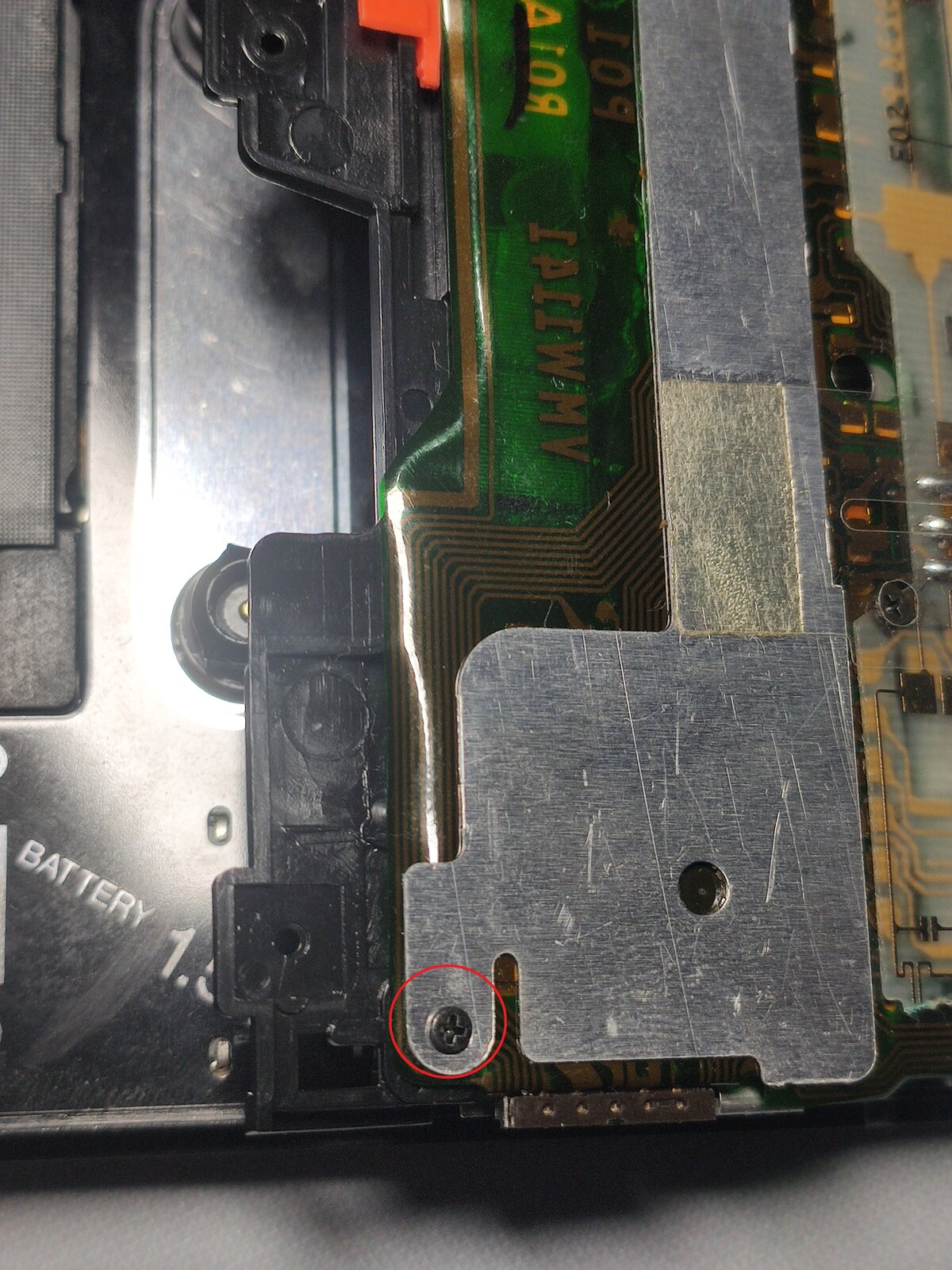

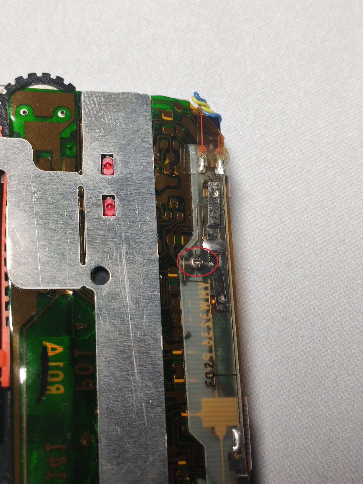

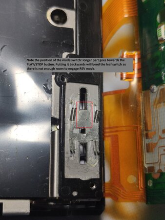

    3. You need to remove the radio PCB (3 screws, one is different note the picture) and the mode leaf switch. Pay careful attention to the leaf switch as it's very fragile.

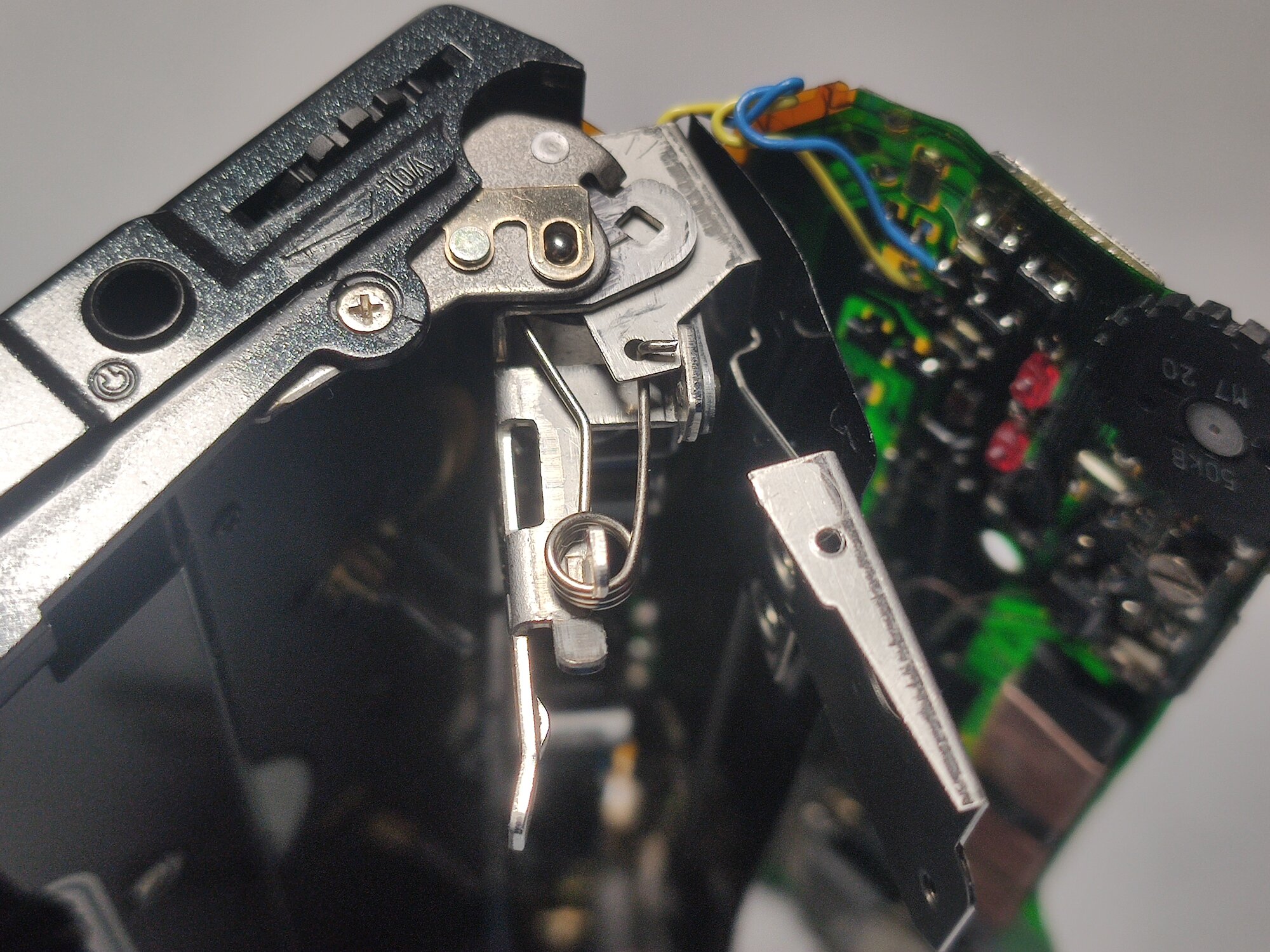

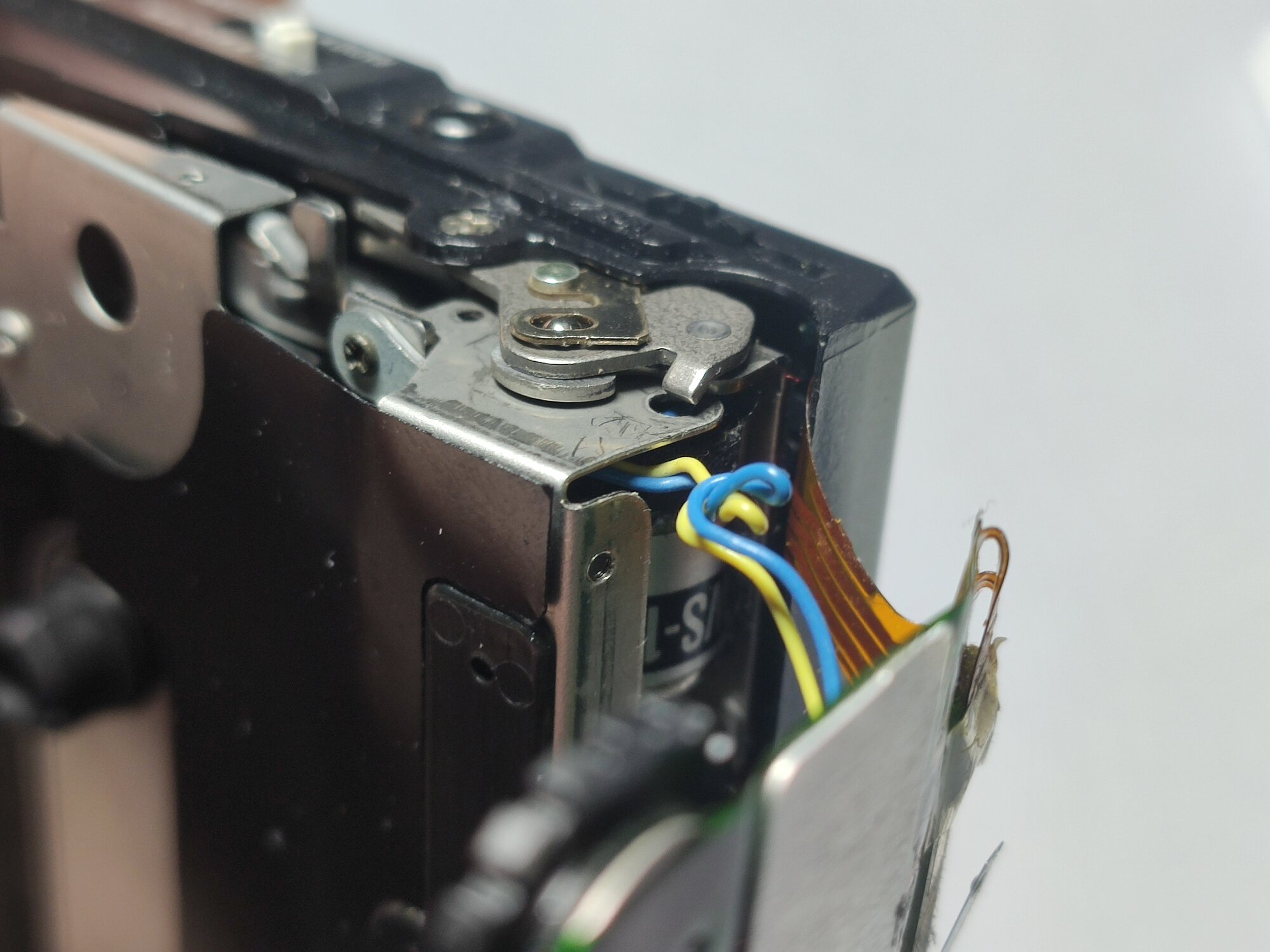

    4. You need to remove the PCB backplate. First remove the spring, then remove the ear near the spring after which it can be slided out completely.

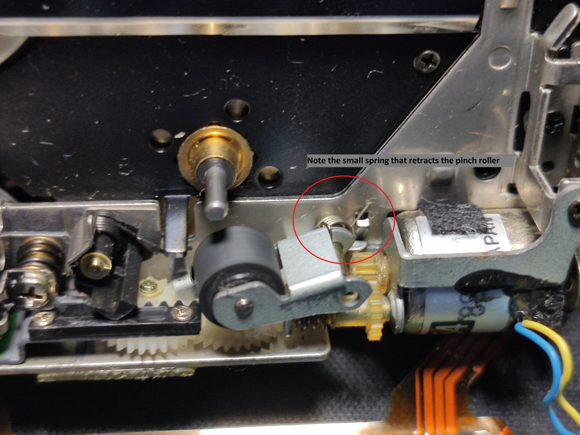

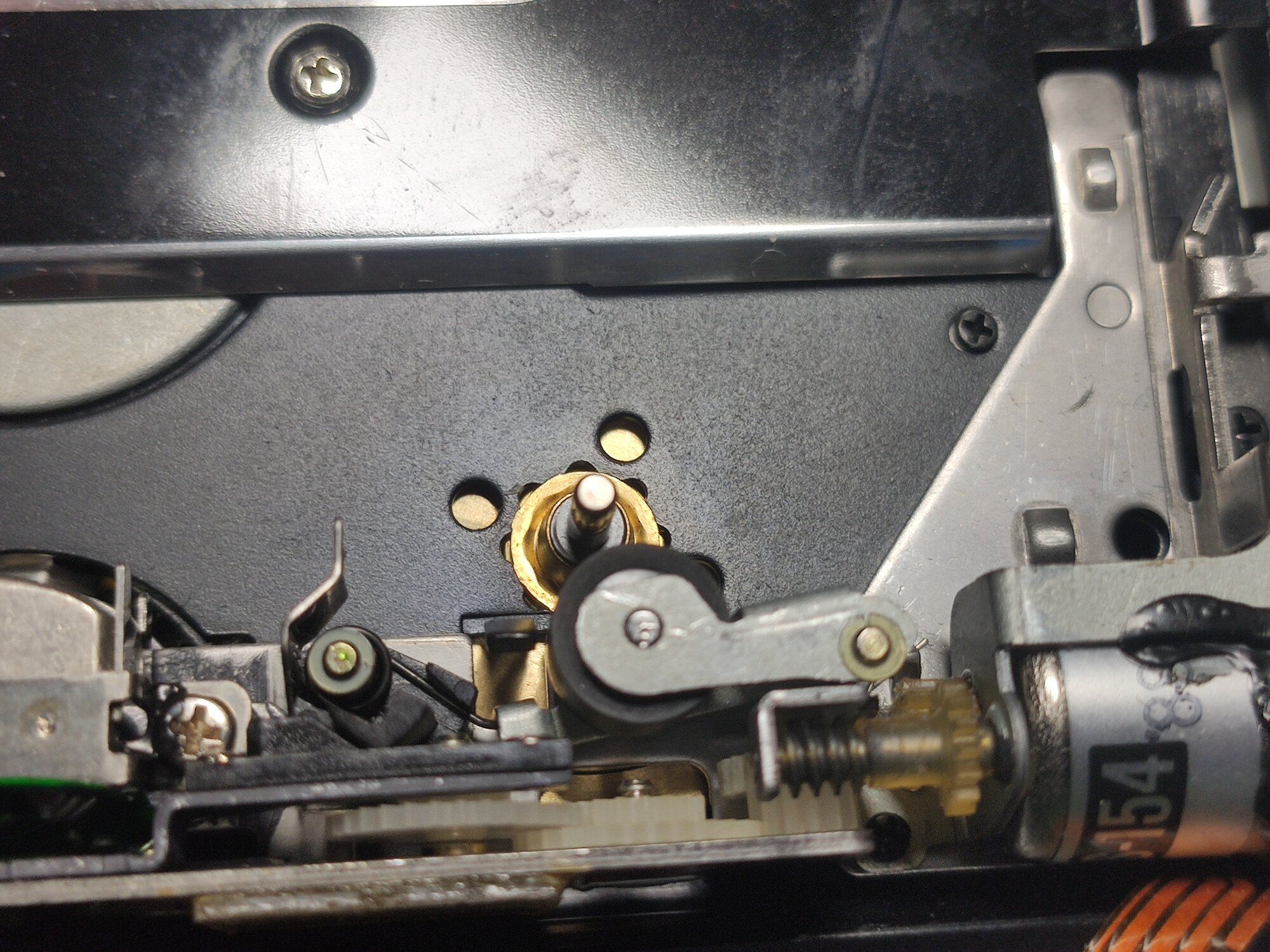

    5. Remove the pinch roller cut washer and remove the roller assembly. Pay attention to the small spring and remove it. It's best to leave it on the walkman in order to avoid losing it.

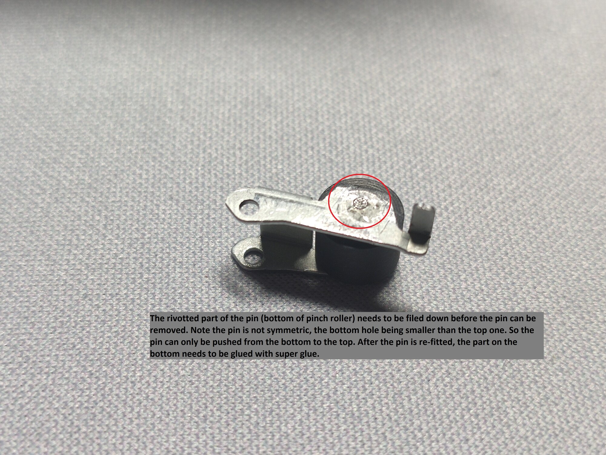

    6. Start filing the bottom rivotted part of the pin until it's flat with the rest of the assembly. At that point you can push it with a small punch or similar metal object.
    Be careful not to lose this pin as it is not of a standard type !

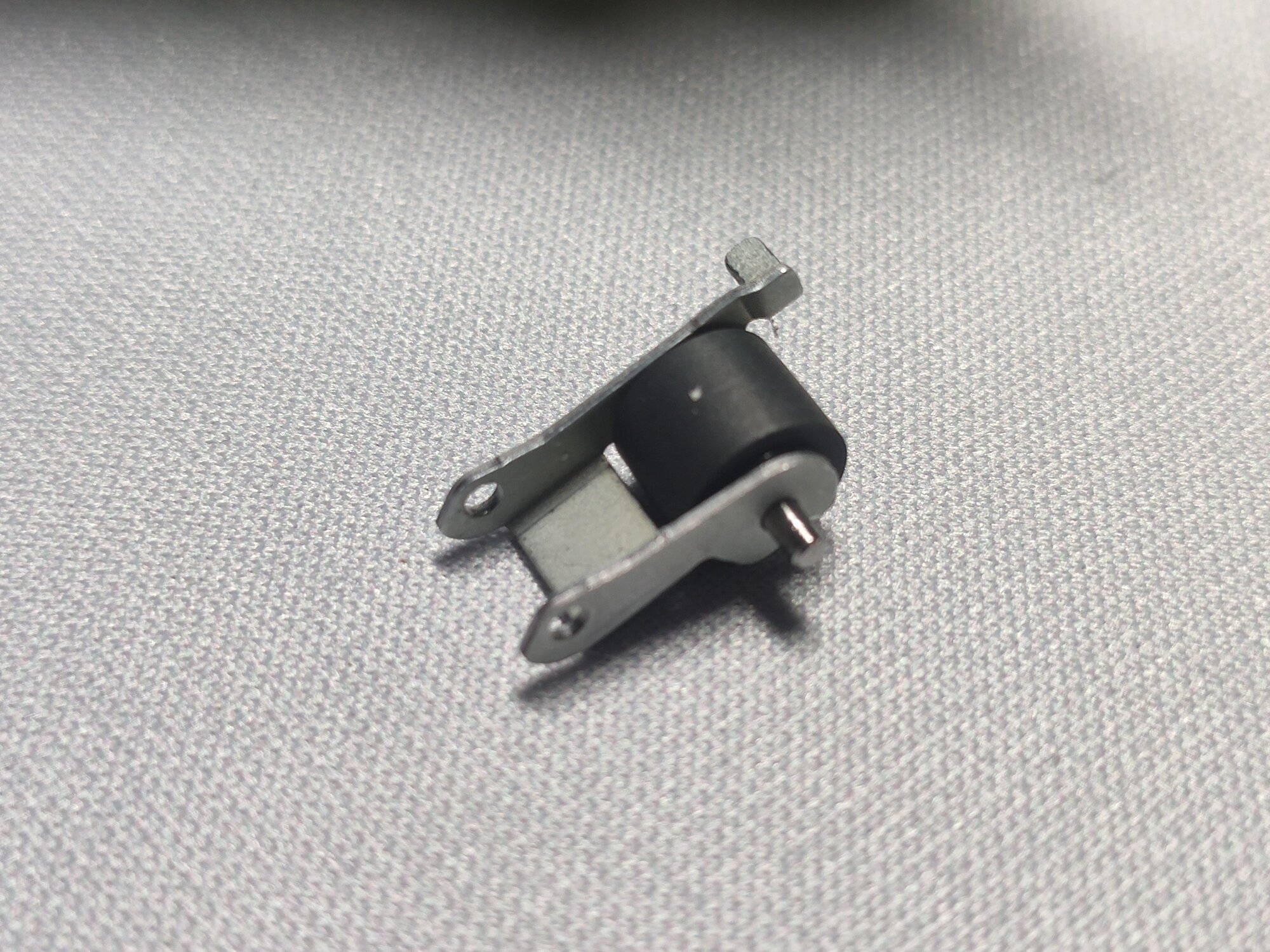

    7. Remove the old roller and replace it with the new one. Put the bin back and glue it where it was rivotted. Don't put to much glue as it can sip though and glue the roller itself.
    8. Re-fit everything in the reverse order.
    9. Put the unit in play and clean the new roller of any grease from your fingers with a cotton swab and IPA.
