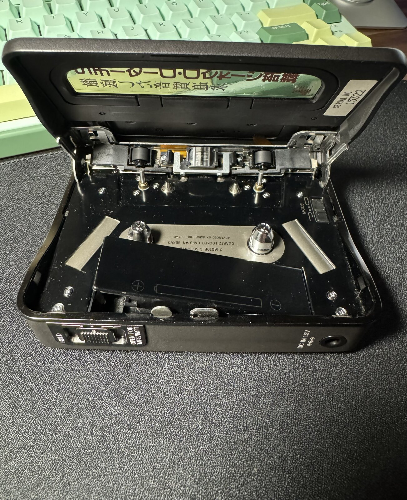

    I recently restored my own DD9, and these are the steps I took:
    1. Replaced the drive belt, rubber tires, and pinch rollers. Regarding the pinch rollers, I personally don't recommend replacing the original ones unless they are actually worn or damaged. The original pinch rollers in my DD9 had obvious grooves worn into them, so I replaced both of them.
    2. After removing both capstans and flywheels from the chassis, I cleaned the two capstan bearing holes (the holes that the capstans pass through) using small cotton swabs and isopropyl alcohol. English is not my native language, so I used ChatGPT to help translate this post. I hope it clearly conveys what I mean.
    3. Applied a small amount of watch oil to the base of both capstans before reinstalling them.
    4. Lubricated the front bearing of both motors with a tiny amount of watch oil.
    5. Used the lubricant very sparingly and made sure it didn't spread to other parts of the mechanism.
    6. I did not touch any of the plastic gears inside the DD9.
    7. I did not remove the head assembly for cleaning.
    8. Before inserting the first cassette after the restoration, I thoroughly cleaned the entire tape path, including the capstans and the playback head.
    Fortunately, this DD9 had no electronic faults, so I didn't need to solder anything onto any IC pins. That was a huge relief.

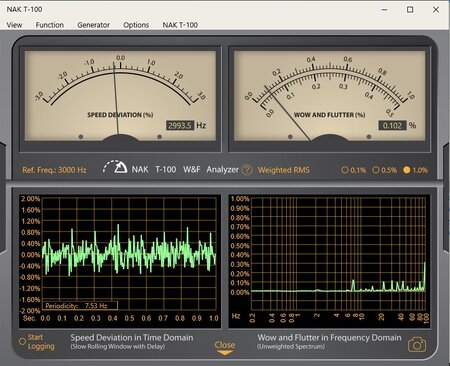

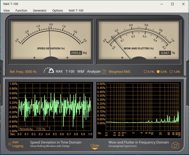

    After the restoration, the W&F in forward playback measures approximately 0.04–0.06% WRMS, and I am extremely happy with that result.

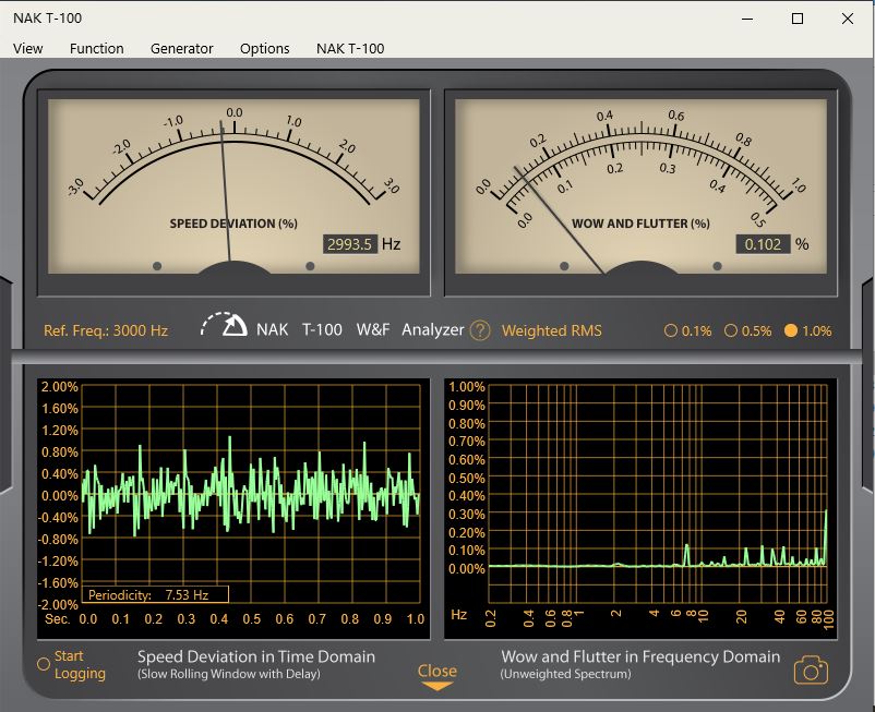

    However, the reverse playback W&F is around 0.10% WRMS. Although this is noticeably worse than forward playback, I currently don't know how to improve it any further.

    There are a couple of things that can be tried to improve the W&F on REV, although success highly depends on cause:
    1. Can sand the motor spindle to remove any imperfections in the surface;
    2. Check/adjust the motor position so it's perpendicular to the flyweel;
    3. Check for any rust spots on the REV capstan; If identified capstan can be sanded (while rotating), but keep in mind reducing the diameter will also reduce the speed on that side.
    1 and 2 is something I always do (on all DDs) and can tell these can improve the W&F although not by a lot (like don't expect it to drop in half from this alone).
    On DD9 specifically have seen rusty capstans to cause increased W&F. So if any pittings are visible, that's rust.
    When it comes to motors, FG coil, flywheel:
    1. Motor can be a problem (weak magnet, rotor touching case/magnet) however unlikely.
    Also motor would cause flutter, which I don't see in your measurement. Rather I see a 7-8Hz peak (not visible in FWD measurement), which would rather suggest it's capstan related.
