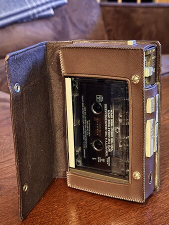

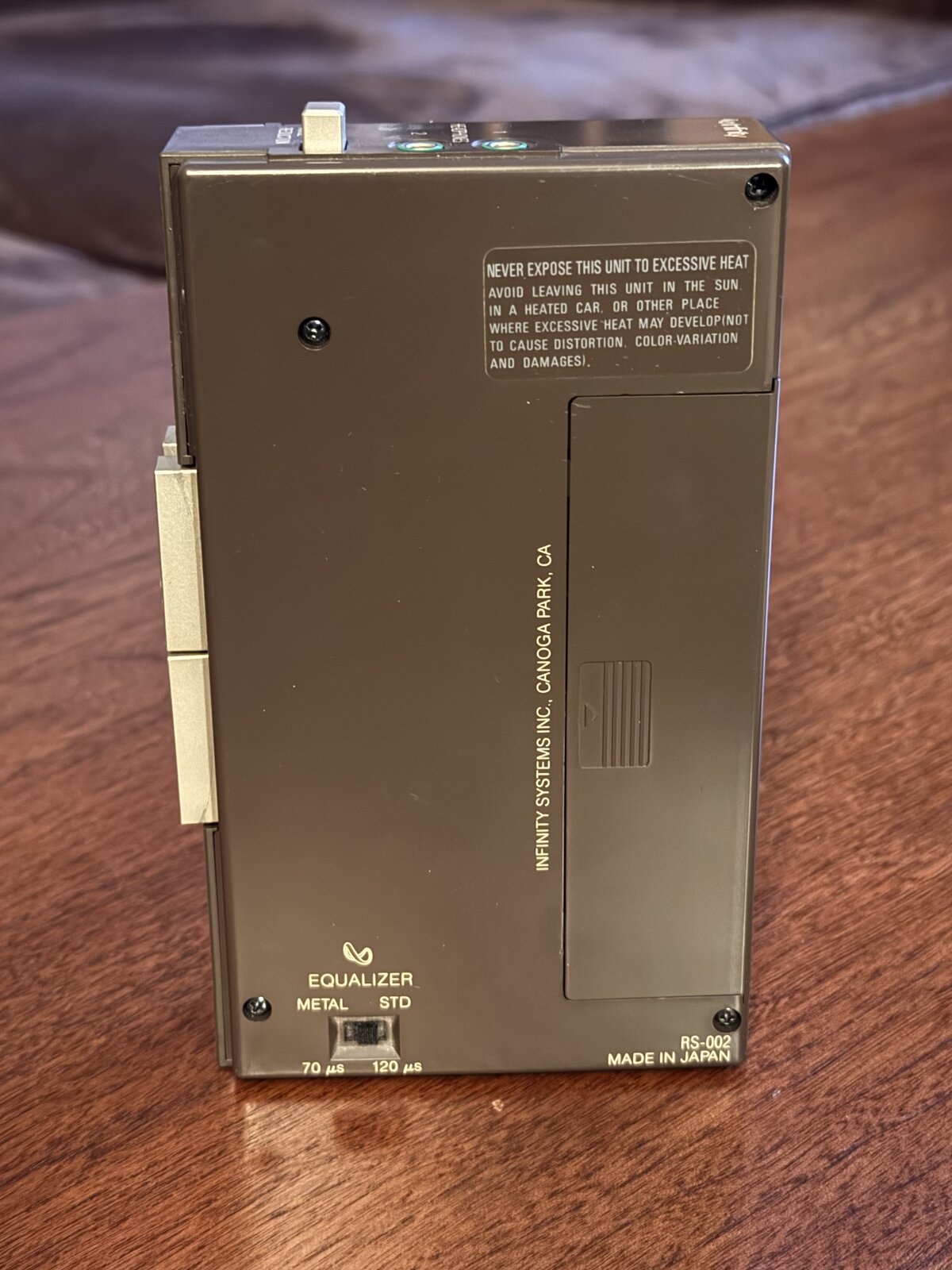

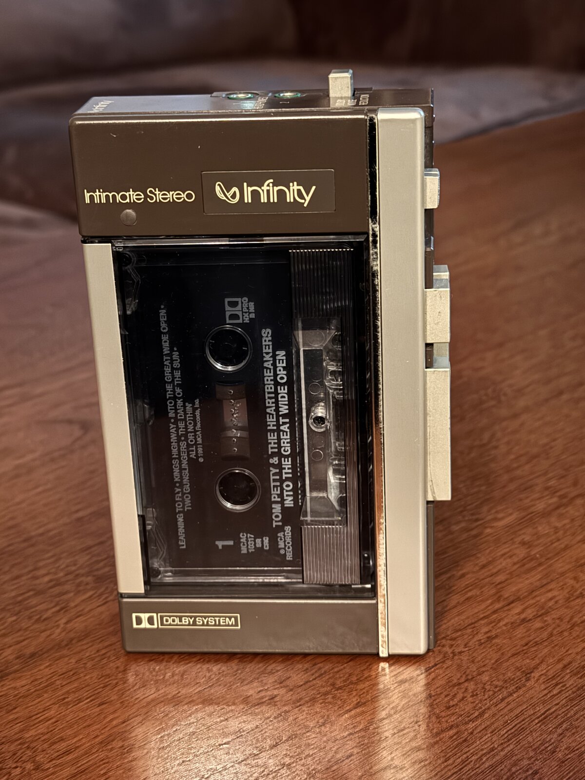

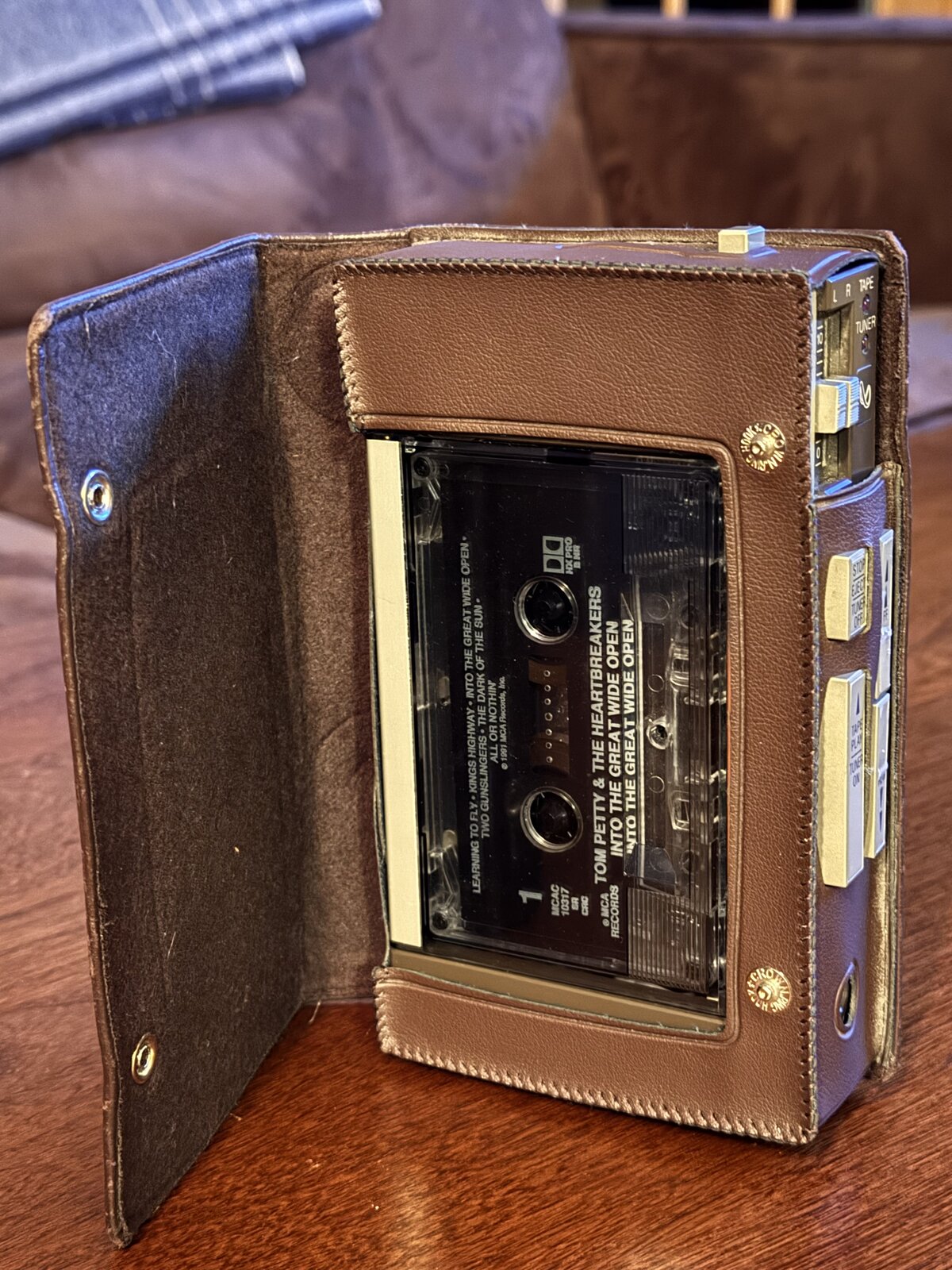

    This popped up on Marketplace in Minneapolis MN this morning so went and picked it up. Seller also had on EBay for lower price. When I got there the unit would not work at all. Negotiated even lower price and on my way home.
    Same thing when I got home where cassette didn’t seem to play. Not sure if it just needed some exercising but when I plugged in headphones and put a tape in it magically started working. Playing slow but I assume original or old belt. Unit is EXTREMELY clean. Not sure if it was used much. Seller said he bought it roughly 30 years ago. I know basically nothing about these units. Not a ton of sales history. Will dig for YouTube content tonight. Cheers…

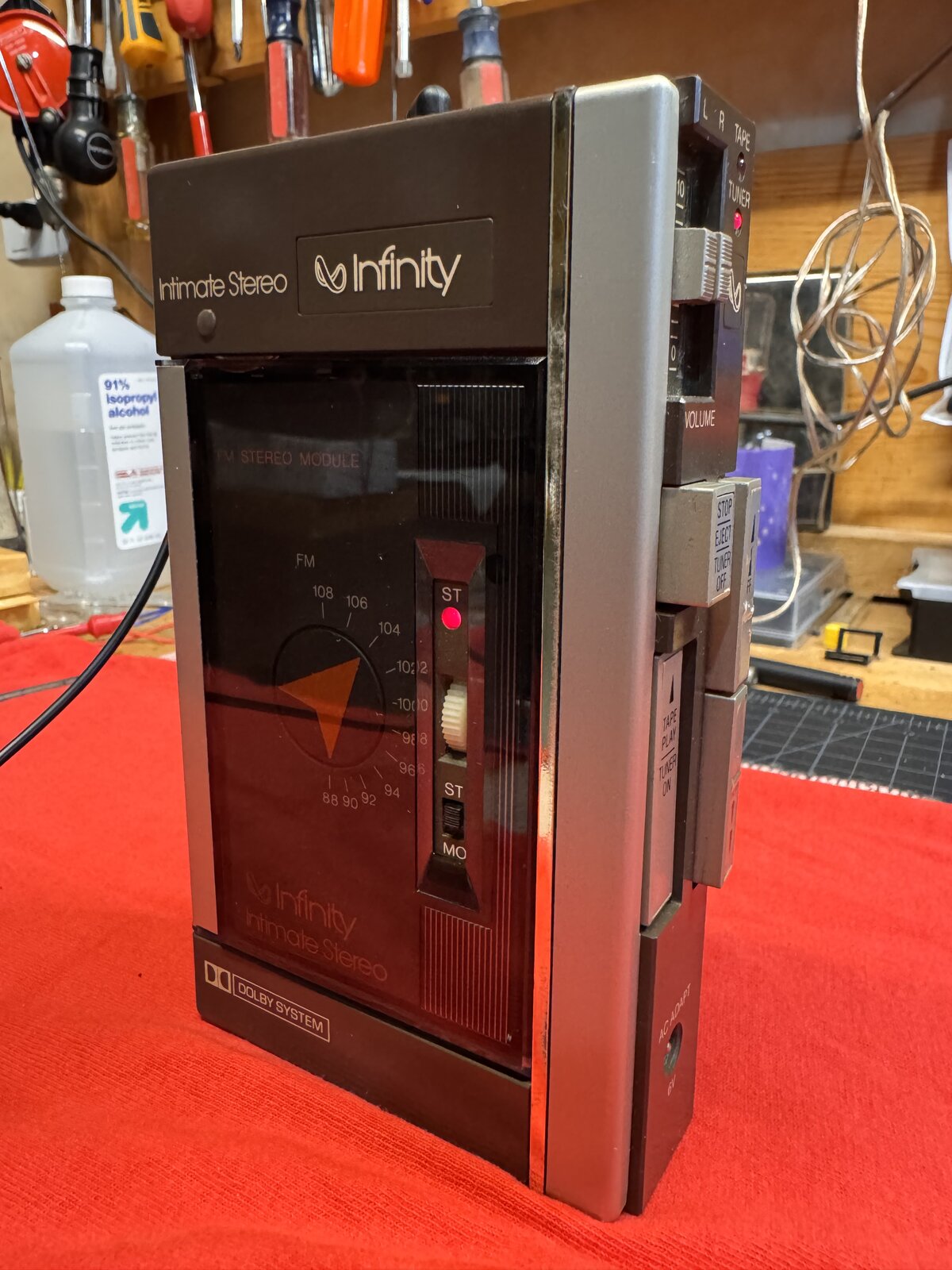

    Ok so EBay FM pack arrived this morning. Installed and other than the scratchy volume pot had decent sound out of both channels. No stereo until I flipped the stereo/mono switch back and forth couple times and stereo light came on and all working. So as of now I have fair amount of wow/flutter and scratchy volume pot. So decision point, do I go and recap, or just try to figure out how to lubricate tape mechanicals and pot sliders and see what it sounds like.
    Valentin, do I need to unsolder all wires on both sides of this top PCB flex circuit layer to do mechanical work or is it an option to scoot things without unsoldering everything? I’m OK replacing all caps but don’t want to solve one problem (that I’m not sure I have) and create another.
  10. Valentin
    1,994
    I wouldn't jump on recapping, unless there is visible leakeage. To see that you need to remove the small preamp board and check on the bottom of it.
    If you have good sound with plenty of bass and loud volume, it's very likely the caps are good (case in which I would leave them alone).
    As stated initially, it's always possible you're lucky to have either a newer version of the walkman which uses different brand caps or a different batch of caps that do not leak.
    It is possible to get to the mechanics without removing too much wires.
    When I restored these, I preffered removing the whole boards as it was easier for me to work on them removed, but if no recapping is needed, wouldn't bother to desolder all wires.
    The wires below the motor will need to be removed for that Dolby switch/LEDs board to come out, but apart from that there's not much else.
    As for the W&F it's visible the belt is stretched and has took the shape of the pulleys, so that will need to be replaced along with lubrcating the mechanism.
    Also don't forget to check that clutch spring tension, on units I serviced it was too low and spring needed to be shortened.
    Again don't know if they fixed this problem in a later revision, but it's something to be checked.

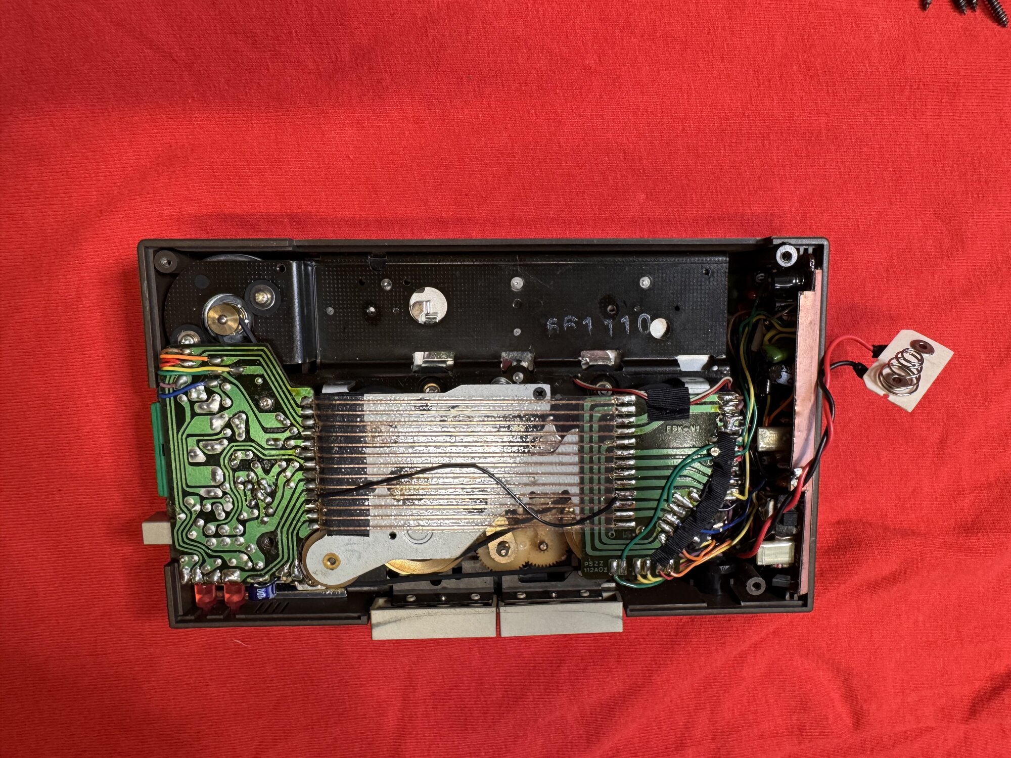

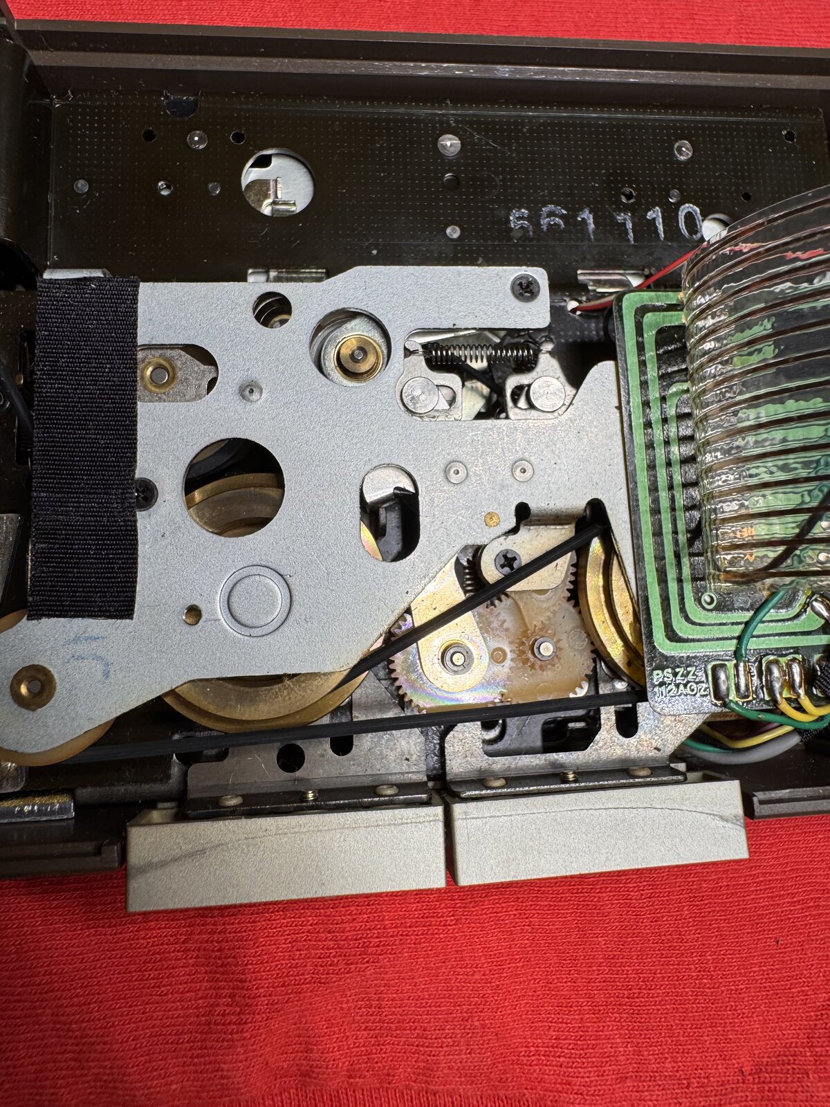

  11. Dauner
    Dauner Member
    66
    Hudson, WI
    Left PCB removal pretty easy. From here not sure of next steps. Is the right PCB glued or adhered to the metal top plate in the image? Not budging at all. No screws holding board down that I can see. For the metal plate there are two Phillips black screws. One on the left by the black tape strip and then one on top side of image. I can’t get these to budge at all. I generally have a decent sense of really tight vs I’m going to strip this. Valentin do you remember these screws removing easily for you? If I remove these screws and lift plate up does the right PCB come with it? Thx
  12. Valentin
    1,994
    Thinking of it, these screws did take some persuasion to remove, but not to the point of stripping. Be sure to use a JIS screwdriver btw.
    As for the small board on the right, I do remember it took some effort too, can't remember if there's any glue but it should come out, there are no screws holding it.
