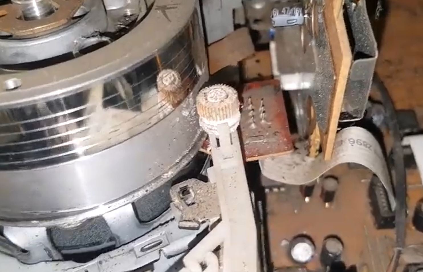

    I recently acquired my first VCR. I came across a small, portable 14" Philips 14PV183 all-in-one TV and VHS recorder at a thrift store and was allowed to take it home for 5 euros. I especially liked the original box it came with, which had giraffes on it, so I couldn't resist trying it :)
    The first time I tried it, it worked perfectly. After that, I let it perform the head cleaning procedures, but after that, it just malfunctioned. Eventually, I cleaned the heads manually and disabled the head cleaning system. I now use it to digitize old video tapes. I can imagine that collecting VCRs is appealing; it's a nice piece of technology, but I'm not going to start.

    I wonder how the head cleaning feature worked, does it have a post with cleaning cloth on it?

    It works quite simply. There's an arm with a plastic brush that looks like a small cog, which is held against the head during cleaning. That plastic brush had partially deteriorated and was actually making the head even dirtier. This immediately stopped the good playback. I removed the plastic - Philips ;) - cog, and now no more problems :)

    Found a picture of the cleaning brush. Pic is not from my example, that was like new inside. But the brush was just as worn out as this one. Its really cheesy plastic.

    It was probably for brushing off any flakes, it did it's duty and now is gone. For how much tape flaking happened, it's surprising these decks lasted so long.
