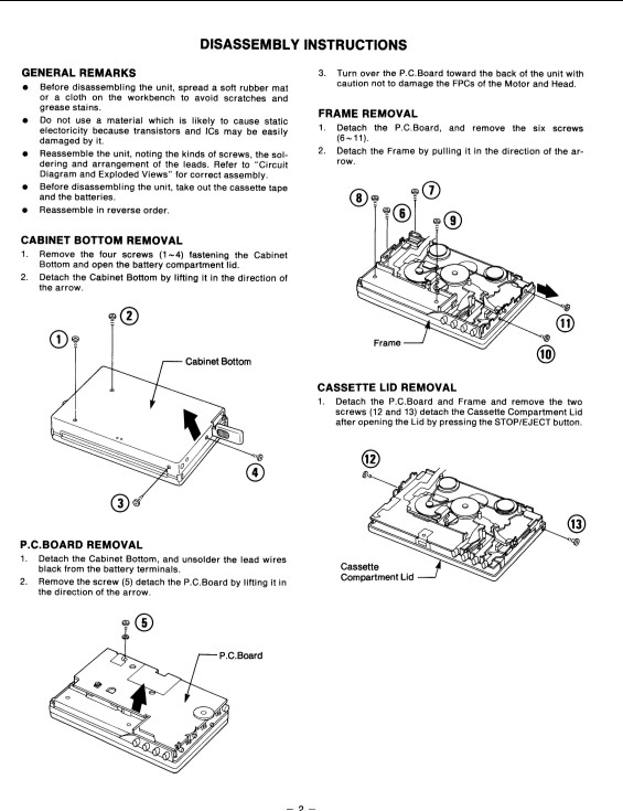

    Hi all. Having just bought one of these (not working) , I need to open it up to check the belt. I am hoping someone out there can help me decide how to go about the disassembly ? There are few screws on the exterior, but many many more inside and I don't want to go about it the wrong way.
    Anyone there able to offer advice please?

    If your goal is to check or change the belt following the first two steps you should be ok , I'm not familiar with that model.

    thanks for this great information - and for the tip about placing the screws in order on tape !
    I removed the base and the pcb to reveal the remains of the old belt. Sticky but in place like it was frozen in time.
    I have just ordered a replacement?
