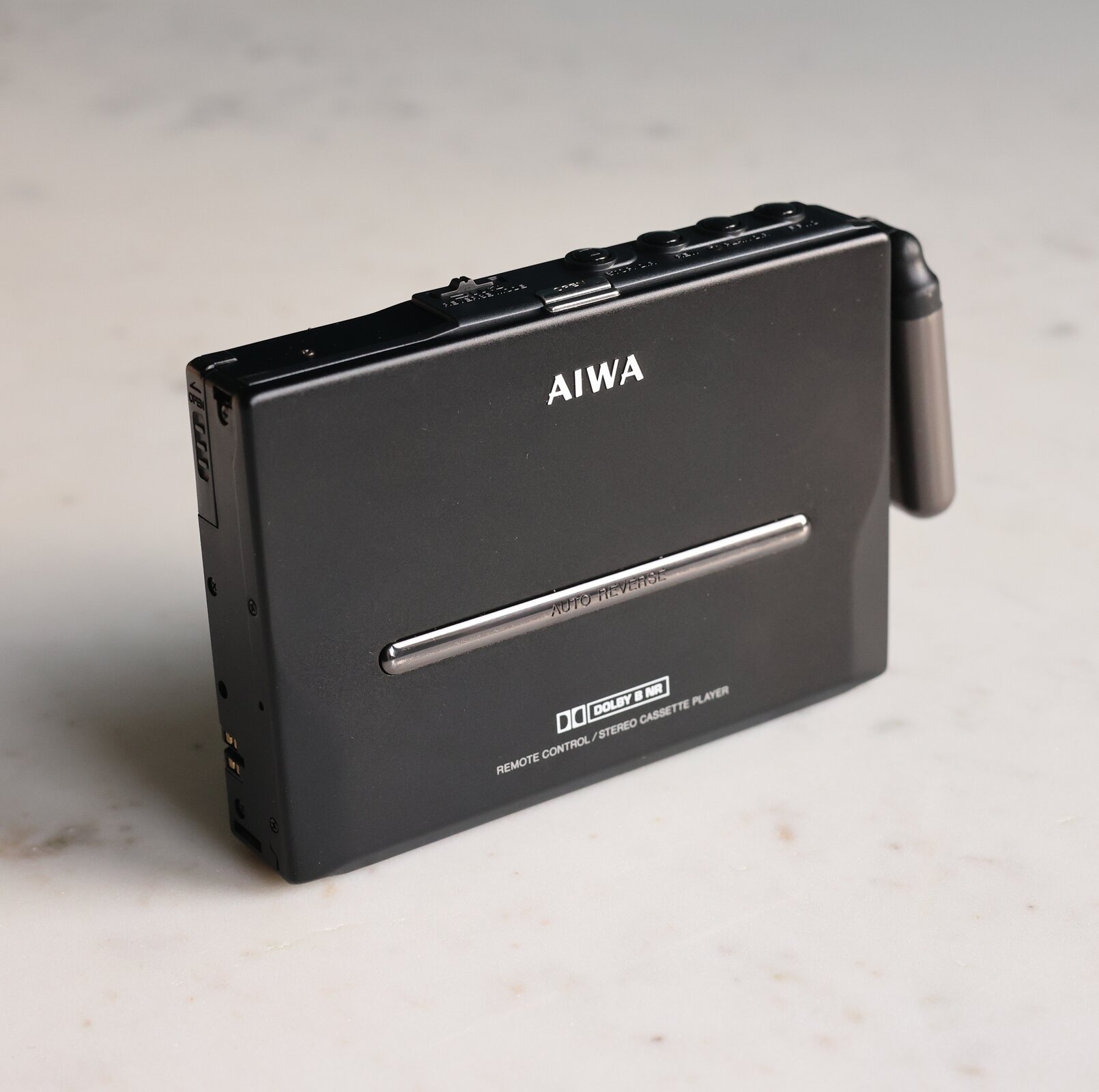

    Hi all.
    I have just restored an Aiwa HS-PL55. First thoroughly cleaned the board and recapped, but had issues with no audio on right channel and some volume issues on rev playback. Traced these down to a a couple of bad resistors and weak pins on IC1, but after a reflow and sorting out some traces and an open via, everything started working nicely - perfect and crisp stereo sound on both directions and both channels.
