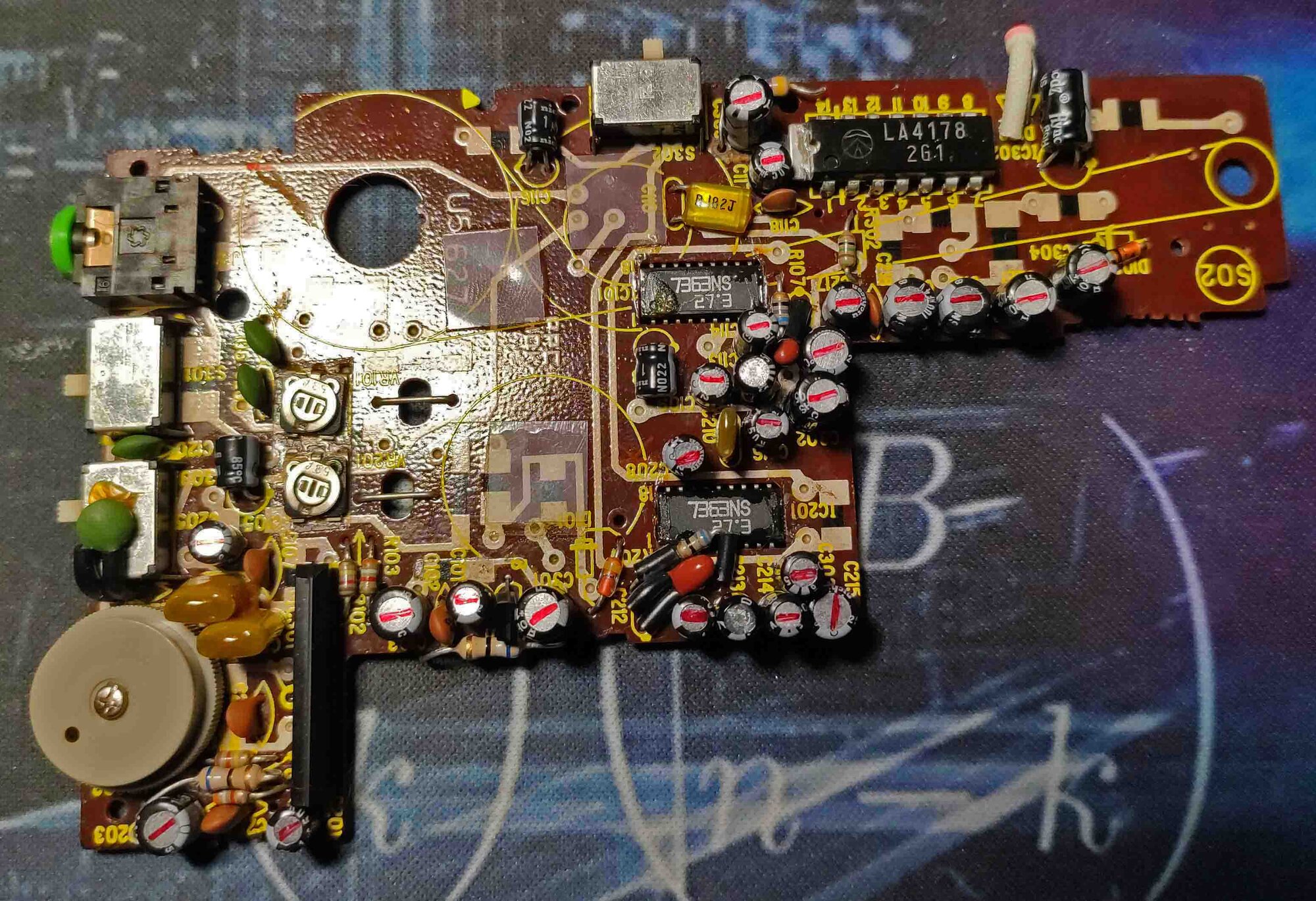

    The first and biggest problem were the CE brand capacitors that have leaked all over the board. Yet another problem with this board is that most of the resistors are carbon printed and corrosion from leaked electrolyte can also destroy them.
    It is to be noted a pattern that I have observed regarding these CE brand capacitors (which I have found to be leaky in other walkmans as well, especially the very small footprint ones): not all of them were leaky, but only the higher value ones (100uF and 47uF),
    which leads me to believe that the manufacturing technology was not that good for making large value capacitors with small footprint. Found this pattern in other walkmans that use CE capacitors, one worth mentioning being the Infinity Intimate Stereo.
    I did replace all capacitors anyway, except 2 of them (0,1uF) that I didn't have on hand and were not leaky.

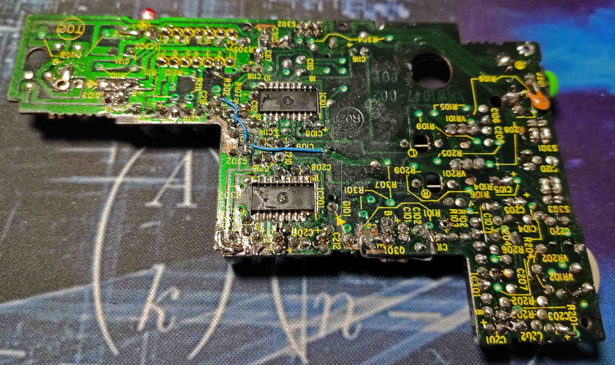

    After the replacement, I noticed that 2 traces were completely corroded; I have repaired them with a fine wire.
    At this point in time I decided to make a test and see if the electronics side works. It did kind of work, but not as it should; the volume was low, especially on one channel.

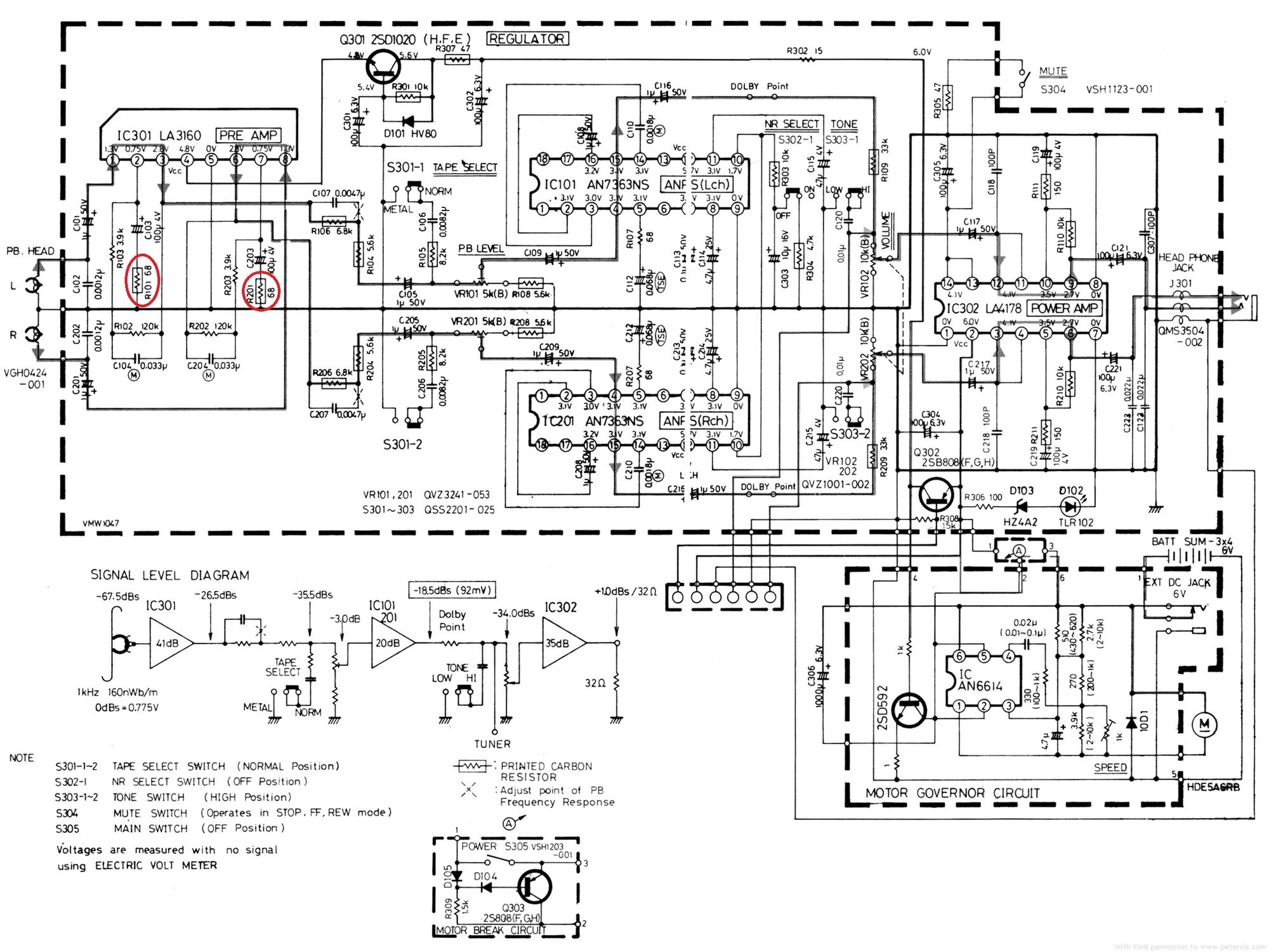

    Started to troubleshoot using a test tape and oscilloscope. I found that the signal coming out of the head preamp was low, which made me suspect the feedback resistors, which were carbon printed on the PCB.
    After finding a schematic of the JVC CQ-F2, which is nearly identical to mine, I measured the resistance of those feedback resistors and found both to be too high. The final solution was to bypass them using normal through hole 0.25W resistors.
    I did find a third carbon resistor that was eaten away, in the muting circuit. Those 3 were the only affected.

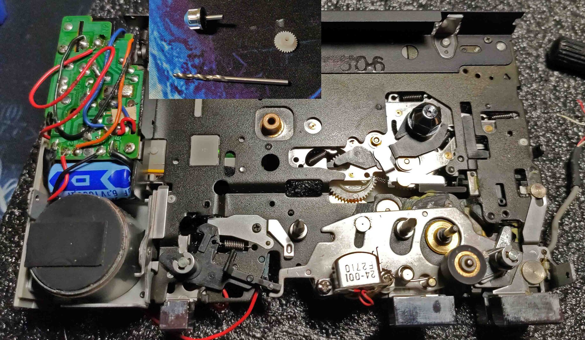

    The next part was the mechanical: the belt was loose, the table reel gears were both cracked and the head screws were both loose.

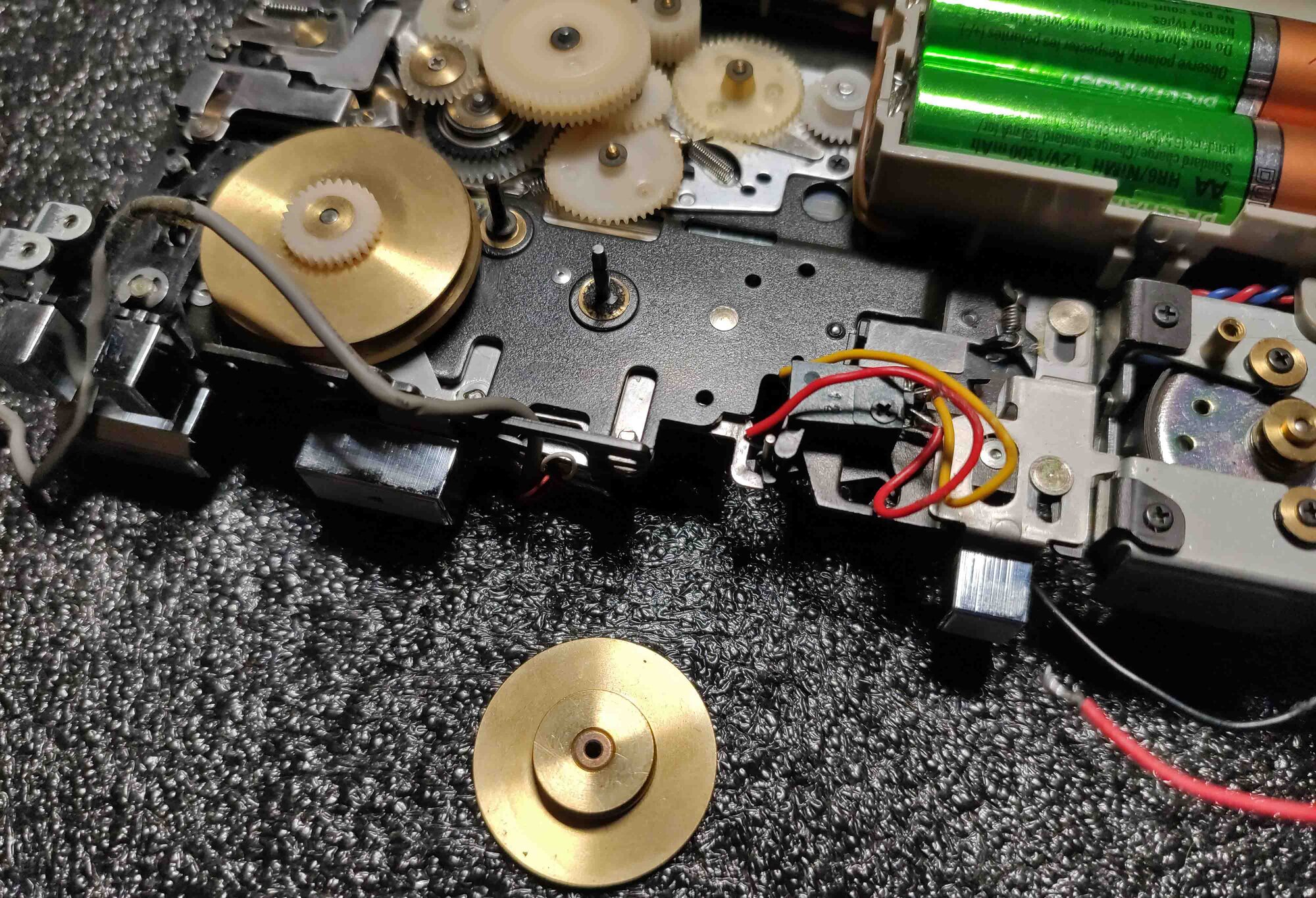

    The reel gears were taken out and the hole was enlarged just a little bit with a 2mm drillbit. The next step was cleaning the reel tables shafts and relubricating them, before glueing the gears back to the reels.
    I also lubricated the capstan bushing, the intermediate flywheel and motor bushing at this point. After cleaning the pulleys' grooves, I found a belt from Marian's 13 belt set that would fit (it's thinner than the original 1mm, but it works fine).
    Next, I adjusted the azimuth, applied some glue to the screws, cleaned and demagnetized the head and pinch roller (which seemed that it was never cleaned before).

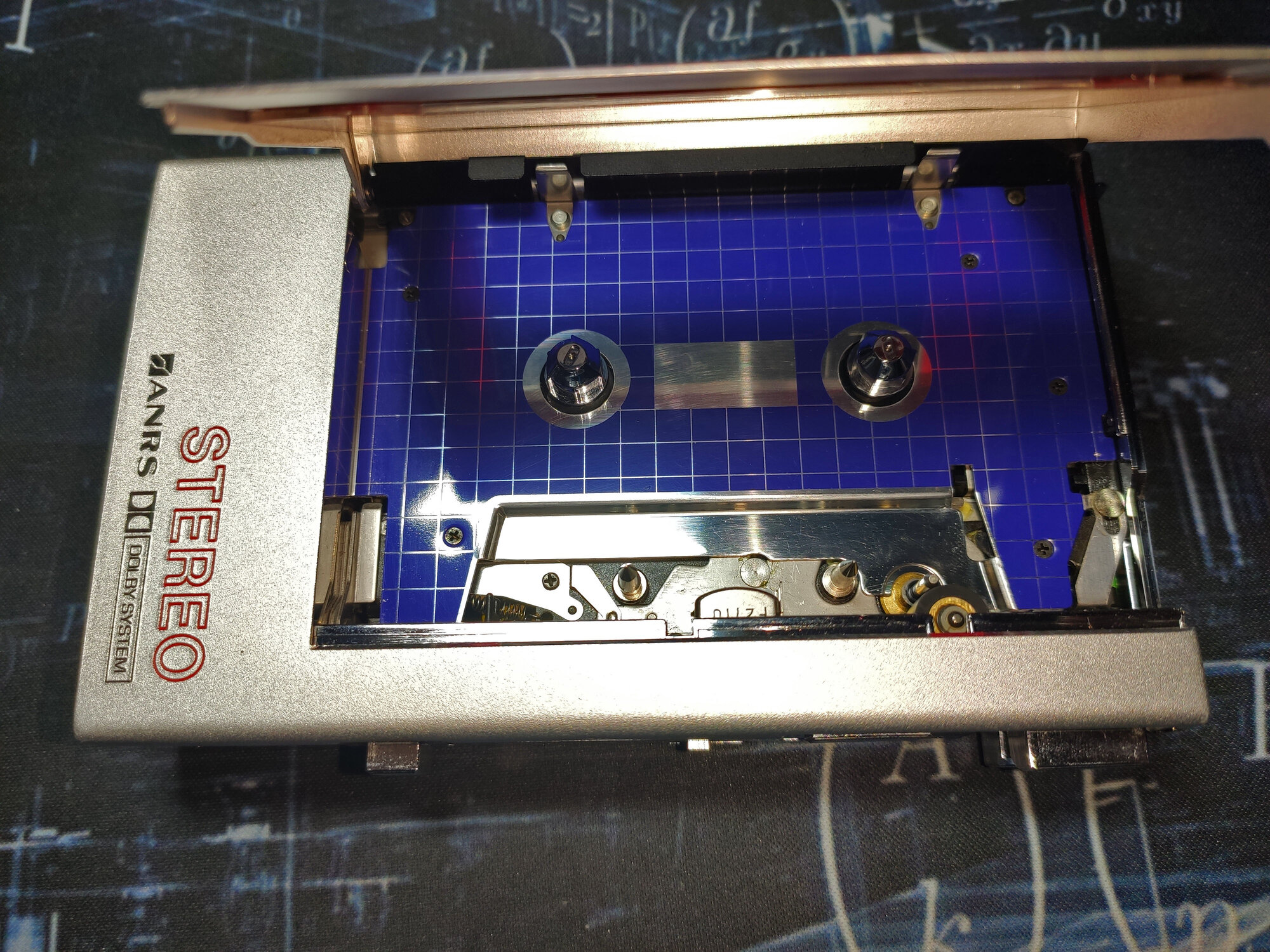

    The walkman was almost finished by now, the only thing that I did more was a clean to the housing and a polish to the cassette door window.
    Overall, I enjoyed repairing this walkman and especially enjoying the final result: a perfectly working JVC CQ-1K.

    Much time has passed and I forgot about the carbon printed resistors in the preamp circuit. Those could also cause a very low volume if the resistance gets too high. Either way, the capacitors need to be replaced anyway, because if the carbon printed resistors are bad, that's because of corrosion from leakead caps.
    Regarding your question, I don't recommend any upgrade, just replace the caps with ones with same capacitance and voltage rating (this can be higher, but the footprint will also be larger and may not physically fit). Note that the footprint is very small, 5mm height if I remember right. The source can be any electronics distribuitor, like DigiKey.
    I attached the schematic of the CQ-F2, which is nearly identical so can be used as a reference for component values. The resistors I had problems with are the ones marked red. All those that are drawed in a rectangle are carbon printed resistors, so if you see corrosion around other ones, you have the values here.
