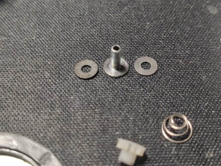

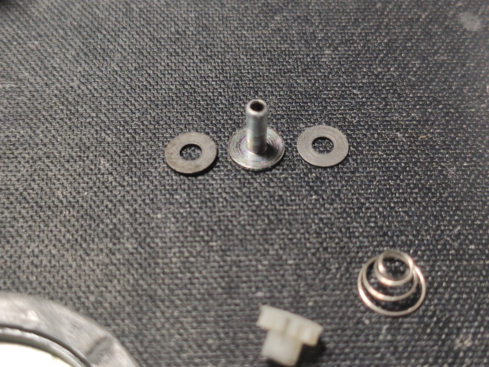

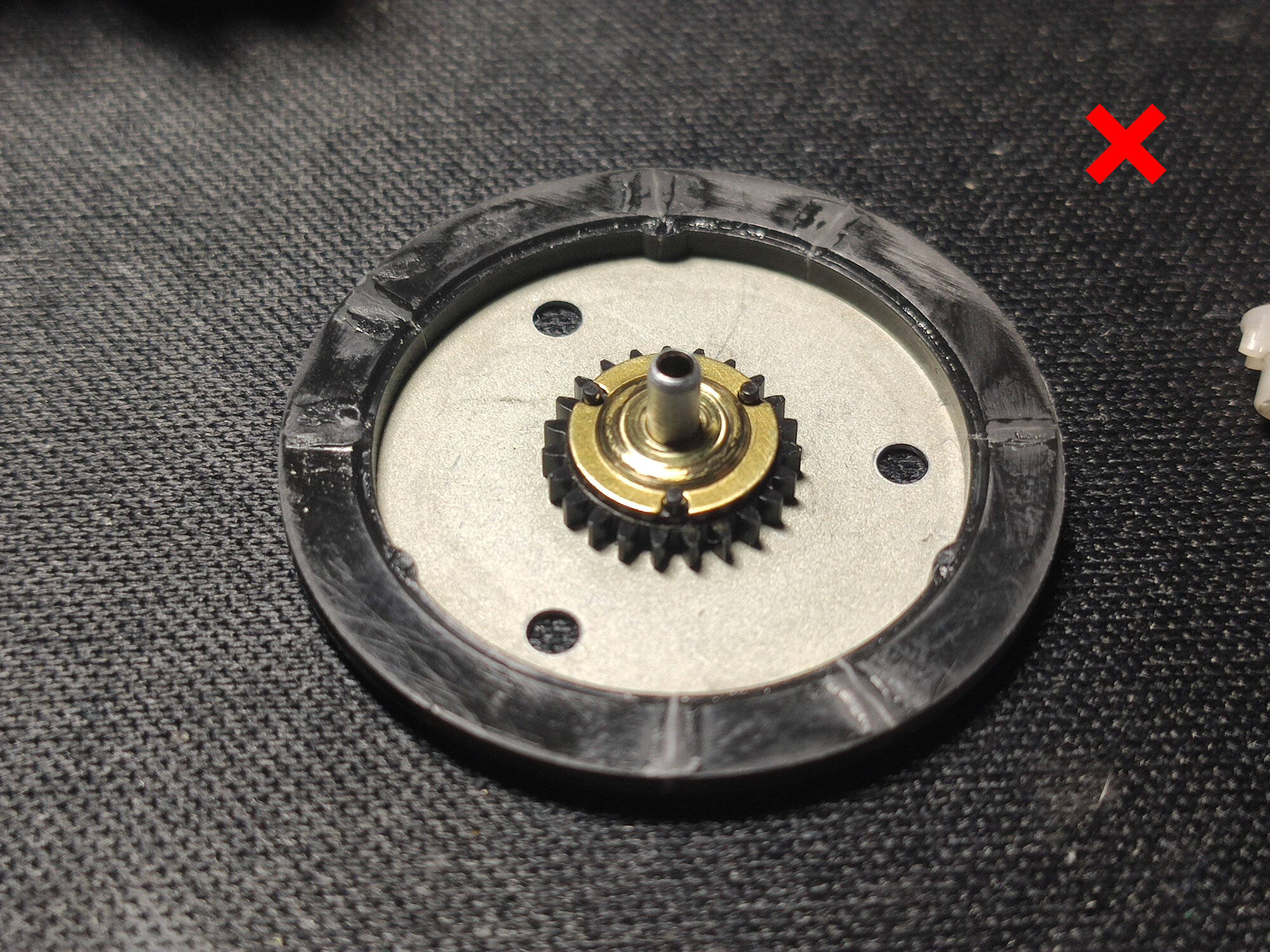

    GEAR REPAIR:
    1. Clean all the parts with IPA;

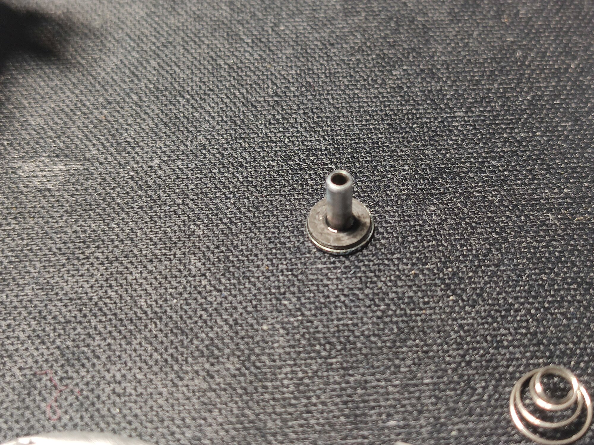

    2. Sand the middle shaft with 800 grit sandpaper to compensate for the shrinked white gear;
    3. Install the 2 washers onto the middle shaft;
    4. Install the middle shaft onto the clutch assy;

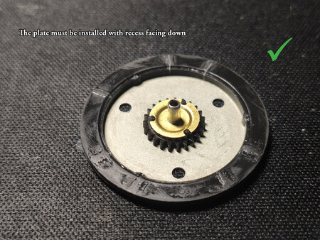

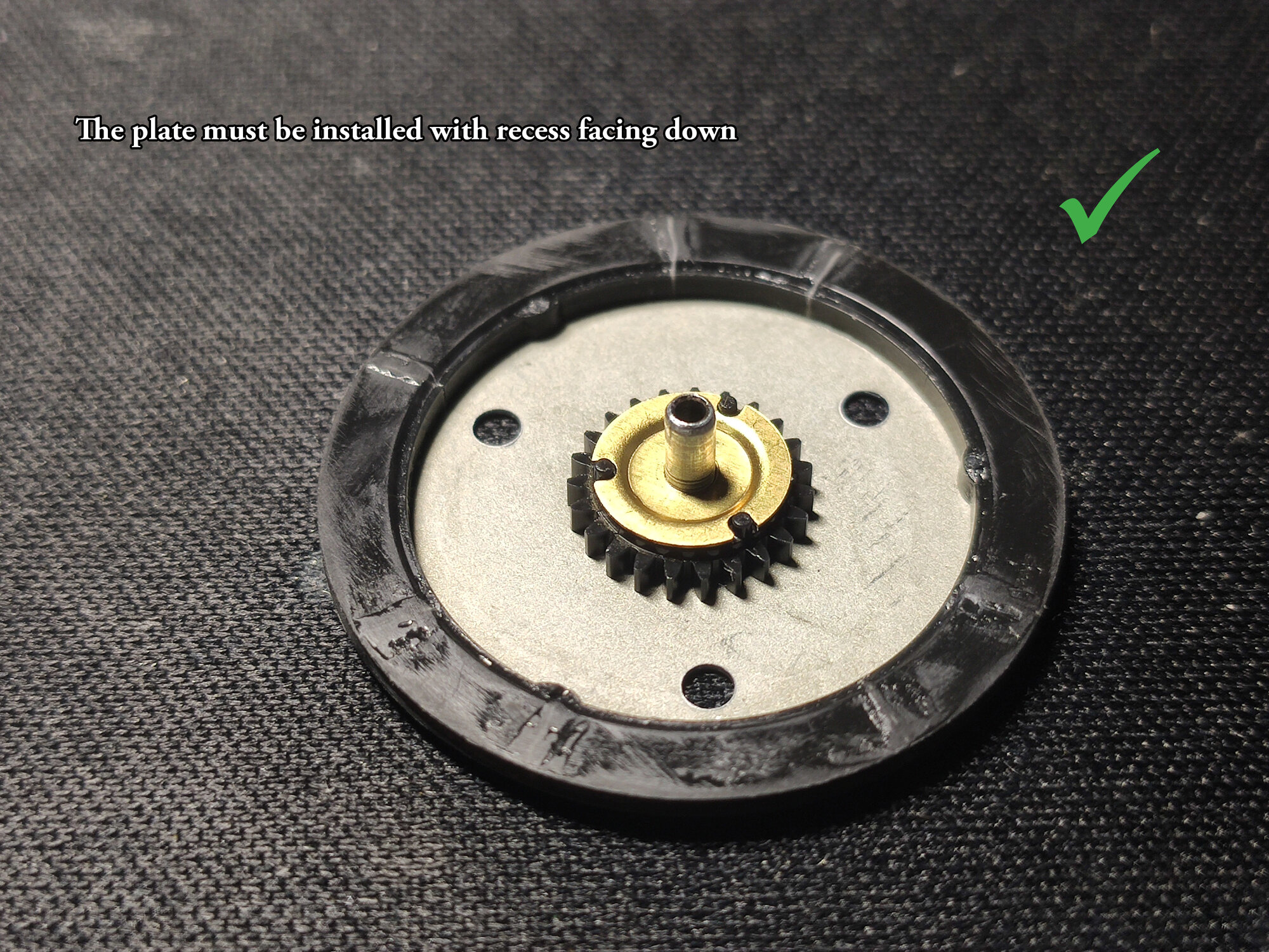

    5. Install the brass plate; Pay very careful attention to install it with the recess facing down, otherwise, the clutch will turn very hard resulting in very high takeup torque, slipping the tape past the pinch roller;
    6. Clean the visible part of the shaft and the inside of the white pulley thoroughly with IPA;

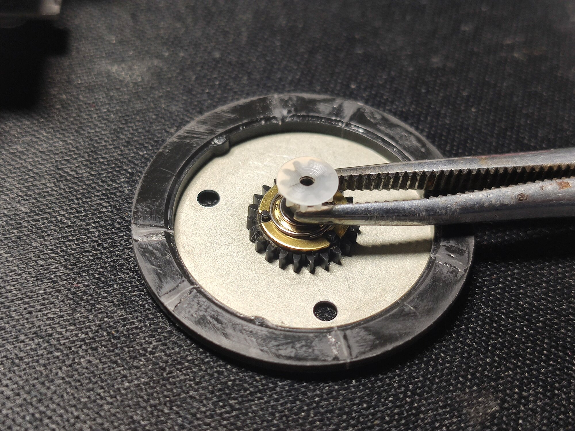

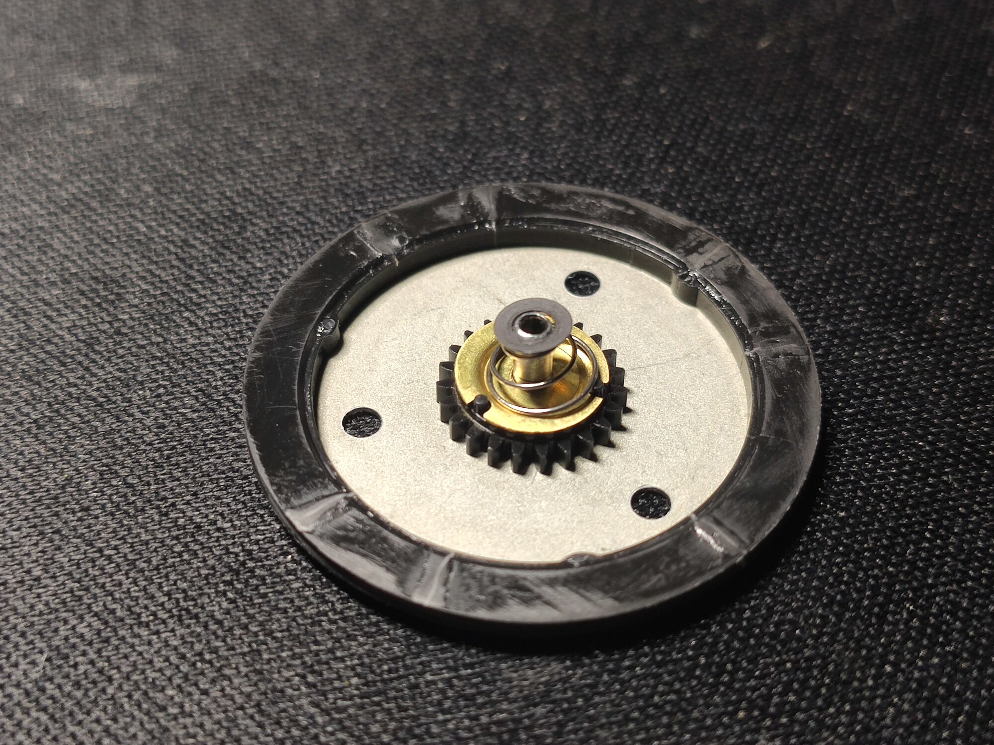

    7. Install the spring and the washer above it as shown in picture;
    8. Compress the spring with a pair of tweezers, while adding a small drop of liquid super glue on top of the middle shaft;
    9. Install the white gear. Pay close attention to push it all the way in, as otherwise the clutch will not fit into the chassis;
    10. Use some kind of clamping tool to hold the white gear until the glue cures. Put the clamp tool in a position as to compress the break line of the gear.
    Do note that in the assembly 4 picture the bottom plate is NOT installed correctly !
    But for the time being I do not have another picture.
    Before comitting to re-assemblying the device, rotate the clutch by hand and if you feel or hear any abnormality (clicking or harshness) check it again before assemblying
    as any imperfection in the friction mechanism will make very audible mechanical noise and will ruin the wow&flutter.
