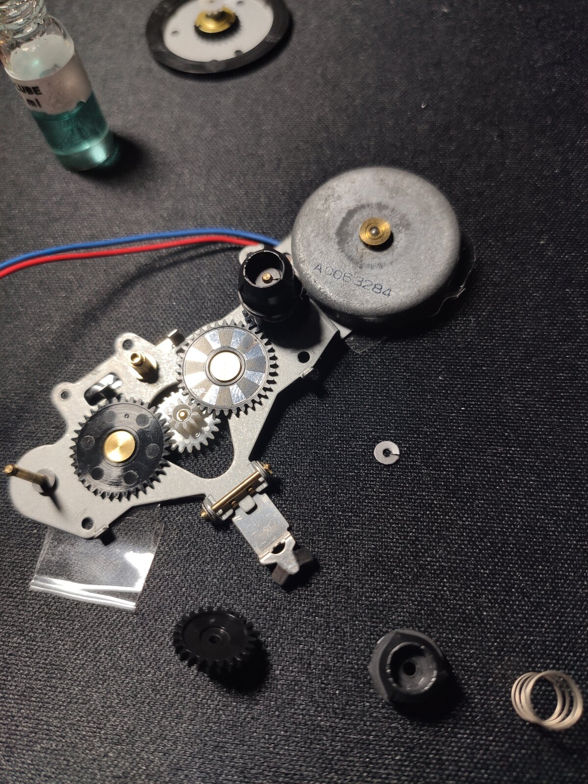

    DESIGN:

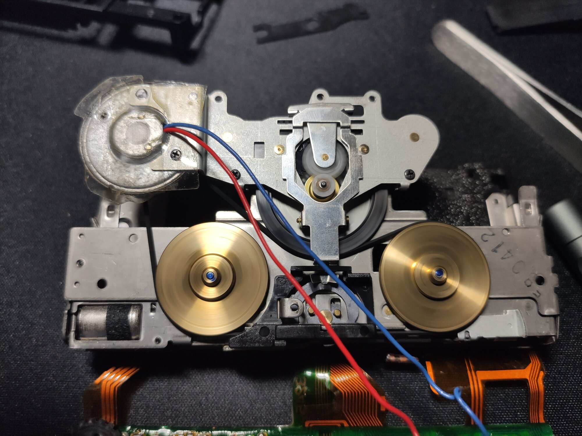

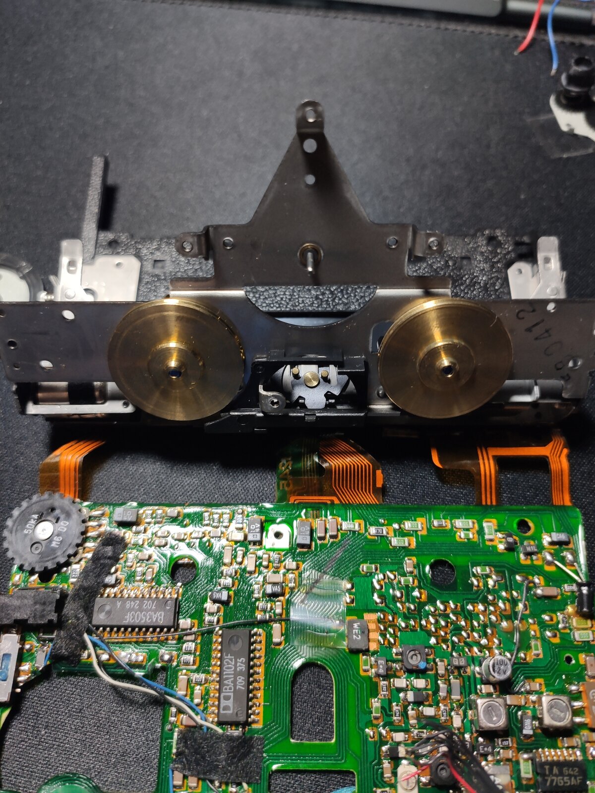

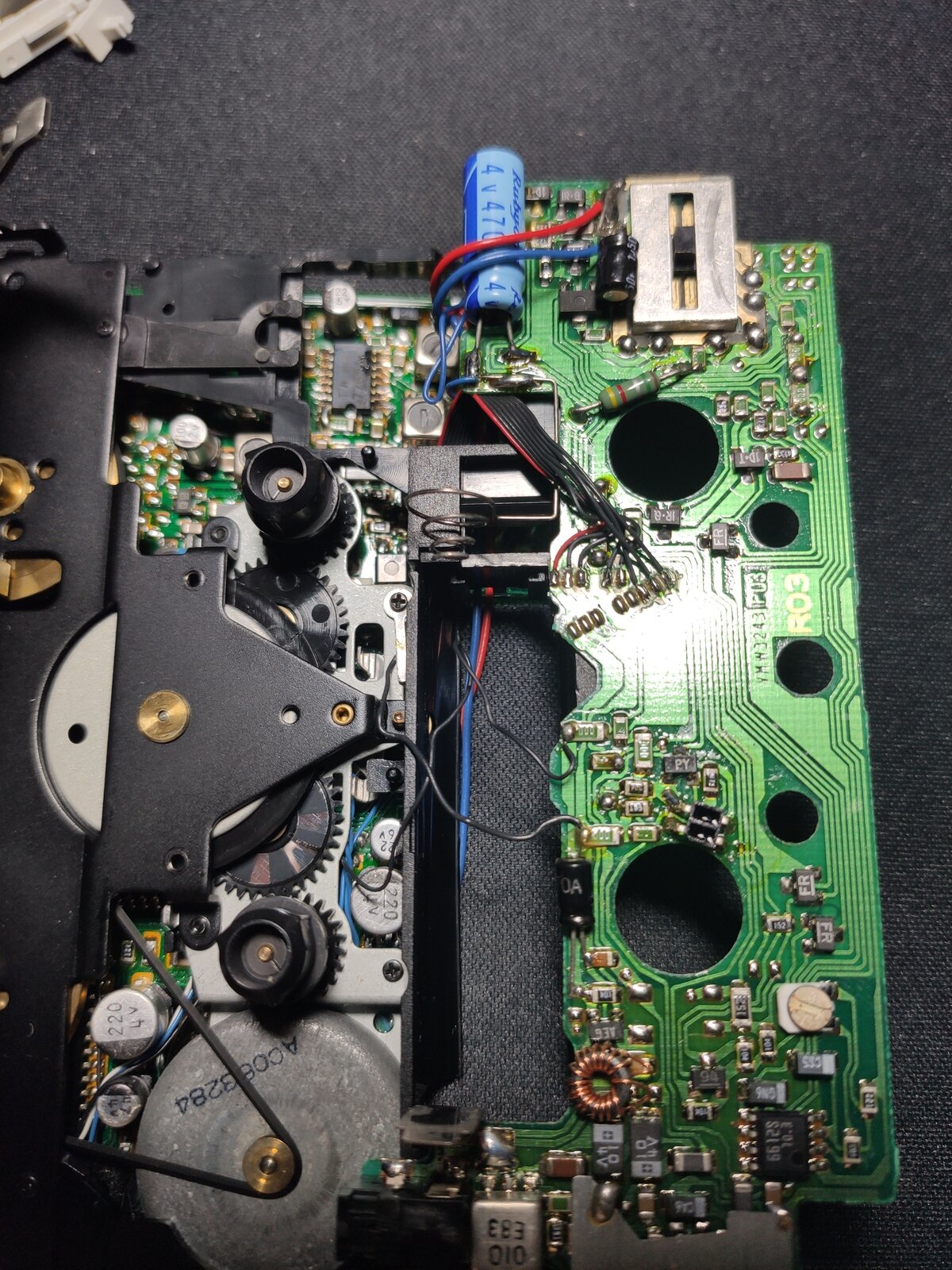

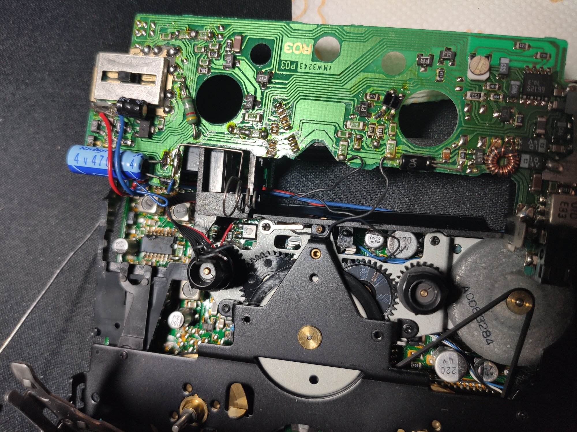

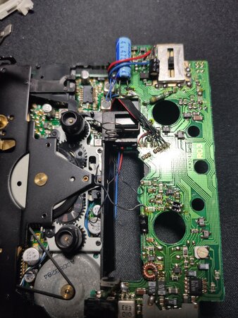

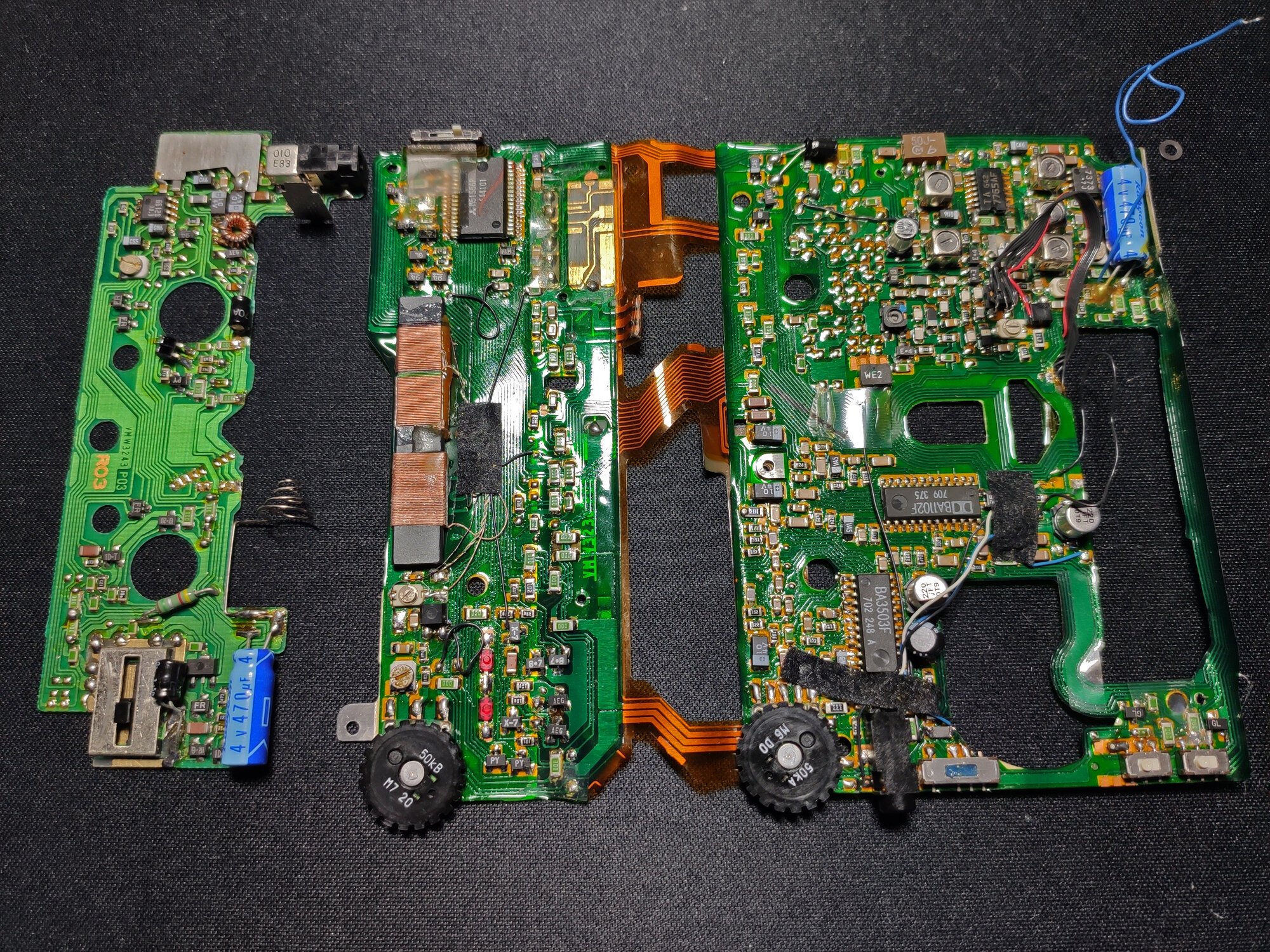

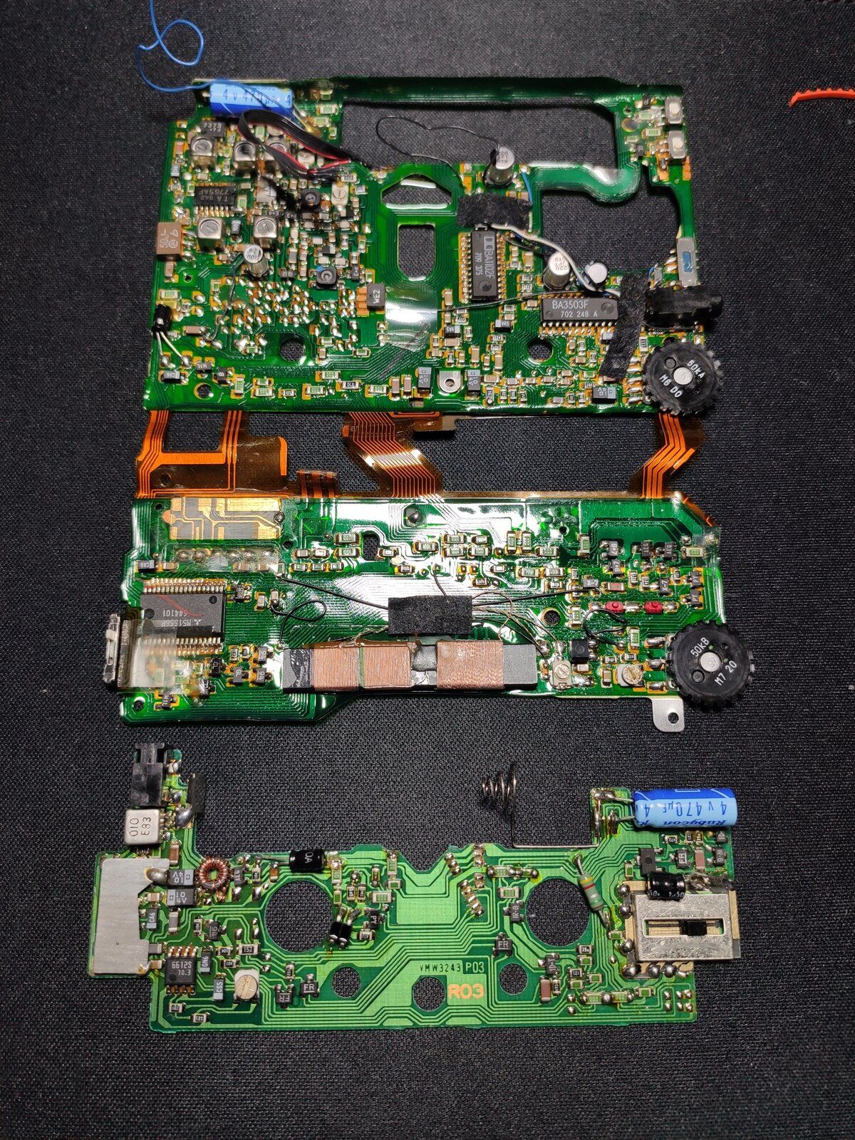

    In terms of constuction it uses a big flex PCB that is used for both the main PCB and the cassette lid PCB. The part of the flex where the components are mounted is glued on a thin aluminium sheet.
    It uses a single AA battery and a typical DC-DC converter with a transformer (a topology found in many walkmans, portable recorders and even Discmans). All the mechanism functions are controlled by a microcontroller that reads the position of the mechanism using a sliding leaf switch.
    There is a second mode switch on the governor board (seen in first picture), that controls the motor's direction. Given the simplicity of the mech, the table reels are engaged only by the torque of the clutch, so the need to reverse the rotation of the motor.
    The auto-reverse function is electronically-controlled by reading pulses from an IR sensor.
    Something else worth mentioning is how the radio function is implemented: given there is not enough room for a variable capacitor in the cassette lid (where the tuning pot is located), the tuning is done with varicap diodes.
    REPAIR:

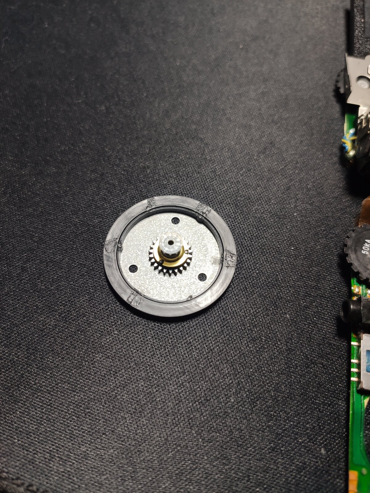

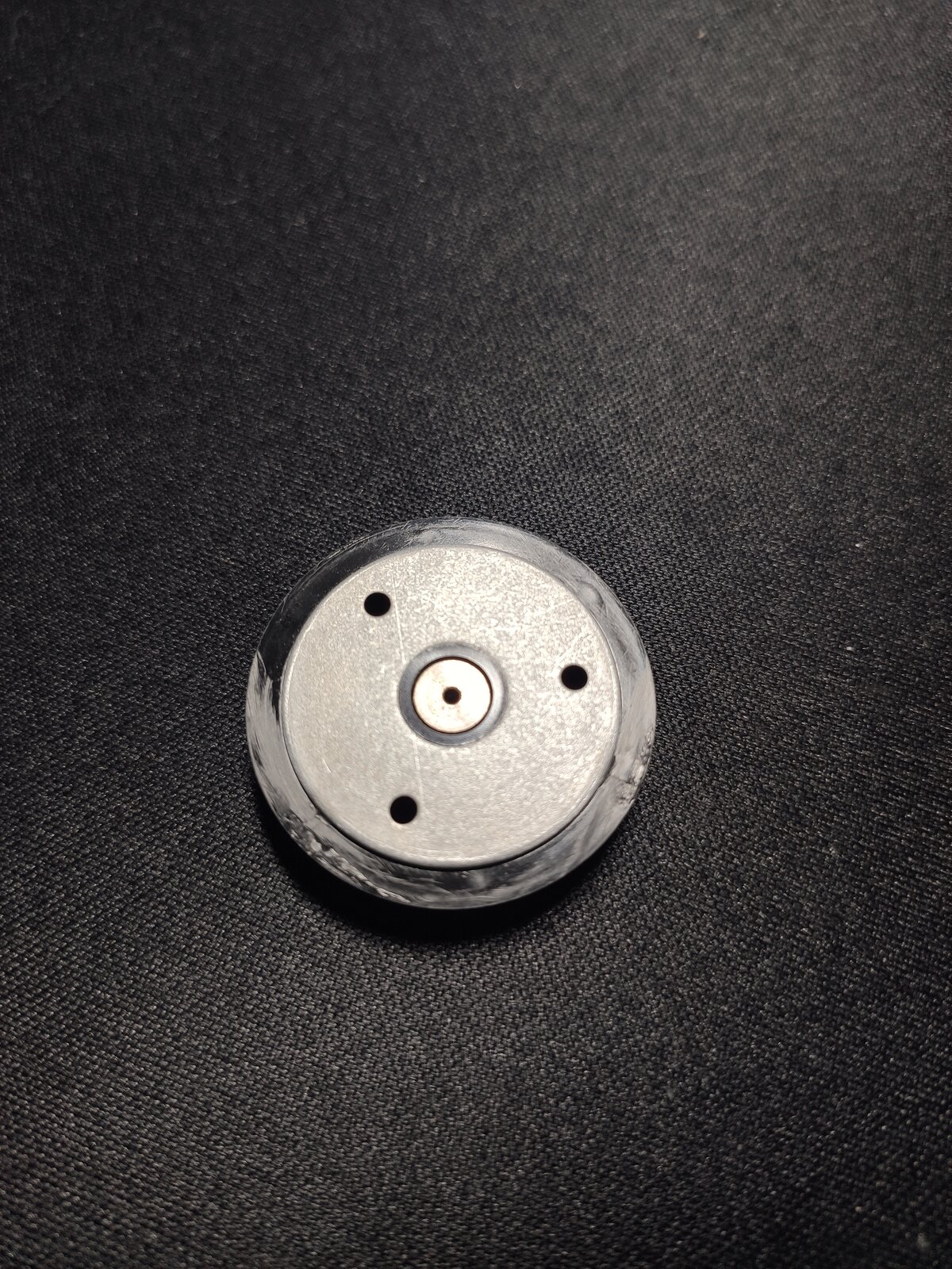

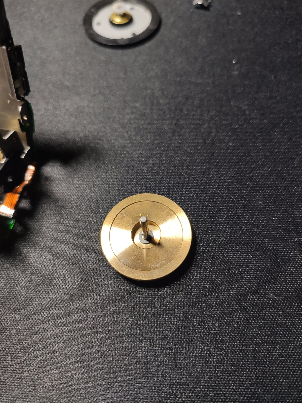

    Repairing the mechanical side consists of lubricating the mechanism (capstan bearings, table reels and motor), repairing the clutch and reinstalling a new belt.
    On the electronics side, there are 5 electrolytic SMD capacitors that are leaky and need replacement. Besides that, cleaning the mode switches and potentiometers is about all that needs to be done.

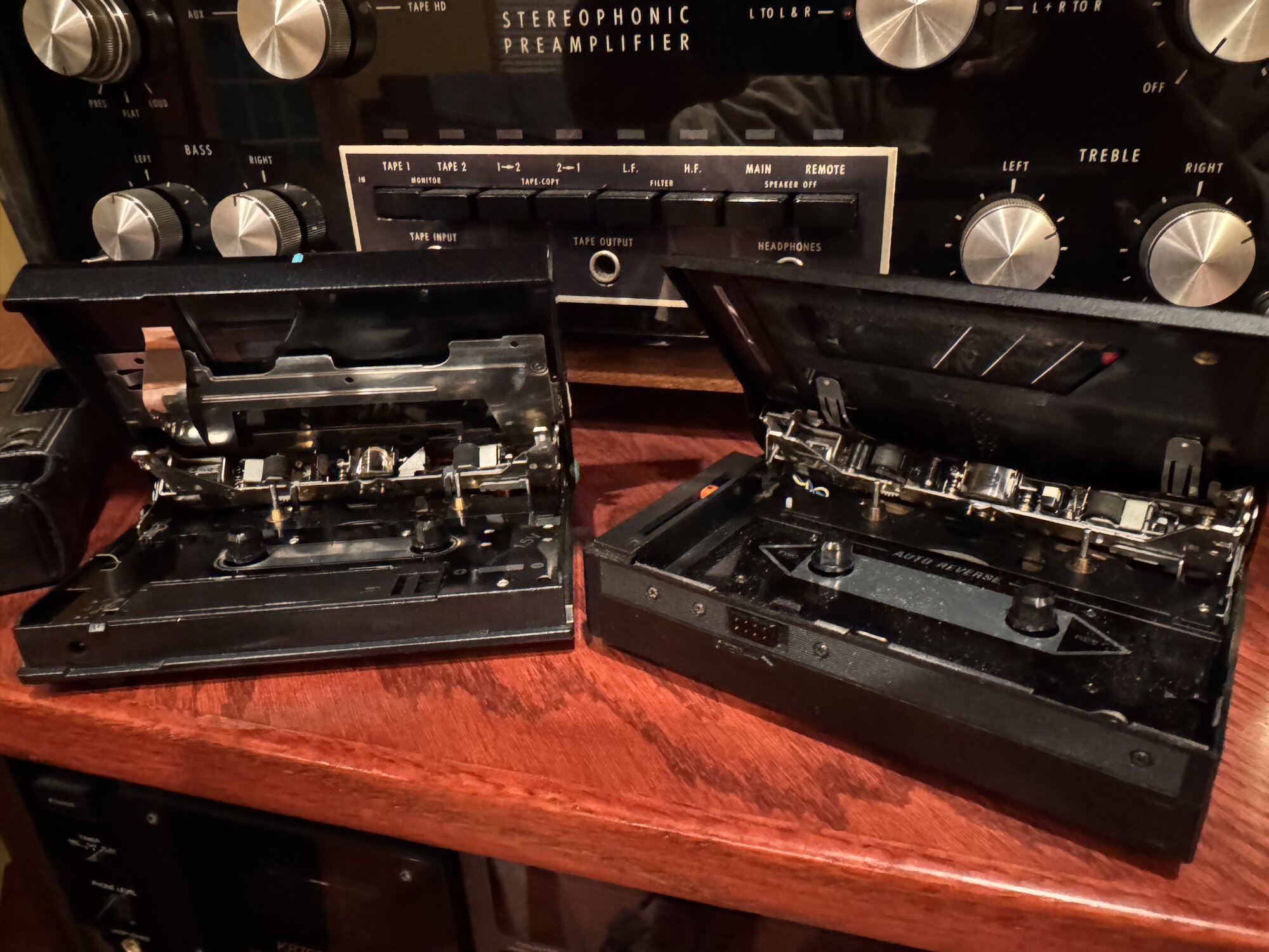

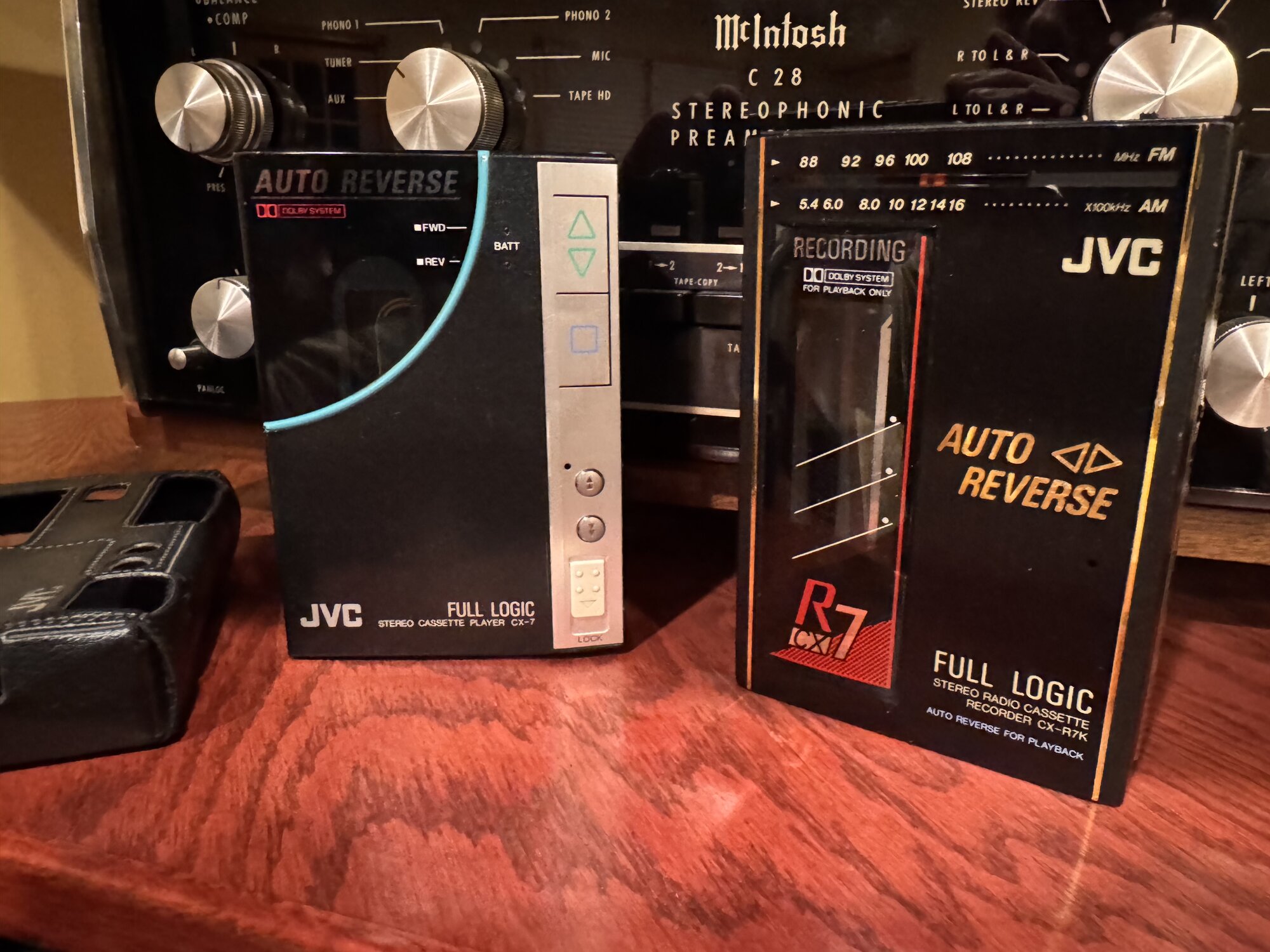

    I am going to attempt to refurbish both a JVC CX-7 (without FM tuner) and a CXR7 ( has recording capability). Can you tell me the belt dimensions for these units? Are the mechanical sides fundamentally the same as the the CX-F7 except for the additional recording capability on the R7?
    I’m trying to buy belts online but unsure of the original specifications (cross section and nominal diameter/circumference )
    both units are mechanically mint on the outside. I’m sure they have all of the same internal issues that you mention. The CX-7 plays but is slow. The CXR7 has motor spinning but must have broken belt.
    I have not opened either up as wanted to have belt available prior to disassembly.
    I do this type of work as a hobby, and paid minimal amounts for both units. I’m not in a hurry, and am ok if I am not successful.

    Some pics of exterior and inside compartment…

    CX-5 and CX-7 (both with and without radio) are identical as far as the mechanism goes.
    CX-R7 has the capstan motor on the opposite side, but by eye belt path looks to be the same length.
    Mecahnical problems are the same on all (clutch, motor, belt), however the CX-R7 doesn't have leaky caps which is a plus.
    I used the DeckTech belts for these units, but unfortunately didn't measure it at the time. Looking on their ebay page, it doesn't seem to be available anymore.
    Am interested myself in the dimension of this belt, since I want to replace it on my own units (the DeckTech ones stretched and slip under FF/REW).
    Still have an original one that I measured recently and measured ~65mm x 0.8mm.
