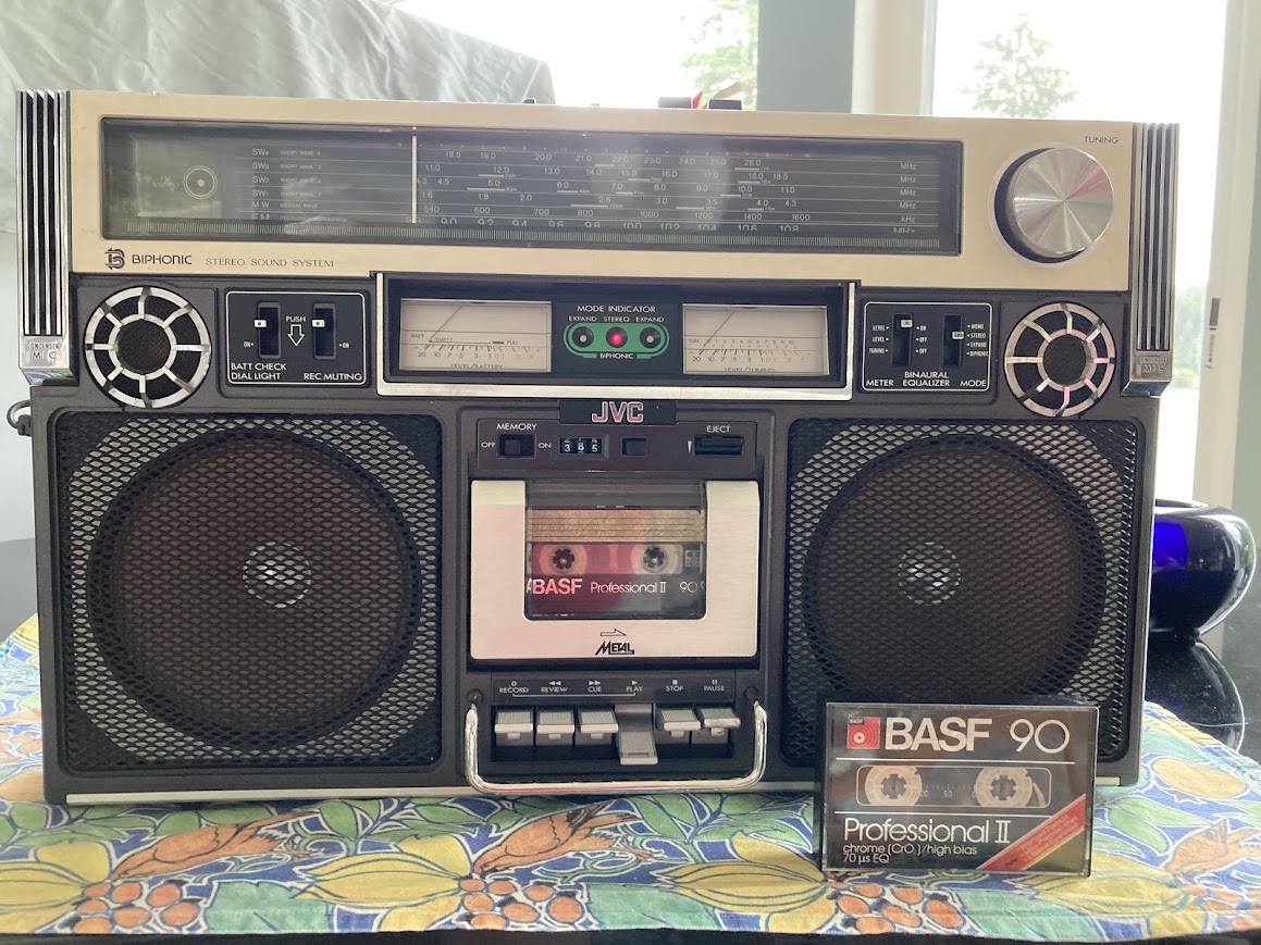

    I recently completed JVC RC-838 JW II restoration and wanted to share some of my experiences and impressions. This was a non-working unit, and it had a broken Pause button.
    The radio was tuning and had reception; the cassette tape door was stuck, per usual. Good news: the cassette deck mechanics functioned (!): Playback, C-60 tape FF and rewind within 90 sec (spec - this means the capstan belt and idlers were OK), and autostop worked (the reel-to-counter belt was intact). But… It had no sound from any source - tape, radio, Line In.

    I used a Silicone Mold Making Kit, 21OZ Fast Cure Translucent Silicone Rubber (link to Amazon where I bought it - no affiliation).
    Here are the Stop and Pause (pressed) keys up close. I could have used a better-suited paint to match precisely, but I did not want to fuss over it. The key visual reference for the mold making was the first row of the pattern.

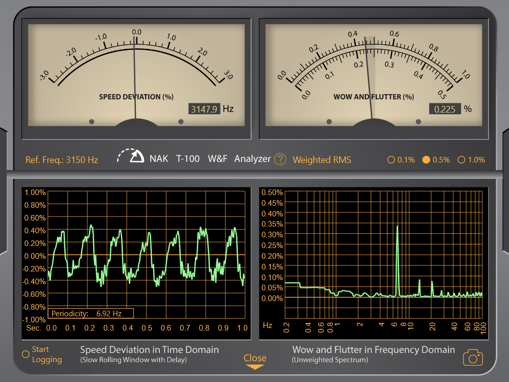

    2. Motor speed: HPR W&F and Speed (3150 Hz) — check. I was impressed by how stable the speed was on this boombox.

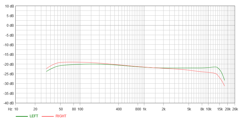

    Playback frequency response. It is neither spectacular nor terrible; it is within the specifications. Frankly, I expected slightly better performance from a boombox of this build quality.
    At spec. I think W&F could be improved a little with a new capstan belt and pinch roller. Time will tell.
