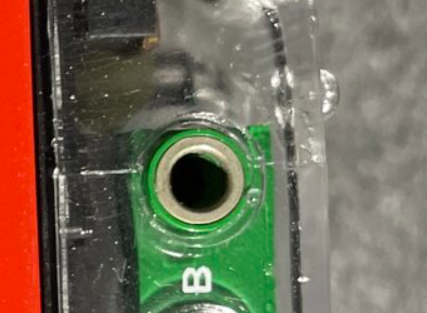

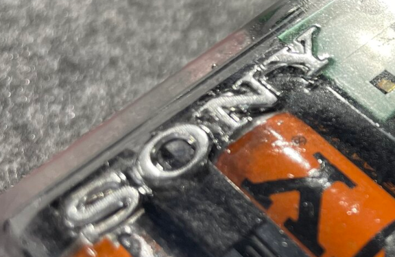

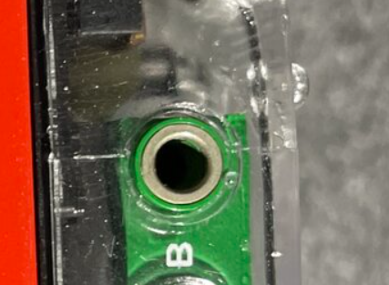

    After seeing more detailed pics, I'm also leaning towards this being a resin cast. A very nice one indeed. On headphone socket B, there's a line on the case located where the black & colored sections meet on a normal WM-2s. I 'm thinking that there probably wouldn't be a line there had this been created from a mold purpose built to make the the entire case in a single mold. The Sony logo also seems to have that pattern line pattern composed of concentric circles. These were originally a pattern grinded on the metal Sony logo insert that's molded into the plastic, not part of the plastic mold.
    That being said, if it really is a DIY project, it sure it a good one. I've actually been wondering myself about how nice it would be to cast clear walkmans like this.

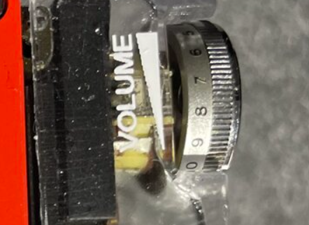

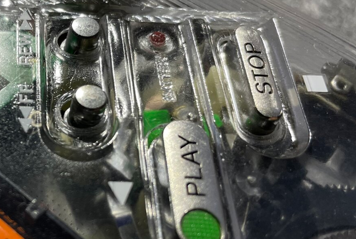

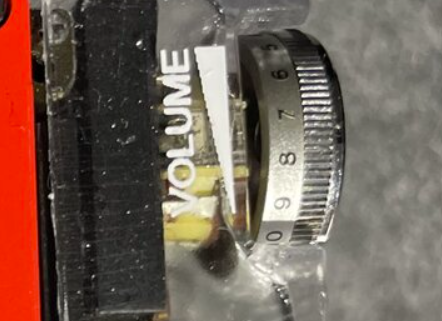

    As an additional note, from the photos it looks like the "Walkman logo", "Headphone", "Volume", "Tape type" and "Voltage input" are not decals (I can't see any faint borders around them), while the icons for the transport buttons are. I'm thinking that those are printed directly on the plastic using a flatbed printer. You can see that the diagonal and circular lines of the print are rather jagged (like the volume indicator triangle and polarity icons). This may be due to the resolution of the printer, since higher resolution ones are not as easily accessible. Using the same printer would make the transport button labels, which are placed on an angle by design, look unpleasant, and decals were use instead. Quite a thoughtful planning, I'd say.

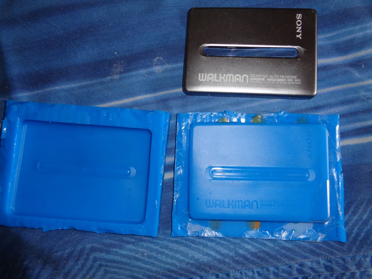

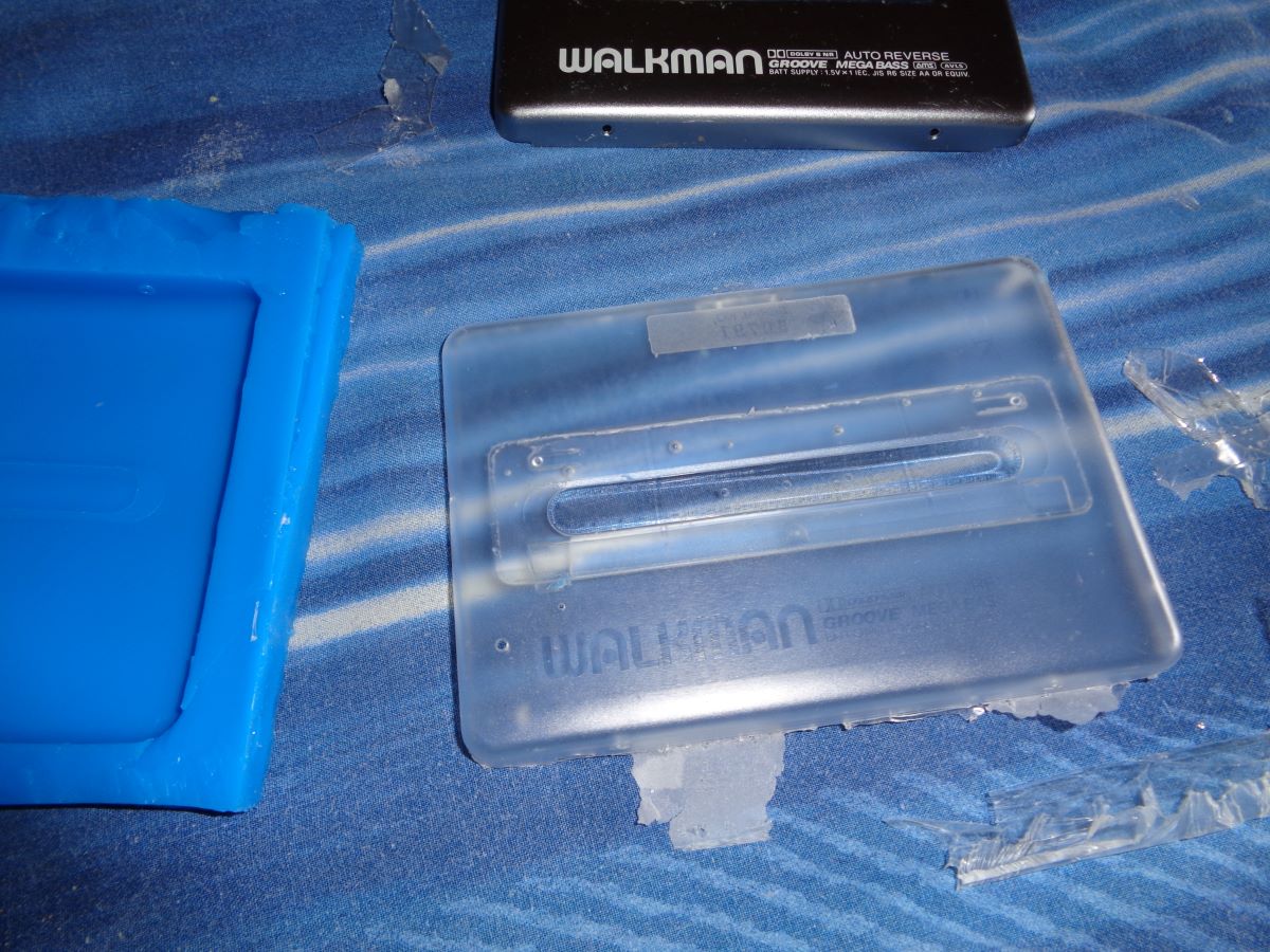

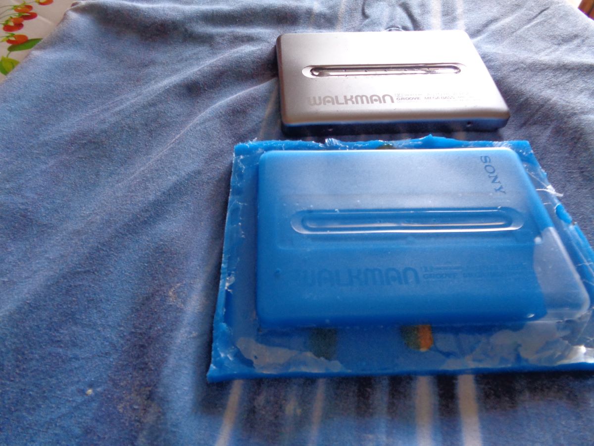

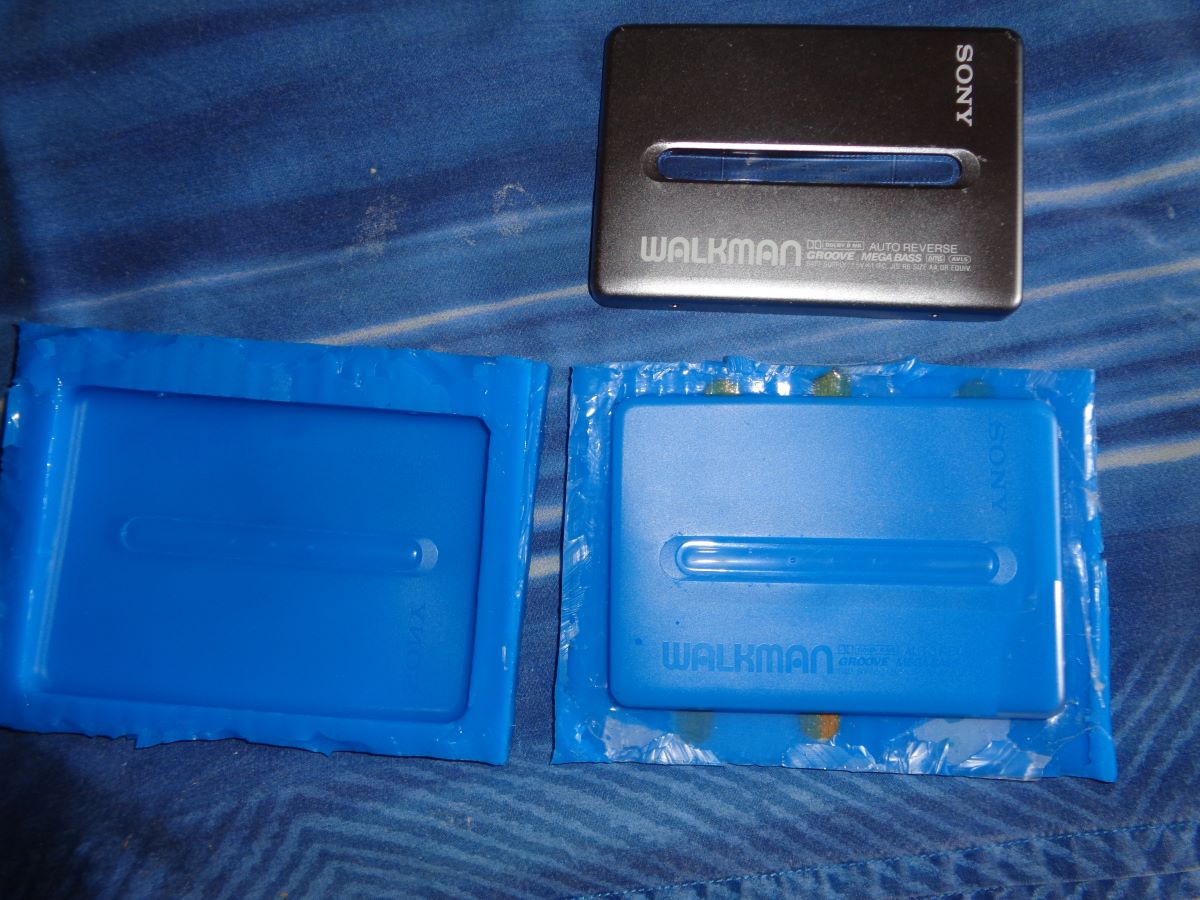

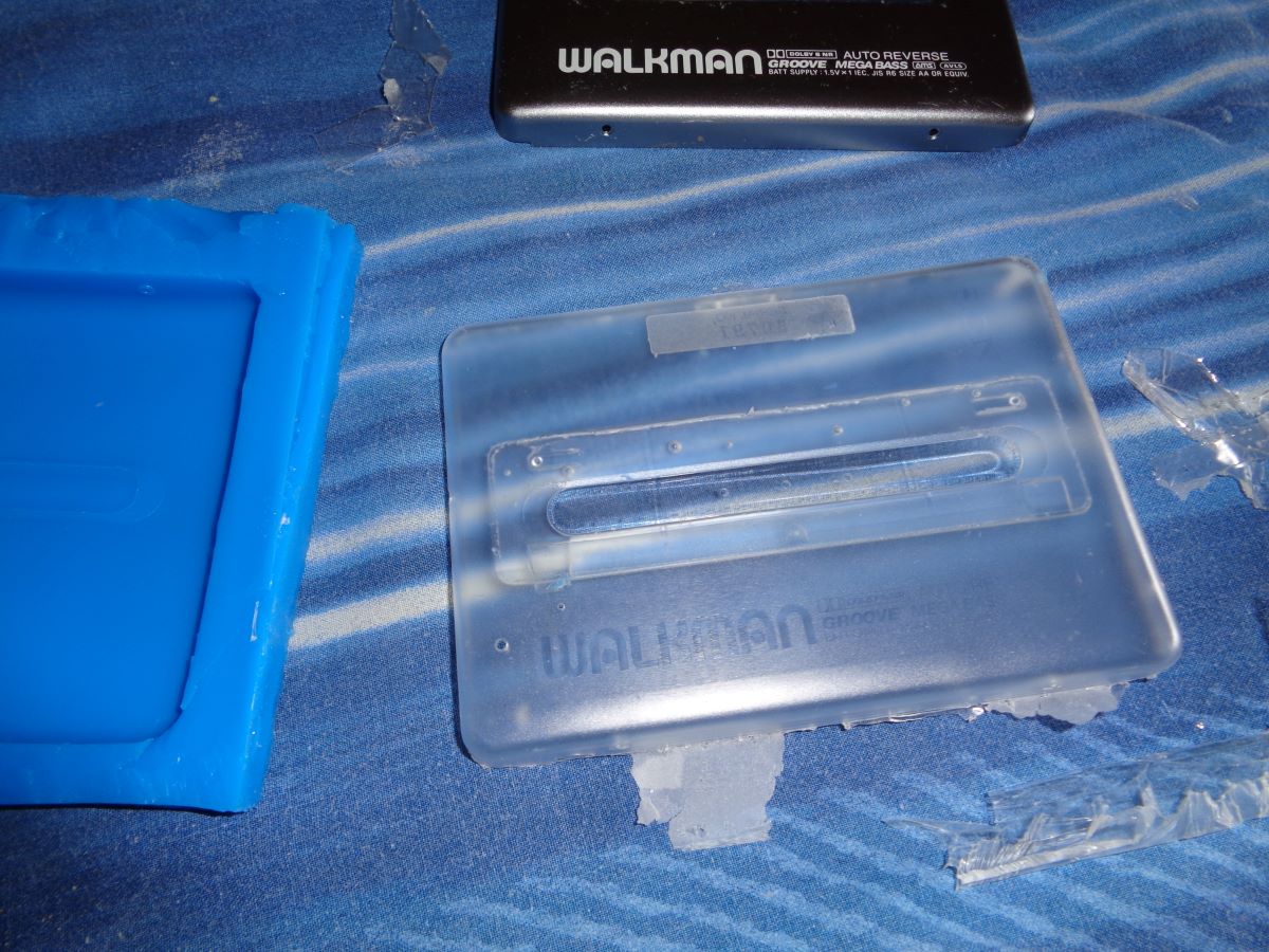

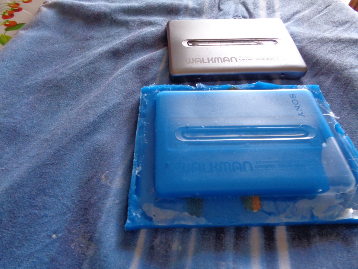

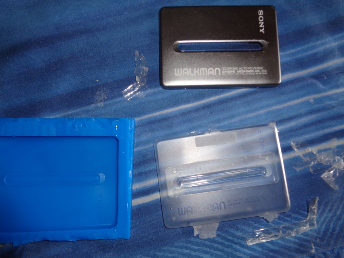

    t's really a DIY project... and it turned out well I put some example photos.... Note the writing on my piece the liquid rubber reproduces them perfectly with a steady hand and a good fine-tipped brush would be enough to reproduce them faithfully
    Mine was just a test ... I have to improve the technique but I would say that the result is valid

    Wow! This is the type of plastic Walkman housing I like. Nice project! Is it possible to produce other colours like grey or neon? I have a Gameboy Pocket in Neon yellow, which looks amazing.

    Very nice work @Silver965! One question though, are resin casts like this more brittle? A production model could certainly endure a few drops from the table without much damage.
    Silver965 likes this.
  6. Silver965
    Silver965 Well-Known Member
    738
    Torino
    @Mystereo yes, there are various colors that can be added to the resin ... just a few drops are enough to color it,it is found on amazon
    @stuck-in-time it depends on how you mix the two-component resin ... if you make it with more resin the result will be a softer and more flexible object ... if you put more catalyst it remains stiffer ... I have not tried to drop it

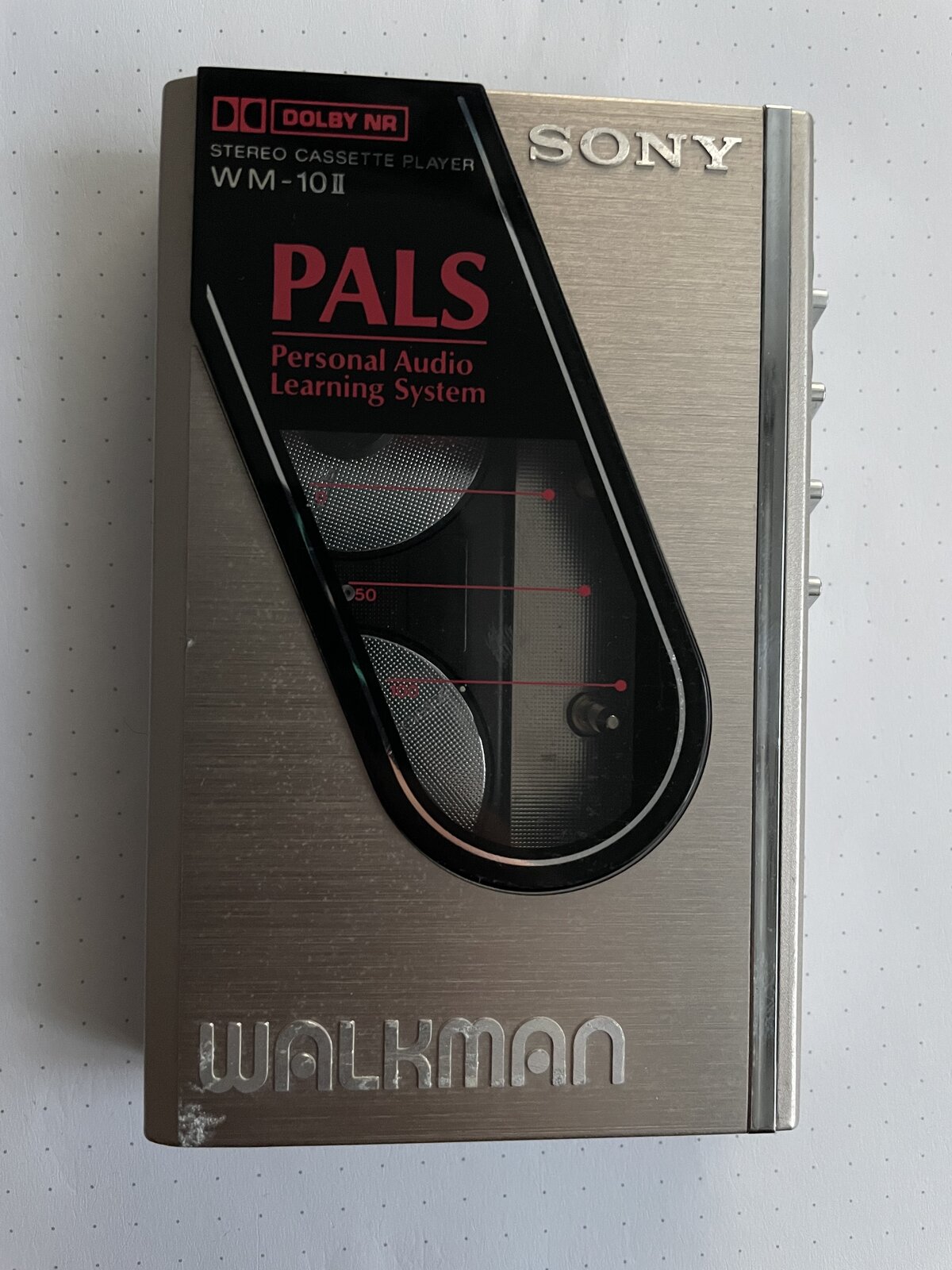

    Can we call this a rarity?

    Does it have a 5 second or 10 second repeat functionality?
  13. Mystereo
    Mystereo Member
    38
    Germany
    No, it’s a standard WM-10II (like the WM30). Only the window is different.
  14. Machaneus
    Machaneus Well-Known Member
    530
    Athens
    Very interesting indeed , WM-10II is actually a WM30 destined for the US and Canadian markets , I wonder if the "PALS - Personal Audio Learning System" text is printed on top of the acrylic window or underside , if it's the first maybe it is a promotional item if it's the second it must came from the factory as we see it , since we don't know what "PALS" is , only someone who has used that "system" can enlighten us.
  15. Mystereo
    Mystereo Member
    38
    Germany
    It’s printed from the underside like the standard windows. I can see no other recognizable difference to a WM30 (Unfortunately I don’t own another WM10II).
    Patex, Emiel and Machaneus like this.
  16. Machaneus
    530
    Athens
    I don't think there are any differences aside the voltage setings for the optional ac power adaptor , though this version might be not the case .
    Some reseach in US and Canadian Sony ads and catalogs and maybe a WM10II/WM30 service manual supplement/update of around 1984 might bring up something (if you haven't done that already).
    Certainly a rarity and a curiosity also , in any case a great find , keep up the good work.:thumbup:
