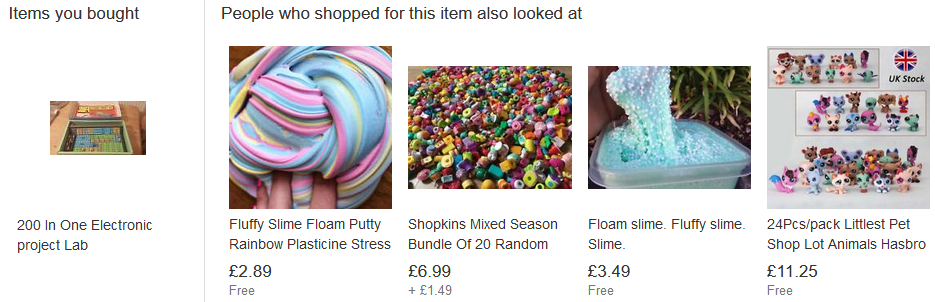

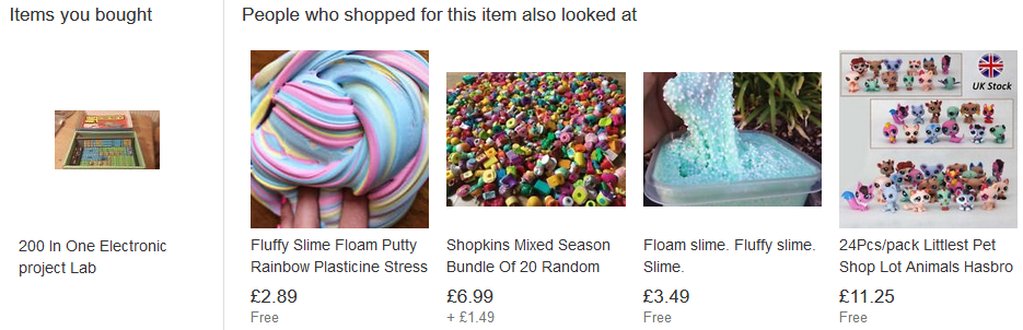

    The good news is that I secured myself a 200 in 1 electronics kit. However, the "People who bought this also looked at..." feature, has me concerned about the kinds of people who are learning electronics these days...

    Ha ha that is funny :lollegs:
