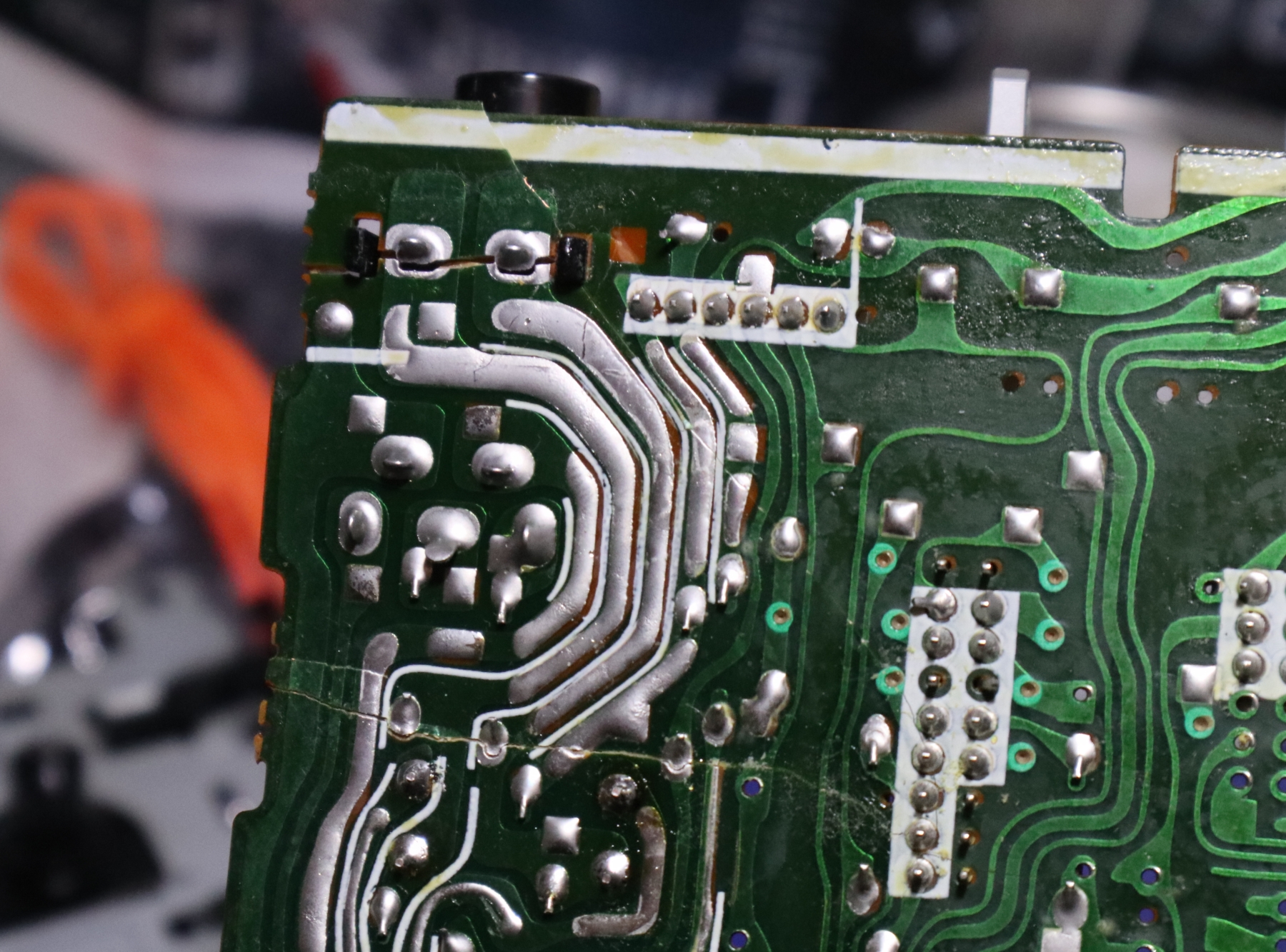

    That should be easy to fix. Buy a reel of thin tinned copper wire and put pieces on the tracks anywhere there might be a break and solder at both ends.
    Back in the 1980s I bought an AM CB rig, one of many that South Wales Police thought they had decommissioned by smashing a hammer into the PCB until it was cracked into about four pieces. They then sent them to an Amateur Radio Rally for sale as parts only obviously thinking they would never work again. One afternoon I was feeling particularly bored so I got out my soldering iron and about 25 track repairs later had a working CB rig.
    I just skimmed through this and he seems to use the technique I just suggested.
    I would use a decent pair of snips rather than a razor blade which I would be worried about damaging the track or my fingers.

    The other side has these white traces and I'm not sure about these. Same procedure? - I've tried to strengthen the crack with super glue... it's in quite a mess. Must be about 40 breaks. I do have some kynar wire but it's nowhere near thick enough to use here.

    +1 to what @Longman said: use single strands from multi-strand wire ((I have a bag of old power cords and old SCSI/Printer cables for the job)). First strengthen broken board loosely together with some tape and restore the traces. I make my life easy and do not always fix traces at the break-point but connect at parts being connected. Do not make my mistake here and do not just use solder at the breaks: always add a strand of wire!
    Once all done and working, use a GENEROUS amount of epoxy along all the breaks, maybe use two layers. Do not use 5-min epoxy, I am always too slow to fit within 5 min of such fun!
    It looks to me that white lines are just paint to show traces underneath, but please check first by scraping some off: its been a while since I fixed my last bbox. (I have a stash of them for when my house rebuild finally starts, to oversee the rebuild)

    I think the white tracks are actual tracks. In the photo just above the blue switch I can also see a printed resistor. Both of these features will make repair more difficult. However, @Jorge 's post shows what can be done with time and patience. I recall that with the CB rig, which was a similarly big repair there was one track break, just at the edge of a solder joint that took ages to find.

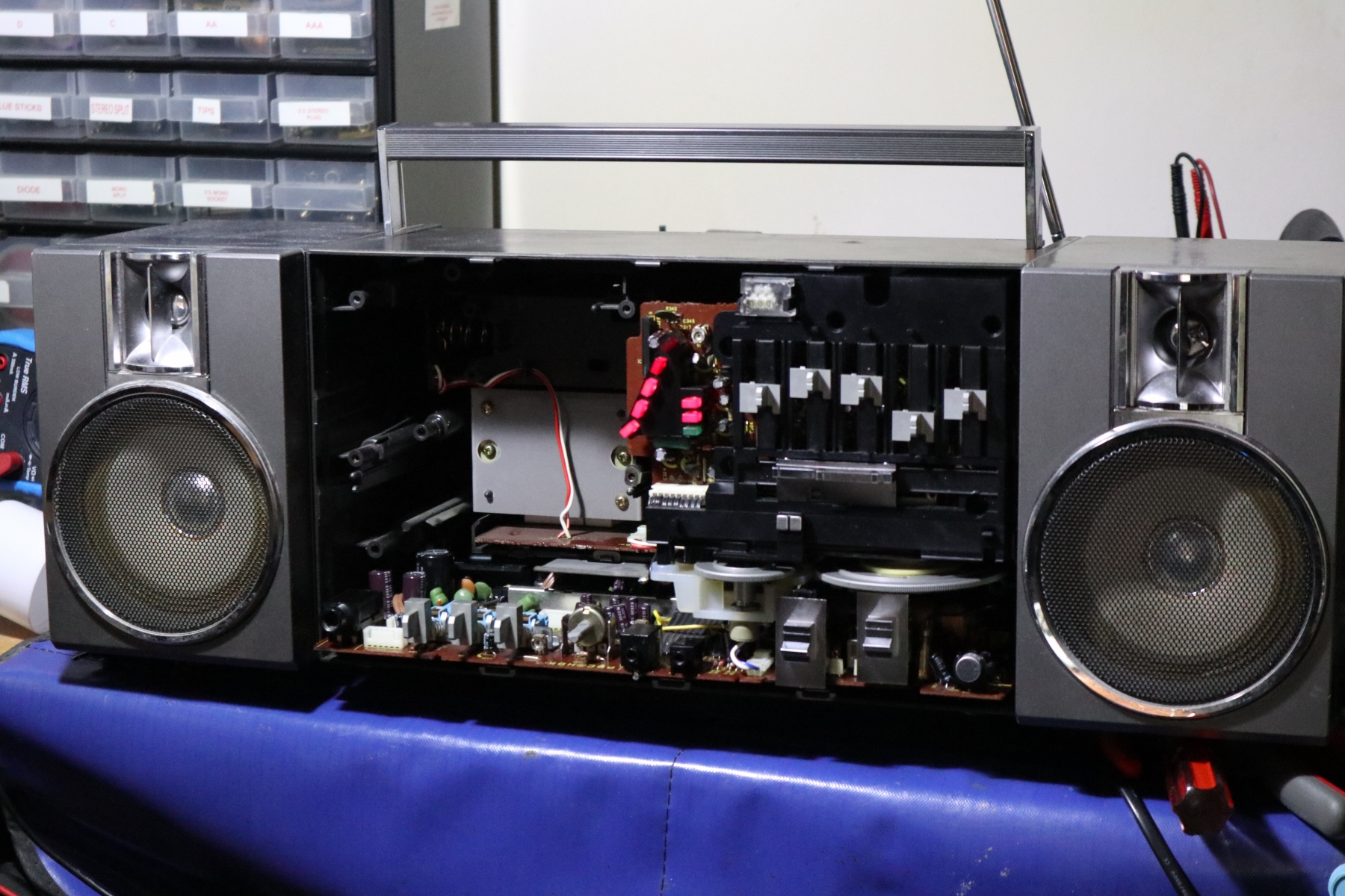

    On the good side, I've finished the recap and assembled the RX-C45L. On the bad side... the internal 2A fuse blew before I got a peep out of it. But I confirmed it was working before I started the re-cap.
    I've ordered some replacement fuses, 20x5 T2A/250 ... and pray that the replacement doesn't blow immediately... because if it does... I haven't got a clue how to start troubleshooting this thing.

    Double check for solder bridges (which can sometimes be very thin and hard to spot) and that every capacitor is the right way around.
    If you removed the heatsink from any power devices like the amplifier IC, did you fit back any insulators (which depending on the design may or may not be required) correctly.

    Will do. It was quite a busier board compared to the RX-C45, so I'll do that tomorrow when I've "recovered" a little. I did double check all caps when I replaced them, and I think in a very few places the joints were actually connected to neighbouring pads. But there's a possibility that I have bridged somewhere and I'll go over the board again. There was a heat sink straight on top of the Sanyo chip. Just put new paste on. I'll remove that and make sure the paste didn't go over the lid and onto the legs... I did check with a torch after I fitted it and screwed it down, but I might have missed something there.... or it might be the age of the fuse. It was simply its time.
    But I've got some time on my hands before the new fuses get here, so there's no harm in going over it again.

    The paste is non conductive so I wouldn't worry about that but make sure nothing metal is touching the heatsink (unless it is designed to).

    I've found something else that's caused it to blow. Hooking up the tape deck causes a slight humming from the unit. If left powered on for five seconds, the fuse blows. It's something to do with the motor unit. More details and pictures when I can bring myself to do it.

    With regards to the humming, make sure that the tape deck is properly grounded. They might be relying on a mounting screw to ground it so if you are trying to run it sat on the bench you might be missing a ground conection.

    FOUND IT !!!! - It was on the board at the back of the tape deck. I'm not sure how, but I damaged it (snapped an irrelevant corner off somehow) and fixed the broken track (purple arrow) however, that wasn't all there was to it. Yes, I did have another tape mechanism out of the other machine, but the connections for the tape head itself weren't the same. Also, the motor was 12V as opposed to this one being 15v. I did switch the back section (motor and mounting bracket) over and the fault persisted. So that lead me to the main board.
    However, doing some desperate messing around with a multi-metre I found a short between the grounding screw and SW10. I put some thin washers beneath the other two screws and lo and behold I can insert the deck into the unit and it all powers up and the radio runs just fine without blowing the fuse. ... this does leave me thinking that I've worked around a fault somewhere else, however, and I now have to run a tape through it when I'm feeling bold enough. - More to come... pardon the pun... stay "tuned" :-D
