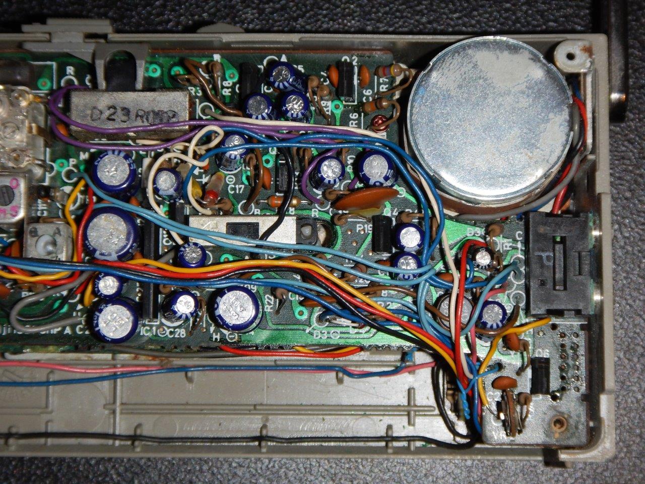

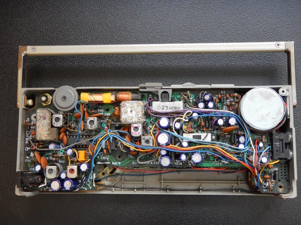

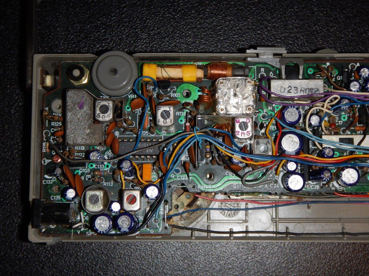

    I'd really appreciate hi-res photos of the insides. I need to see exactly which screws and cables go where. There are two major circuit boards - I'd really appreciate photos of both of them.
    19,268
    I'll try to crack it open in the next few days, I've got a pretty busy week still going on but I'd love to help.

  6. quaz30
    quaz30 Active Member
    153
    Poland
    Thanks. I switched the copper screw on the left for a different one, that was the problem.
