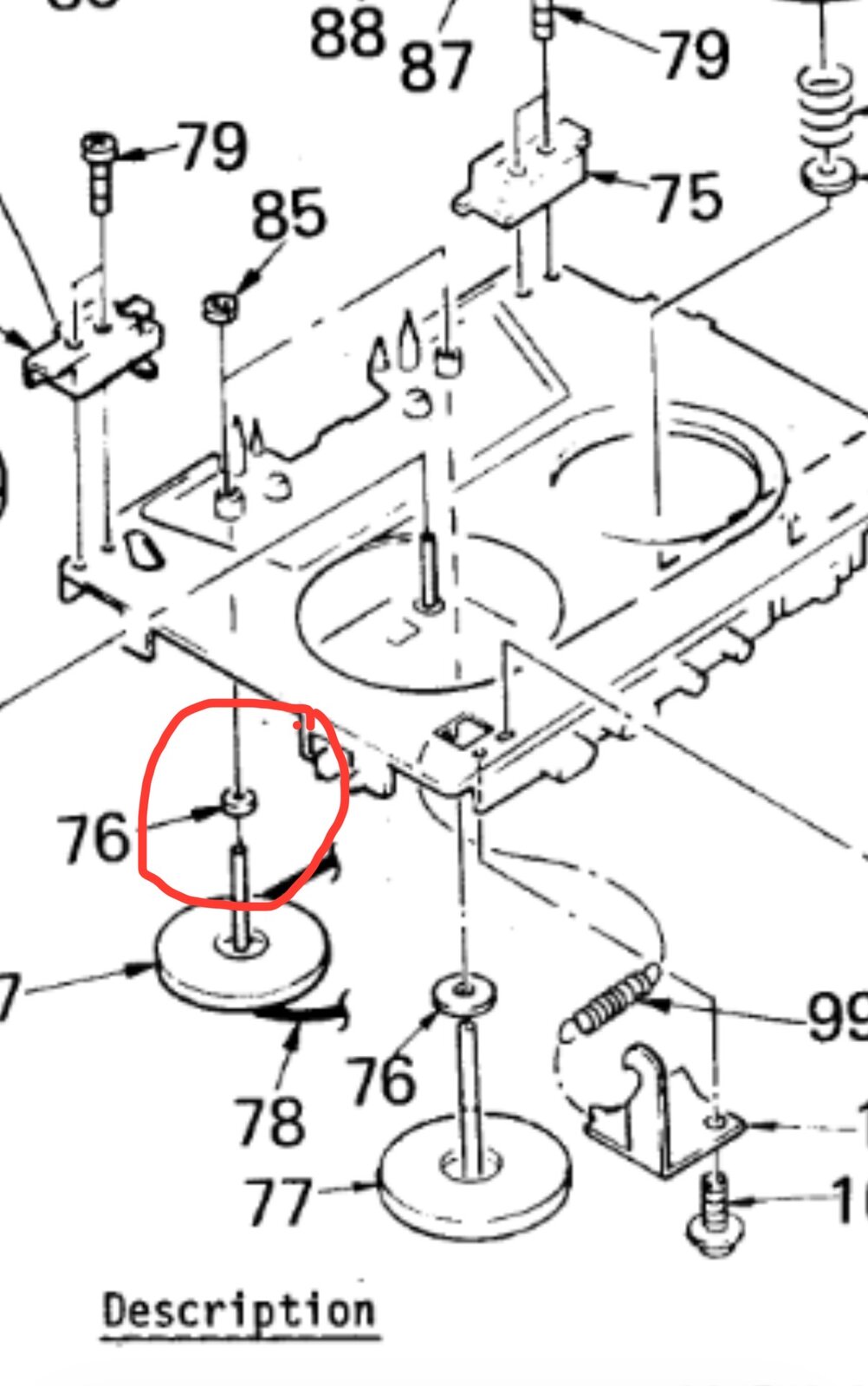

    I have worked a number of these and this can be tricky. It does sound to me that the motor is struggling a bit even when you first hit play. I am not sure if this has been taken apart before you got it but there are white thrust washers behind the capstans and the centre gear that can disappear if you are not careful. There is a gear that runs off the centre gear (cream coloured) that controls the autoreverse. It can get sticky. Same with the tension pulley on the right (looking at the gears with the back off). The gears under the plate where the tape goes can also gum up. The pinch rollers can also push on a worn capstan and slow things down. Sorry that this is not super helpful but you potentially have a power problem (as per Valentin) or you need to clean and lube all gears, pullies, and potentially the motor.

    Ok, fair enough. From the videos it does seem that it does slow down when upside down and then the speed increases as you flip it back (although not fully). There is some level of gravity effect going on here. That is why I mentioned the capstan thrust washers (not the retaining split washers). The capstans are heavy and can rub upside if the thrust washers are missing. Same with the motor. If there is belt residue or hardened oil in there, something may rub differently inside when you move it around. You are right, it may be something else but something worth looking into unless you are going to find someone to work on it for you. Thank you. IMG_6915.jpeg

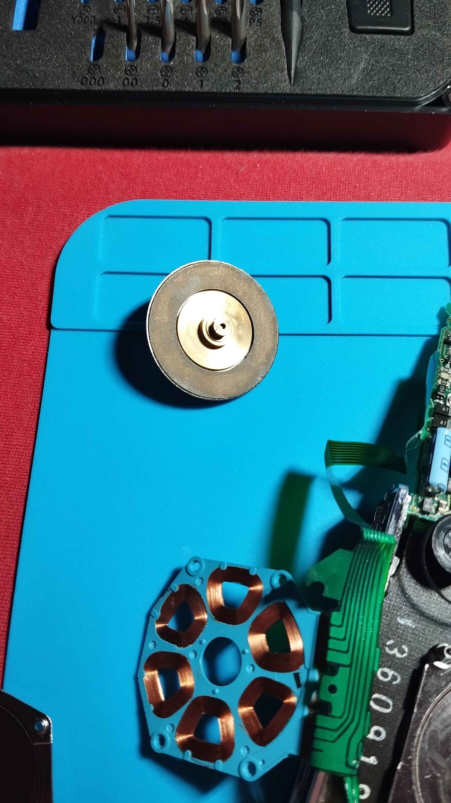

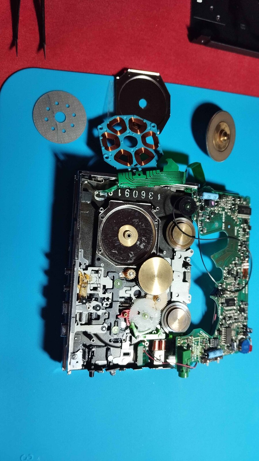

    I took the motor apart since it seems to be causing the issue. I'll try to clean everything as best as I can, but I want to ask - does anyone have any experience with how it should look ? More specifically the motor wheel ? It seems a bit worn to me, but I have no idea how it should actually look like, so maybe it's fine ? Any help would be appreciated.
    Btw just for info, I did look at the washers, they are present and they don't seem to be causing any issues, the capstan wheels are rotating fine without any resistance.

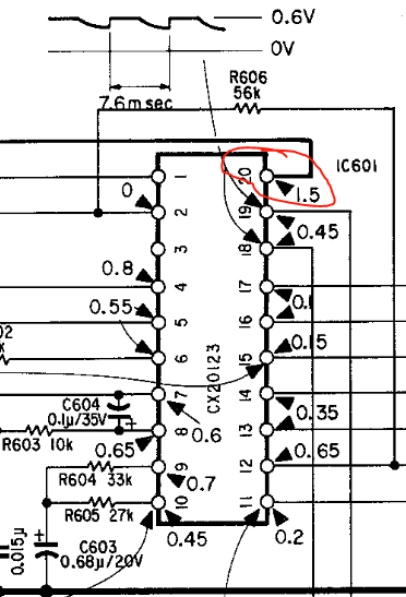

    i would check the replacement you used was a 1500uf4v but id guess you did a 1:1 replacement there already so its probably fine
    you could try measuring the motor voltage next- it should avg around 1.5v give or take according to the service manual (IC601, pin 20)-
