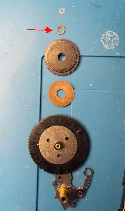

    Slightly off topic, but good timing as I have a WM-2 open on my desk that has the full plastic gear. After a good cleaning, I seem to have a mystery washer (red arrow) that has appeared on my work area. I can't seem to find a home for it except underneath the split washer on the centre gear. I don't recall it being there when disassembling or it doesn't seem to be present on the photo that Valentin references above. The Service manual also seems to have the metal disc version described and the clutch configuration is different I believe. The photo included has the assembly order I am thinking it is in. It is however possible that it is unrelated but I seem to be stalled. Does anyone have an experience with this or recognize the washer? Thanks in advance.

    That washer doesn't look like it would fit where you put it in the picture, because the center hole is too large.
    If it were to sit below the split washer (which I have never seen on this type of mech), the center hole would have be just slightly larger than the one on split washer (about 0.1-0.15mm larger).
    In your picture the hole on that washer looks ~4 times larger than the one on the split washer.
    My opinion is its unrelated, I can't see where it would fit and I disassembled this type of mech completely many times (you can find reference pictures on forum's gallery).

    Thank you Valentin, I reached the same conclusion putting it back together last night. If you look at the main gear, the yellowish plastic of inner sleeve is actually raised up above the black outer plastic about the same amount as this washer thickness. The washer fits over the yellow part nicely and sits on the black. However, I think that is just coincidence and agree it was not there originally. Maybe someone used it as a shim or something. I am pretty lucky, this WM-2 looks like it has never been opened, only missing a hinge screw (which will be a challenge), no cracked gear(s). Thanks again.
