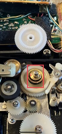

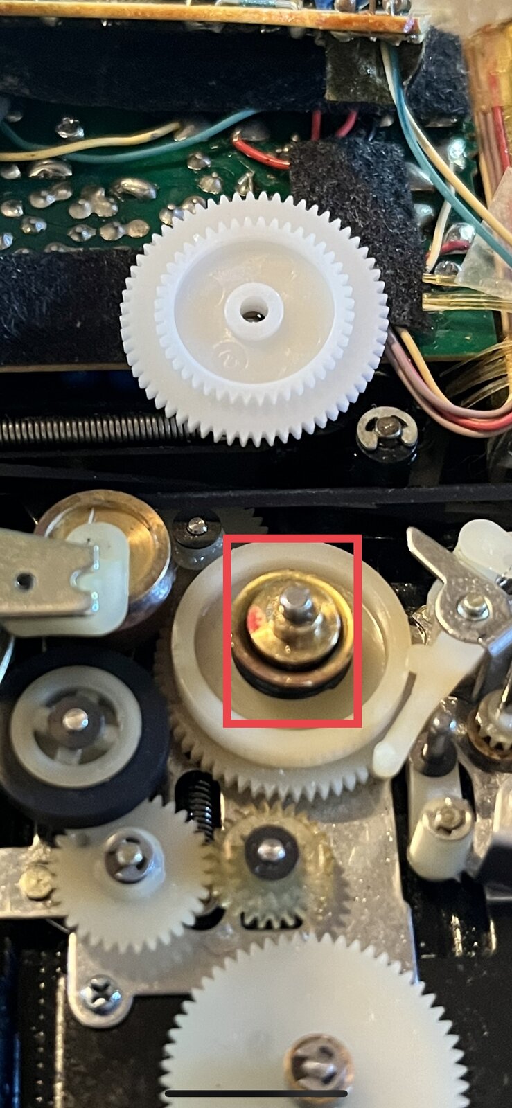

    Oh man, thanks a lot for the quick communication. I’m guessing I need to remove this brass retainer to get to the bottom gear. Unfortunately I’ve managed to rough it up pretty good in my attempt to remove it. I tried pliers and I’ve tried a flat head screw driver but it won’t budge.
  4. Valentin
    1,994
    One thing I can tell you for sure: you're unlikely to be able to remove that brass ring without damaging the entire assembly, it's a very tight press fit.

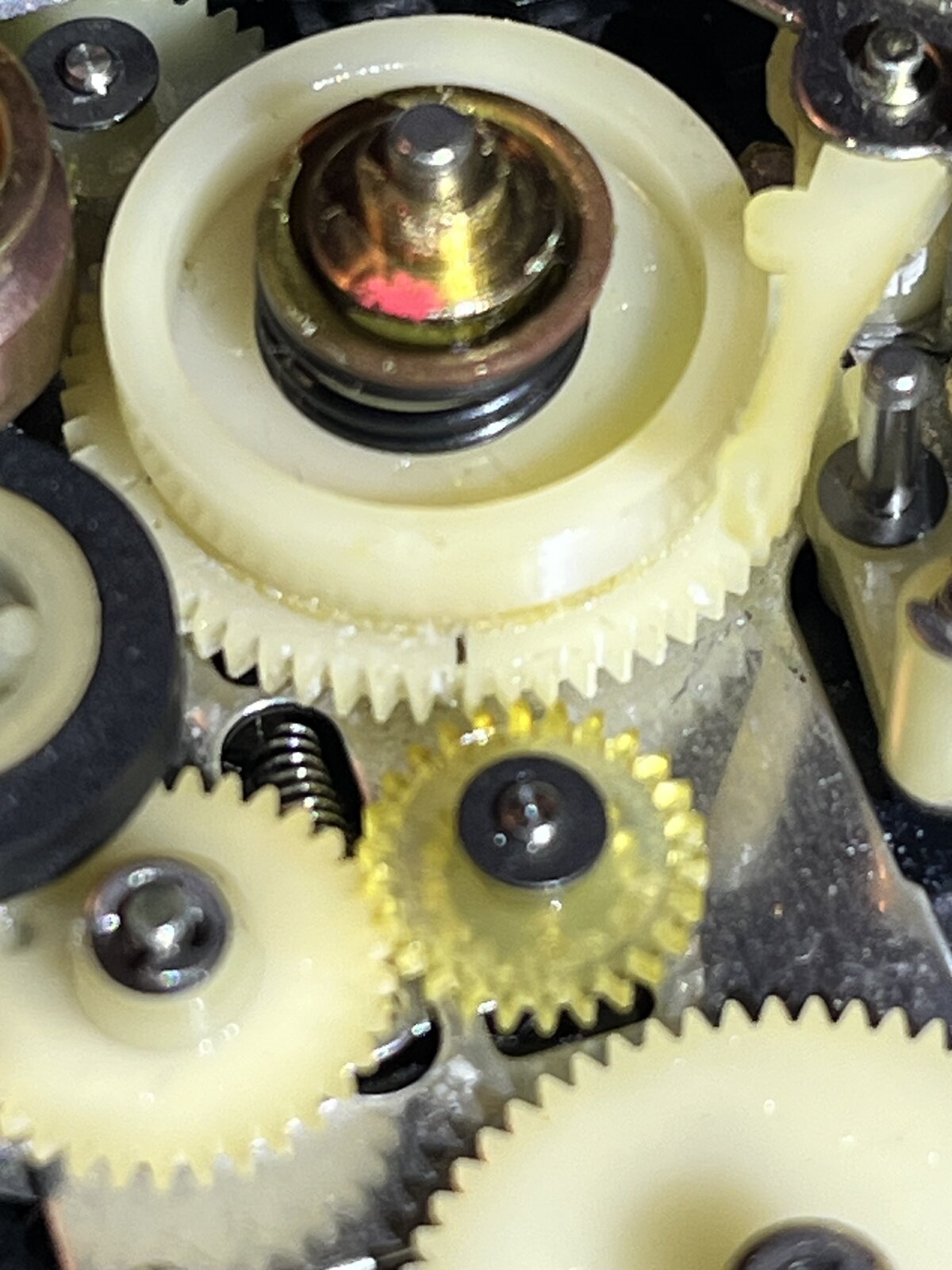

    Uug that’s like the worst news possible! When I found a supplier who makes reproductions of that gear I thought I’d won the lottery. And now coming to realize that there’s no practical way to swap them out….I mean that’s just cruel.
    I’ll attach a video and zoom in so you can see the hairline crack. It’s a little tiny bit of damage but it makes the whole deck unusable.

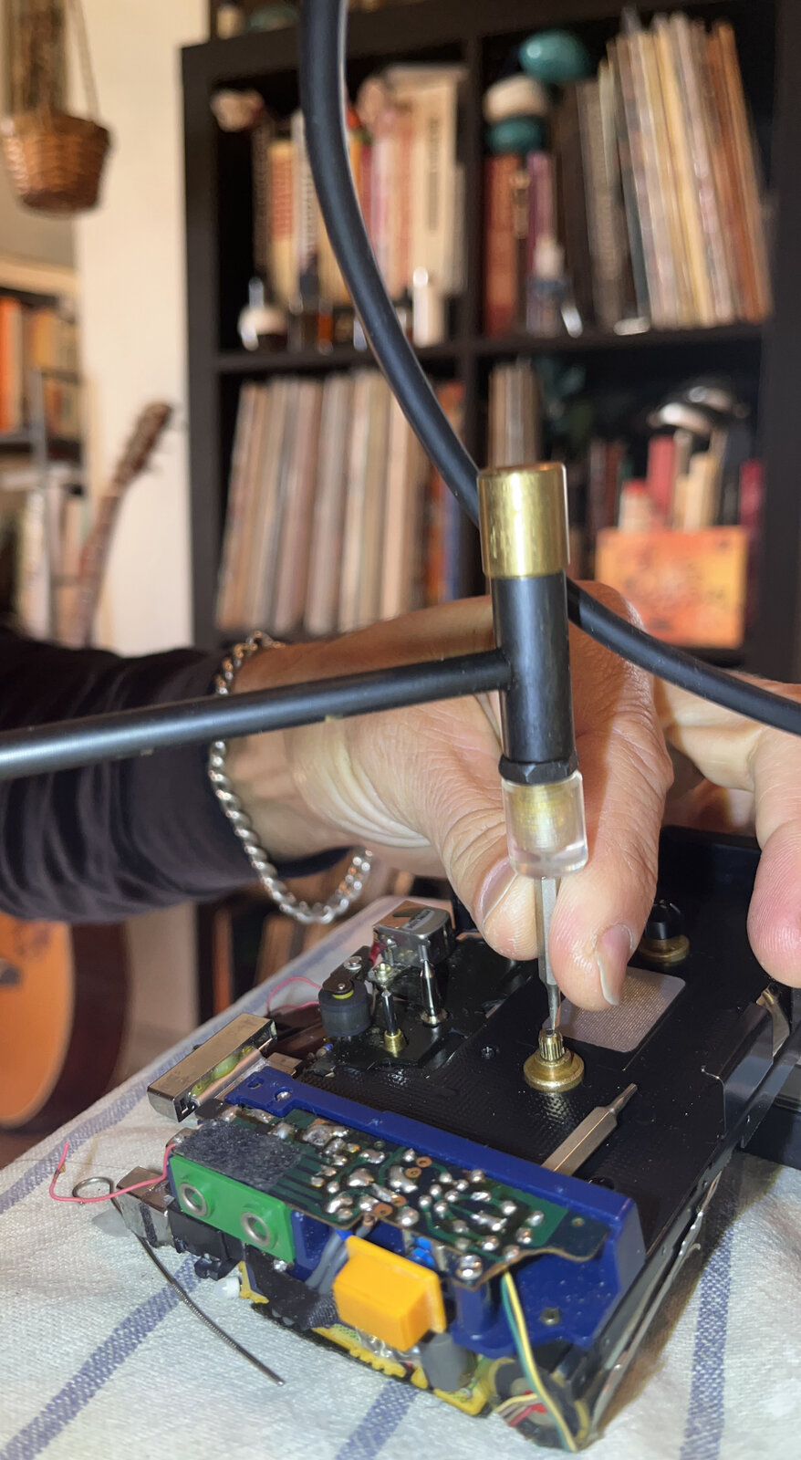

    I did start trying to approach the spindle from the other side but it’s a held in VERY tightly. I was wondering if I have to heat up the brass reel to make it expand to a point where I can use a small nail (scary) and ball peen hammer to knock it out the back side? Thanks for your valuable time. Seriously I’d be lost without your input.

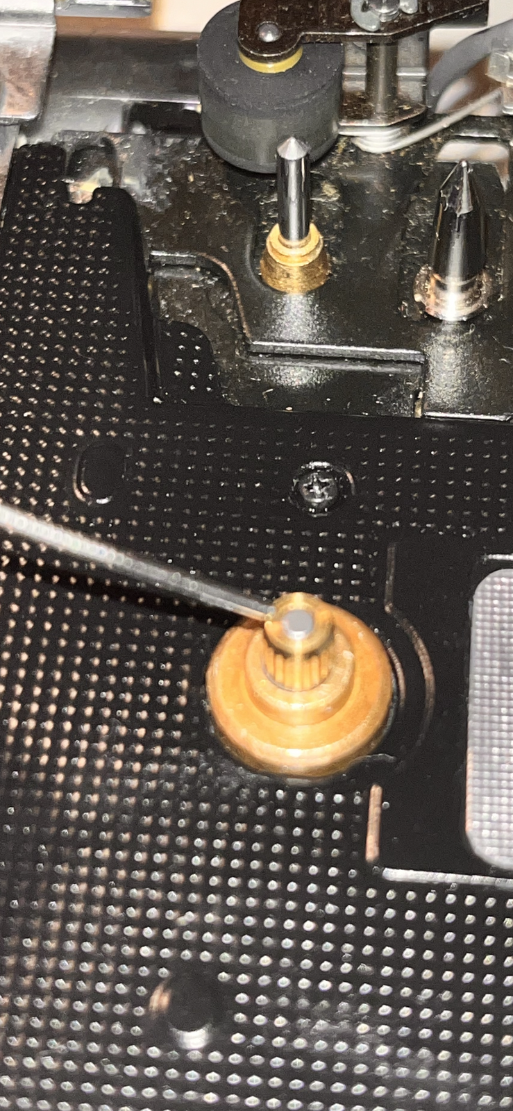

    Well this approach yielded nothing. Wouldn’t budge at all. I heated up the brass with a soldering iron till it was VERY hot and was hammering almost too hard. Not a millimeter of progress. Yeah, clearly a press is in order here; but where would you even be able to anchor it on the chassis for resistance? There are no points of contact they aren’t “delicate”.
    I know SOMEONE must have done this successfully or there wouldn’t be people remanufacturing and selling (not cheap) this gear. Unless, I suppose, it’s the same gear used in many different Walkman’s with many different methods of access. Right now I have a very valuable but unusable cosmetically clean piece of history. Isn’t that the worst feeling?

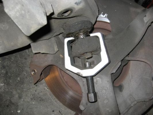

    I attached a picture of how the press I imagined looks like. In the pic it's a much bigger one used for car ball joints, but the principle is important.
    You need to have some claws to grip behind the retainer and a screw that forces the shaft down.
    However it's debatable if a screw that small can withstand such a force without the threads breaking.
    Hence why I'm more inclined to say that retainer (either one of them) should simply be cut and replaced. Don't think there's any other way of doing this job.
