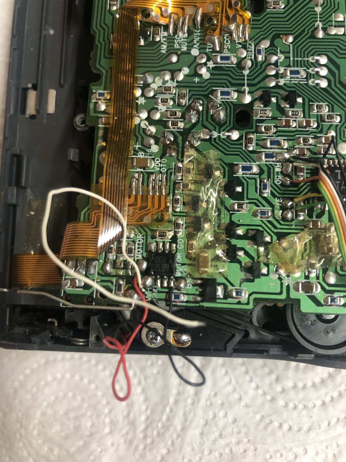

    I am starting out on a small project on an Aiwa HS TX410 personal player.
    I have a replacement belt but find that a white wire has become disconnected , it was intertwined with the red and black motor wires.
    I was hoping that a magnifying glass would reveal where the wire was soldered but no luck .
    Can anyone advise please.

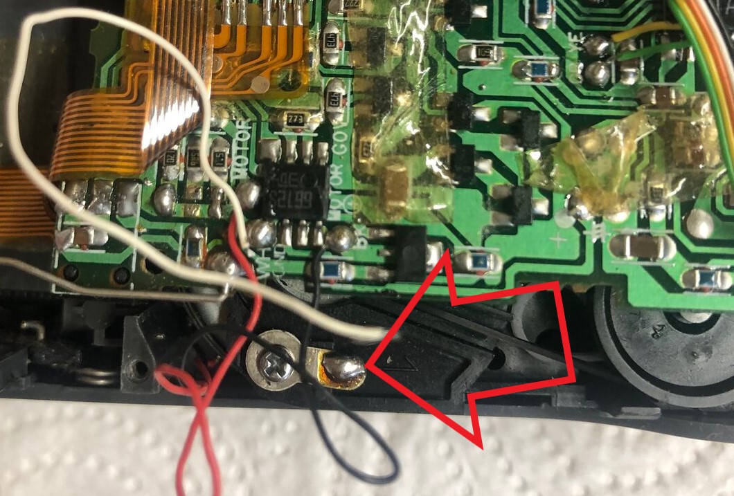

    it seems to be detached from here ... also because I don't see any other wires on that solder

    Also, does it say "WH GND" on the other end? The solder point Silver is pointing to would make sense for a ground wire, I think?
    MikeTorq58 likes this.
