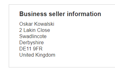

    somebody selling DD central gear kit (exactly the one designed by Marion) on ebay.
    anybody know this seller? there is different solution/ gear offered on Ebay but this one specifically is exactly the one @mihokm designed. If this guy i Marion's agent/ proxy , then there is nothing wrong with it, otherwise nobody should buy from this guy since Marion spend a lot of time to design the gear and some of us helped to his project.
    https://www.ebay.ca/itm/Sony-WM-DD1...221875?hash=item23e61884b3:g:LAAAAOSwD4Ffprjo
