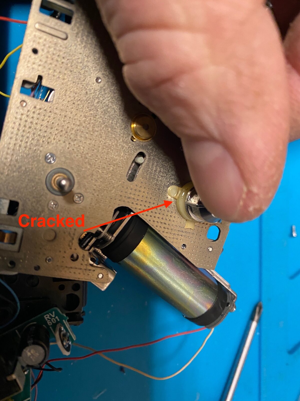

    Ciao a tutti, ieri ho trovato un wm DDII probabilmente di mio padre, ho provato ad accendermi ma sembra morto, la luce rossa rimane spenta e non succede nulla se provo a premere start o qualsiasi altro pulsante.
    L'ho aperto oggi e ho notato che c'รจ una marcia rotta, cosa potrei fare per ripararla?

    Hi I have a WM DD first model 1982 with broken central gear. What type of gear you recommend to me? I read a lot and no sure what kind to use - with skrews or not?
    Thanks!

    Hello, if its your first repair I think the plastic gear is easier.

    Yes for mi is first repair.I want to use better plastic gear.Do you have experiance with this gear?
    Thanks!

    @Ivajlo B Please read posts #332 and #333 (5 posts before yours) as we already stated the experience in regard to that gear. Use it without any worries.
