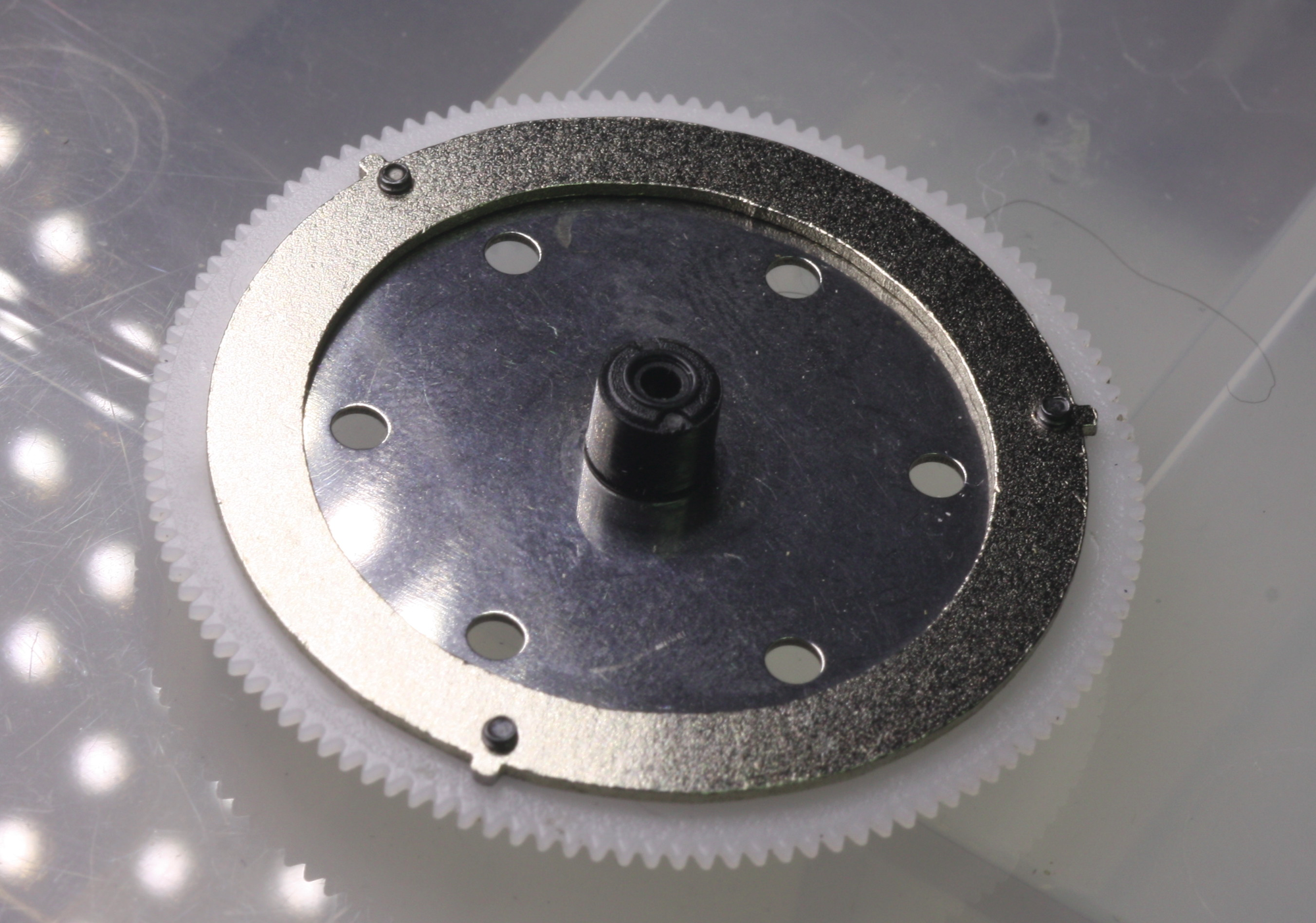

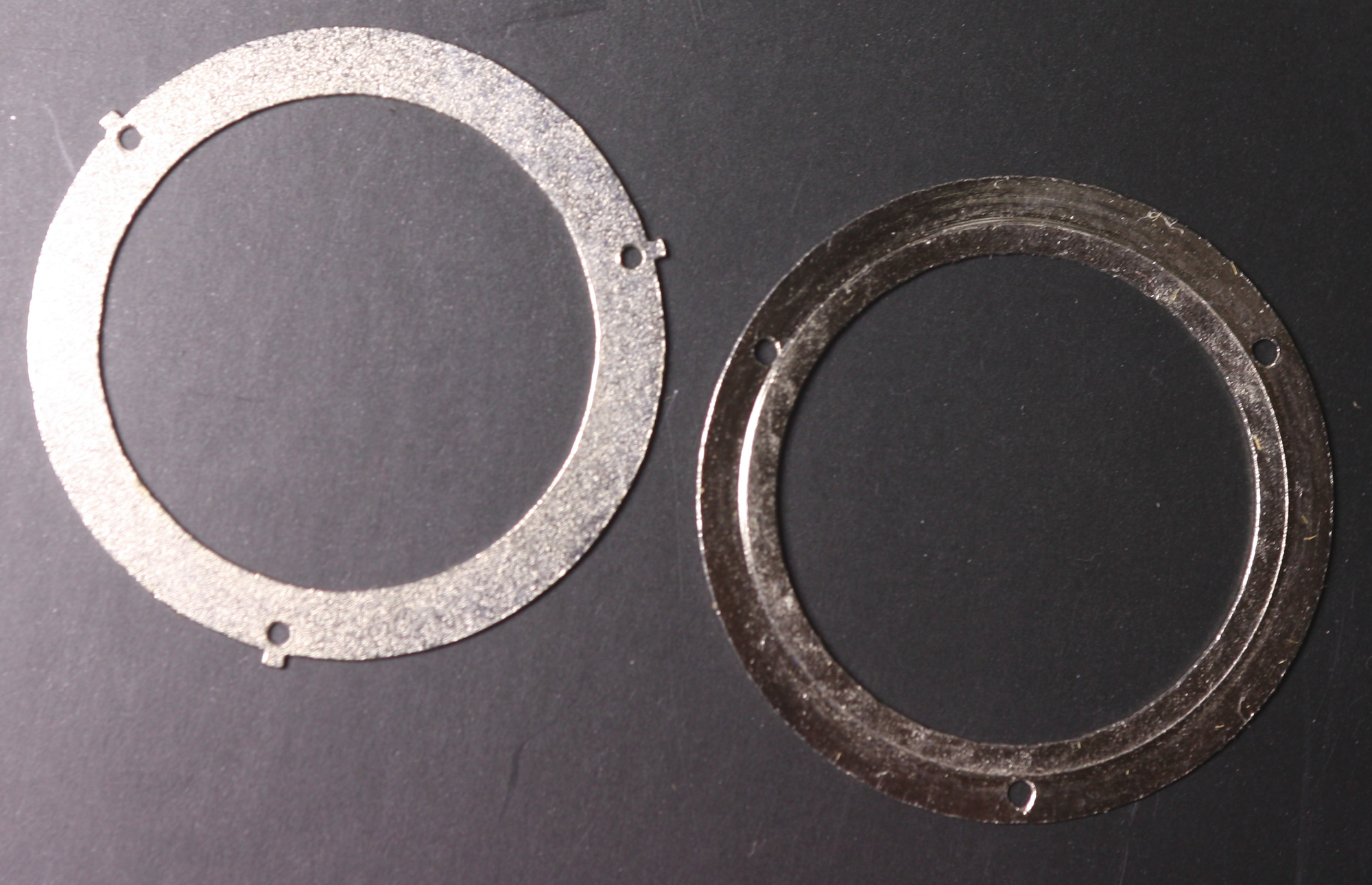

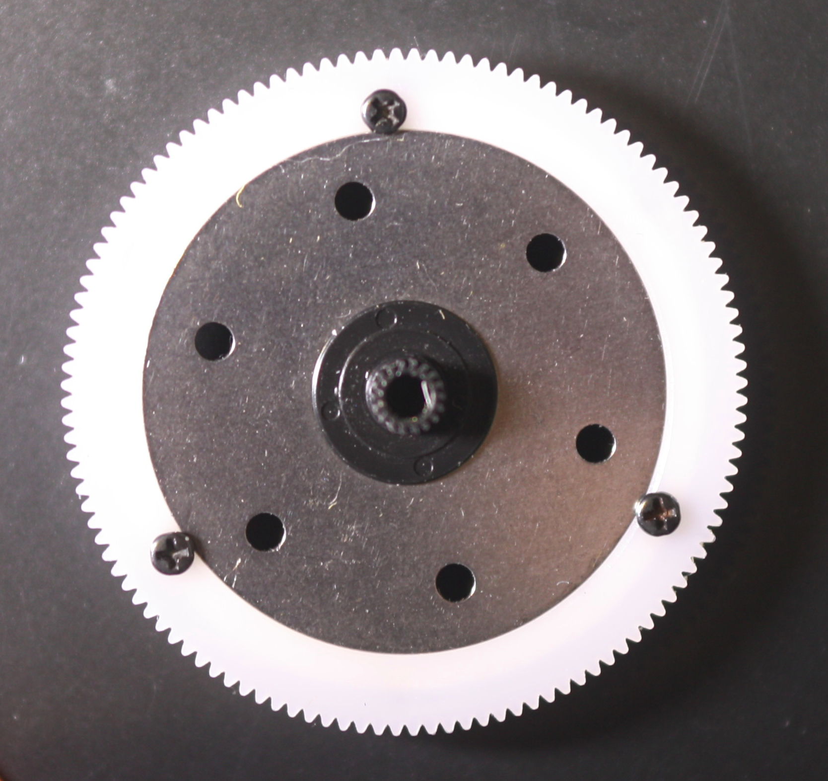

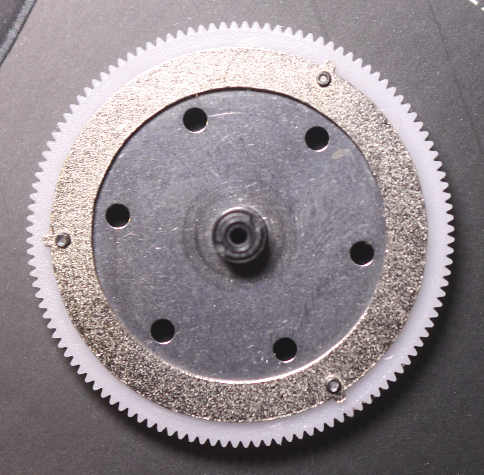

    I will post any updates, as soon as I have them. Now I'm waiting until I receive the final version of the support rings. I do not want to order final gear production until I receive them. Better test them 10x and then place one final order. I also did research with small screws producer. I will need special, custom M1.4, length 1.3 mm screws made. He told me that minimum order quantity is half million. There are many producers, I have to find one who is willing to accept lower MOQ. These are simple details, but these need to be solved as well. Luckily, it is not show stopper. Standard M1.4 screw can be used as well, after few modifications.
    I'm planning to develop my own e-shop for cassette parts. I did similar project few months ago. So much interesting things to do and so little time I have :(

    I have these screws but they're not good. The head width is much smaller. Also, length does not fit. These are much better:
    http://www.ebay.com/itm/272492794153
    1.3 mm fits well. For better results, the head should be even wider and thinner. I prepared screw drawing and now I'm getting quotations from various producers.
