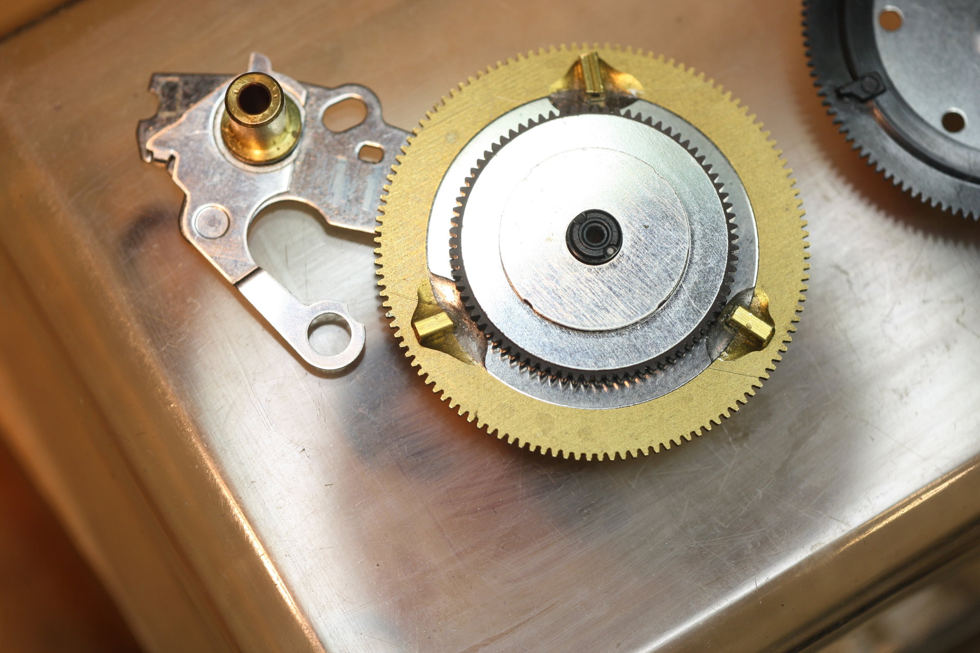

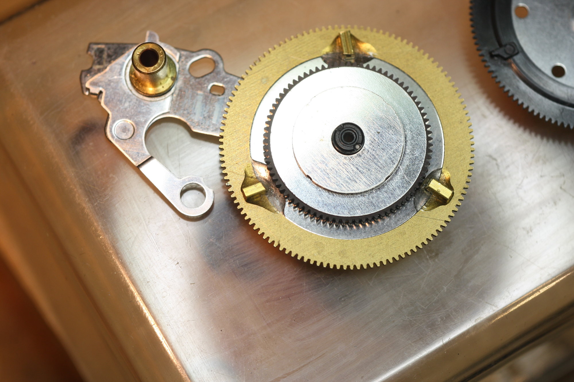

    The gears samples and screws are here. I'm very satisfied with result. The dimensions are accurate and teeth are exactly the same as original.
    It was not easy to prepare gear drawing because teeth dimensions are not standard. I had to tweak source code of the gear drawing software.
    The only issue that I can see on samples is one faulty tooth. I hope producer can correct it easily. I'm waiting for their answer.
    Here are some photos of result (sorry for bad quality of images). center_gear1.JPG center_gear2.JPG broken_tooth.JPG

    Weird manufacturing issue though... looks like a glitch in the mould to me.
    I can hardly wait to see your final production results.

    Small problem wasn't in mold. There was something wrong during processing. They made another samples and all is OK, now. They sent me photos as proof.
    I'm going to order final production. I'll be on holiday from 31st of July to 14th of August. When I'm back, gears should be here.
    I tested them in 3 different walkmans this weekend and they work like new (except slight click caused by defective tooth). I'm really satisfied.
