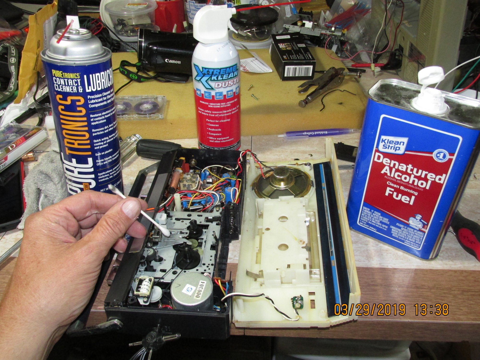

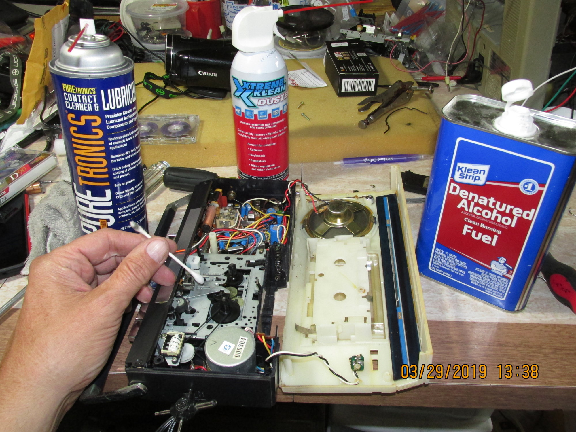

    Hello im just wondering seeing as you obviously are very familiar with thus model, a few days ago i managed to find a National RX-C300 at a garage sale in near new condition, it works but doesn't sound to flash, i took it apart tonight hit it with deoxit and it does sound much better however the left channel is very weak, also the switch for the spectrum analyzer doesn't stay on unless u hold it, i took ot apart and not sure if its repairable or i need to source a new switch, any advice on where to start to get the left channel working and the analyzer switch repaired or replaced would be greatly appreciated, cheers in advance
    Cassette2go likes this.
  8. Cassette2go
    1,615
    As in ANY Recorder ... Did I forget to say ((( ANY ))) any tape deck that Records, any recording deck, ok I have I said the word ( 'any' enough time s'? ) LOL Please Clean the recording Bar switch as it is located Behind the tape deck as ALL Of your music goes through it and if an when it get dirty and it will, just blow it out with air followed by contact cleaner w/lubricant work the switch and repeat and untill the switch snaps back with a clear click sound & then you should get your low in one channel sound back. I detest those push on an push off swithches and the mecahinacs of those will wither and go brittle and there you are. I have a different radio that works perfectly as long as you stand there and hold the button in and you release the botton and the sound goes away - so now it is a parts box so sad. 713-502-9993 call me James daytime only please :) IMG_6645 Panasonic RX-C300-2 not work
