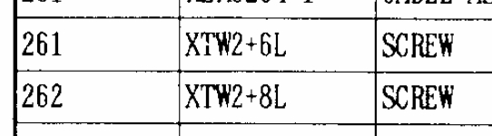

    Hello again...... Can anybody here help me with some information ("name" and size for example) about the screws I circle in the picture below? As you can see, they are the ones that fix the head mechanism. I am in the need of finding at least four of them.
    For any help, thanks in advance.

  7. Hyperscope
    Hyperscope Well-Known Member
    320
    Probably 2.5mm to 3mm and they were originally JIS Philips screws. Easy to strip. About 10mm length. I would send for a metric pack assortment on e-bay to test fit which ones work.

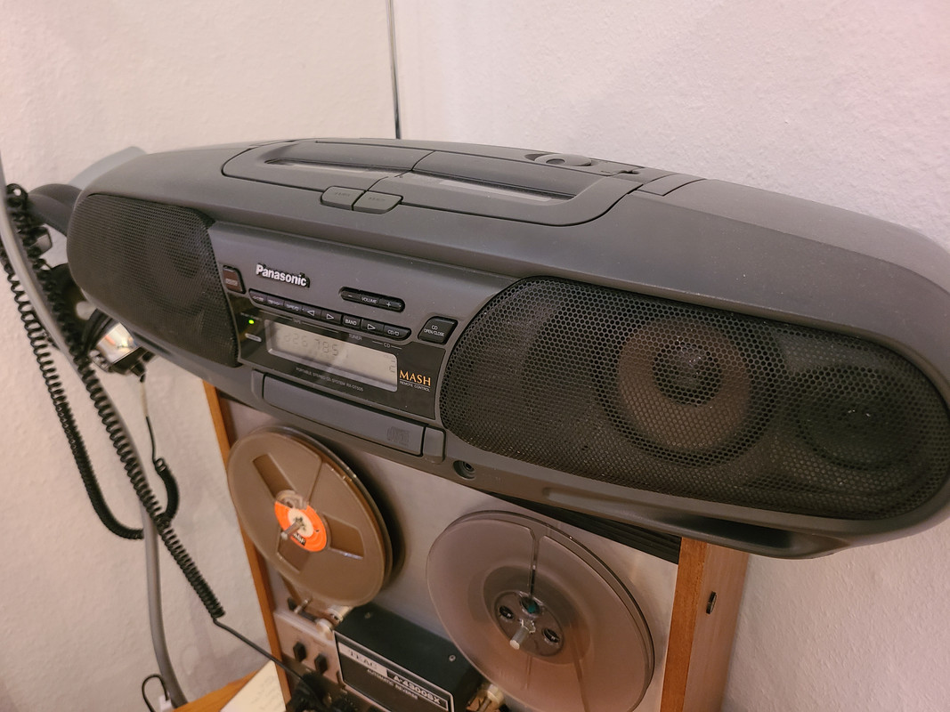

    This is the first one that I bought some months ago, and which made me want to have a second one. That second one is the one that still is under repair (not in the pictures). Not too much time and several other things in which I must invest that very time.​

  10. kanamaster
    kanamaster Member
    58
    Germany
    Two of my favorite babies......
