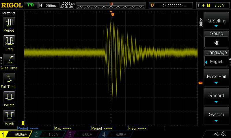

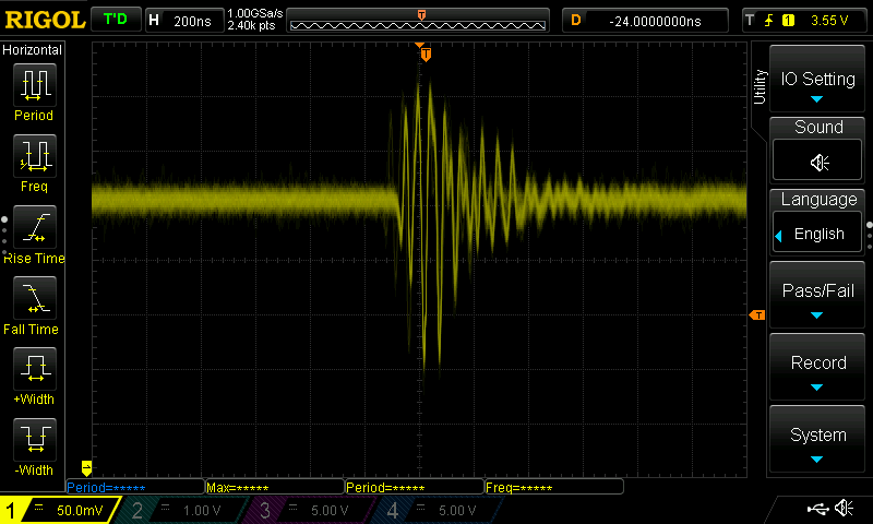

    On Christmas Eve my little bastard lighted up like a candle during my long term test. The smoking signals were not a good sign and I switched off immediately. However I have not found any issue, everything was working. Some days later everything failed and it was not working anymore. Seems that some components got stressed during the fire and finally failed. I had to replace two transistors and two fusable resistors on the power supply panel to get it back working. Took me another day of desperation.
    Now I am running again a long time test since a couple of days and everything is working great. Think the machine and I do have a kind of love & hate relationship.
    Also finished the second part of the tape mechanism repair video. I contains an unprofessional way (for the poor wo/man) to measure wow & flutter and to set the speed. Anyway, the method was working very good, better than expected. A recorded tape on the CD555 sounds also very good on my Denon devices.
    Fun fact - I had an artefact during recording from whatever source I choose. I took me about 3 days of measuring just to recognise that the signal was coming from my magnifier LED lamp :eek::confused:
    Artefact from the LED lamp on the audio line about 37kHz ish...
  13. Longman
    A few days ago we were talking about AM radio and how my wife still listens to Smooth Radio on it in her car.
    Coming back from shopping with her we pulled into the drive and started getting noticeable interference on the radio
    exactly in time with the LED Christmas lights on the other side of the garden.
    20,201
    I get the same thing, I listen to radio everyday and sometimes I get interference, I always thought LEDs were fine and flourescents were the issue.
