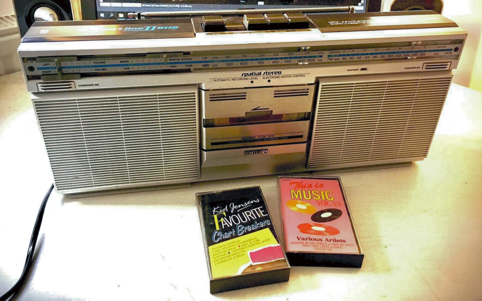

    It was my first boombox back in 1983, and today I received one via eBay. Surprisingly good condition for something 38 years old, though with one slider missing.
    Gave the heads, capstan and roller a flipping good clean (and they needed it), and aligned the head. Playback is so far acceptable. On recording however, the previous recording on a tape is not erased. This suggests the erase head is at fault. I did manage to get a lot of oxide off of it, but so far to no avail.
    Are Philips erase heads known to fail? Any suggestions are welcome. Also if anyone can recommend a suitable size of replacement belt, that would be lovely. The current one appears to go slack when the motor starts and stops, but otherwise drives well.

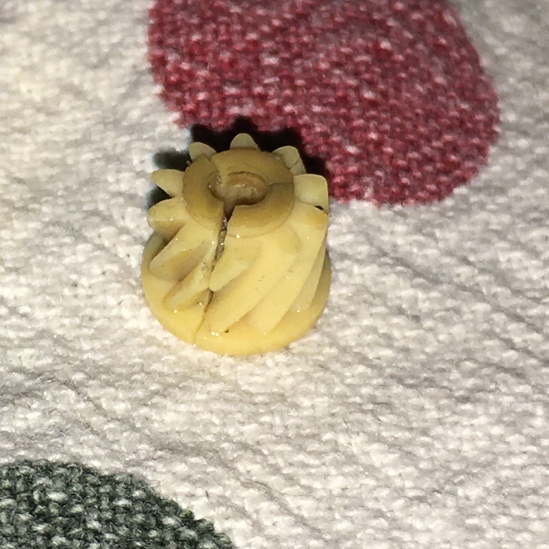

    And because it is a Philips, it comes with those famous gears made of cheese. Removing the capstan flywheel reveals a mounted gear with ten diagonal spokes, and a visible crack down it. This seems to interfere with the takeup spool in play mode, leadign to tapes being eaten. Has anyone ever successfully 3D printed repalcement gears? Should I attempt to just superglue it back intact?

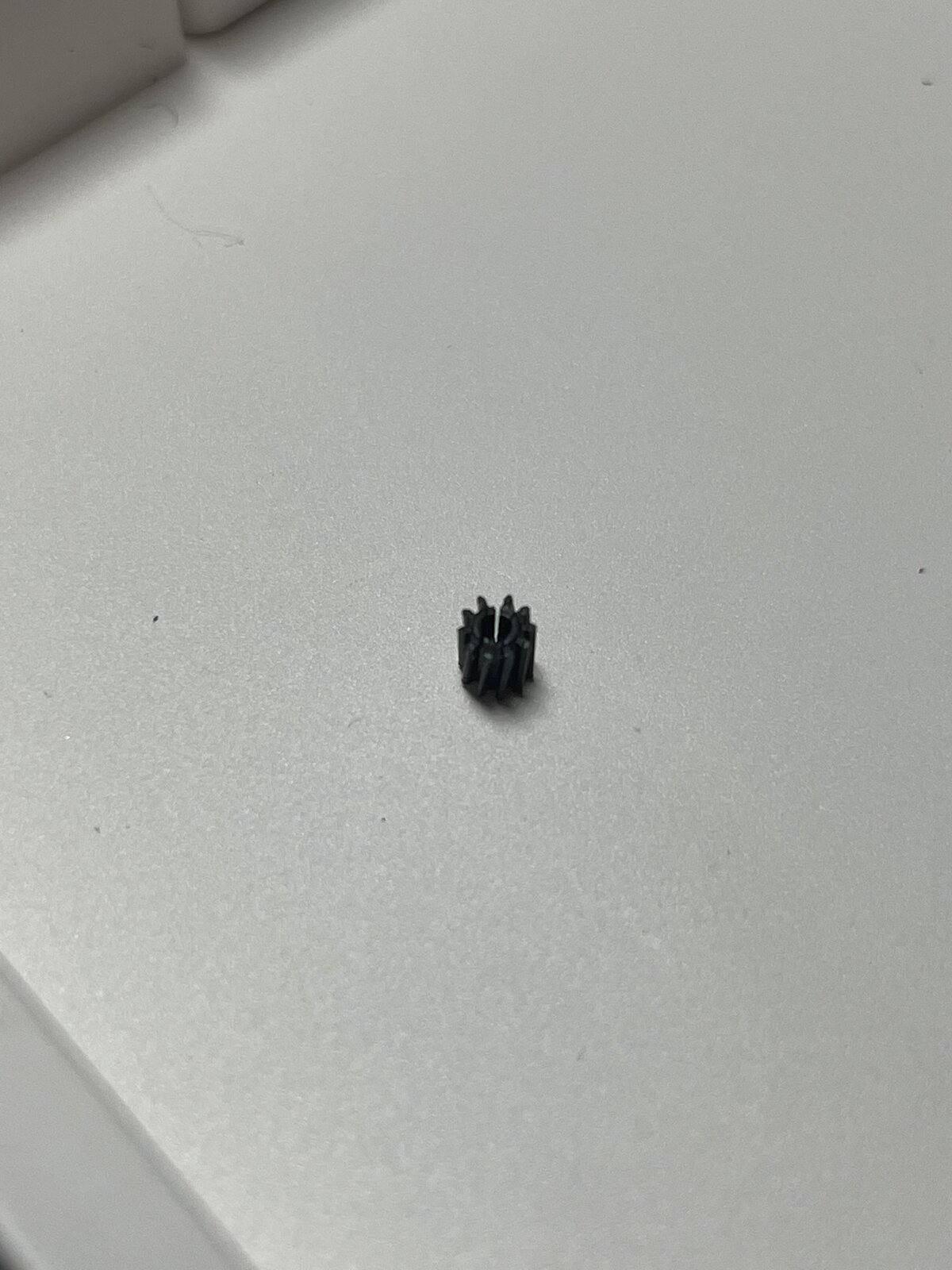

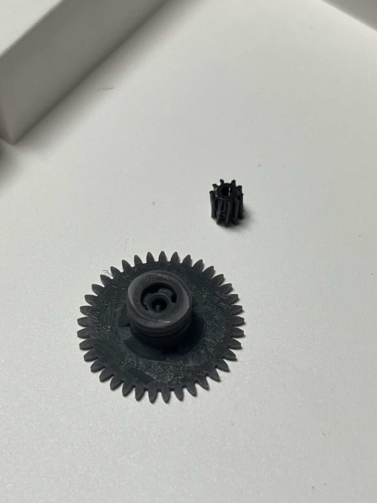

    Not just Philips.. I have 3 Sharp MiniDisc portables that all suffer from a cracked, tiny gear.
    Supposedly press fit on the sled axle, but after 15+ years no fit and TOC error as a result.
    You see the crack in the small gear (white background showing) that meshes with the worm gear part of the larger gear assembly.
