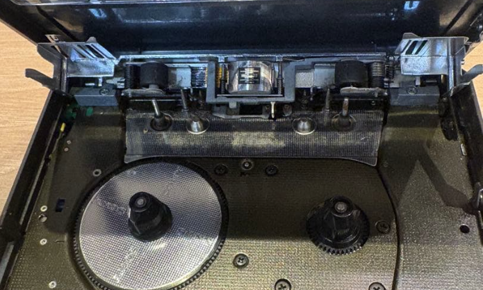

    Thanks, unfortunately I don't have the WM-503 walkman in hand yet, it's still at Buyee. But I did open up my WM-501 which looks like it has identical mechanics inside. and measuring those pinch rollers came up with:

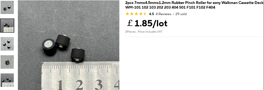

    7(D) x 5.5(H) x 1mm
    I saw some on aliexpress going for cheap price
    https://www.aliexpress.com/item/100...c_item_bridge_pc_main__UBlNeca__1769015803837
    But given some of the comments I thought I'd avoid for now.

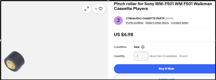

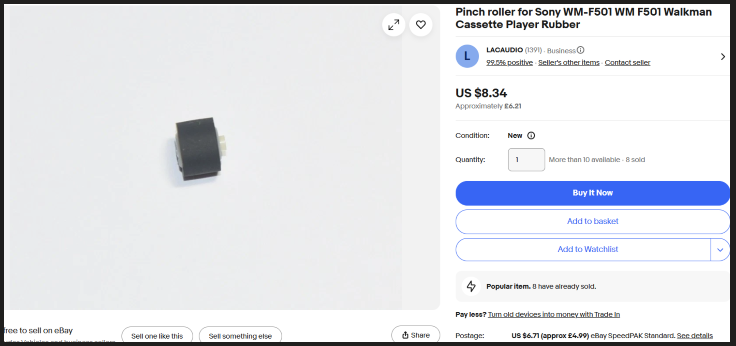

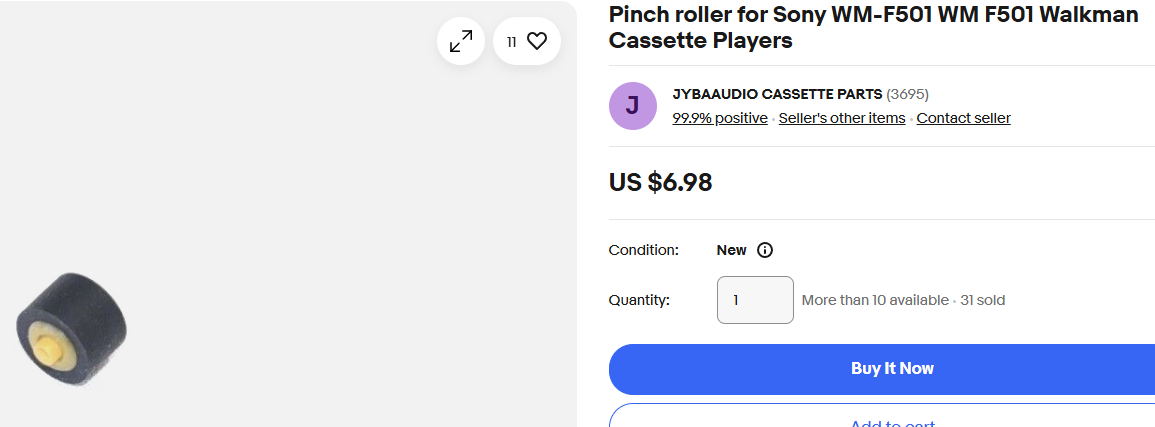

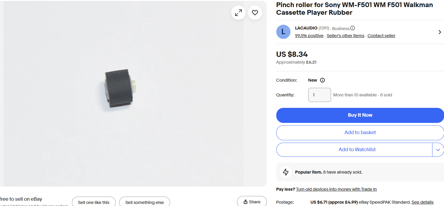

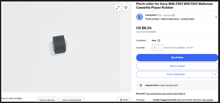

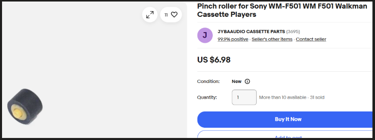

    Looking on ebay I spotted 2 sellers selling pinch rollers under the model WM-F501
    https://www.ebay.com/itm/125756456667
    https://www.ebay.co.uk/itm/315191145064
    So I asked the second seller for dimensions and he came back with
    "diameter is 7mm, the rubber width is 4.8mm, and the total height is 6.4mm."
    They seem to be reduced in height 5.5mm vs 4.8mm - but I've bought a couple to try out.
    I'll let you how they fit, I've not pulled the rollers from an old WM-501/503 before so I hope it's not too awkward!

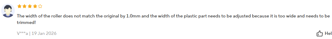

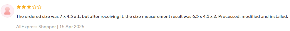

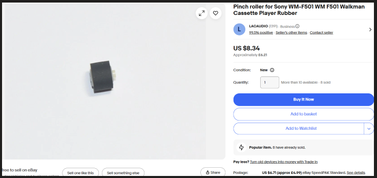

  4. Valentin
    1,985
    For WM-100/200/500 series you will need the ones at 8.34$ that has the hub sleeve only on one side not on both.
    The other can be modified to fit these series also by cutting/sanding one side of the sleeve, but in reality those are for some early Panasonic RQ-JA series.
    That's what the one with 4-star review is trying to say. Rubber dimensions are the same on both types, it's just that extra sleeve that on one it needs to be trimmed.

  5. radiorich
    radiorich Active Member
    249
    Washington state
    Hello guys,
    Valentin is correct because I know I have one of those Panasonic RQ-JA series sets that use that one.
