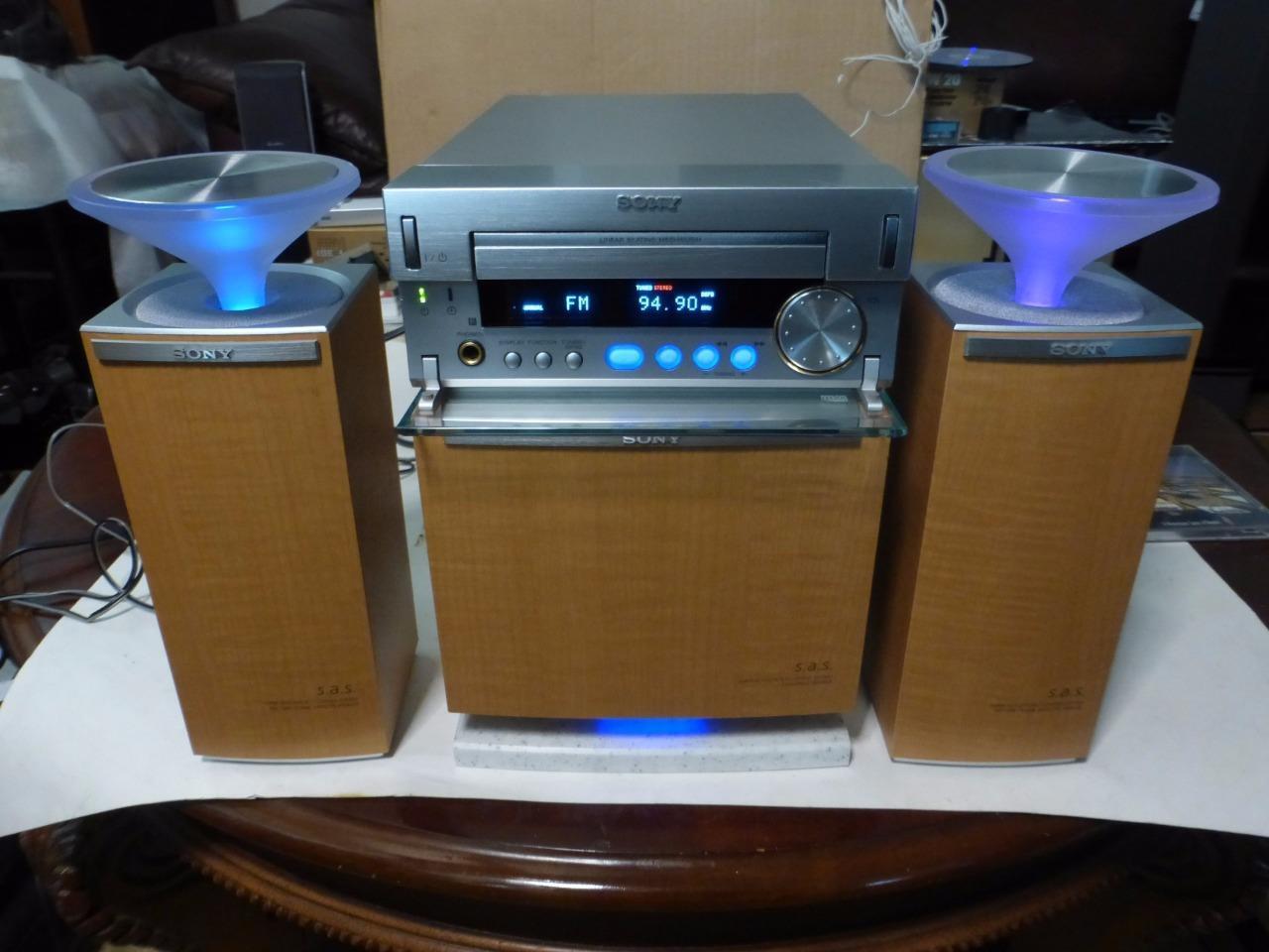

  6. Kulgrinda
    Kulgrinda New Member
    13
    Lithuania
    Sure, here it is with half loaded Iron Maiden cd :) Speakers are actually from another Sony micro system HCD-SD1 - 2 satellite speakers plus subwoofer. This system was really beautifully show-cased in Sony catalogs when I was a teenager, I always wanted to own a set. Sound is disappointing, but they look beautiful and very extraordinary :) Original EX1 speakers sound much better.

  9. Kulgrinda
    13
    Lithuania
    Cones actually have 2 functions - they glow when unit is on (not only blue, there are 3 RGB controls at the back of each speaker so you could change color to match your interior or mood :) Cones are matt glass) and work as a diffuser for drivers that are mounted on top of the speaker. That is the main drawback of these speakers - sound is very boxy (speakers are actually plastic) and spread out, not concentrated. Without subwoofer it is really bad, with it correctly setup sound is acceptable from further distance.
    PS subwoofer base is marble. Probably unnecessary, but still nice touch :)

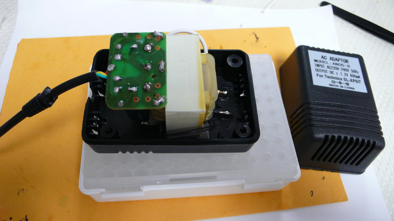

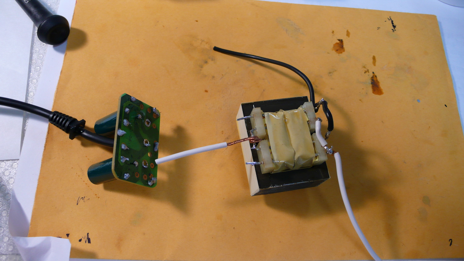

  11. Jorge
    1,794
    The easiest and the cheapest, as always, is to buy 120-to-220 step-up transformer, they are sold on Amazon and eBay for ~$10.
    But it is very easy to rewire the original adapter. You open it (it is held together by screws) and exchange the transformer. Transformer which worked the best for me is FS12-1000 by Triad Magnetics. Follow the instructions which come with the transformer:
    Good luck! :)
    JasonZ and Emiel like this.
